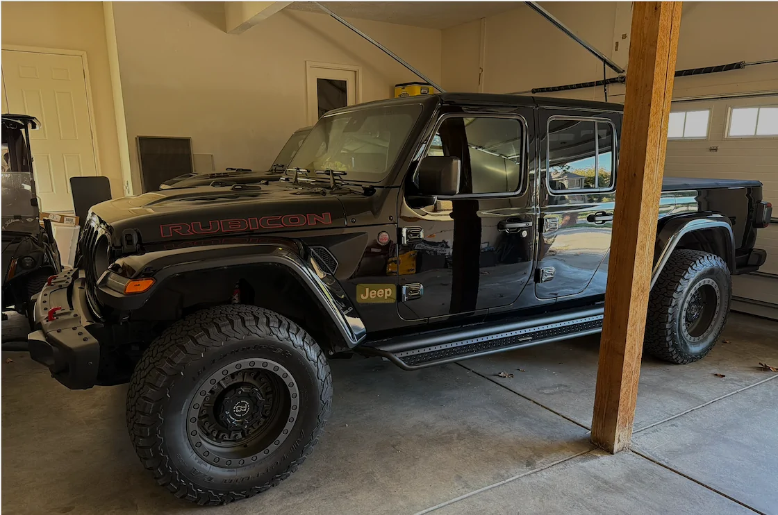

I've owned a 2020 JT Rubicon Launch Edition since new. It has the original FOX shocks that came with it. The factory steering stabilizer was replaced with a FOX unit. I have 35x12.50 BFG K02 E-Rated tires running at 35 psi. I had the dealer install a Teraflex 1.5" spacer kit when the tires were installed. I've always dealt with the soft suspension, bump steer, and wandering. I get the tires are pretty stiff and that may be a lot of it.
Truck has 61,XXX miles on it now and I'm thinking of having the BILSTEIN B8 5100 Leveling Kit installed. LINK Curious if anyone here has experience with that kit and any feedback? My concern (after searching here) is the stock springs are too soft and the BILSTEIN shocks will help but not be the fix.

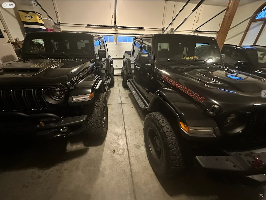

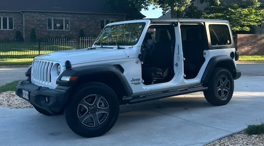

I have a '23 392 JL Rubicon XR (35" BFG K02 C-rated) along with and a '19 JL Sport S that is mostly stock. Both JLs drive SO MUCH better than the JT. I'm looking at options for improving the JT ride. I'm not looking to do much off roading and want to keep the lift to 2" or less. What other suggestions do you all have? Would new shocks and new C-rated tires be a better idea?

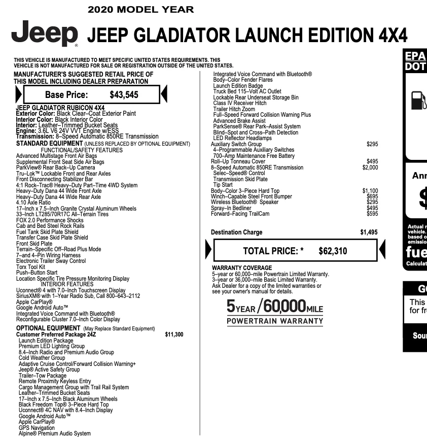

That's a great way to describe the ride - like the bed is overloaded. Good to know on the red shocks. I had looked around and thought of just swapping the shocks with other Jeep/Mopar shocks (like 392 shocks). However it seems that doesn't always go well - want to make sure to get the correct shocks for the JT.
I looked at my build and it shows the "Trailer-tow Package" but it doesn't state "Max Tow". Did you find the rear coils second hand or buy them from the dealer?

Bought someone's take-offs on eBay. Roughly $100. I figured it was worth a try for $100. I installed them myself so no labor cost. I don't have the exact part numbers on me at the moment. I think there are different "Max Tow" springs, and probably additional ones for 2020. I think one of the set was 68341445AB. The other was a slightly different number.

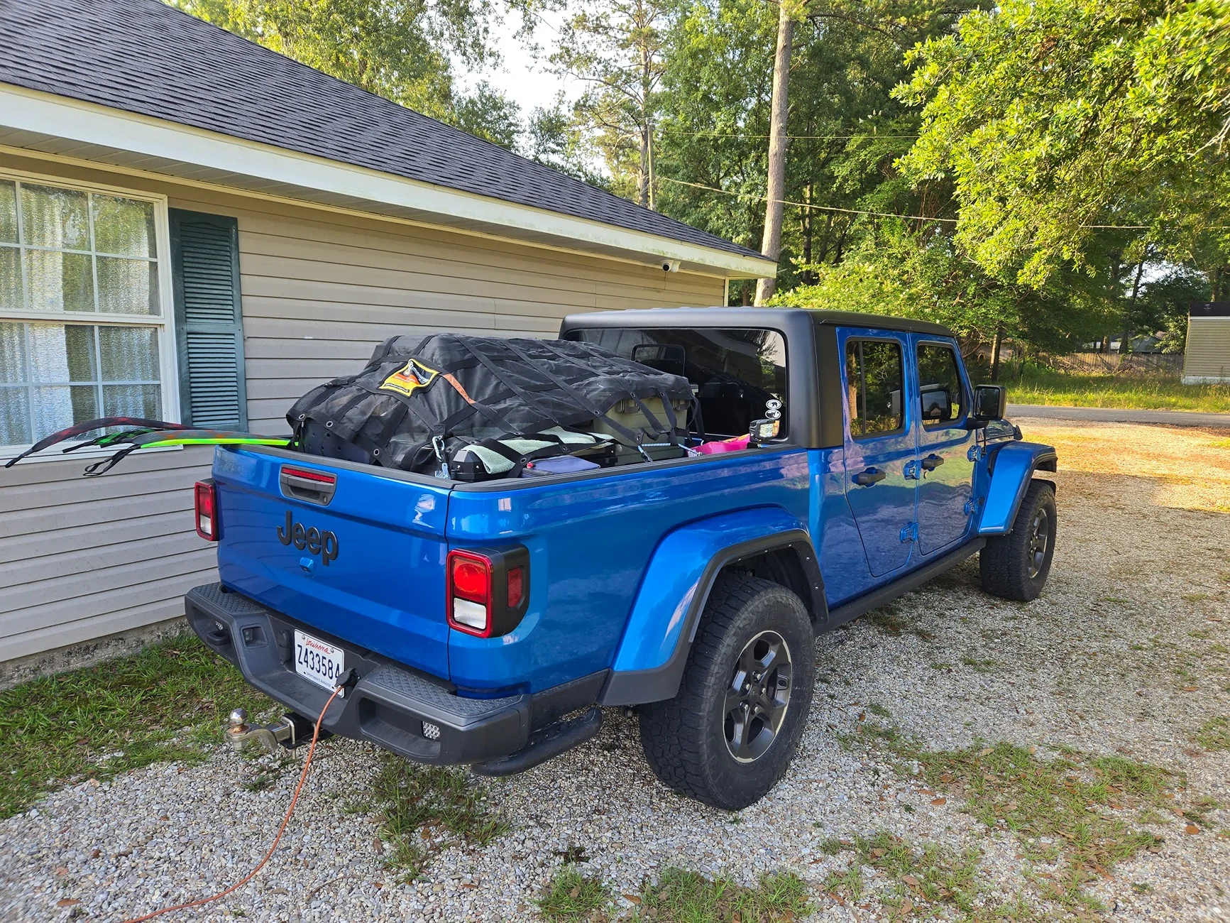

Mine being a Sport, it always had a 'firm' ride, but the 5100's are a bit firmer than the factory shocks. I think our roads are just a bit terrible for a digressive shock. You can run over a quarter with 5100s and feel it just about. Id prefer something at some point that is firm, but progressive rather than digressive.
I rode in a stock Rubicon once and it felt squishy just driving down a flat highway. It would bounce over expansion joints.
They control weight very well, though. I can drive pretty sporty even with a lot of weight.
Thats three weatherproof cases packed full, 100 pounds worth of fridge, 8 fishing poles, three scooters, probably 250 pounds worth of toolbox, and other junk. Plus three kids and two adults. No wallow or sway, even exceeding the speed limit on hilly/curvy two lanes. This is a Max Tow as well. So. Good springs...
