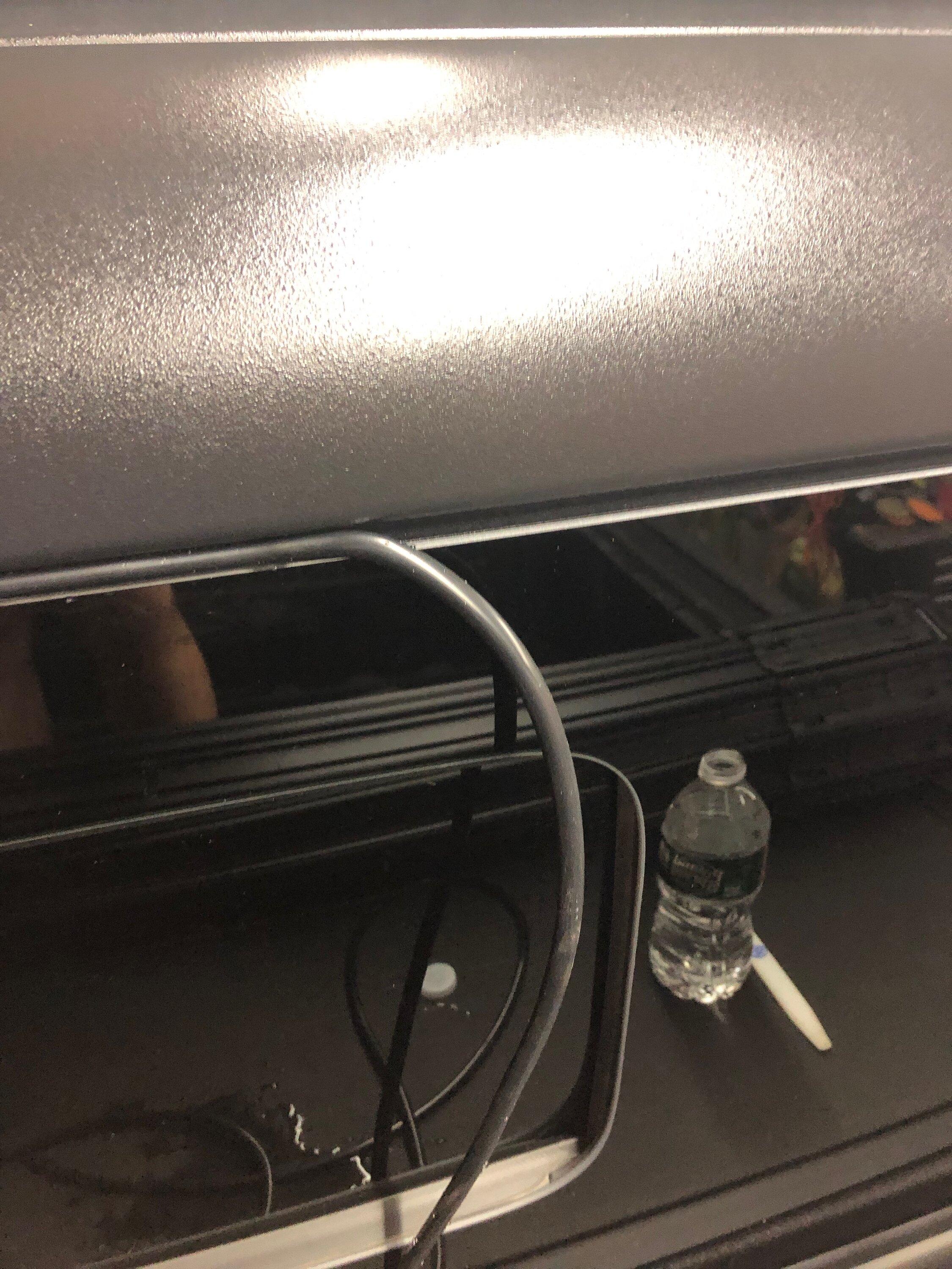

I chose a DIY fix after reading horror stories of damaged vehicles.
Looks great. I might do the same. Rear window on my truck started leaking also.
Looks like hose or weather stripping of some sort. Correct?

I used automotive rubber vacuum hose. I'm not exactly sure what size I ended up using since I had several different sizes 'in stock'.
I cleaned everything thoroughly, then used a mix of isopropyl alcohol and distilled water to act as a lubricant for installation. I used a 2" long piece of roughly 1" OD plastic pipe (wrapped in painter's tape) as an installation tool. Wet everything down, place the rubber hose over the gap, then roll the tool over the gap to push the hose in to a consistent depth. It's kind of a PITA because the side gaps are slightly smaller than the top. I did the top and all the way down both sides, but left the bottom open.
Thanks for this tip. After putting off dealership repair for fear of them marring up my top and interior trim panels, it seems this solution has rectified my leak. My Gladiator spends the majority of time in the garage so I was not really worried about it, but it did bother me when I had to drive it in the rain.
I used this 1/8" Vacuum hose from Amazon for anyone else looking to do this. For only $11 and less than a half hour its a no brainer. It also looks better in my opinion with the gap filled in.
Jeep Gladiator 2020 Gladiator rear window leak (so far i suspected the actual small opening window, but actually it is entire top of the window) IMG_4241
That's awesome! I'm glad I could help.
