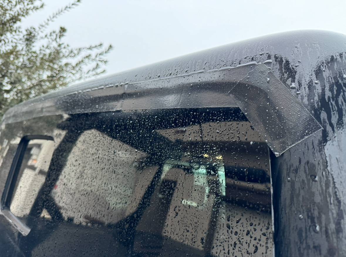

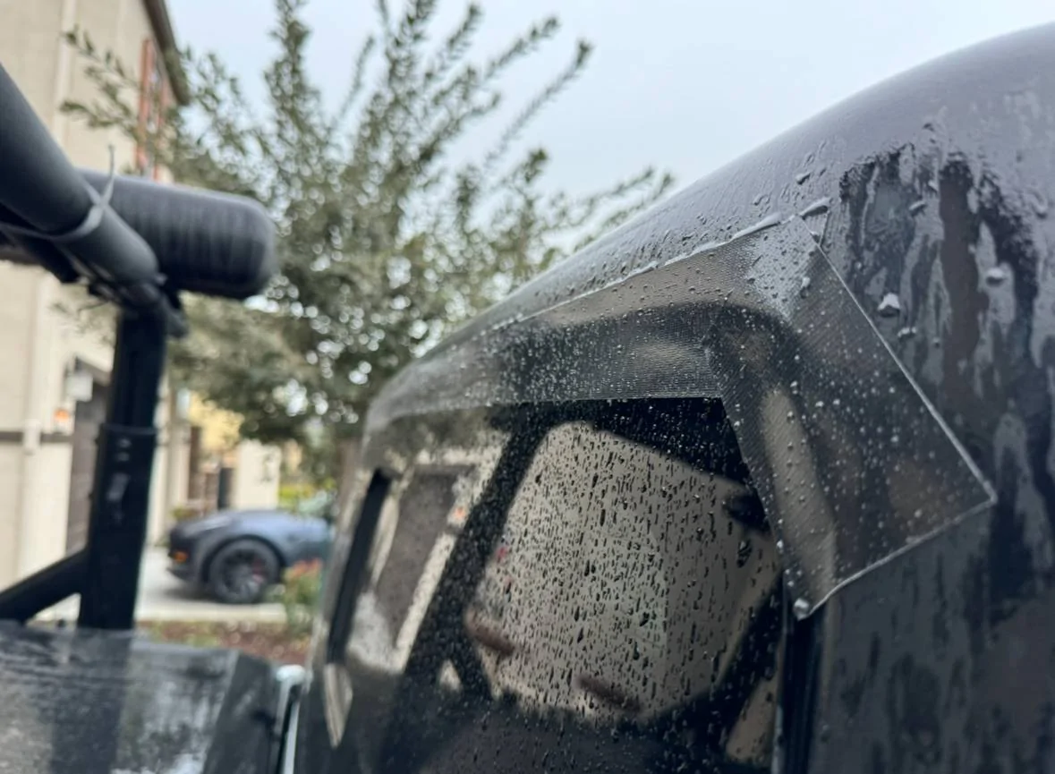

I tried the silicone vacuum tube as well as a couple different diameter foam rubber seals, but my leak persisted. Finally put on a window weather stripping (rubber moulding). It doesn't appear as clean without it, but it won't leak now. I sealed it across the top with some silicone sealant.
I bought mine through GT Glass. Similar product may be avialble elsewhere. I searched on Amazon, but a Google search took me to GT Glass.
https://www.gtglass.com/pages/search-results-page?q=m25
I got the 25mm, which looks just fine. I think 19mm would be too small, as it won't cover the gap and sit flush at the top corners.
recently experienced leak and out of warranty, thanks for this. I'm waiting on the molding. In the meantime gorilla tape lol
Jeep Gladiator 2020 Gladiator rear window leak (so far i suspected the actual small opening window, but actually it is entire top of the window) IMG_7177
Very functional! Mopar should just put a part number on a roll of tape and refer to it on a service bulletin. Maybe even just include it with every JT.
