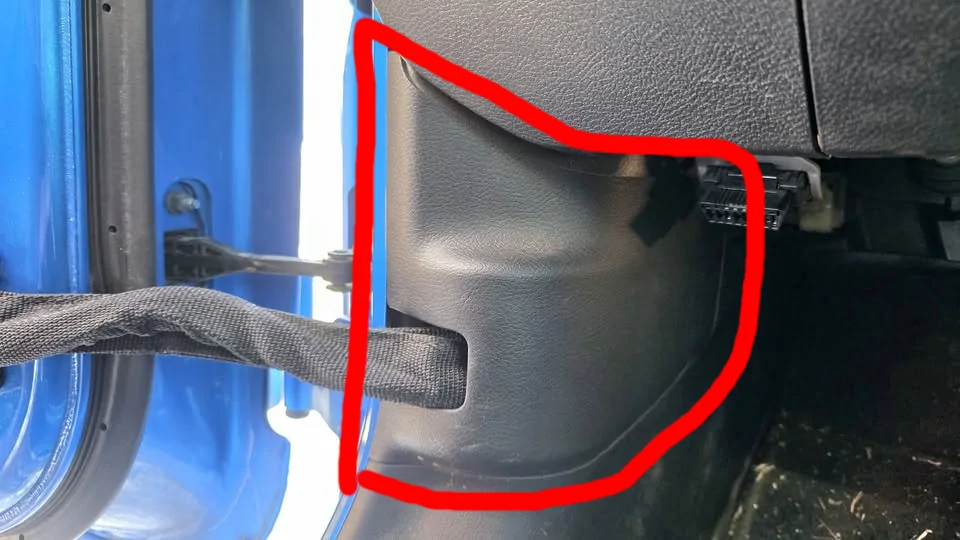

  3. Drivers window and mirror switch both do not work as of recently. Fob works, other switches work. (I think it's the door harness or connections but the dealer couldn't find it in the two days they had it!! )

Your drive side window and mirror issue is very likely just a simple connection problem. Unplug, and re-plug these where you are certain they seat firmly together. Now if you have had water on the cabin floor, moisture can do some really funky things anywhere in the electrical system. And of course if submerged connections even briefly, they will indeed give you grief later. Unless thoroughly dried and contact cleaner spray suggested too. But in typical situations with pavement only or not so messy/dusty/wet off-road driving, you just try unplug/replug. Your problem should clear up.
Also, if you have ever had the doors off, it's stupid easy to bend one of the pins plugging the electrical connector back together. That could mess up anything electrical in the door.
I have not looked on my 2025, but I believe they still have not fixed this. On a vehicle meant to have the doors on and off regularly, that is a horrible style plug to use.
Thank you. The previous owner had the doors off several times. I agree I told the dealer to check it.. I can do it but why but it seems dealer don't have any incentive to really dig into any problem with an aftermarket warranty. So I'll probably end up just taking the door panel off and checking it myself.
You do not need to take the door panel off to check that. Since the doors are meant to be removed, there is an access door to get to the plug.
Thank you!!! I'll check it out carefully. Seems like unplugging and plugging back in is easy enough.. just take my time to make sure it's all lined up and nothing bent. But if bent I'll see if I can fix. Thanks!!

Door harness, as someone has mentioned is checked a few ways. Hold the inop switch and shake, push and pull the harness at the door hinge area. It won't fix you problem, but it will tell you that you need a new harness or a repair. Since the doors have been off, a bent pin in the harness connector could be the problem it is under the foot well cover. You would need to look real close. Best to take a photo of both sides so you can zoom in. You can try flexing the connector a bit while holding the inop switch.
Door harness damage, probably not covered with warranty, normal wear.
Bent pin at the connector, not warranty. User error.
