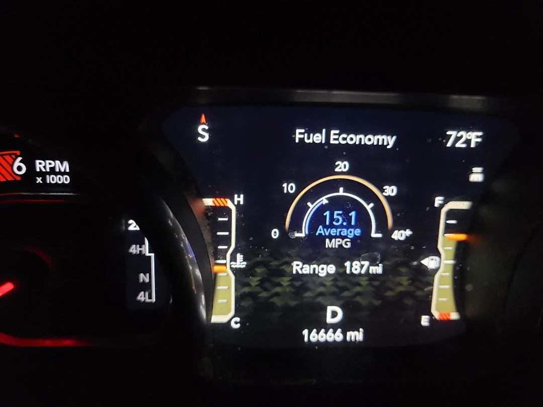

Before 8K miles was consistently getting 25 MPG. Now at 16K miles, 15.1 average after an 8K miles road trip over 60 days. Had an issue free experience until I hit 8K miles in June and now have plenty of issues from poor MPG (not even towing anything, afraid to at this point), excessive use of DEF (1 gal+ every 1K miles), power drop due to excessive oil temps, using a quart of oil every 1000 miles, engine surges 500-800 rpm on cruise control........
and what did the dealer say or do?

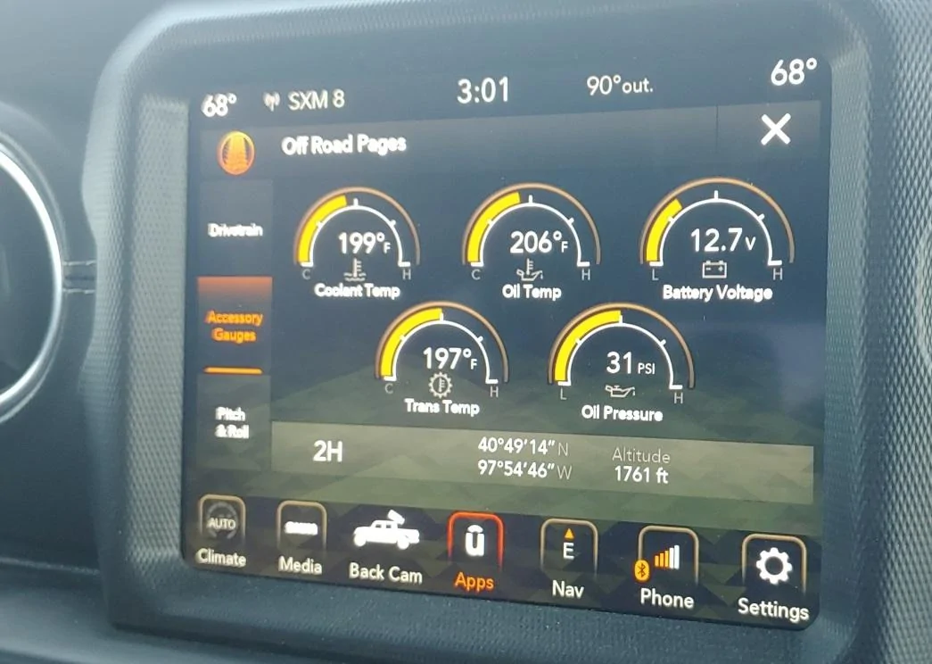

That axle isn't going to seize at any time. This is a known thing and as I've said a dozen times, in almost every single case the leak is small enough it won't drop the level of the lube to a level that would cause any real problems.
And the voltage is also NORMAL. These are smart alternators and totally different systems. Get used to the voltage swings. Welcome to modern vehicles with smart systems.
There's a TSB about that explaining how normal that is - and - a thread or two about it here as well. It's common, it's NOT scary or any sort of a problem. 12.6 is the voltage if a fully charged battery - so that means the system is handling the load just fine since the voltage is still showing fully charged. If it was lower than 12.6 then I'd think about being worried - but it's keeping up perfectly, working exactly as it should.
So the axle leak is a known thing and it's not a big enough leak to do damage (in almost all cases) and the voltage - stop worrying - it's normal on modern, smart systems. NORMAL.

Yes, it's NORMALY for a smart system. It is showing a fully charged battery and the alternator is handling things just fine. They put out ONLY when necessary - saves POWER, saves fuel. Alternators take a chunk of horsepower! You don't want that load when it's not necessary.
It's a known thing, there's a TSB, we've discussed it, etc.
The axle leak is annoying as heck, but it's not losing enough lube to do damage to the differential.
Here's mine at 12.7. After I took this pic it went down to 12.6 and then later jumped to 13.7 or so. It's been as high as 14.6

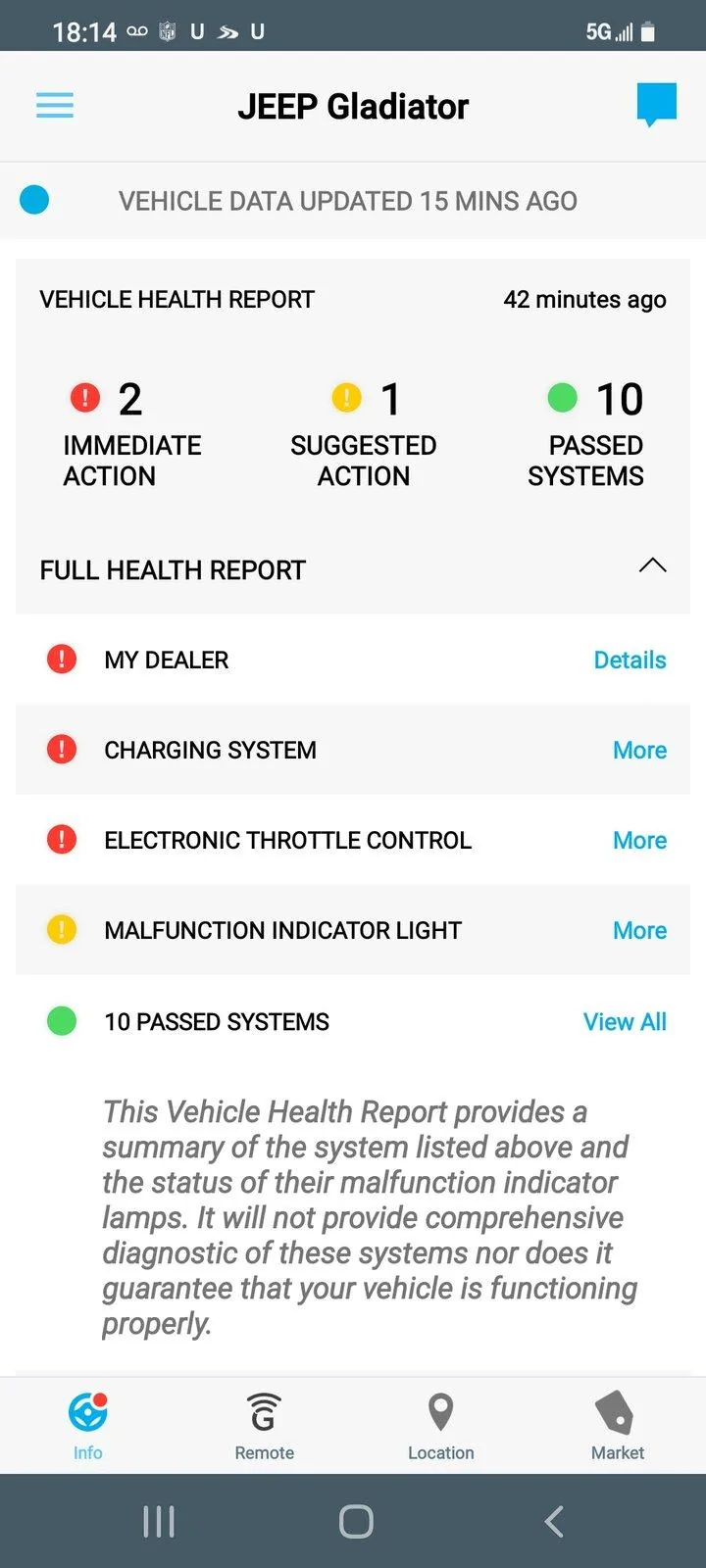

No I don't and I have had it looked at by 3 dealers. The same from all of them after they had it for 2 days without a loaner, the 3.0 TD JTs have issues that there no information on and there are no codes to investigate. We'll I do get codes for Throttle position sensor and charging system all the time but they clear when I get to dealer in the next few days

Time to do what I do - OBDLink MX+ AlfaOBD or Jscan, phone or table. Next time it acts up, create a log or look at the codes and then look the codes up on the web.
