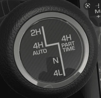

Here is what the transfer case shifter looks like AND a decent video on what Selec Track is all about.
40,496
54,011
I still do not understand why Jeep would limit availability to the tippy top upper end of the Gladiator line. It's almost a safety feature in most of the country with any slick roads or serious hydroplaning on a regular basis and ignorant people who don't understand the nuances of 4WD are the very people who NEED this kind of thing the most.. IMHO limited slip at the very least ought to be on every one of them.
Thus the reasoning behind my searching the whole country for a reign JLU with that SelecTrac transfer case!
My wife - what's this lever for?
Don't worry about it - shift and drive as usual.

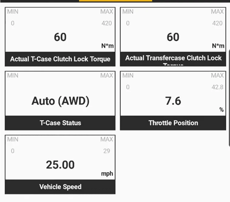

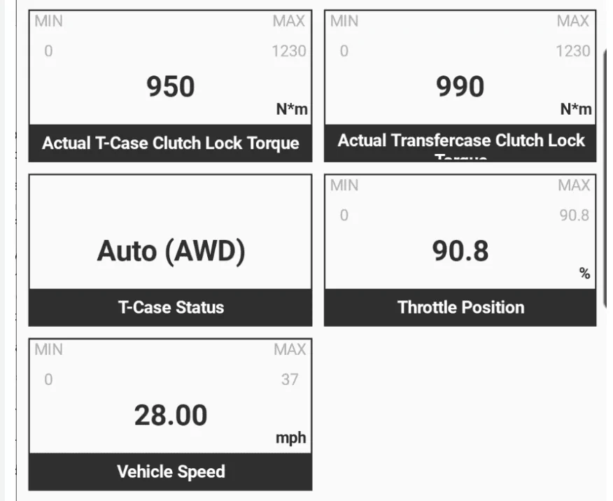

The difference is with the Rubicon you have front and rear locking differentials, I am not sure how this effects the clutch pack vs the true lock transfer case.
Rubicon still gets the clutch pack transfer case if it's got the 4H auto position.
Proof is in the JSCAN displays of NM pressure applied to the clutches.
The 4xe output is a bit higher than the diesel as I recall as far as torque and HP - and you can't buy a 4xe without these transfer cases - including Rubicon. We own one.
RUBICON ->
AHHH, real, actual data showing a difference... AND, NOT just an opinion.
