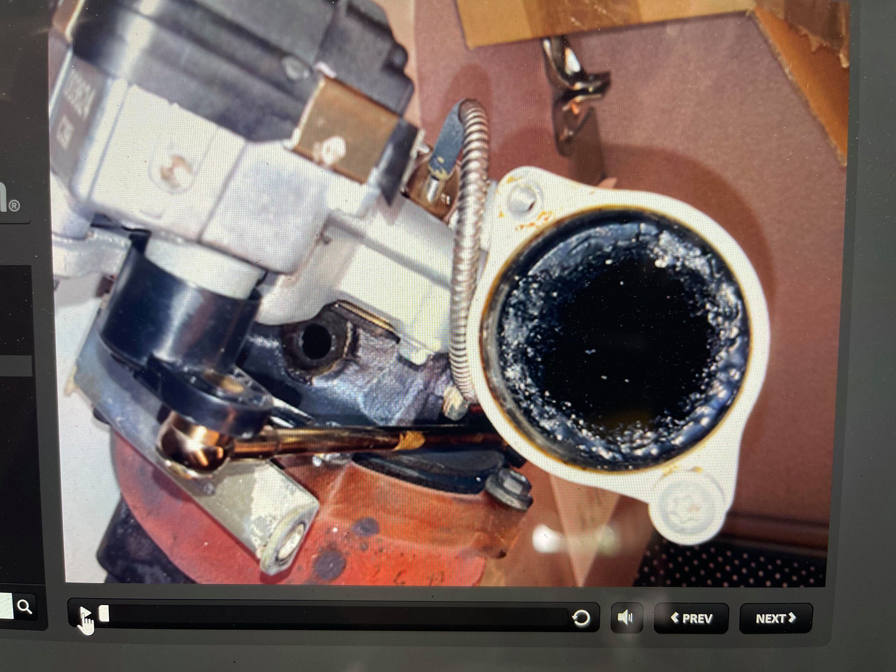

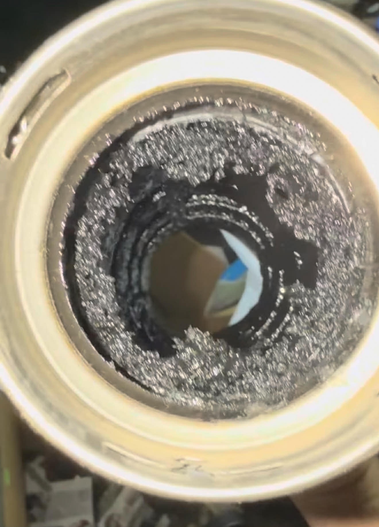

There was a guy on one of the social media groups that posted this image. He didn't reply to any of the questions. All we know is that he had deposits in the turbo resonator tube. He said he was running Amsoil, but he didn't say when he switched over or which Amsoil he was running.

It's a good oil for the Cummins and 2nd gen EcoDiesel, but I wouldn't run it in my Gen 3 EcoDiesel. We've seen the turbo that was taken off a Gen 3 test mule with a CK-4 oil. The deposits were a big enough concern for Stellantis to change the oil specification and send memos and a video to the service departments letting them know the concern.
Is that coming FROM the turbski?! Wholy shit!
Yes, you're looking at a factory turbo that came off an EcoDiesel test mule. The compressor outlet temps must be super-hot.
