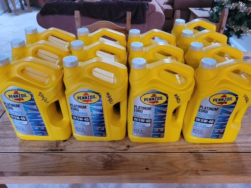

I've also bought lots of QS back in 2021 when they were $15 a jug and been running it since first OC.
Back during COVID, I bought 13 jugs (5 quart in size) of Platinum Euro for $14.25. That comes out to $2.85 per quart. I bought enough for a 5-year supply.
