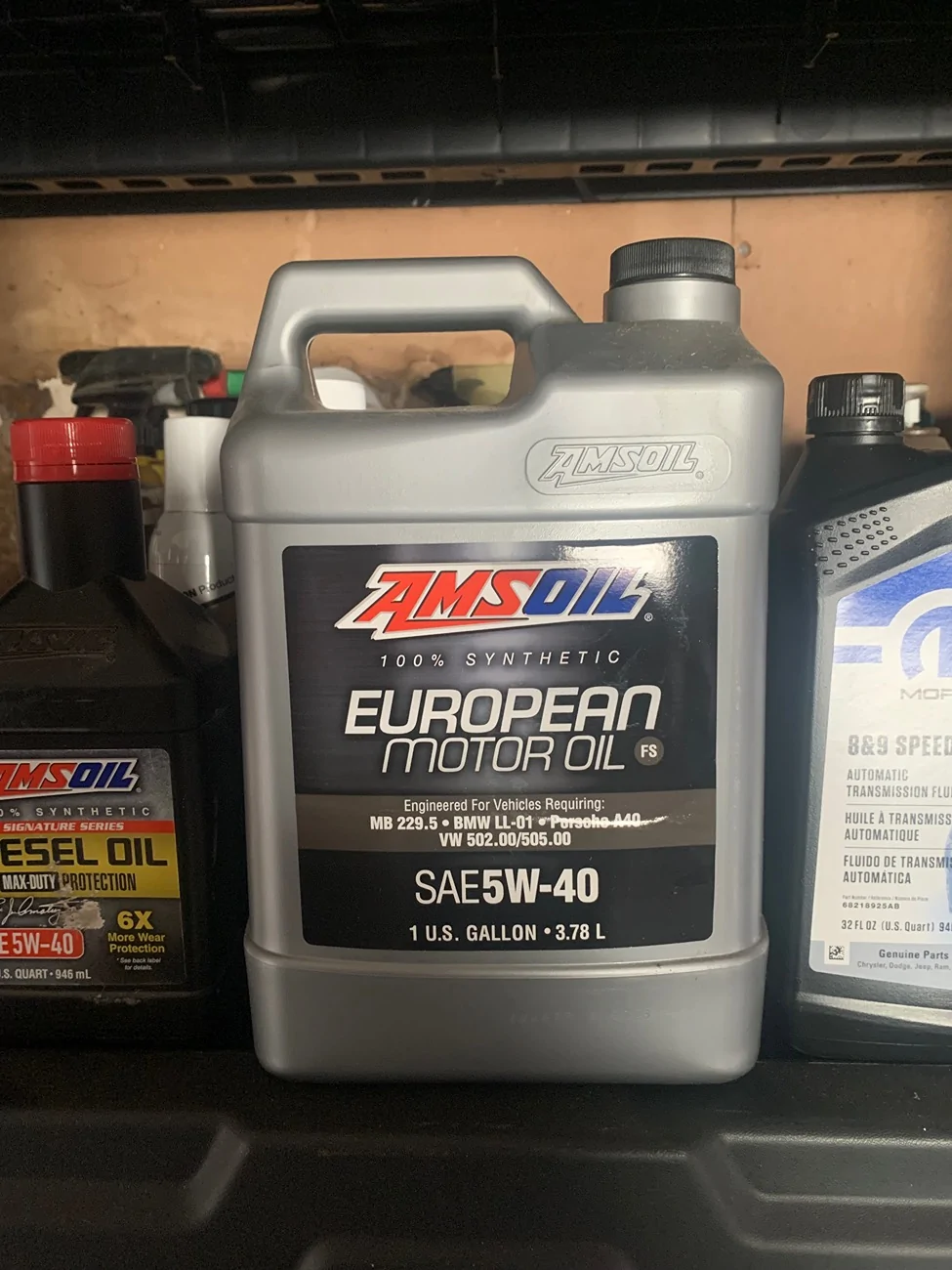

I ran this in the JT and the JL until the reliability upgrades were performed. I talked to Amsoil rep and he said the current oil is “Much better than euro formula”. His words.

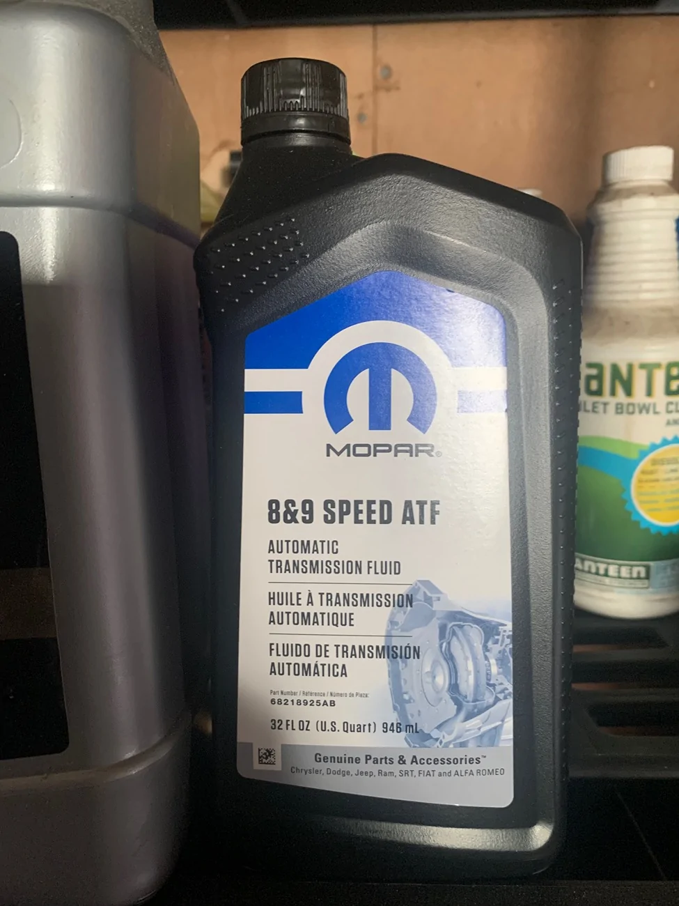

Transmission fluid used. I got my filter and fluid off Amazon for about 1/4 price of dealer quote. Thieves.
Reused pan gasket.

I like the Mityvac trans filler, but man, they are proud of it! Not sure its in the budget for a fluid change. Did you do the factory proc of warming the trans. first. I need to figure out a way to put fluid back in

Yes on the temp. I set screen to Off-road Pages and watched it closely.
I also bought one of those cheap pumps that goes in a qt bottle. It spit back more than went in the trans. The valve body is right up against the fill hole on the ZF. You really need a tight seal to be efficient while filling it.

With manufacturer’s moving away from dipstick tubes I figured the fluid install kit is a long term investment.

What else would he say?
I guess he could have told me to keep running the Euro?
I would think pics of pan and pick up tube screen speak for themselves.
