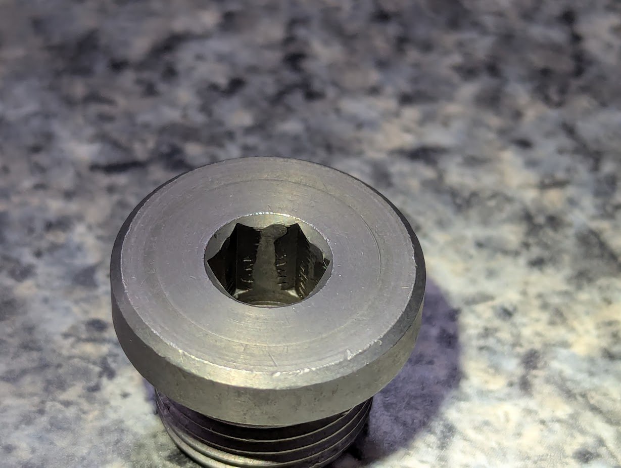

I had a center hole drilled through a few transmission fill plugs. The hole is sized for the clear hose on the hand pump. This allows for easier pumping without needing to hold the hose end.
I've got three vehicles that use the ZF transmission, so I've gotten pretty good with the process. It makes it easy if you measure what comes out. So, if 6 quarts come out, then you know 6 quarts goes back in. I added the PPE pan to my 2015 and 2020 Ram, which makes the drain and fill that much easier. I'll eventually do the same for the Gladiator.

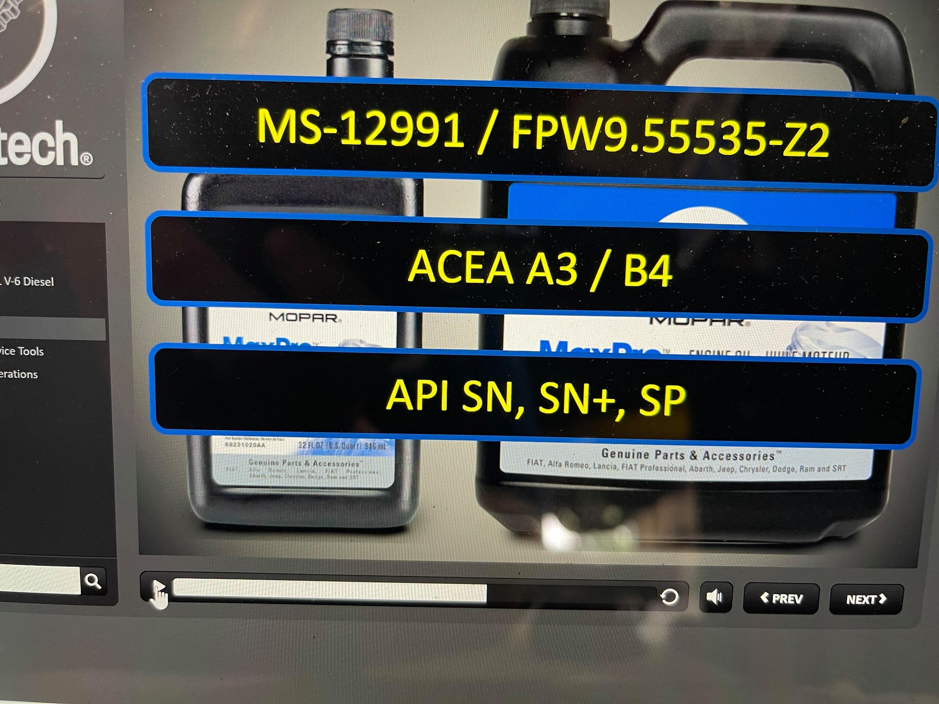

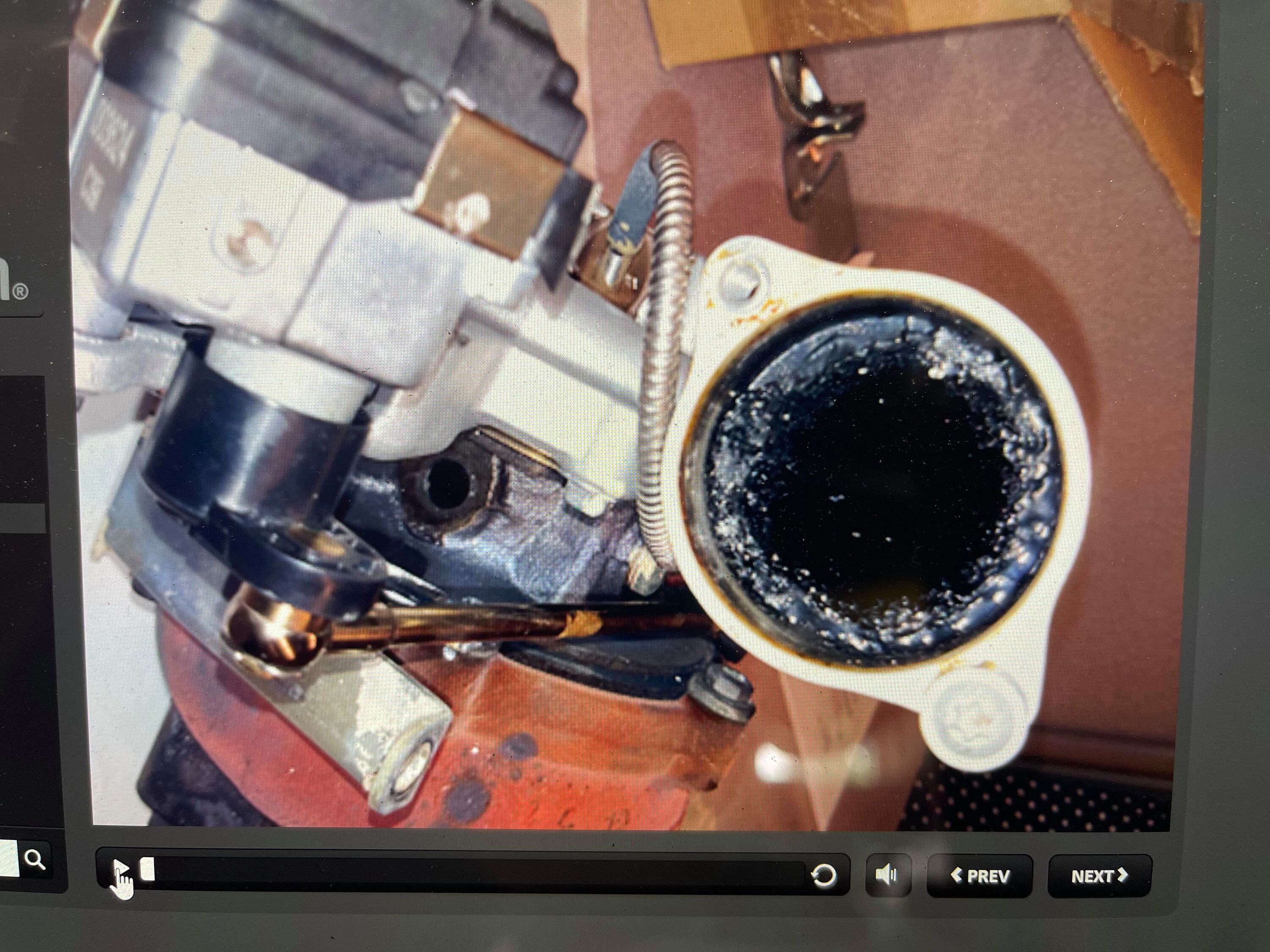

The only reason Stellantis moved away from the Gen 2 spec to the Gen 3 spec was due to deposits forming in the turbo. So, I would like to see pics of the inside of your turbo, please. ;)
These are the pics that came off a test mule, and why Stellantis reversed course on the spec.
I will see what I can do.

Hey, everyone. I was able to get more clarification on the MS-12991 spec. An engineer for Stellantis said that deposits can form on the outlet pipe of the turbo charger. This happens due to higher turbo charger compressor temperatures on the gen 3 engine. According to the engineer, the 13% volatility CK oils aren’t designed to operate at the higher temperature range we see in the Gen 3 EcoDiesel. In other words, the Gen 3 spec oil is backwards compatible and can be run in the Gen 2, but the Gen 2 spec oil can't be run in the Gen 3.
I'm guessing that some Gen 2 spec oils are suitable for the Gen 3, but we just don't know for sure how those oils will perform in the Gen 3. There's something about the lower volatility A3/B4 oils that protects at the higher operating temps.
Does that change your oil recommendation for a gen 3 at all?
Last time I asked, you had recommended this:
