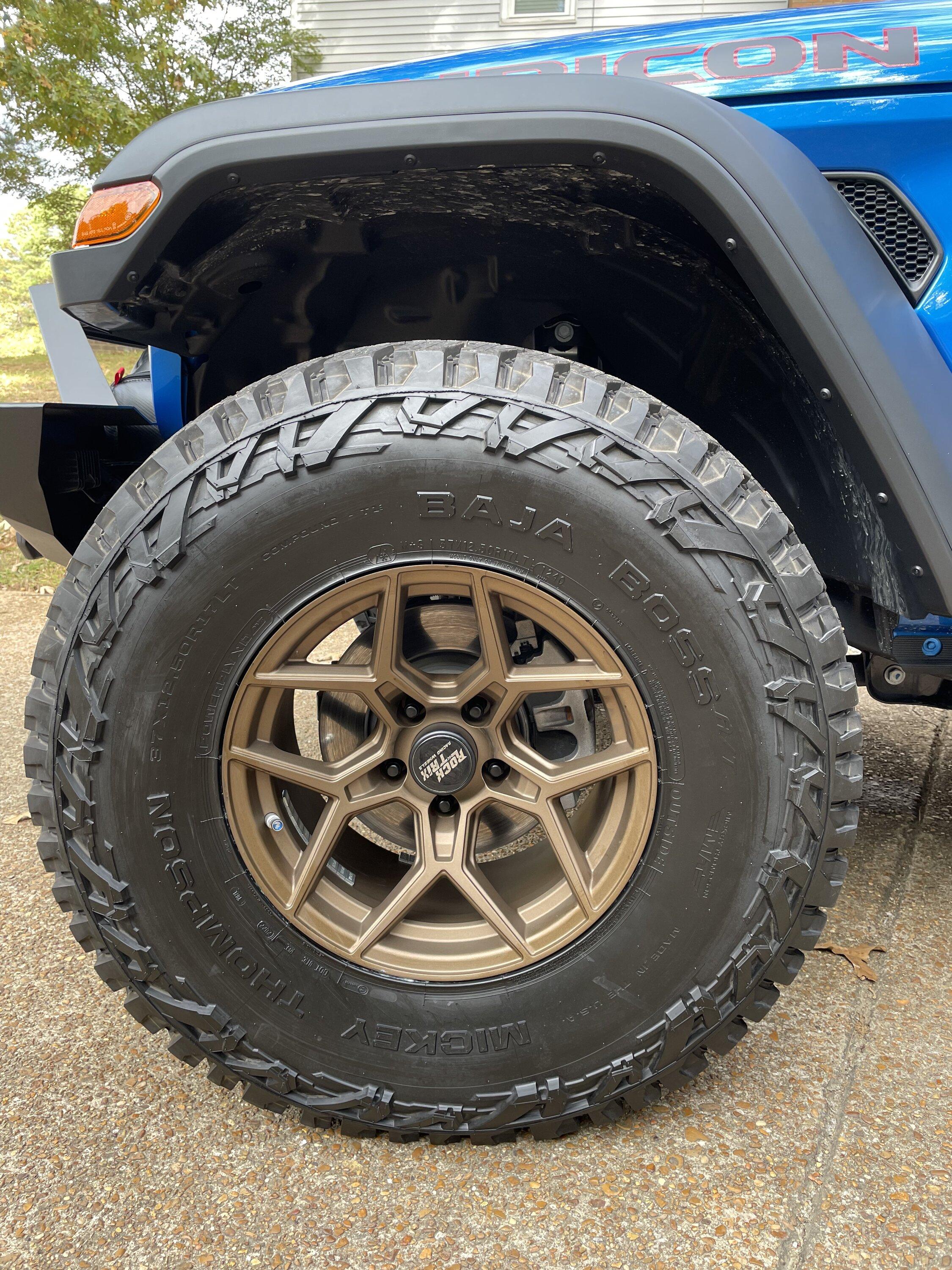

Goodyear MTR Kevlar 37x12.5x17 are one of the biggest 37s. They will not fit in the spare tire area - between the frame rails, even with zero air. They claim 36.8 inches and I think that is accurate. I have 4 of them. Here they are compared to the same size Patagonia MTR which I am using as a spare. It will fit between the frame rails.
Those are cool. I didn’t know anyone got as high as 36.8 in a 37x12.5. My MT Baja Boss A/T’s measure 36.5. I can get my spare in inflated, but not by much. Thanks for the post. It makes my decision to not go bigger than I have, since I want 5 matching for rotations.
