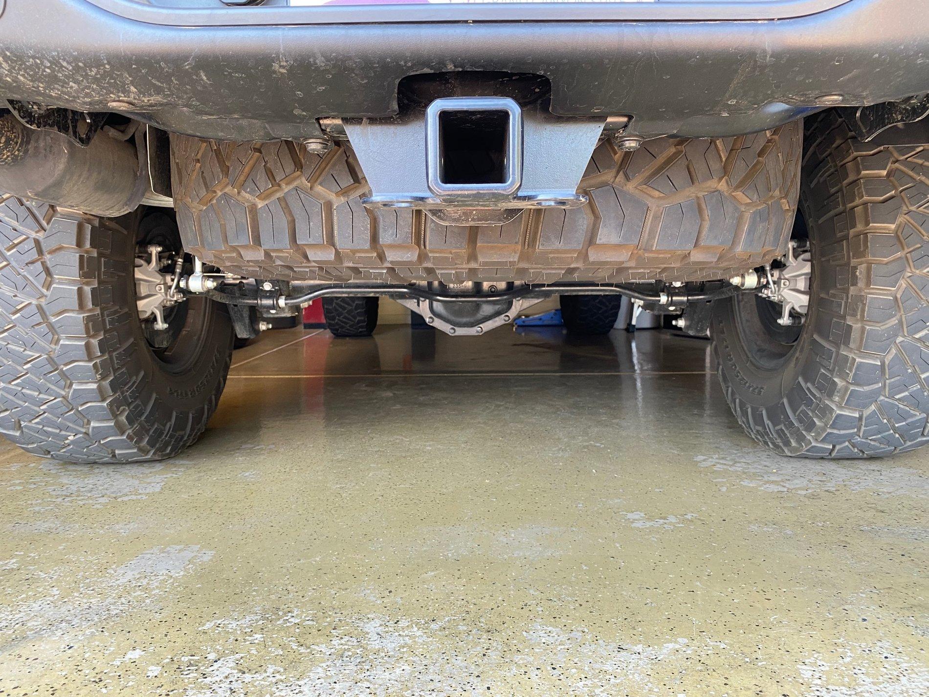

Brand new 37x12.5r18 Toyo RT on a Black Rhino Armory 18x9.5. Tire is aired down to 15#. Clears factory track bar by a fat 1/8". Gladiator has 4" Readylift for reference. Didn't have to bend heat shield.

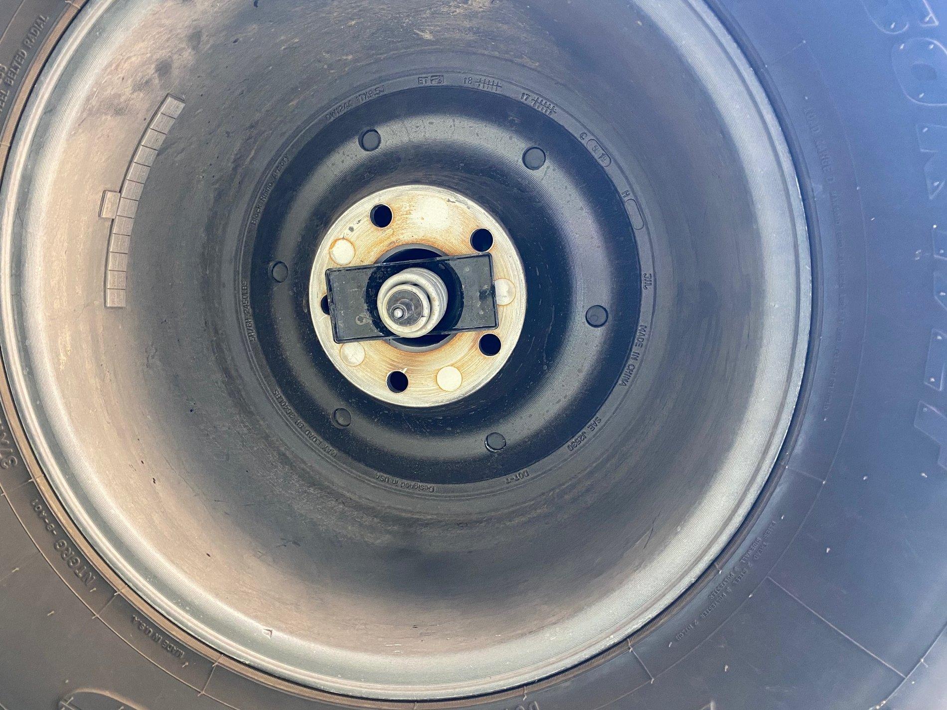

Is anyone running the spare on an aftermarket wheel? I have 35's on the Quadratec 1941 wheels. But, the 'holder' does not fit through the center of the wheel. Does anyone know of an alteration that would allow the 'holder' to fit - or any other ideas? I want to have the spare rotated through, thus the need to hold the 35 in the spare location. Thanks!
My 35" full size spare with after market wheel stows away under the bed of my Gladiator. Fortunate that the hub bore on my Fuel Off Road was big enough.

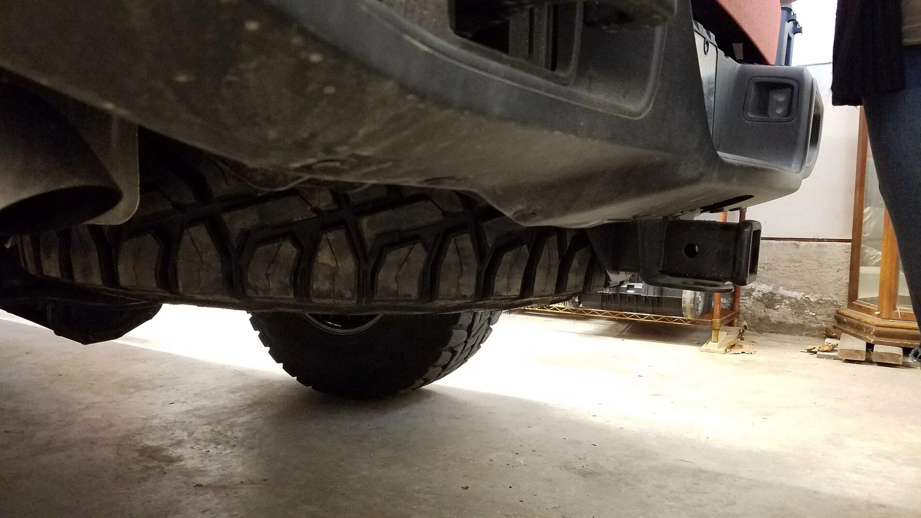

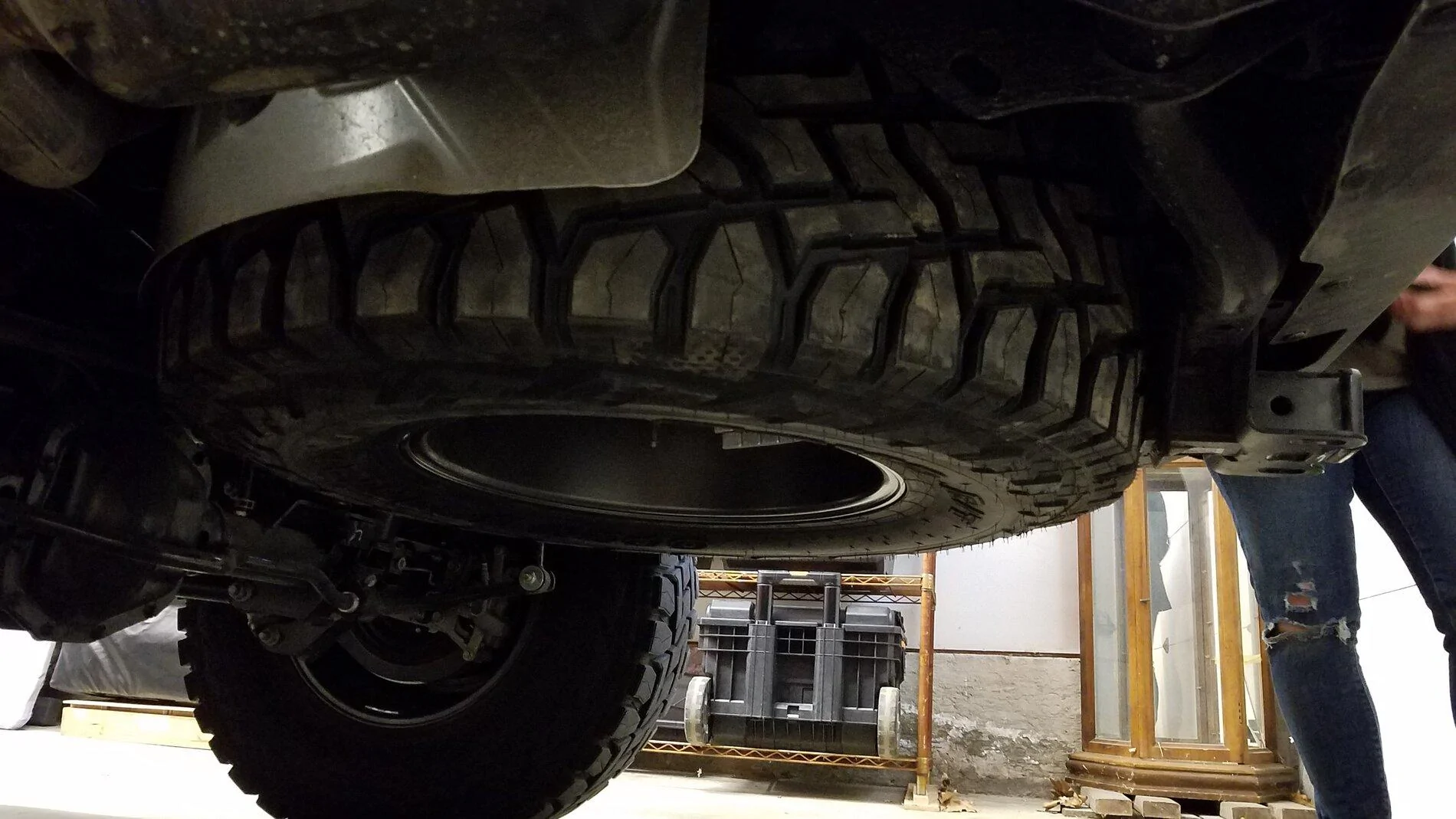

Hello... YES I have a 37" ridge grappler mounted and aired up. with aftermarket wheel as seen in picture UNDER / In the spare wheel . I just did a 5 tire rotation and had no trouble at all. She's close but fits without problem Check with whatever your choice of tires ACTUAL measurements are. the Ridge Grappler is 36.6" . ( 99% positive)
CONFIRMED. Fully inflated Nitto Ridge Grappler 37x12.50x17 with Pro Comp 69 17x9 wheel. Mounted outside of wheel up so hopefully it's protected. Hangs 2 or 3 inches below hitch but is level and secure. Snug - does touch track bar and back of hitch but I didn't have to force it in..

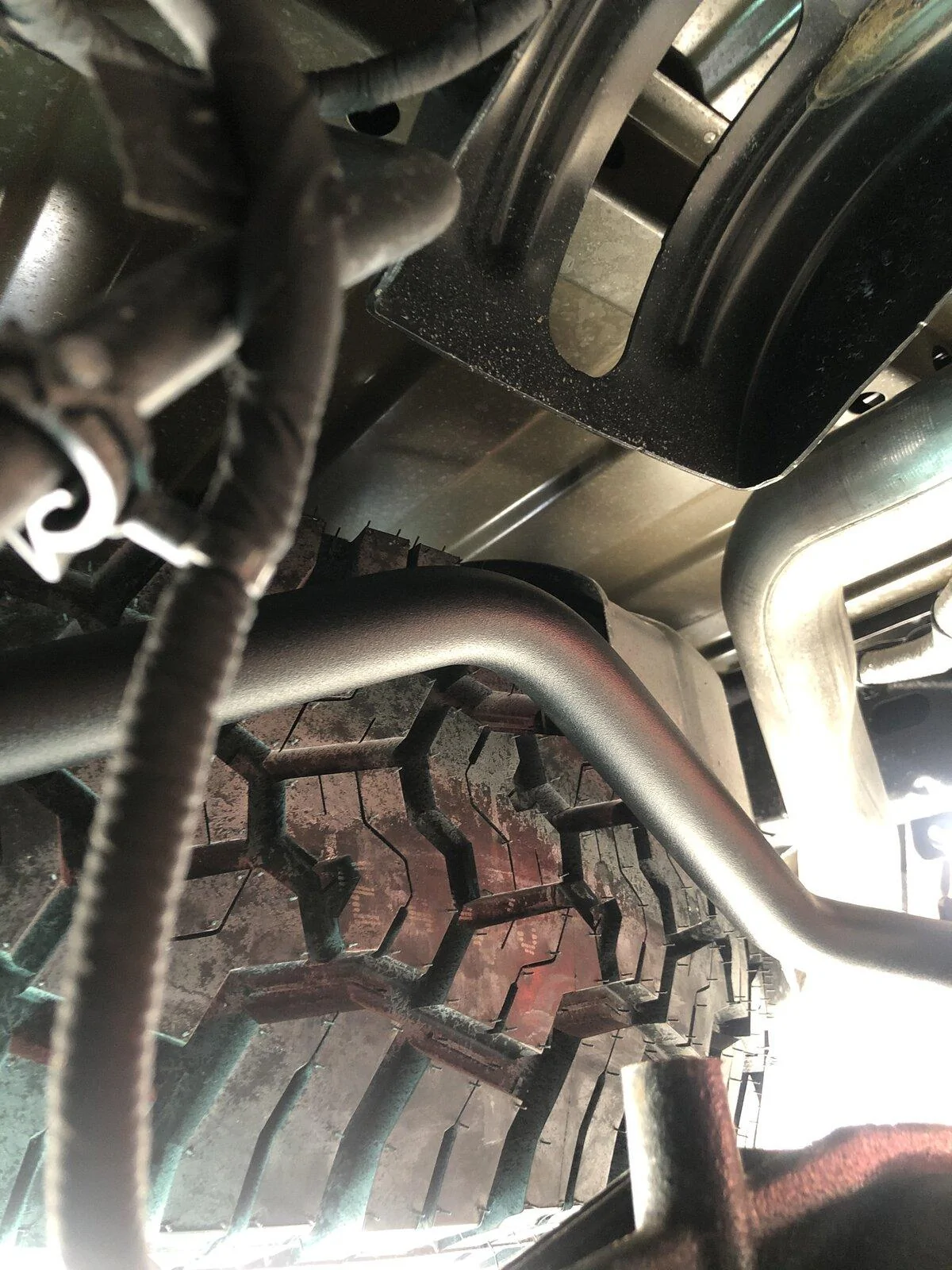

So I repositioned the Yokohama in 37” by removing the to bolts to the heat shield for flex and I got the new Clayton Off-road rear track bar. Fits up there really well. Track bar is another beefy-ass product from COR. Worth it to me...as the spare was rubbing when the weather got warm.

I have 5 of the same wheels ( Pro Comp Wheels 69 Series l; 17x9) and 5 of the same 37in tires and I didn't have to air down to get my 37in Nitto Ridge Grappler up there as a spare. My spare tire is touching the track bar and back of hitch but not much. Maybe when the temps heat up I should air my spare down some but not sure if it's necessary.

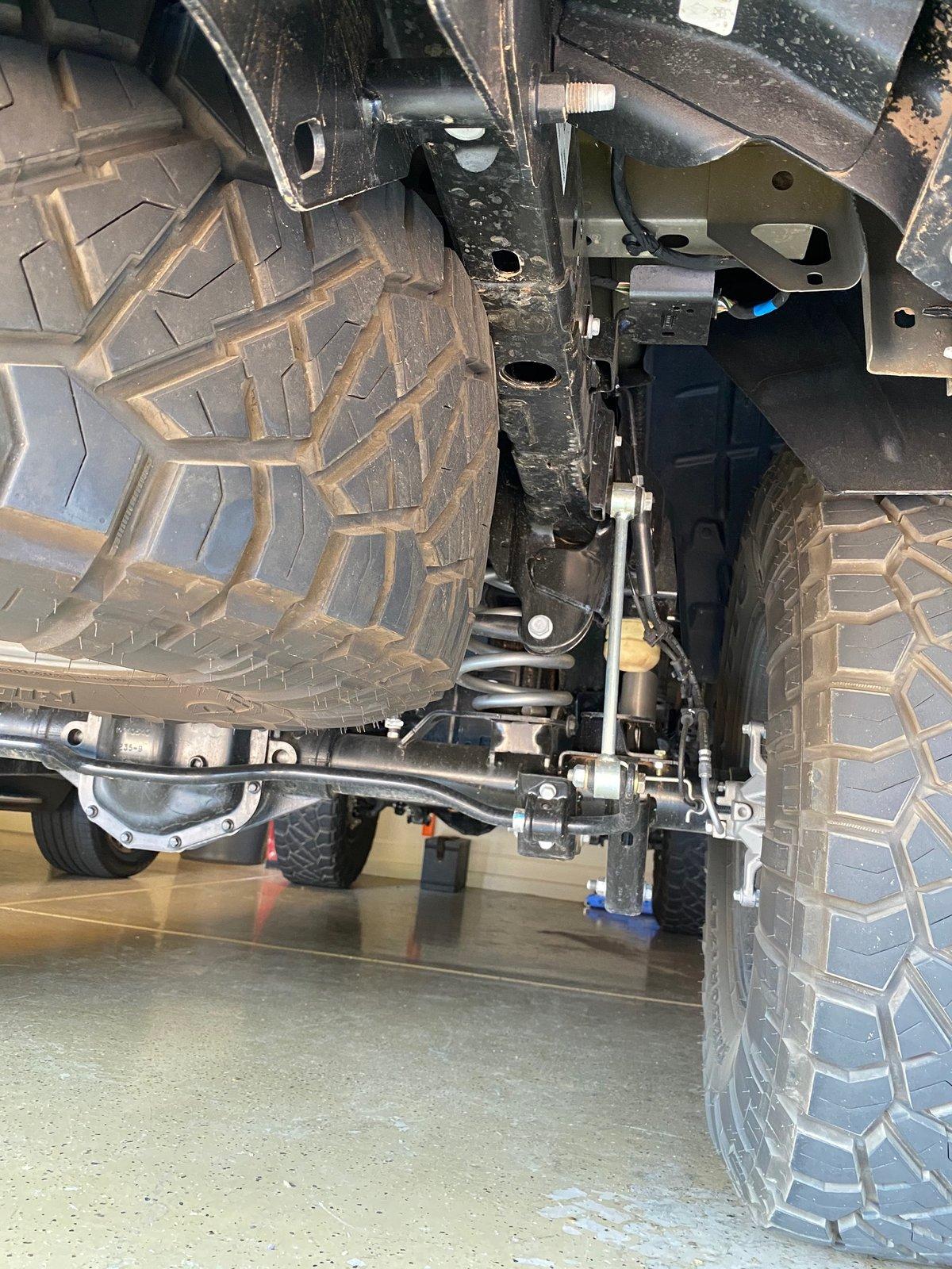

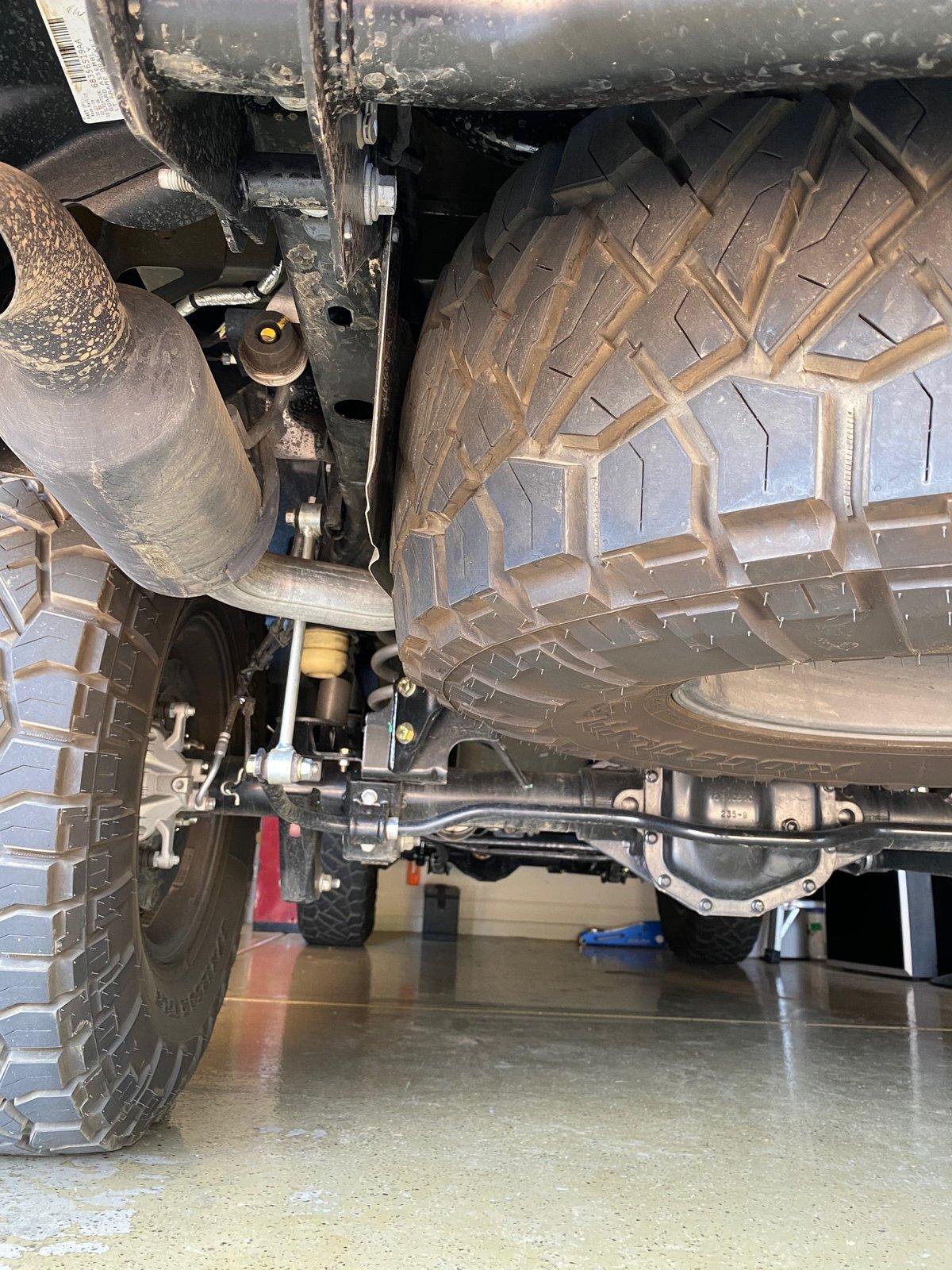

i went with a full set of (5) matching wheels on 37s. If you use the stock steel rim on a 37 tire then it will only work on the rear Axle. Not enough clearance for up front. I also got the COR rear track bar... money well spent if you have the cash.

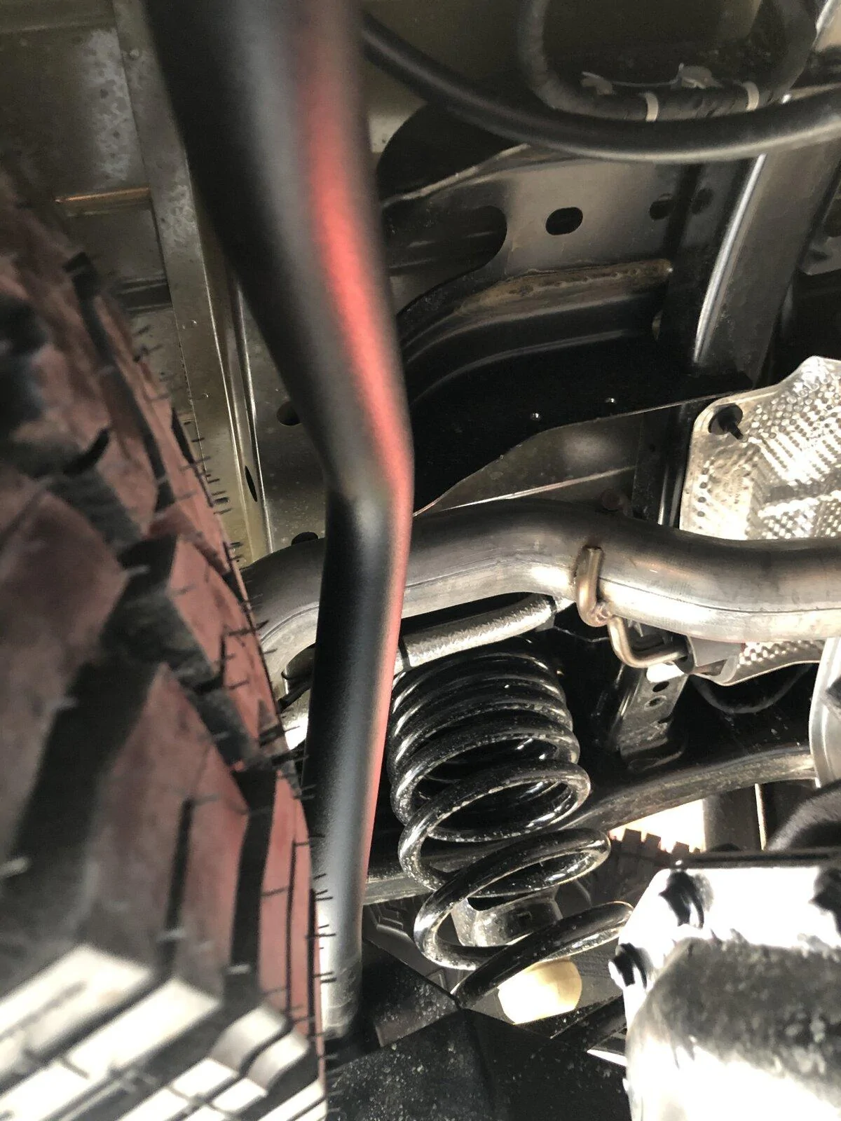

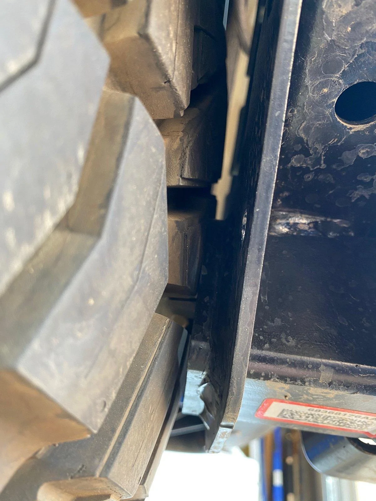

Hi. I'm no expert and I'm only speaking and trying to help. Only speaking on my own application. I just took these pics for whoever. It fits , it's solid, doesn't move, it's level, and has multiple points of contact to be secure. Just my 2 cents . I hope this helps.
Reviving a long-dead thread! I just wanted to say thanks for posting these photos. Very helpful!
