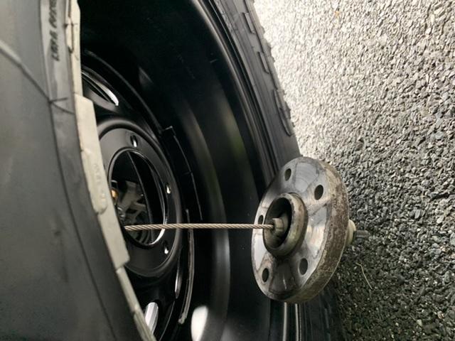

Well just tried fitting partially aired down 37-12.5 nitto trail grap On aftermarket rim with a metal Cloak 3.5 lift. First of all I needed to use a tire spacer because of the size of the center hole the larger tire. The bracket that fits in the hole and holds the tire in place barely had any grip, scary. Def not made for a big wheel. Second what is not being said is that even in the posted photos above, the tire does not fit between the frame rails so it’s off center and when tightened looks cocked because the frame blocks it on one side because the heat shield won’t let you center it on the frame. Also the lift Has a larger rear track bar than stock glad and tire is def right against it but not sure that will hurt. Overall, can you crank it up there crooked or drop it a bit untigtened so it looks level? Yea, but.......really? Mine is Up and slightly Un level but I have a spare I guess. Looking forward to more aftermarket options For glad large spares. Also going to consider moving heat shield to outside Of frame So it can Lock up tight centered.
Jeep Gladiator 37 inch spare tire 1D7F63EA-181D-4507-8ADA-F6067E58CA30
