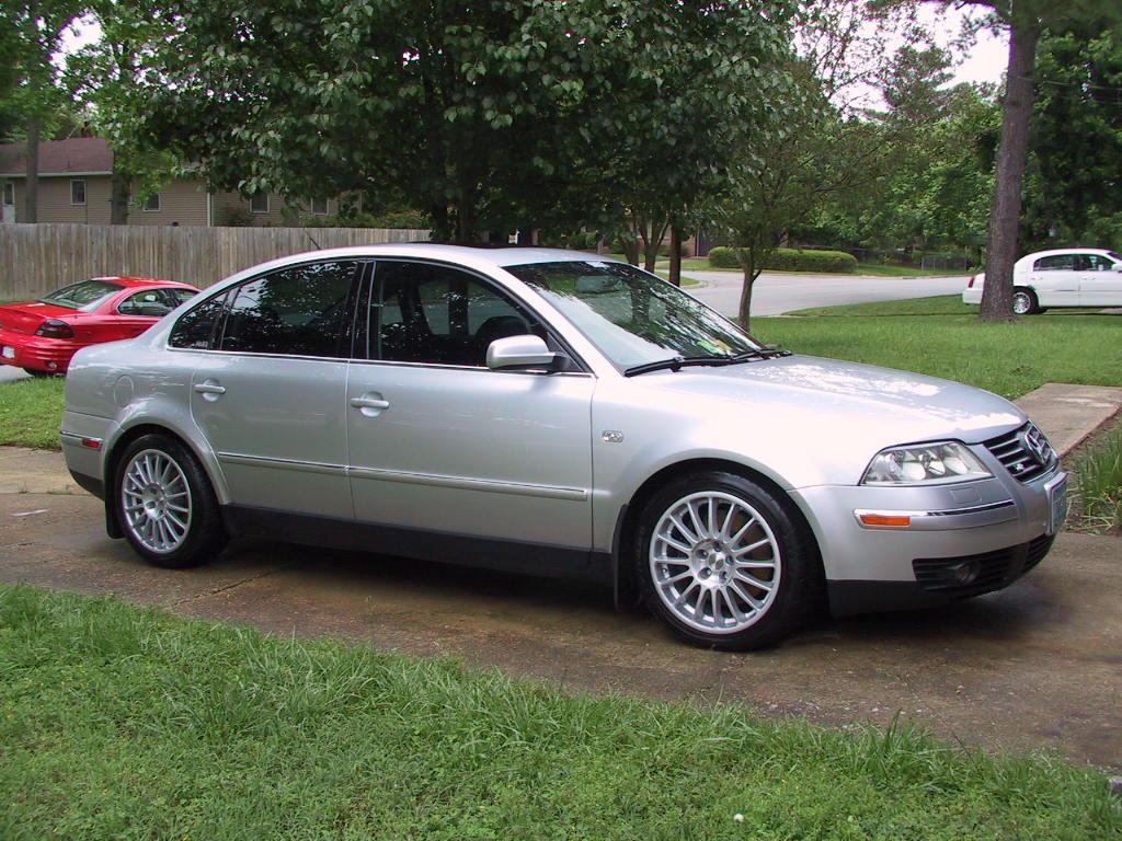

To make a long story short. Thru the BBB Auto line arbitration procedings, VW bought back my 2002 VW Passat W8. In the 14 months I owned it, it was in the shop 14 times, Had 32 separate and individual work orders written against it and was out of service for a total of 61 days. They did not attend the second arbitration hearing I filed after the first one. They decided to buy it back instead of going to court.

The BBB works. Just make sure you have all your documentation with you and don't go into the arbitration hearing acting like an azz. Be polite and to the point. Don't lie and always be straight fwd. my packet of documentation was over an inch thick. I could literally write a book on my issues with my W8. I large part of the issues I had were due to inept service techs that don't know how to do their job and had to rely on the VW Tech line.
The last 34 days my W8 was out of service was because no one knew how to work on the new engine. They had to have a tech from Germany, fly in to replace the drivers side, cam phasing mechanisims. He arrived the day VW wrote me a check for the buy back and I was in the service lot getting my personal belongings and wheels/tires off the car. The tech comes out all pissed saying he needs the car so it can get fixed. I told him to go pound sand as I am going to finish what I was doing. I of course took my sweet time! I never bought another car from that delership never again. This was the fourth car I had bought from them.
