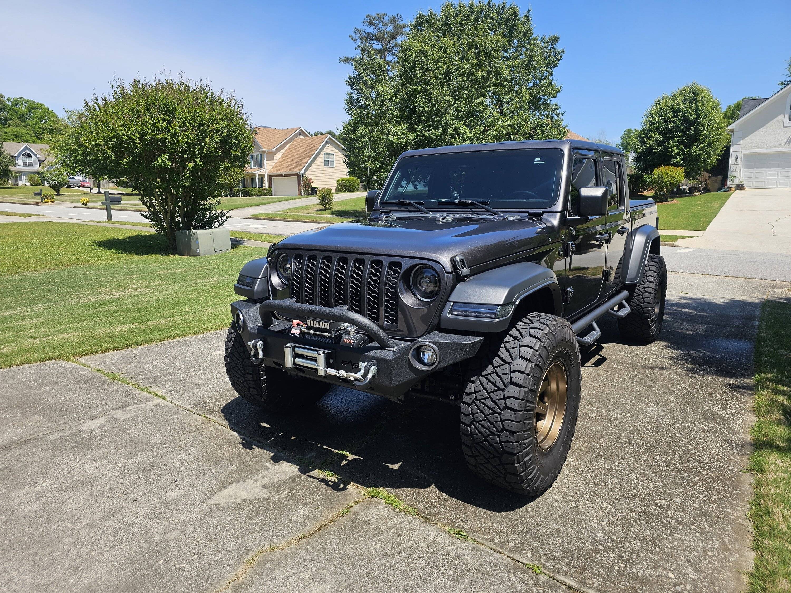

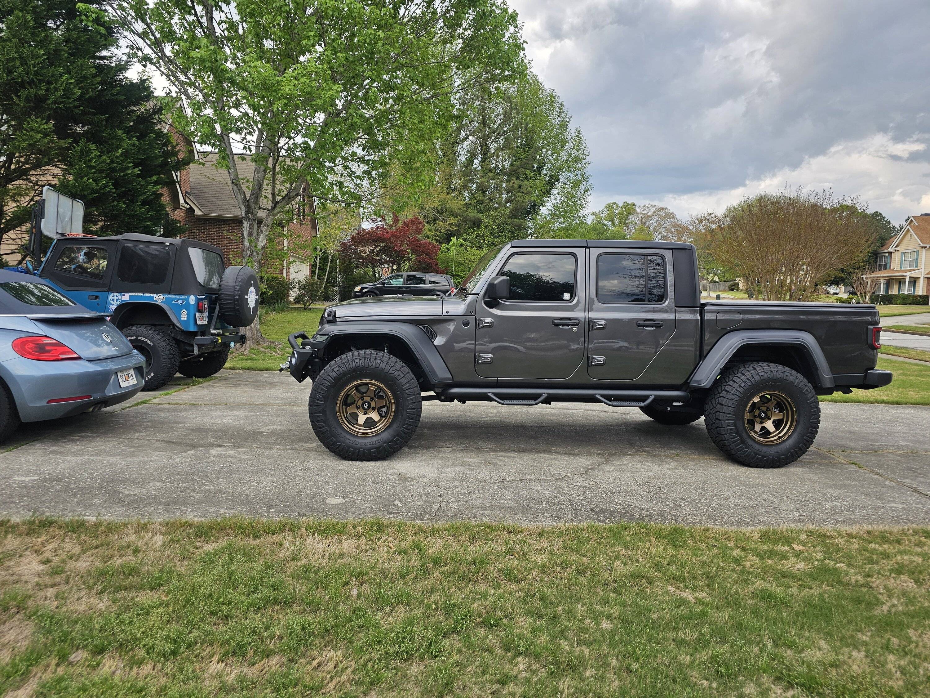

I bought mine used and it came with the Mopar 2" lift, 37x13.5x17 Nitto Ridge grapplers, steering stablizer etc. It rides very nicely. It is the 2020 Sport S with the Max Tow package. It is my daily dirver. I have a YJ for off road..

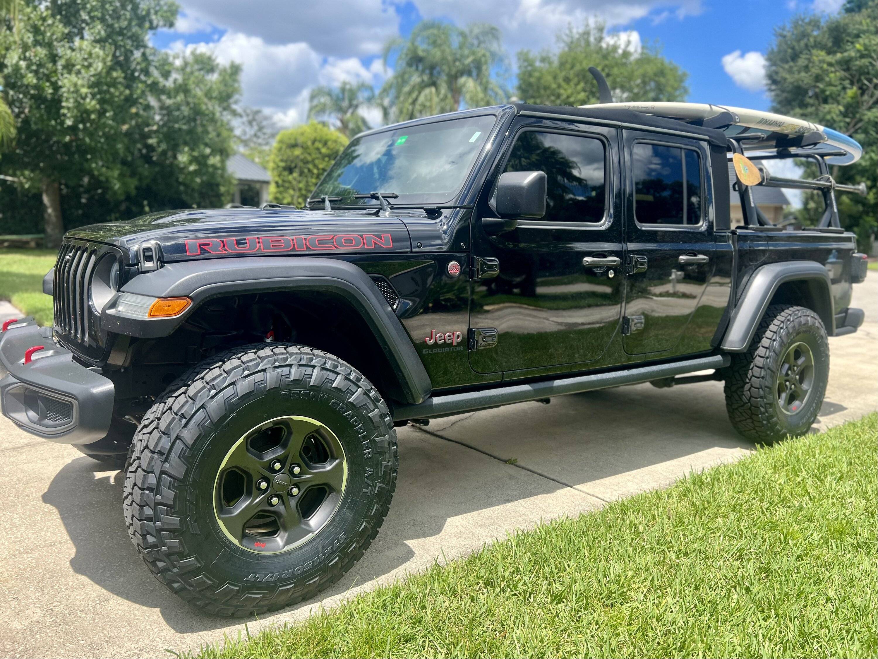

Rode my stockers till I had to replace them. Was torn between 35/37. I went with the nitto recon 37 by 11.5. 2 inch coil spacer lift. And a front adjustable track bar. I have a Rubicon and had planned on going to 4:88 right away. But honestly being in florida it hasn’t been near what I thought it would be. Mileage drop from 15.9 average to 14.5. Power is still there , still see 8th on the highway. Overall I’m very glad I went with the 37.
I love that man!! Those are the exact tires I've been looking at. Thx for those pics!!
