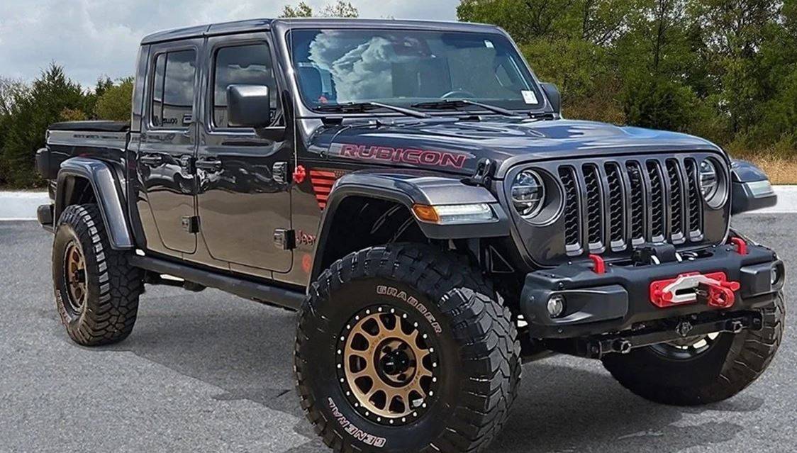

My wife says change the ride or sell it... Happy wife ... Happy Jeep Life. my 37's are just about ready to be replaced, i have a 3 inch Lift and its geared down 3 ratio. i Love my 2020 JT - any advice.? Vin: 1C6JJTBG0LL144543
On another note, despite my previous post...
That Jeep, @Charlie Downey , is an excellent looking JTR. It is beautiful. Thank you posting that pic.
