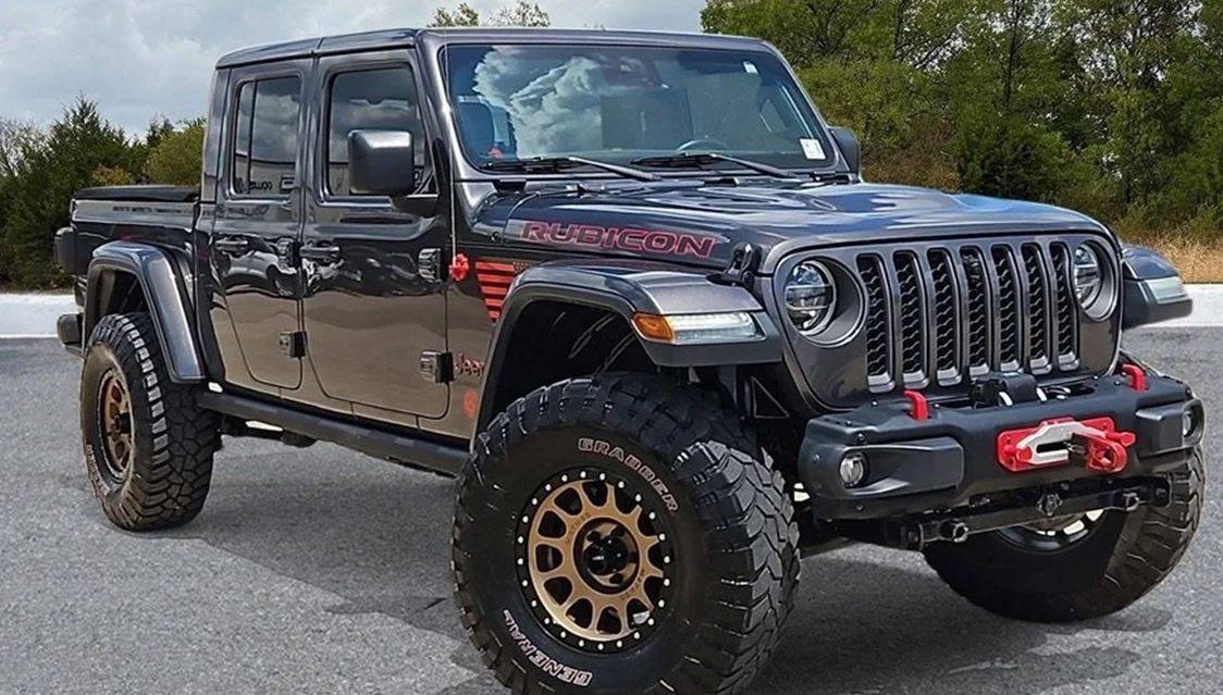

Rode my stockers till I had to replace them. Was torn between 35/37. I went with the nitto recon 37 by 11.5. 2 inch coil spacer lift. And a front adjustable track bar. I have a Rubicon and had planned on going to 4:88 right away. But honestly being in florida it hasn’t been near what I thought it would be. Mileage drop from 15.9 average to 14.5. Power is still there , still see 8th on the highway. Overall I’m very glad I went with the 37.
I too went with recon 37x11.50’s on my Mojave and getting same numbers as you are. https://www.jeepgladiatorforum.com/...con-grappler-37x11-5r17-on-2020-mojave.69183/

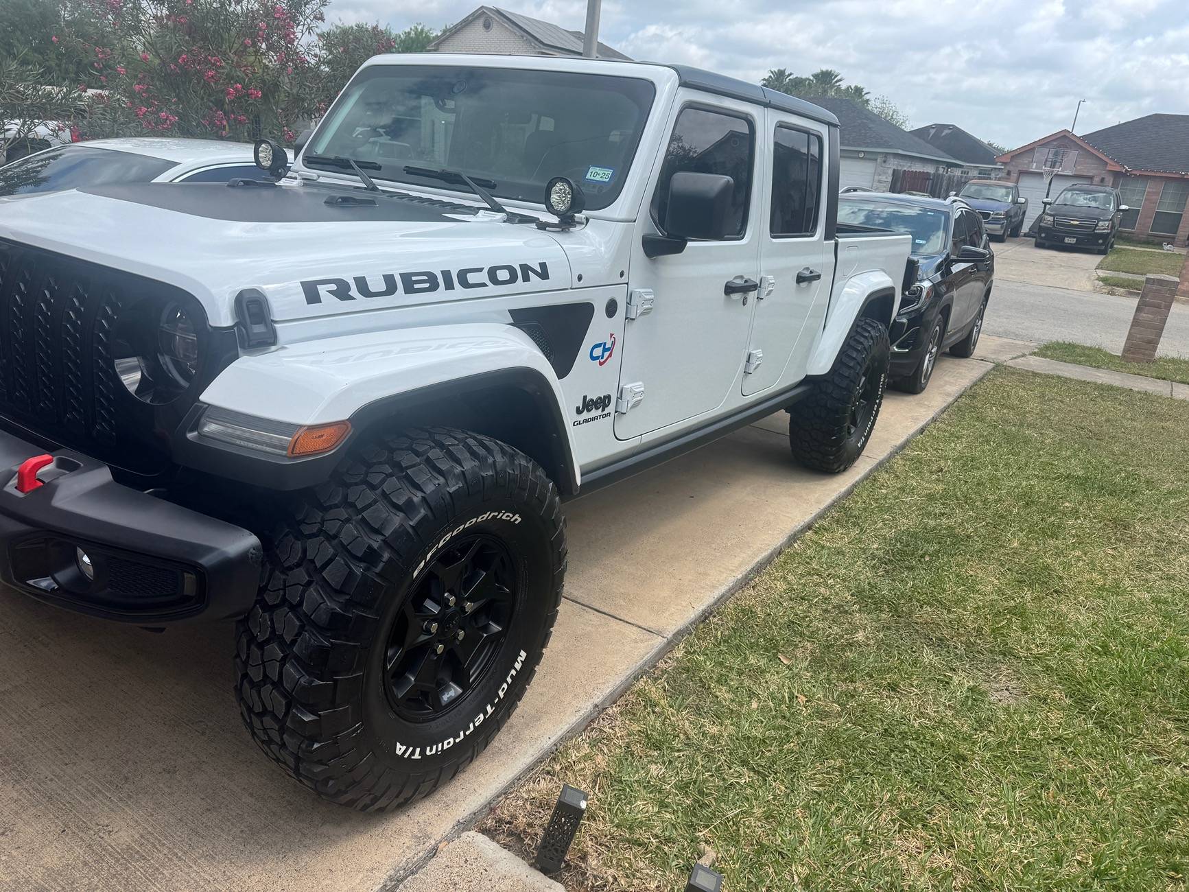

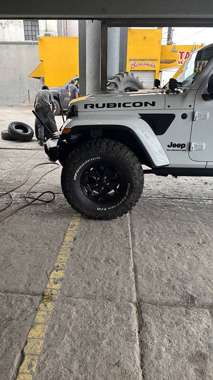

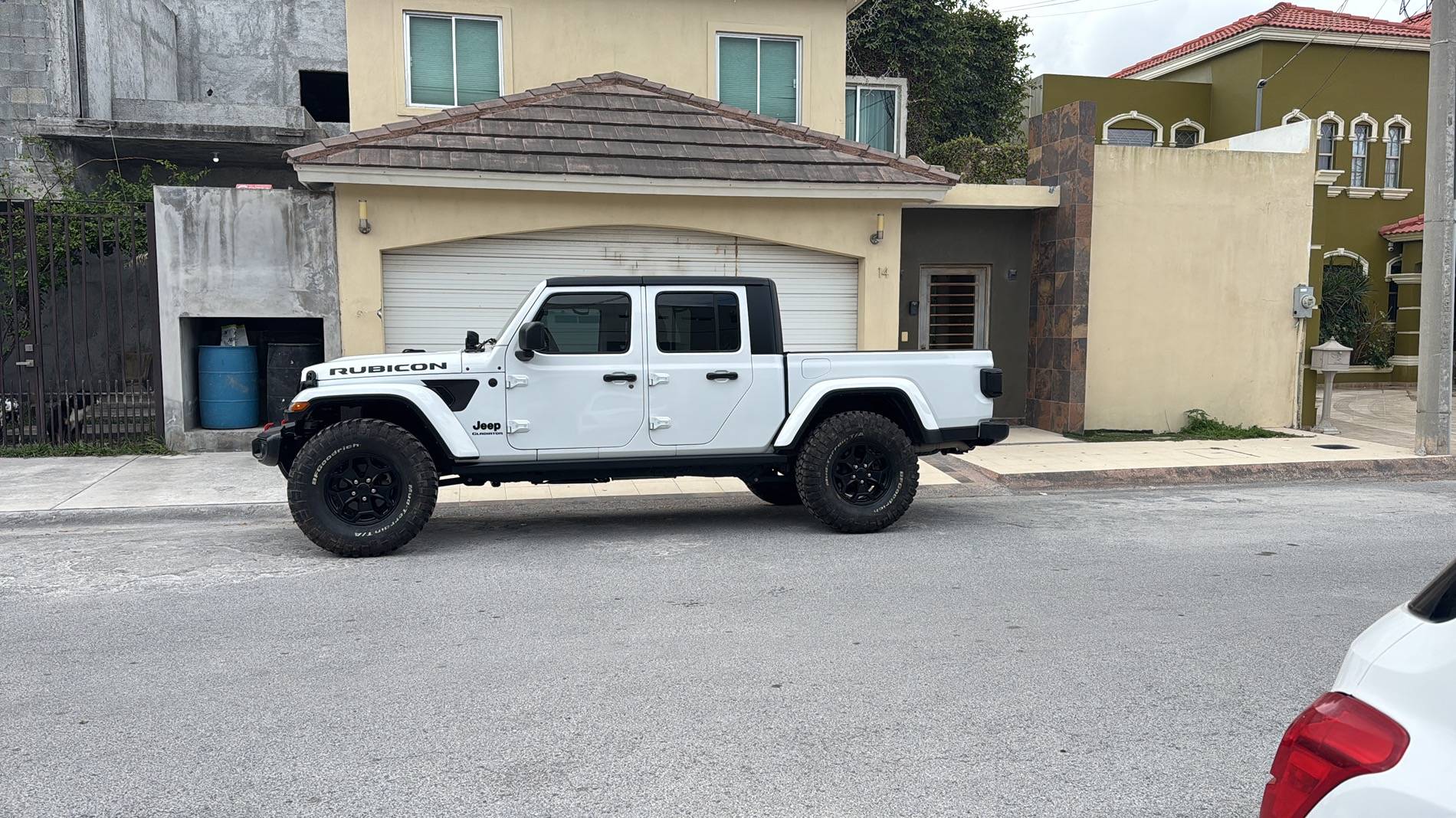

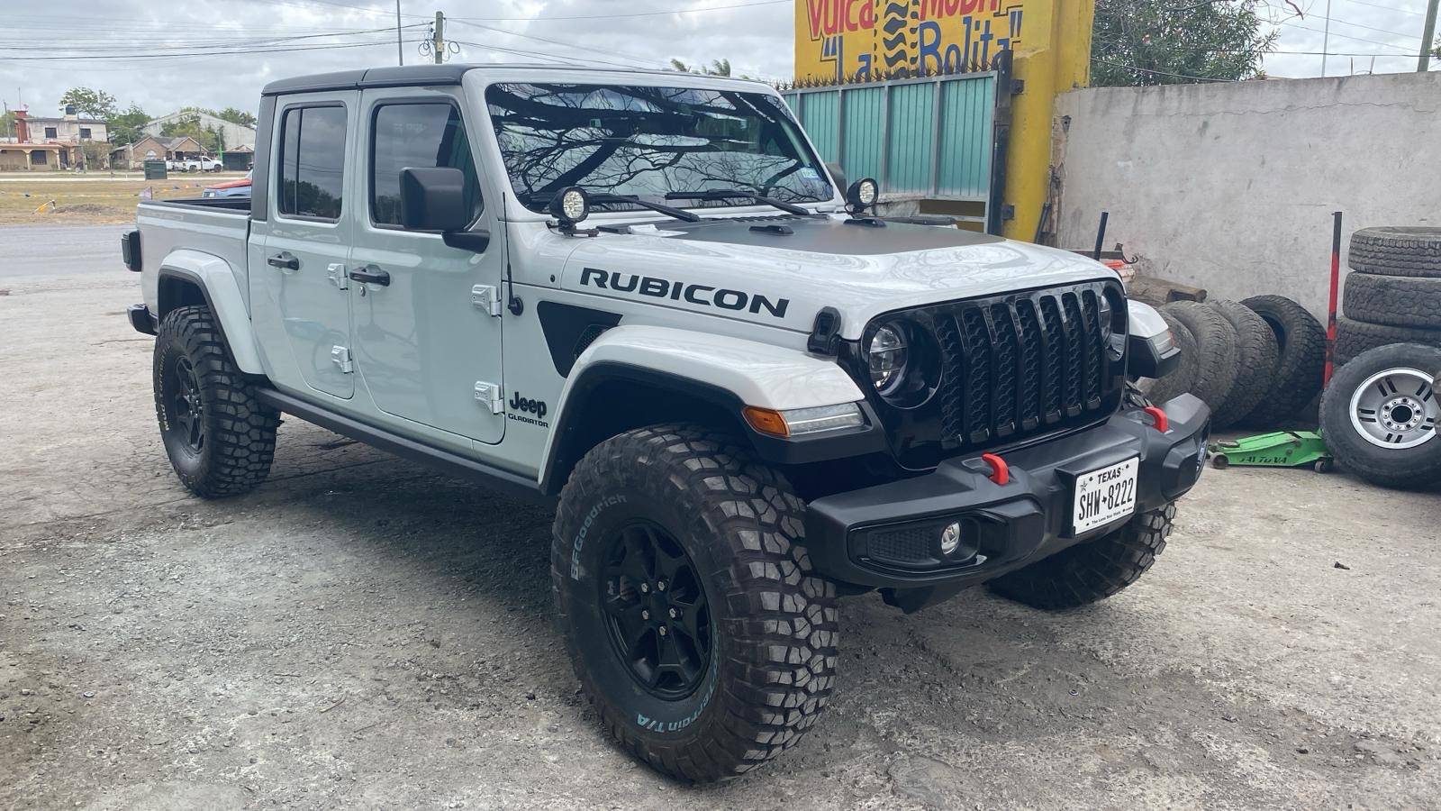

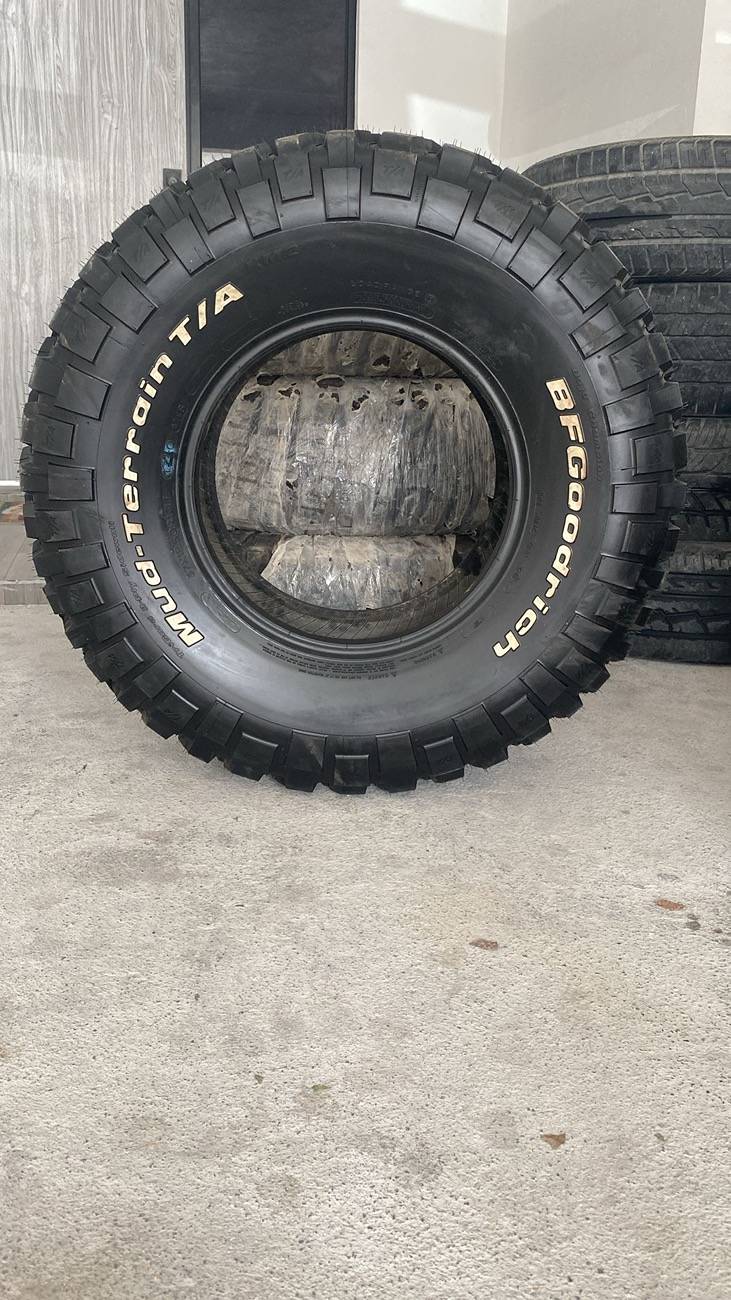

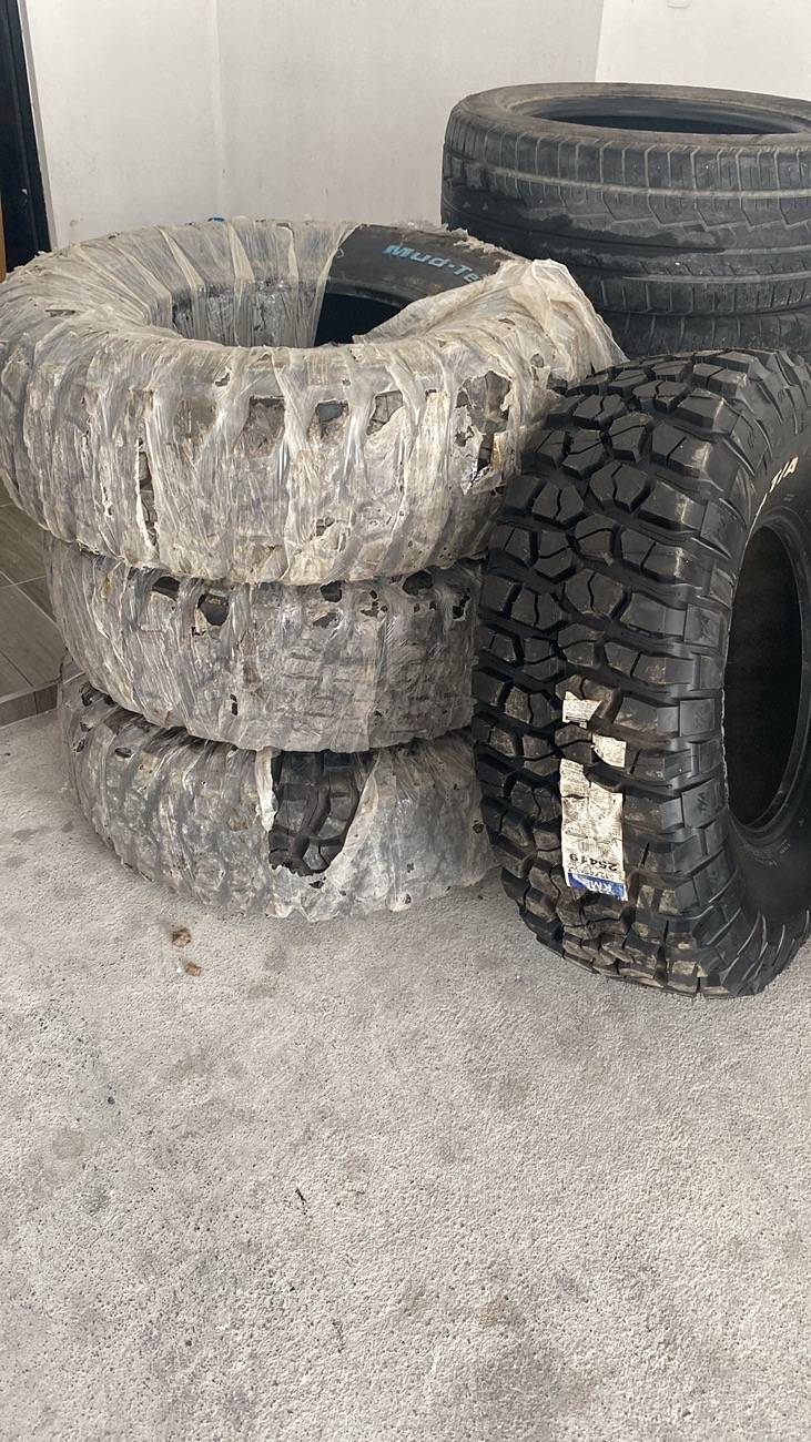

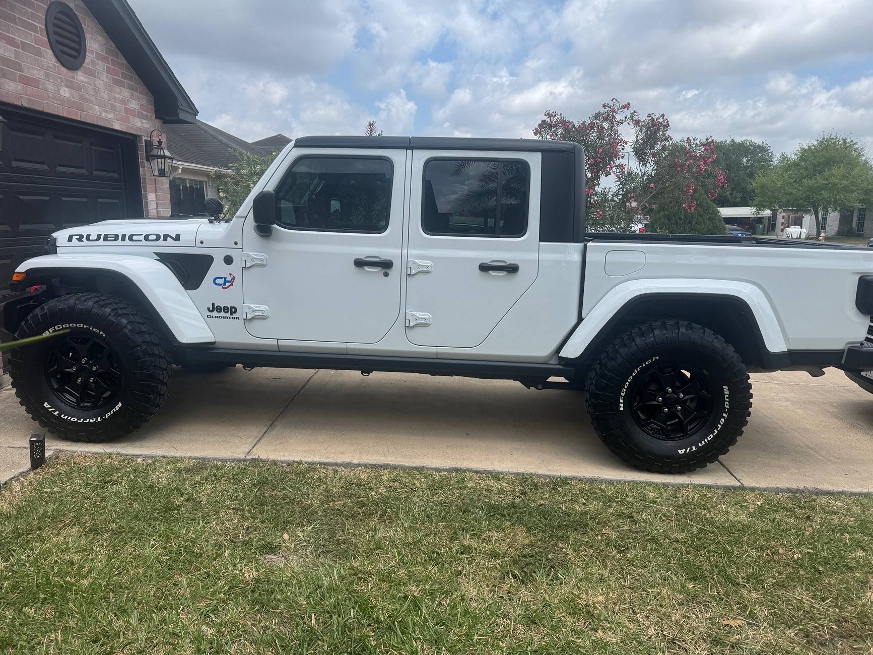

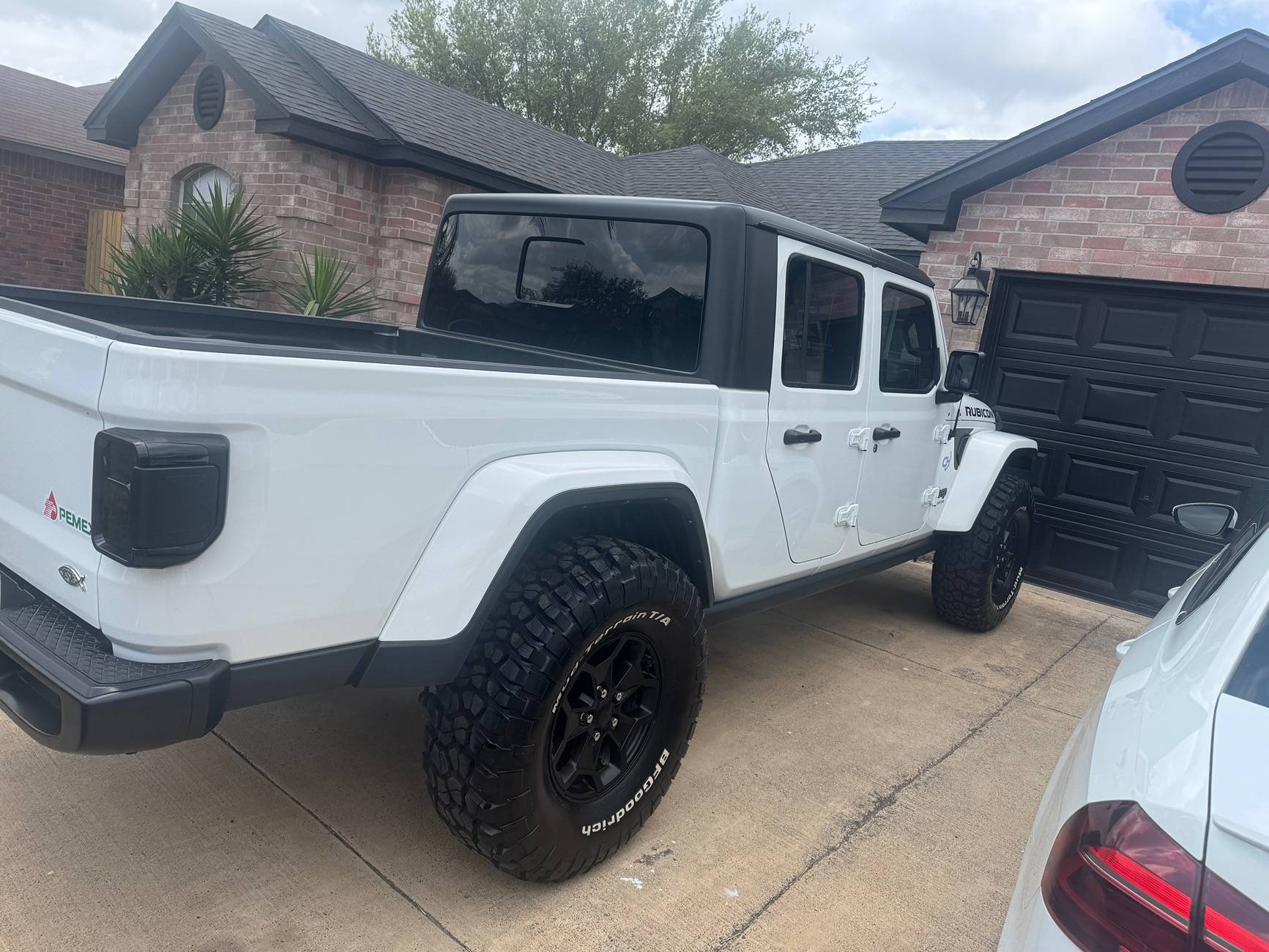

Hello there i just put 37 on my gladiator 2.5 lift on front and 1 inch on the back i was running 35 12.50 r17. Now 37 12.50 r17. With 1.5 inch wheels spacer
