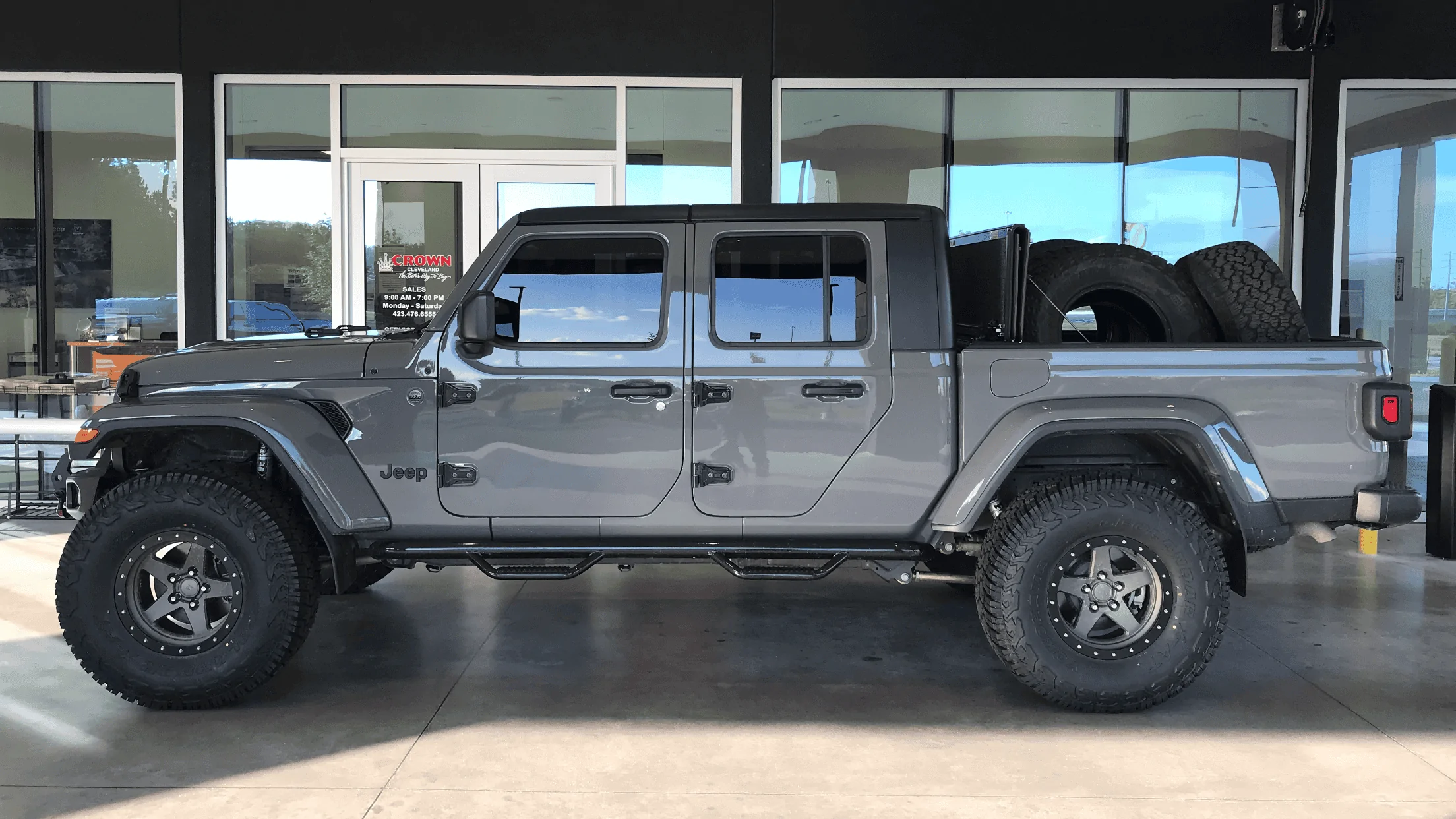

Jeep Gladiator How to do 37 inch tires IMG_0574
This is 37s with 2” mopar lift 3/4” spacer up front. I went with 5.13 gears. As far as upgrades I I upgraded the steering and the control arms for more adjustment. If you plan on off-roading I’d look into doing a fender chop or aftermarket fenders.
