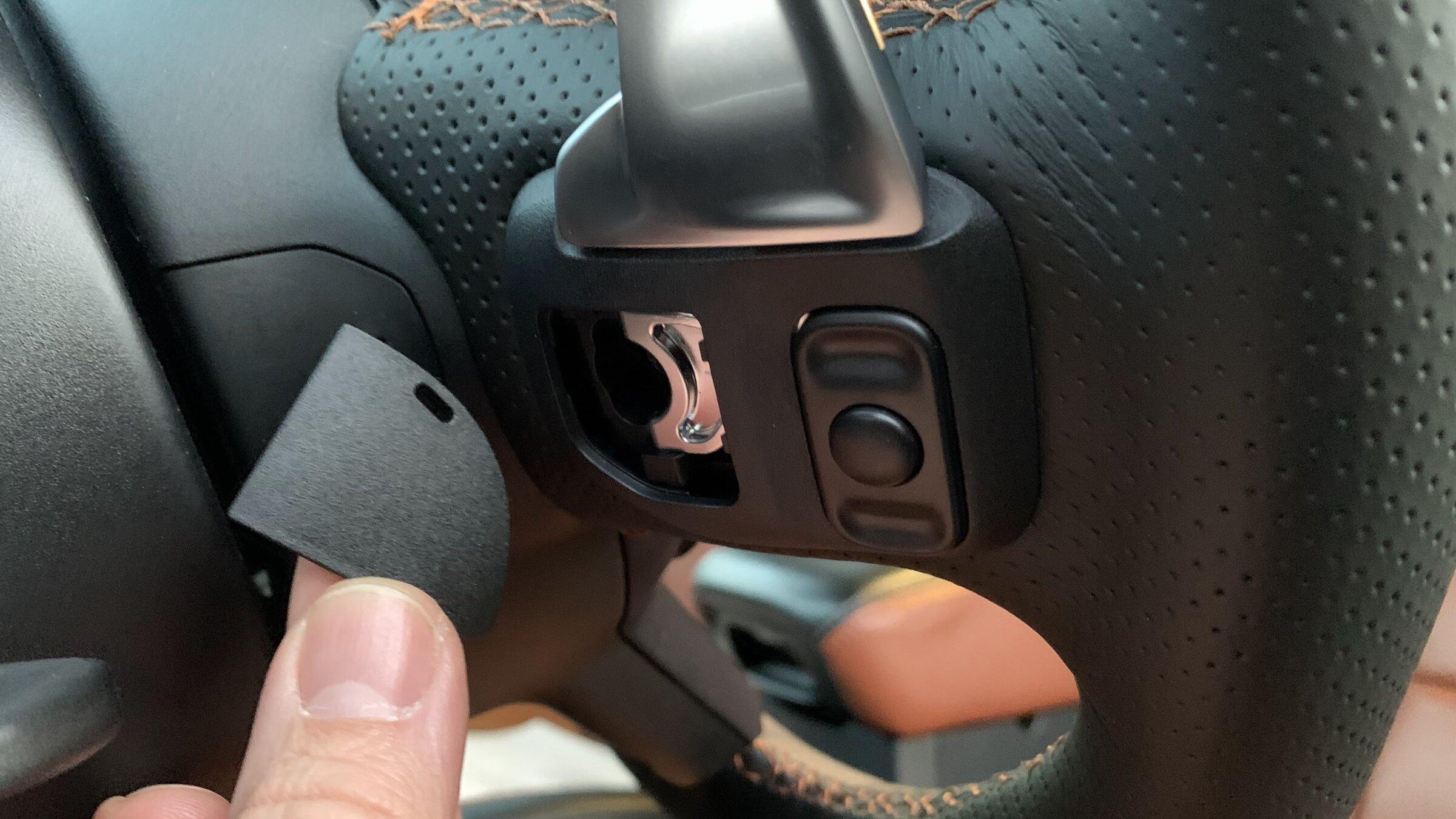

Has anyone asked an actual 392 owner to pop their cover off and look for a part number?

We received the pallet of parts and will have enough to fulfill just under a dozen orders. The first order was not completely fulfilled and we have more orders entered. It will be interesting to see how Stellantis/Mopar handles the influx of orders.
Initially, we'll be shipping full kits only. As our additional orders are fulfilled we will begin offering paddle shifter kits for existing steering wheels.
We'll be recording the retrofit video in the coming days and Z-Automotive (Tazer) will be doing the same once they get the programming validated.
Definitely interested in a paddle-only retrofit for my Mojave when they come available!

You can always order the parts straight from a dealer. I posted photos above of my install on my Mojave wheel.

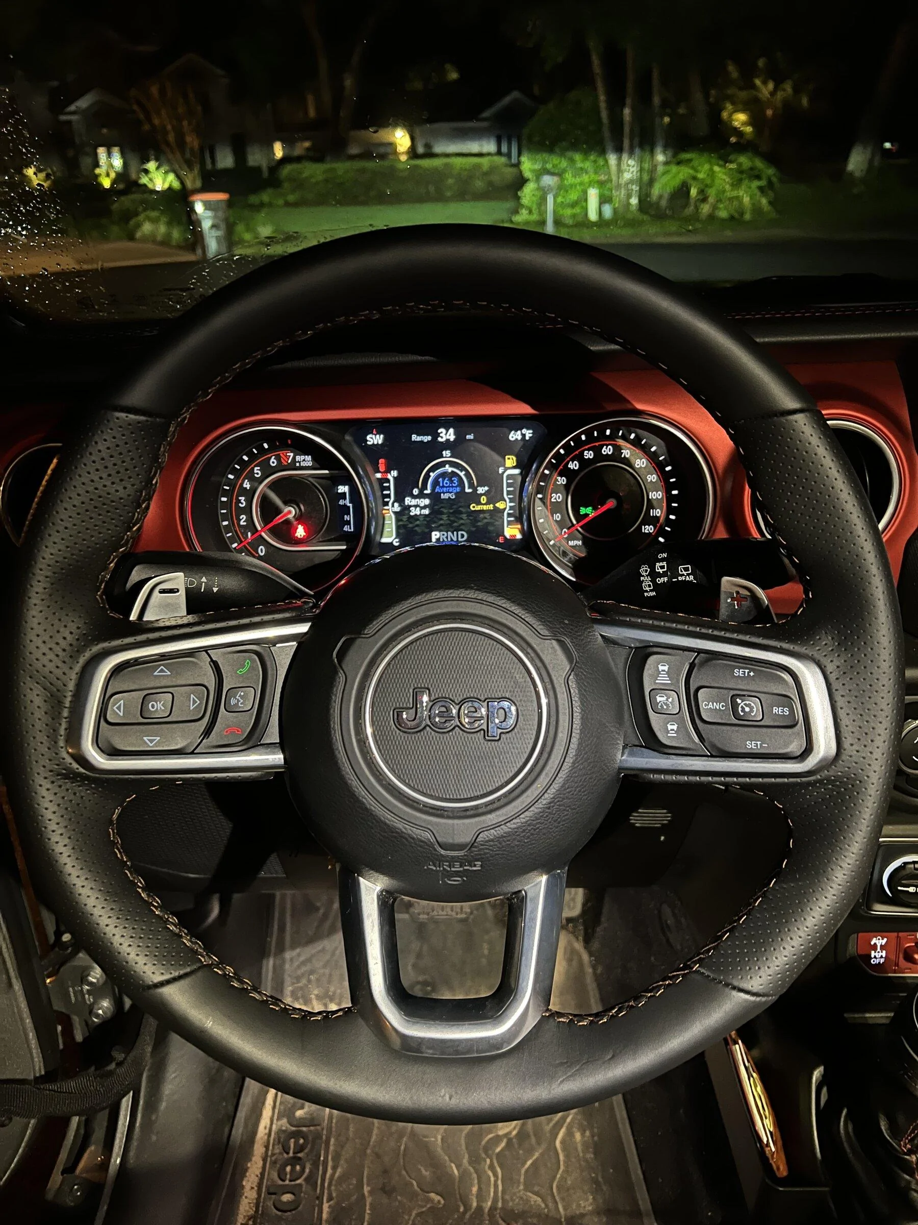

Also, I did this project and it works like a charm. The only thing is that the gear indicator disappears when shifting with the paddles if you don't move the shifter to the left, which is odd and counterproductive. Shifting with paddles in an SRT vehicle instantly indicates the gear on the dash automatically.
Bonus, the bronze/brown wheel stitching mathes my year old brown/black leather project perfectly. Looks like it came from the factory like this. (Sport S Gobi Max Tow)
Jeep Gladiator 392 Steering Wheel Retrofit IMG_0079
Jeep Gladiator 392 Steering Wheel Retrofit IMG_0078
Jeep Gladiator 392 Steering Wheel Retrofit IMG_0077

Anyone have any luck getting the gear to indicate on the dash?
HemiMagnum1
James
Nov 5, 2019
115
205
NJ
Challenger Hellcat Redeye Widebody, Durango SRT 392
I am still working to figure this out. I purchased a factory flash tool (Micropod II) to dig deeper into the FCA system.
Thanks! keep us posted!
