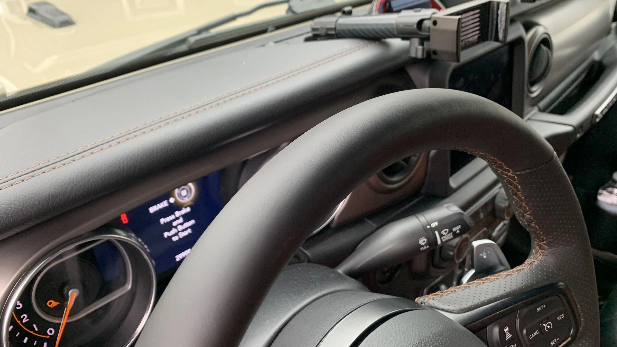

Anyone have any luck getting the gear to indicate on the dash?
I’ve been working on it on and off for a couple weeks with no luck so far. some people on Charger and Challenger forums have mentioned the same problem on their cars when adding shifters or changing the cluster, depending on vehicle trim (or trim of the donated cluster). I haven’t given up yet, but I’m not confident we’ll be able to pull it off unfortunately.

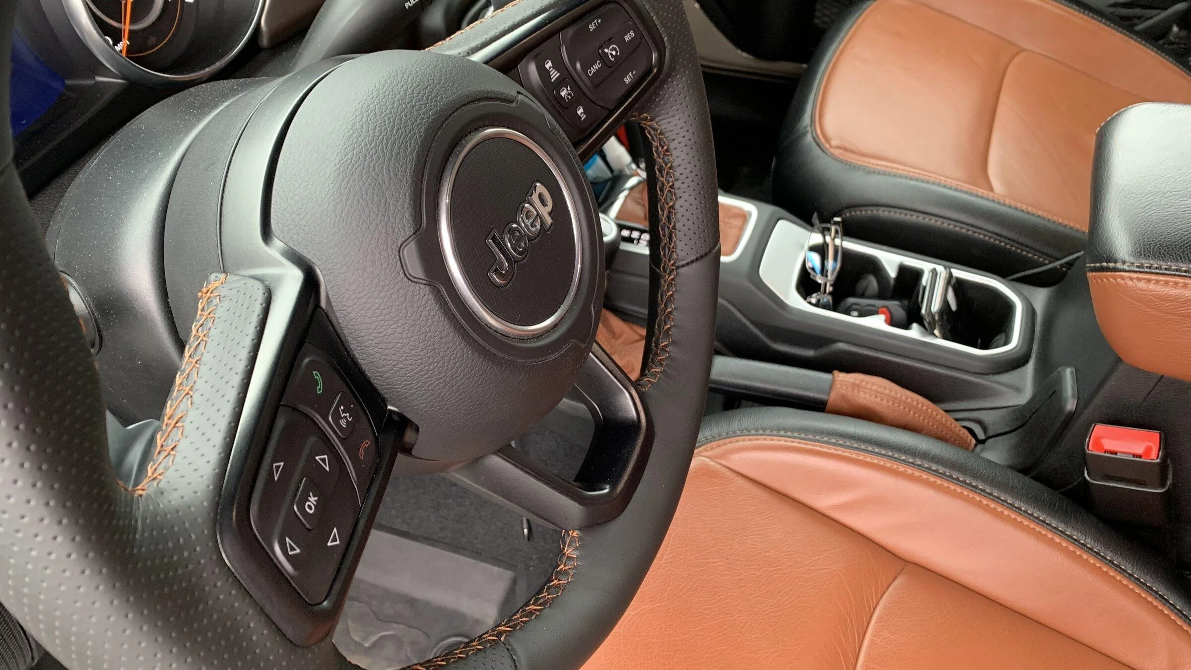

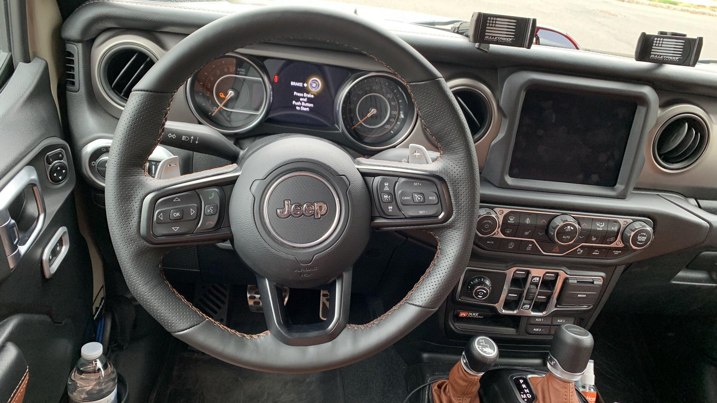

Also, I did this project and it works like a charm. The only thing is that the gear indicator disappears when shifting with the paddles if you don't move the shifter to the left, which is odd and counterproductive. Shifting with paddles in an SRT vehicle instantly indicates the gear on the dash automatically.
Bonus, the bronze/brown wheel stitching mathes my year old brown/black leather project perfectly. Looks like it came from the factory like this. (Sport S Gobi Max Tow)

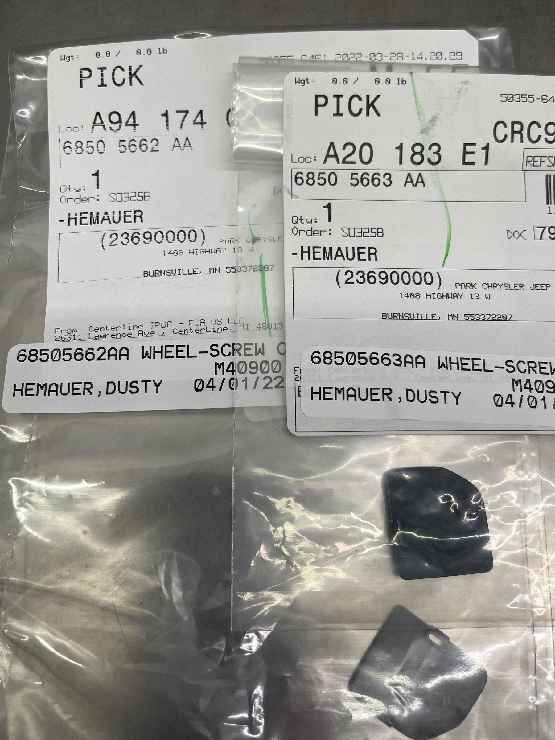

Well boys my time and my digging paid off. Here’s the switch covers
That's awesome! Just ordered mine. Strange that one cover is like $15 and the other was like $2. Then, of course shipping is another $15. Oh well.

Well boys my time and my digging paid off. Here’s the switch covers.
Order in! Out of curiosity, how did you find them? I spent hours digging and came up empty handed every time.
