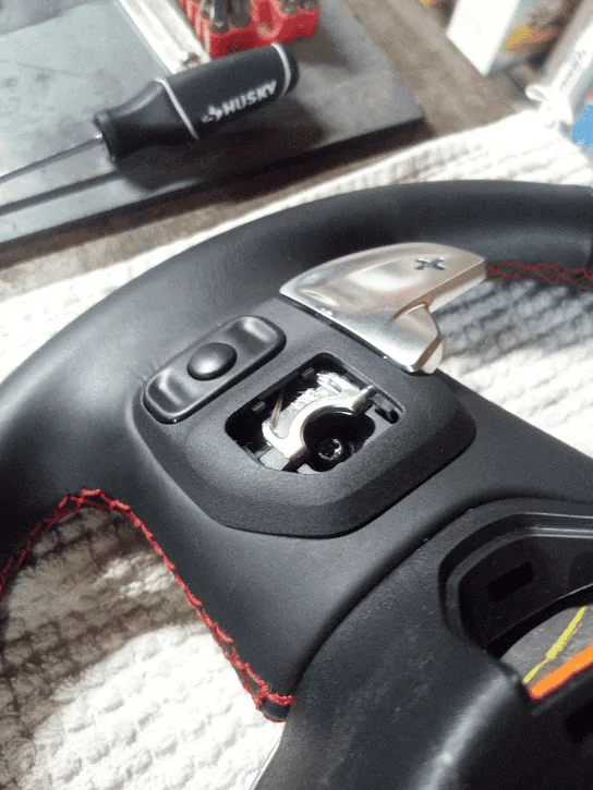

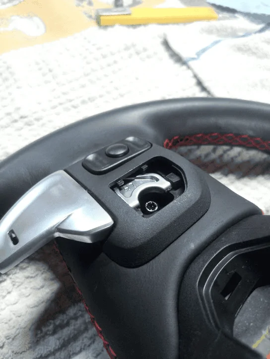

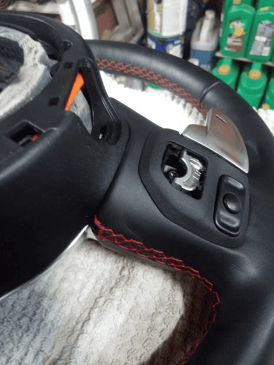

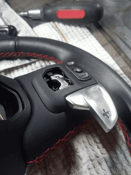

Got my paddles installed.
A few lesson learned.
For back ground I am reusing my ruby steering wheel and I have the ZF 8hp75 EcoD trans. All works just the same as the gasser.
1. Be very careful installing the Cruise control and menu harness plugs, the pins on those are very thin. I managed to bend one on my cruise control button set when plugin in the first time. I managed to bend it back but only after I had to remove the steering wheel and all the stuff for a second time.
2. check your radio buttons on the paddles before you install, my left paddle had a very loose/rattle'y radio button i noticed after install.

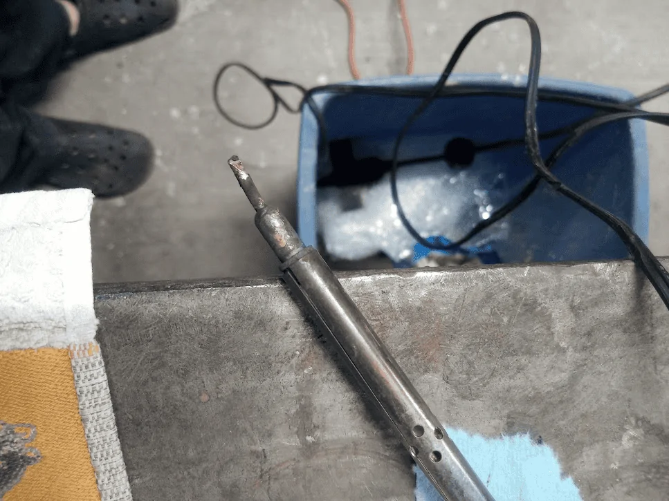

3. I was able to get the paddle bezel to sit flush against the steering wheel by using a small soldering iron tip and using the high heat setting to melt and undermine the foam under the leather. I undermined just enough to make the foam more pliable to compression and site flush to the bezel. I started out by pressing the shifter in place which will leave slight marks in the leather giving you a outline of where to stop the undermining, doing a little bit at a time until i was happy.
4. I used jscan and did a search for "pad", which gives 2 options. I enabled those.
5. If you want the jscan activation to go faster then 24hr, disconnect the batteries and re attach after a few minutes. I disconnected the batteries because I was scared of working with air bag. The second disconnect happened because of item 1.
Disconnect is not traditional because the jeep will still have power if you just remove the main battery ground. You need to disconnect both big wires from each other going to the main - battery terminal to have no power going to the jeep.
6. All wire ends of the new harness, even the ones you don't use will have a place in the trim where they nest/clip to so there will be no loose wire ends rattling around.
7. My 7" screen does not display the enable/disable paddle shifter check box under driver aids. But they work, by using Jscan to active them.
