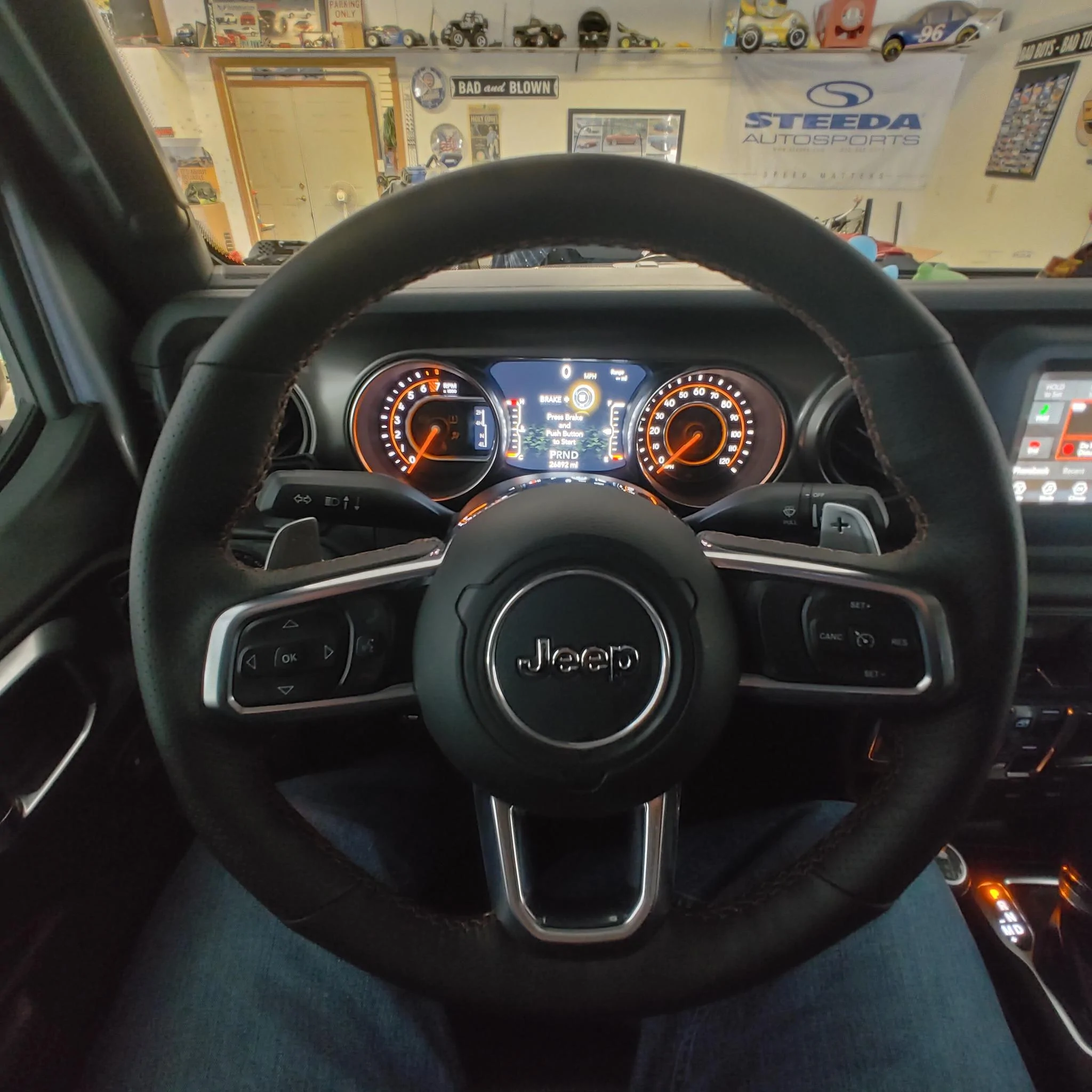

I finally got around installing the paddles. After the install I noticed that the volume button is very loose To the point that it will most likely rattle when driving. so before taking the paddle off, can it be tighten up or the whole paddle needs to be replaced?
rharr
May 6, 2021
1,268
1,666
Tucson, AZ
I ran into the same issue, just pull the paddle out and press the back of the button board into the front of the housing, the button board snaps into the housing and can pop out of the snap if over tighten. I found a happy medium tight that still let everything sit nice. You also might put a little bit of super glue on the snaps. Seam to keep the pieces from separating, but do that at your own risk.
You can remove the paddle button without having to reremove the steering wheel
Thanks. I was able to fix it based on what you mentioned.
