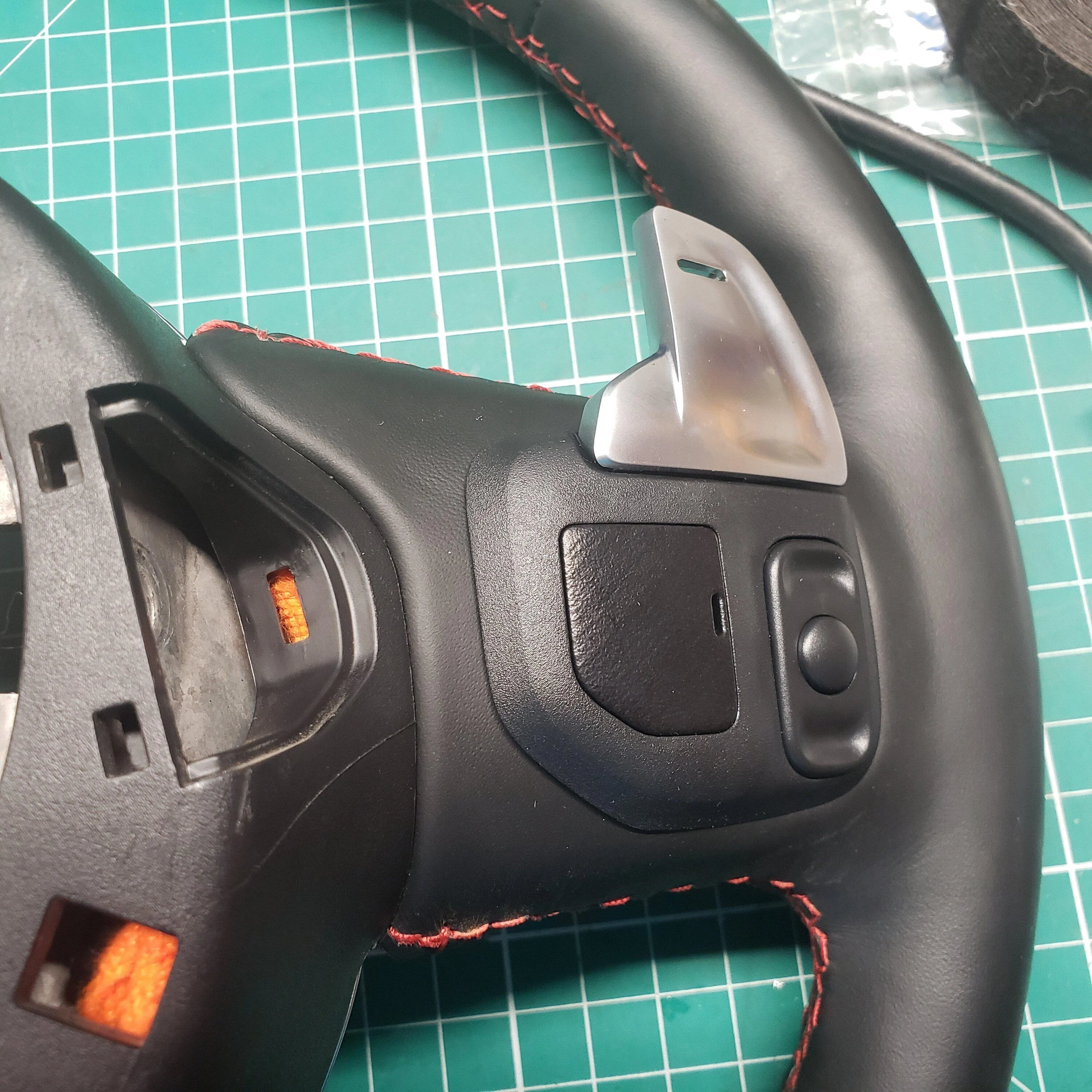

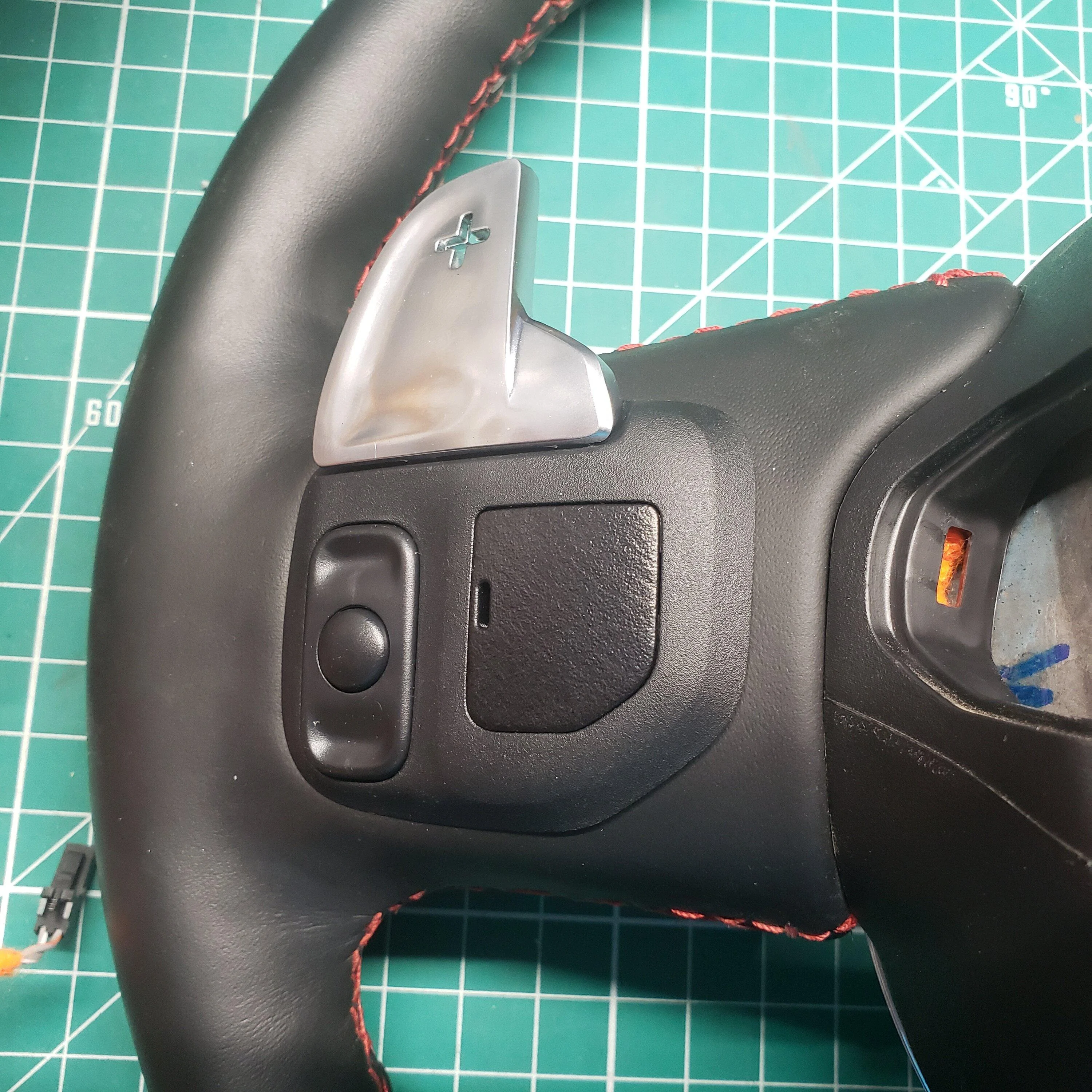

Paddles fit the rubicon heated wheel perferctly. Threedom covers also fit the openings perfect!
Now to reinstall the wheel and program the paddles.
Did you have to do anything special to get them to fit, or did they just pop on? Assuming you need the harness too? I’m thinking this might be the route I go since the non matching stitching of the 392 wheel will probably kill my OCD.
Nothing special. I bought the harness and paddle kit from Threedom. These were direct replacement for the factory switches.
Threedom has some YouTube tutorials on what needs to be done with the harness swap and the programming to turn them on.
I ended up using Jscan to turn them on because I found out afterwards I didn't have the cruise switch connector fully seated to use the Tazer.
Even after reseting all modules and clearing codes it still took a couple key cycles for the HVAC controls to start working again.
Awesome sounds good. I thought I had read/heard there was some issue with getting the paddles to fit the wheel correctly that required some modification, but if not even better. Probably will go ahead and order the stuff then.
I think that was fitting the switches on the Mojave wheel. The only issue I had was I had overtightened one side and the paddle wouldn't click correctly. Loosened the retention bolt slightly and paddles are working consistently.
