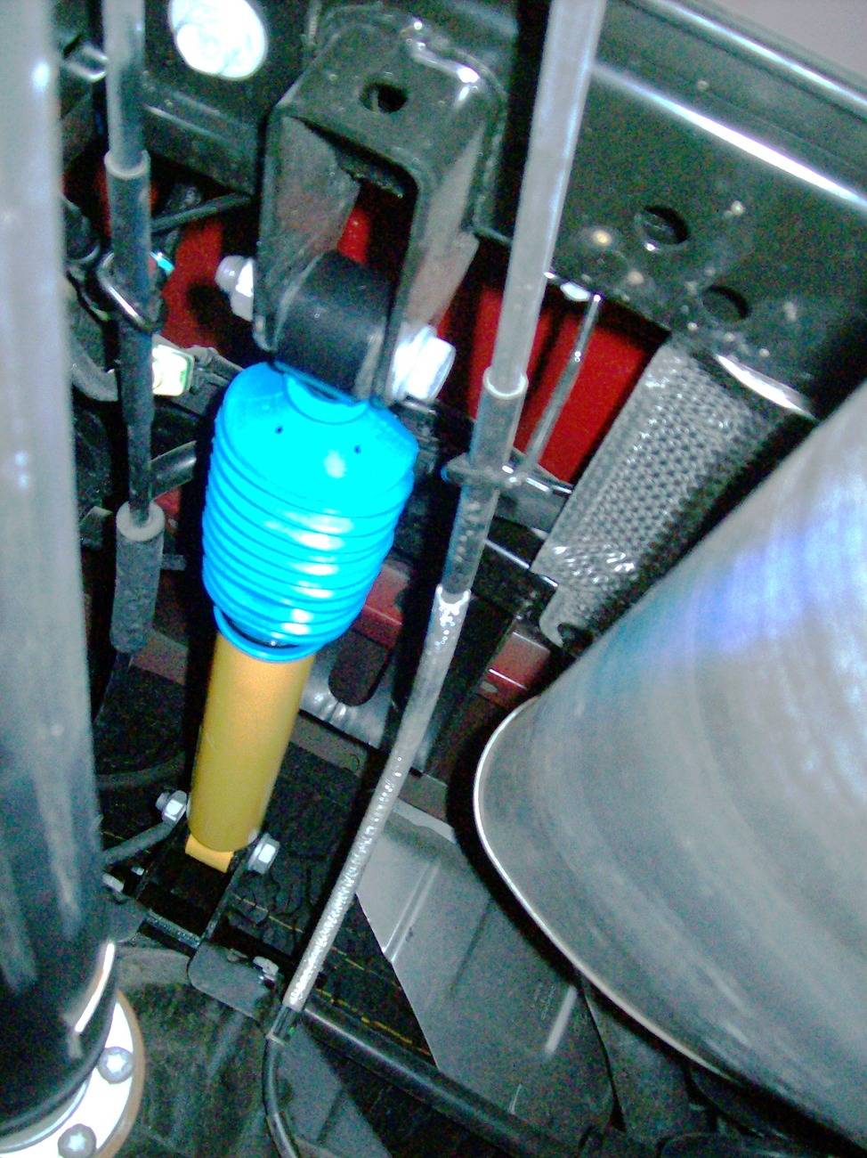

Has anyone added this to an automatic? I have a 21 Mojave and have the bracket on the frame. Would any shock work or would it need to be this specific bilstein?
You need the specific Bilstein shock. It was chosen for the amout of dampening it provides. I bought all the pieces from @AllMoparParts.com and installed it on my '20 Overland. I moved all the pieces to my '23 High Altitude when I traded.

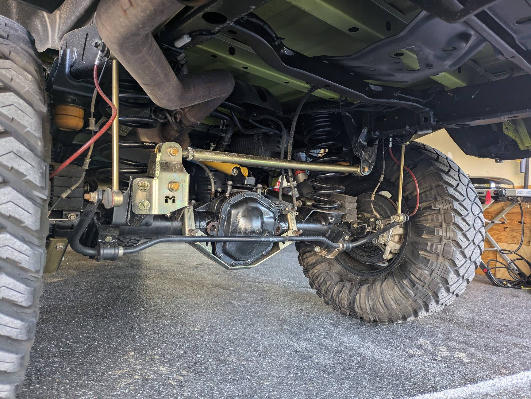

I added the axle shock to my JTM

Benny's kit makes it easy! You won't notice any big difference on smooth roads, but it can help off-road, in gravel, or with snow-belt potholes.
Yes, the rear feels more settled; just adds an additional angle of dampening
