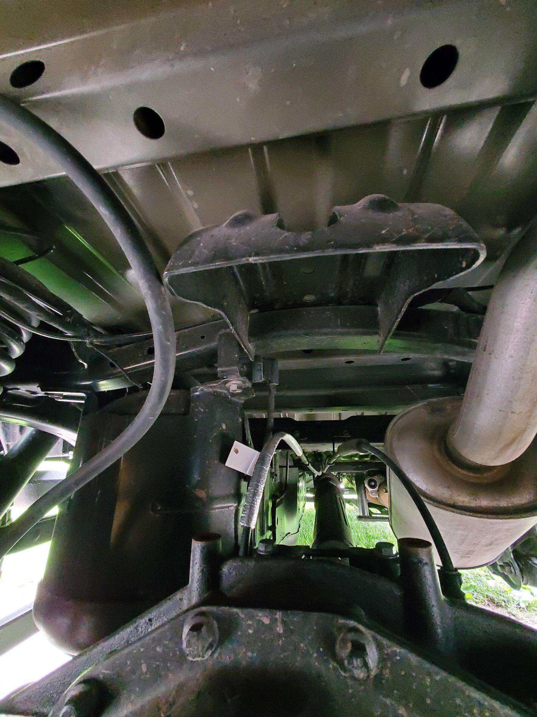

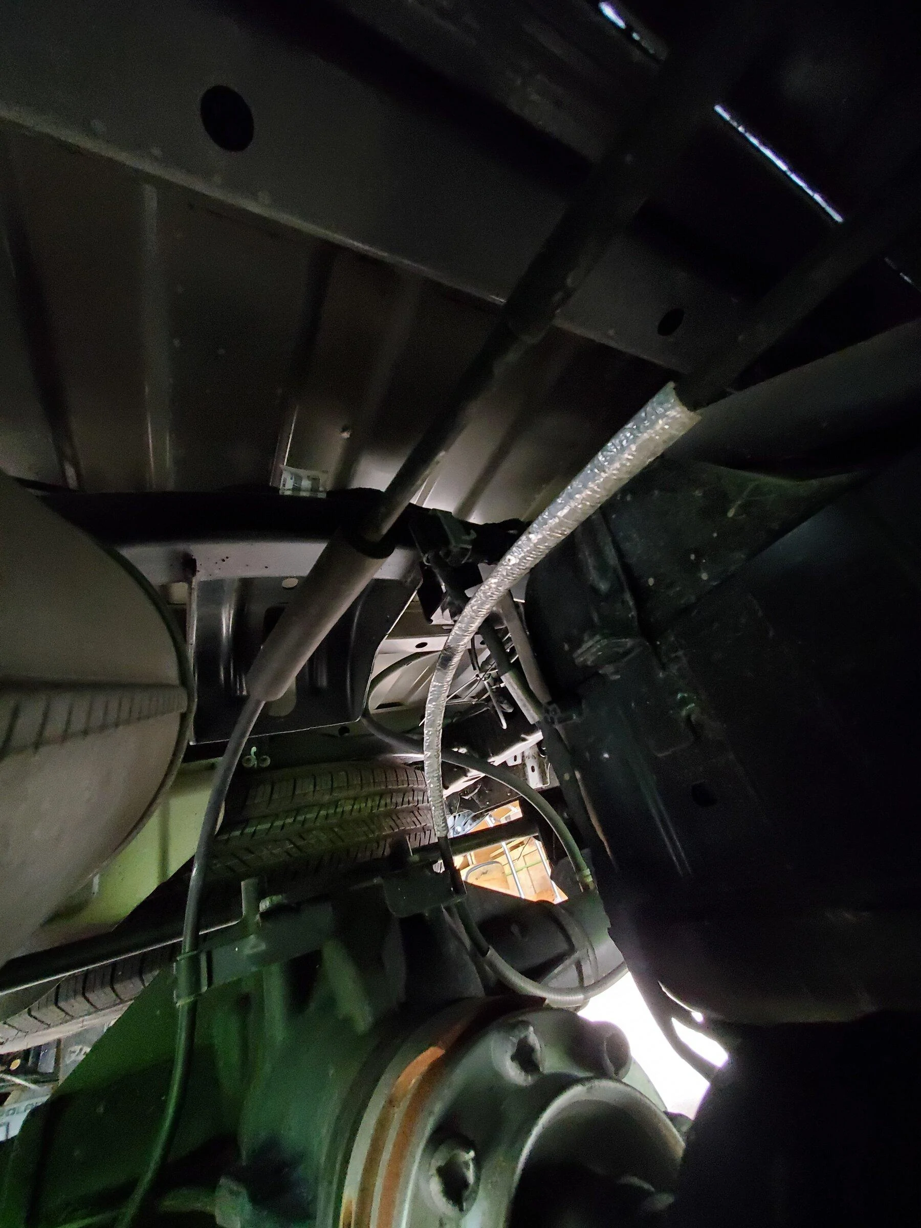

So I finally got around to add the 3rd shock over the rear axle on my 2021 Overland Diesel and I was surprised to find there was no upper frame mount ☹. I guess I will further suffer wheel hop in the sand...... If anyone is looking for a kit I have a like new one for sale.

What kit do you have???
It is the Bilstien shock and bracket for the top of the rear dif. Make sure you have bracket on the frame cross member. Not all have it apparently.
