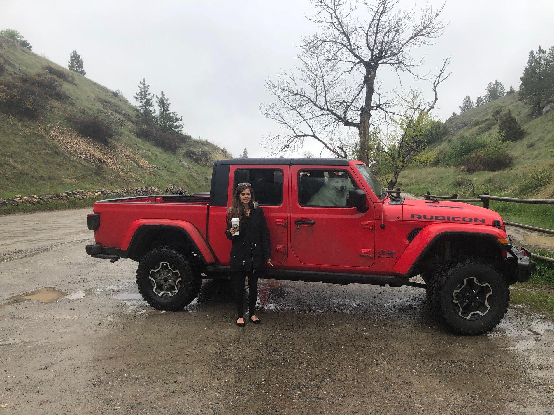

Hey Red you really need to get some step bars for your little lady. Am betting that she has to climb in. Make it a little easier for her.

LOL, fido be like screw her I've got shotgun
