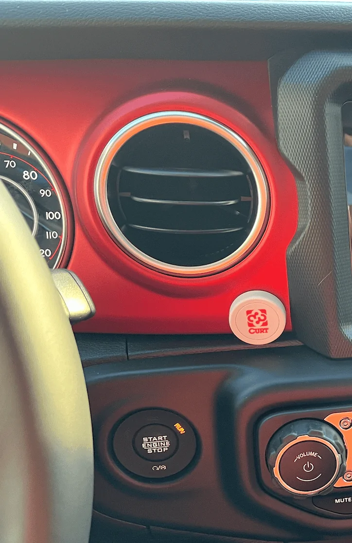

We have 2 Trucks, so I can move this between them and save profiles for each. I also have what I have dubbed the Crap button and mounted that to the left of the radio which is an easy reach from the steering wheel. I think this picture does a good job of showing it's size.

I have the Curt Echo as well and 100% agree with @Summitdan. It's awesome and I will never use another traditional brake controller again.
Here is a link with a nice video
https://www.curtmfg.com/dm/echo-mobile-brake-controller

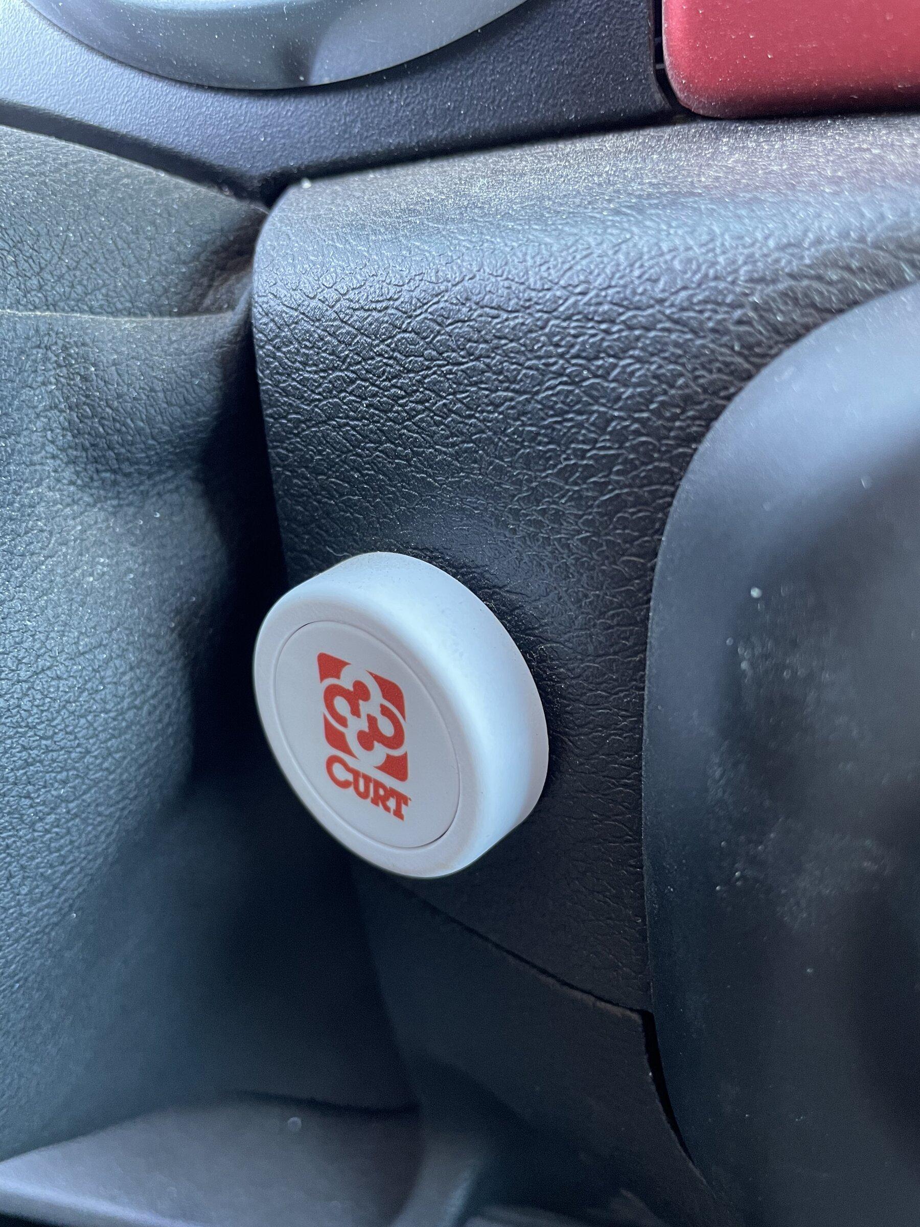

Nice to know someone else agrees. My only complaint is itā€™s length sticking out of the 7 pin, but I use a small rubber coated twisty tie to backup the strap curt gives you. Iā€™ve used this on super sketchy trails with lots of bumps and articulation, and have never hat it move a bit. (Serious off road trailer). I put my override button just to the right of the steering column. My delicate sensibilities wouldnā€™t allow me to put it on the rubicon red, but Iā€™m mentally impaired. :) I also think itā€™s important that people know that even though these are configured and can be controlled from phones using Bluetooth, your phone does not need to be connected for it to work. It retains its last setting, even if itā€™s been off and removed. So if you drop your phone in a river, you still have brakes on the way to the Verizon store.
