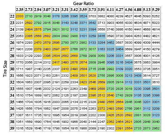

Anyone else hardly seeing 7or 8 gear?
Mine is a 2022 with the max tow automatic with the Mopar lift and 35x12.5r17 M/T tires. I have the Tazer mini Jl and my speedometer is dead on with GPS. But still i don’t hit 7 gear very often and 8th is rare. Any suggestions???
Do you really need lower gears? Do you find a want of more torque or better low speed control? With a Max Tow, you don't have the 4:1 transfer case so lower gears would be big help when in 4-Low.
If your only question is for highway speeds, then I would not worry about it.
The chart be low is straight math, no slippage or efficiencies calculated.
It gives you effective gear ratio in a given gear versus differential gears.

Yes, changing to 4.88's will give you an effective ratio in 7/8th gear (4.1/3.26)similar to what you have now in 6th gear (3.73) Either way, the engine is finding it's correct rpm at any given speed, it just doesn't currently need 7th or 8th to obtain it.
You could further extrapolate and multiply your tire rotations per mile by the effective gear ratio above to find your rpm at 60 mph.
with true 35's (given 593 rotations/mile)
6th gear 2212 rpm
7th gear 1856 rpm
8th gear 1483 rpm
Not knowing what the torque converter stall speed is or where lock-up is, I would guess that 8th gear at 60 would not lock the converter and cause slippage, heat general badness etc..

The below chart gives approximate rpm for tire size vs. differential gear at 65 mph with 1:1 transmission gear- no overdrive.
Jeep Gladiator 6th gear most of the time. 1649865972536
Thank you Quadratec for the chart.
