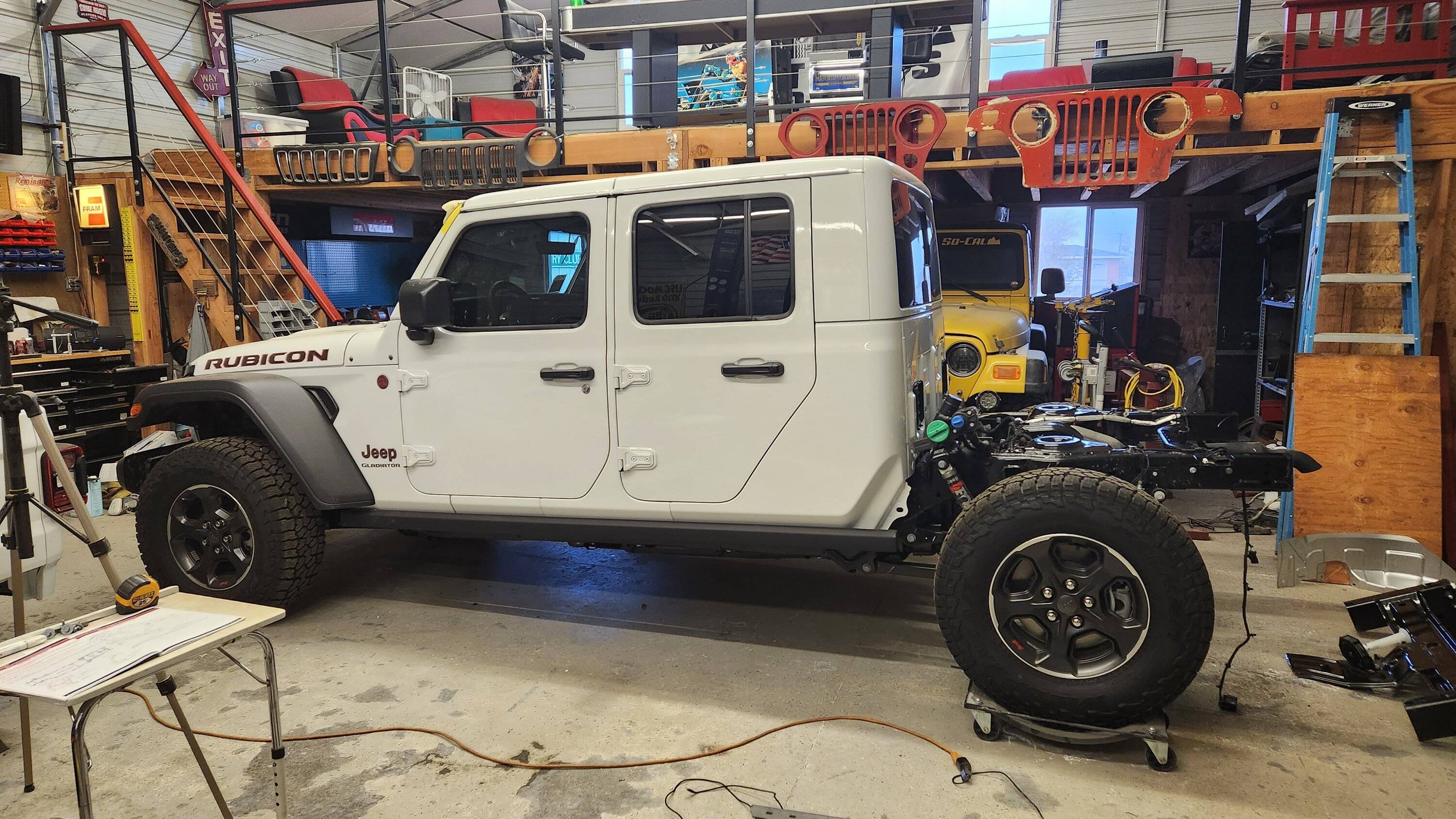

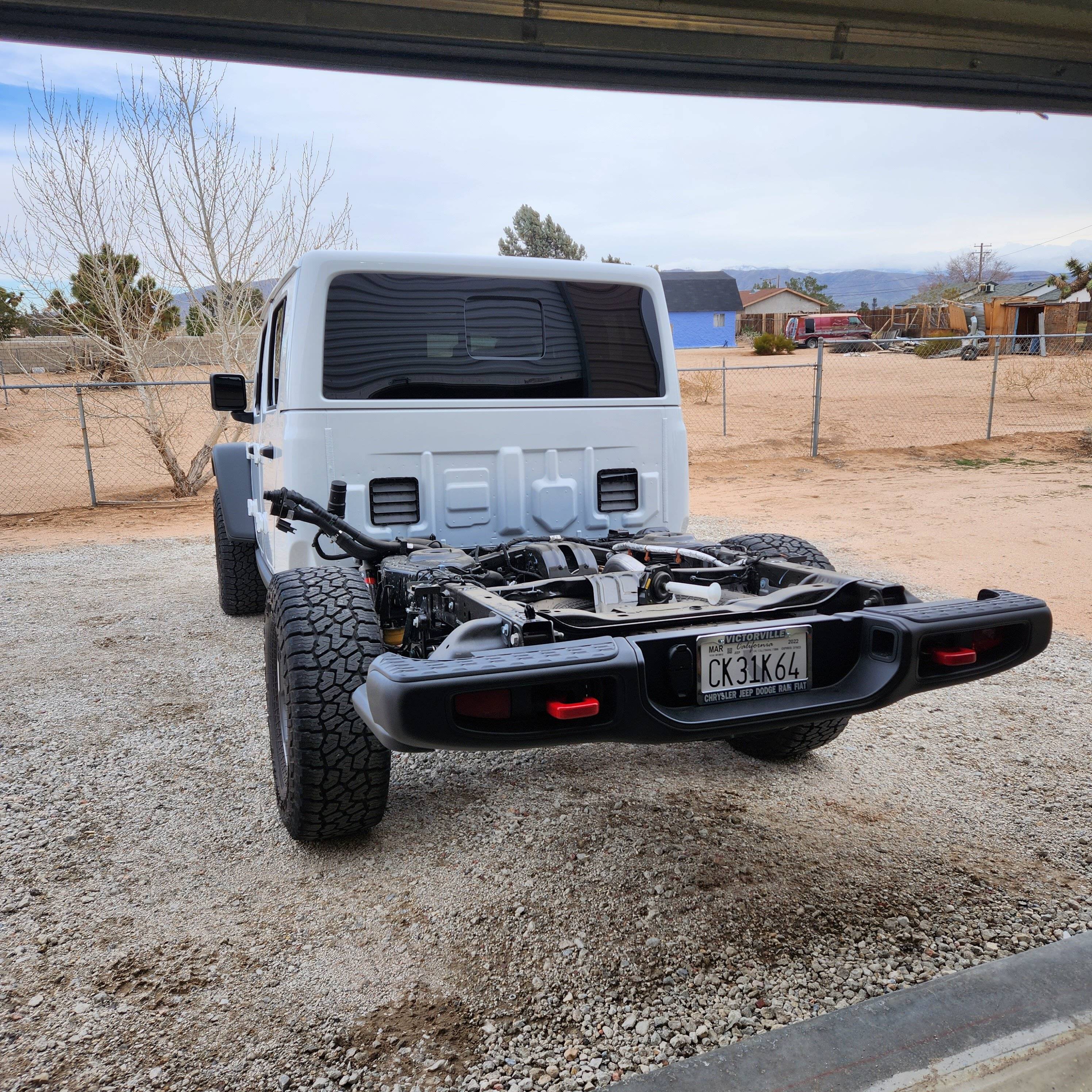

Tore the bed off immediately

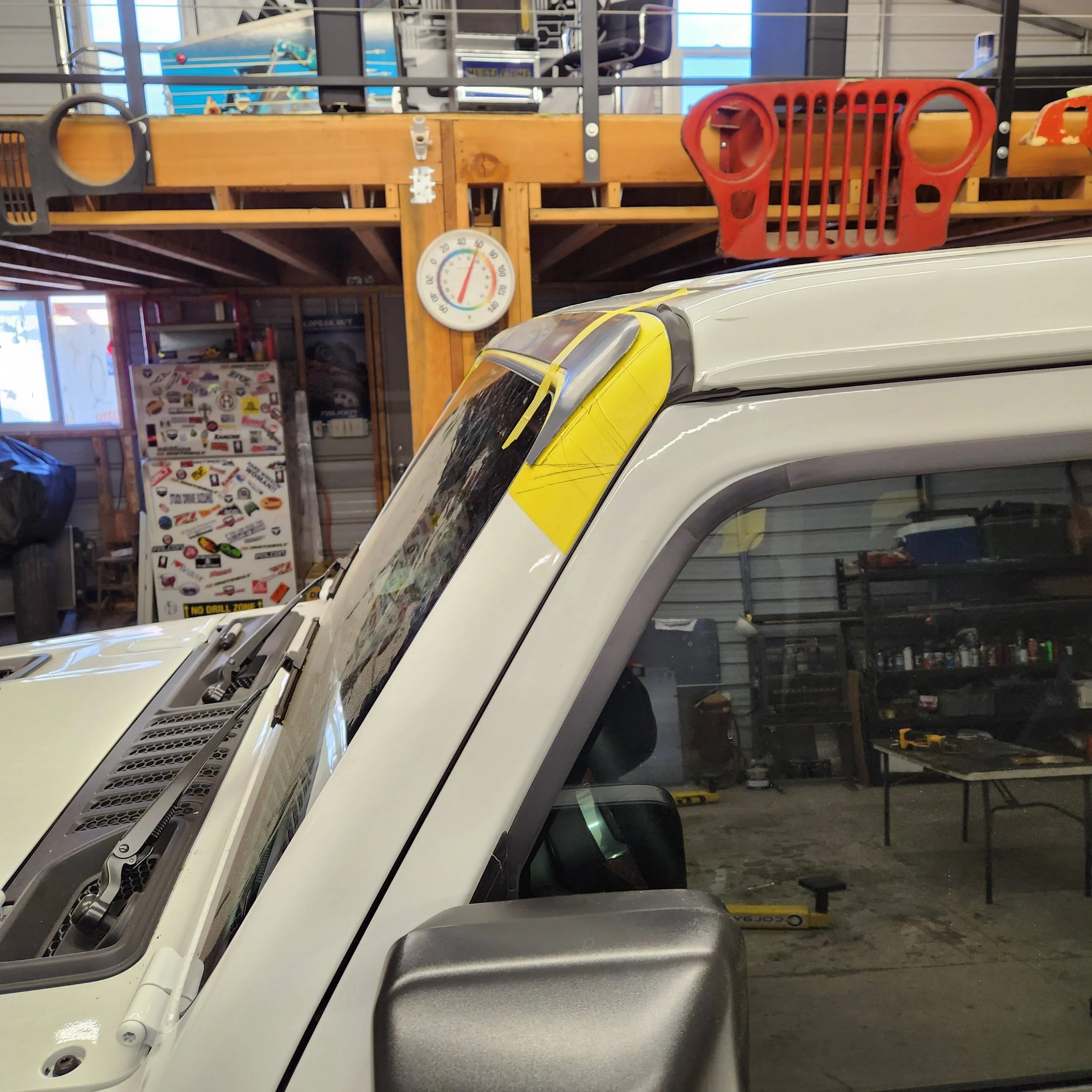

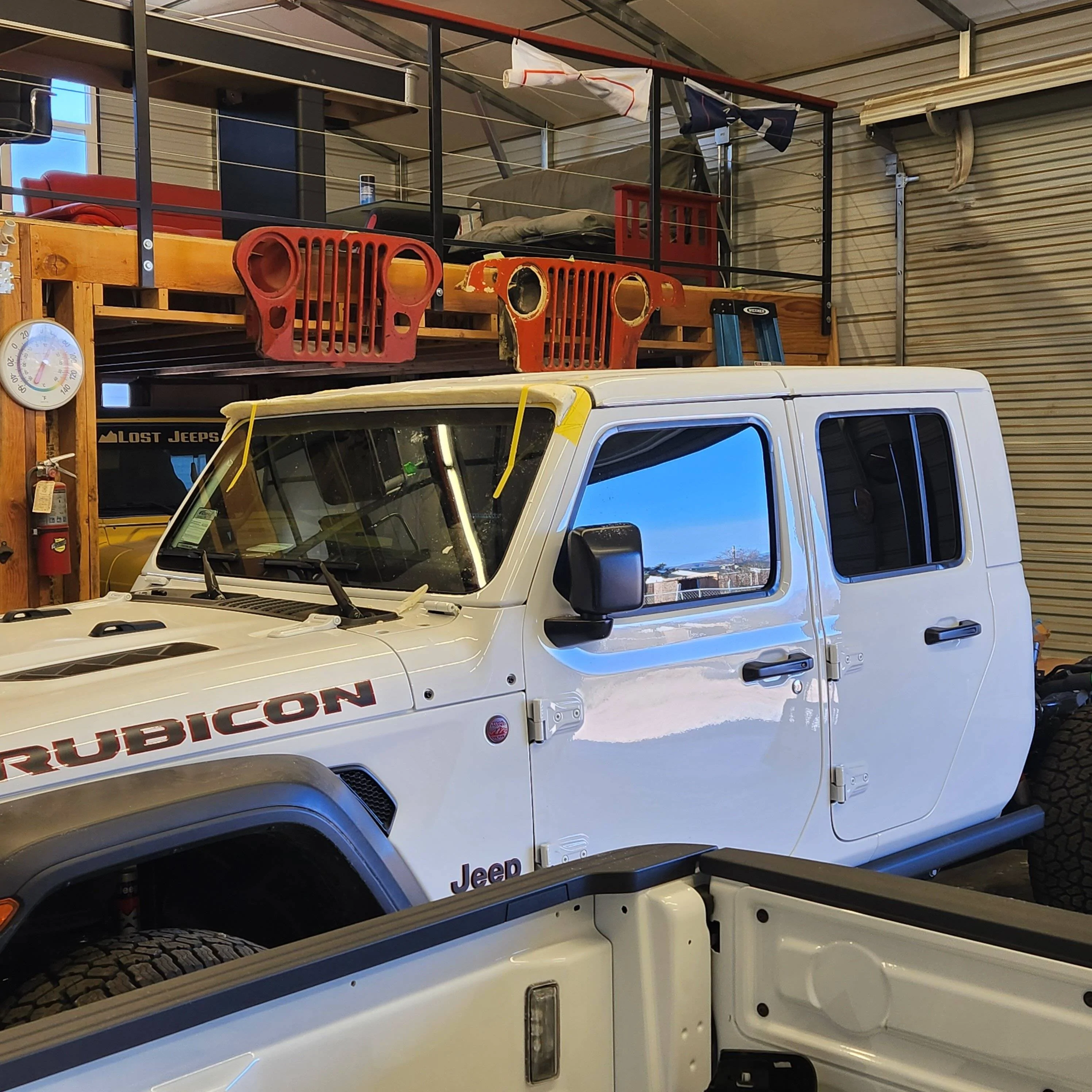

I started with the visor, I knew it would take time. The base is .90 steel and worked to match the body contour.

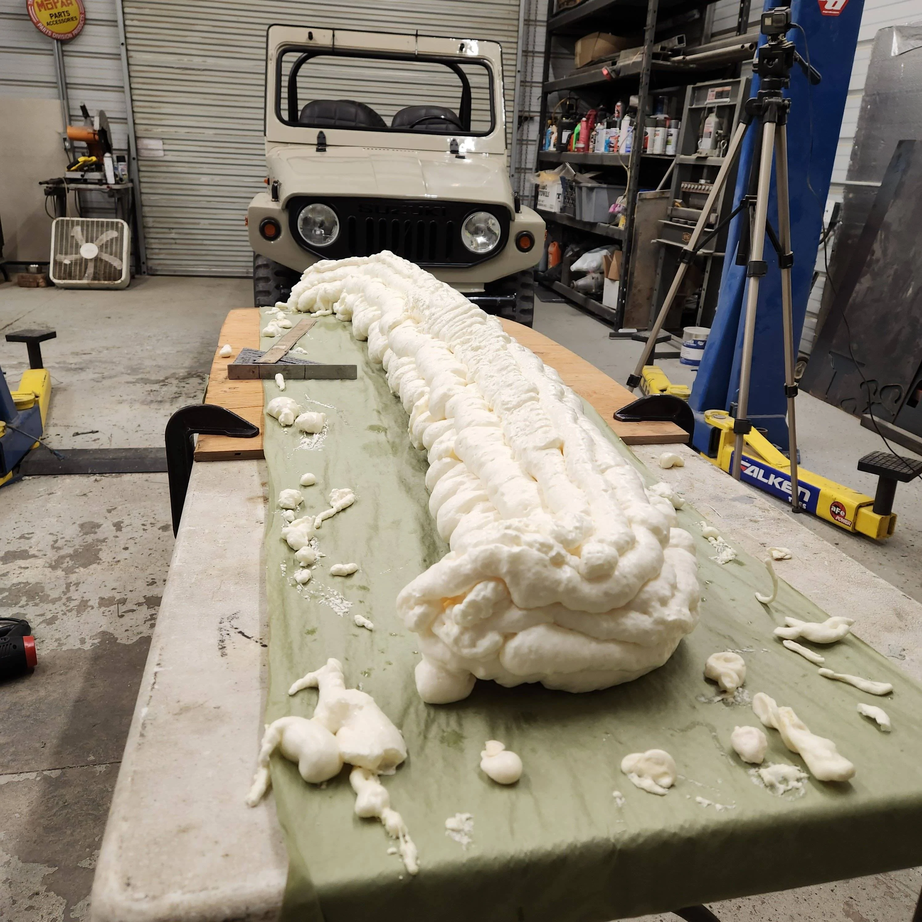

Great stuff foam was used for the basic shaping. I learned each layer needs to fully cure before the next or it will solvent out in the middle.
Jeep Gladiator Retro Gladiator build, my modern take on the Old Honcho 20230219_155035
Shaping with an electric turkey carver, I tried several shapes until I settled on this one. I'll take a break here and shift to the Motobilt bobbed bed in the next post.

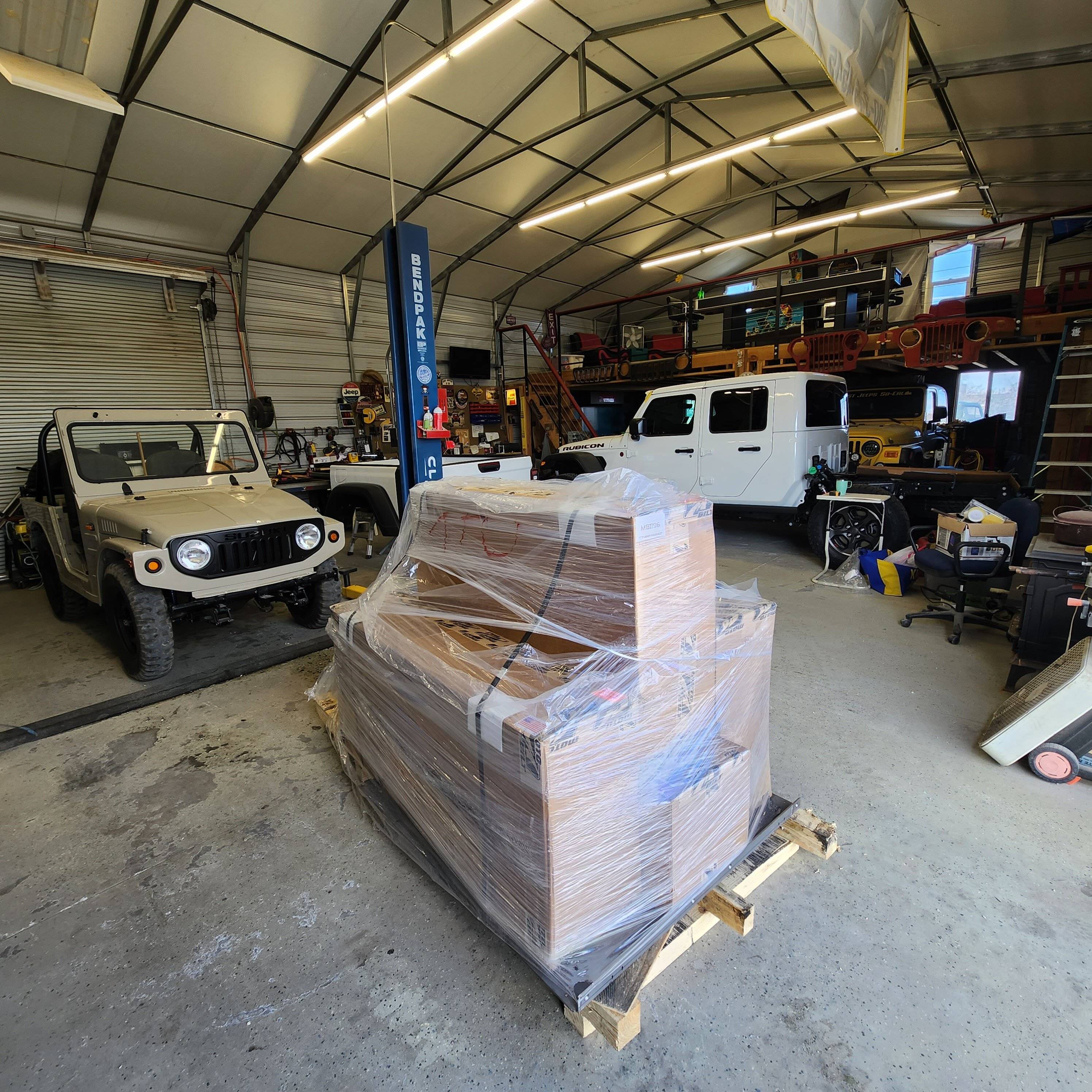

So, next part. The bobbed bed came in. The packaging alone took half my shop. Each part wrapped in paper and loaded on a pallet. Just unpacking took close to two hours.
Jeep Gladiator Retro Gladiator build, my modern take on the Old Honcho 20230222_130154
Thankfully my neighbor let's me borrow his forklift often.

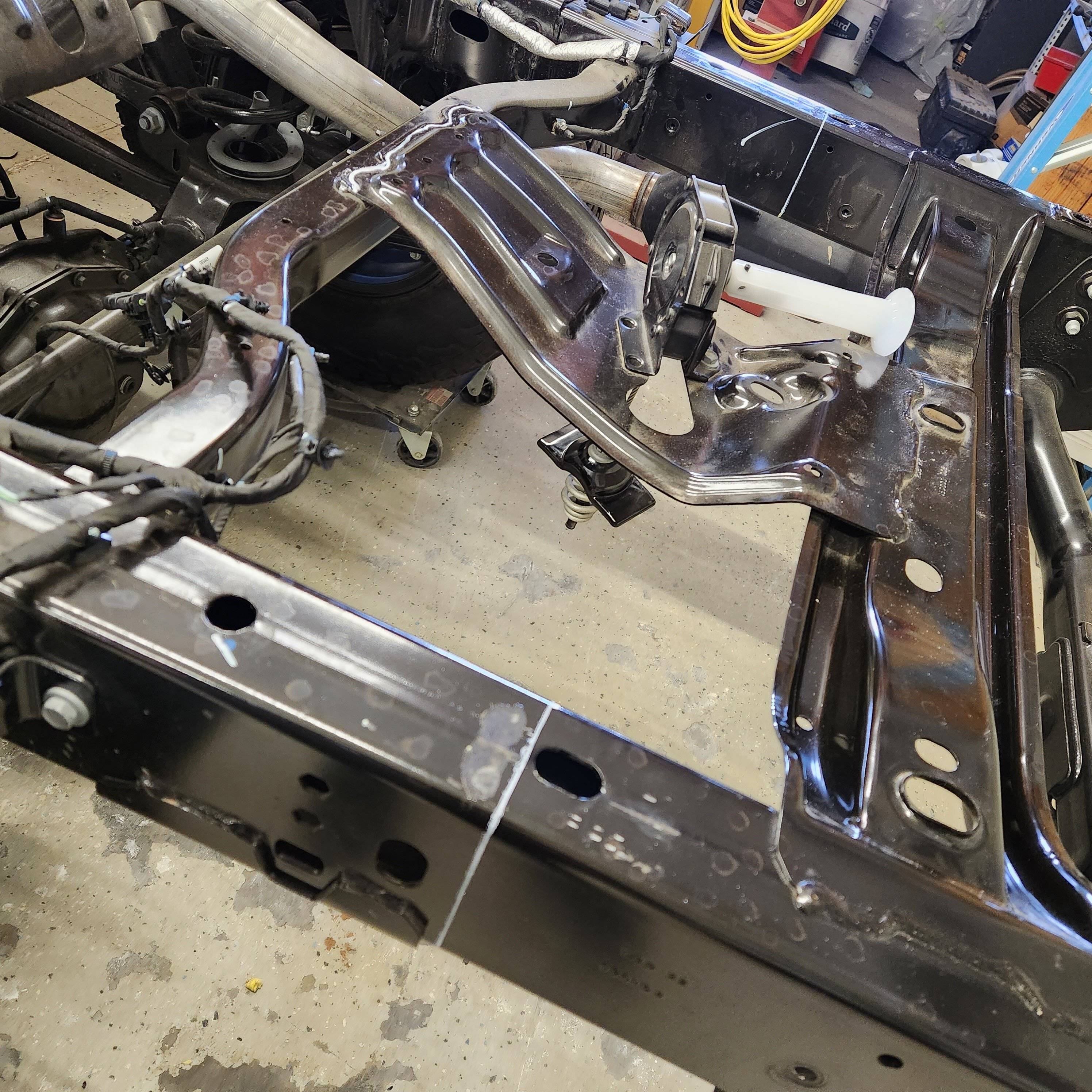

Step one was to measure and mark where I was cutting the frame. This part went unusually easy. Surprising how quickly my metal blade made it through the frame. There was some wiring that was pulled back for this step.

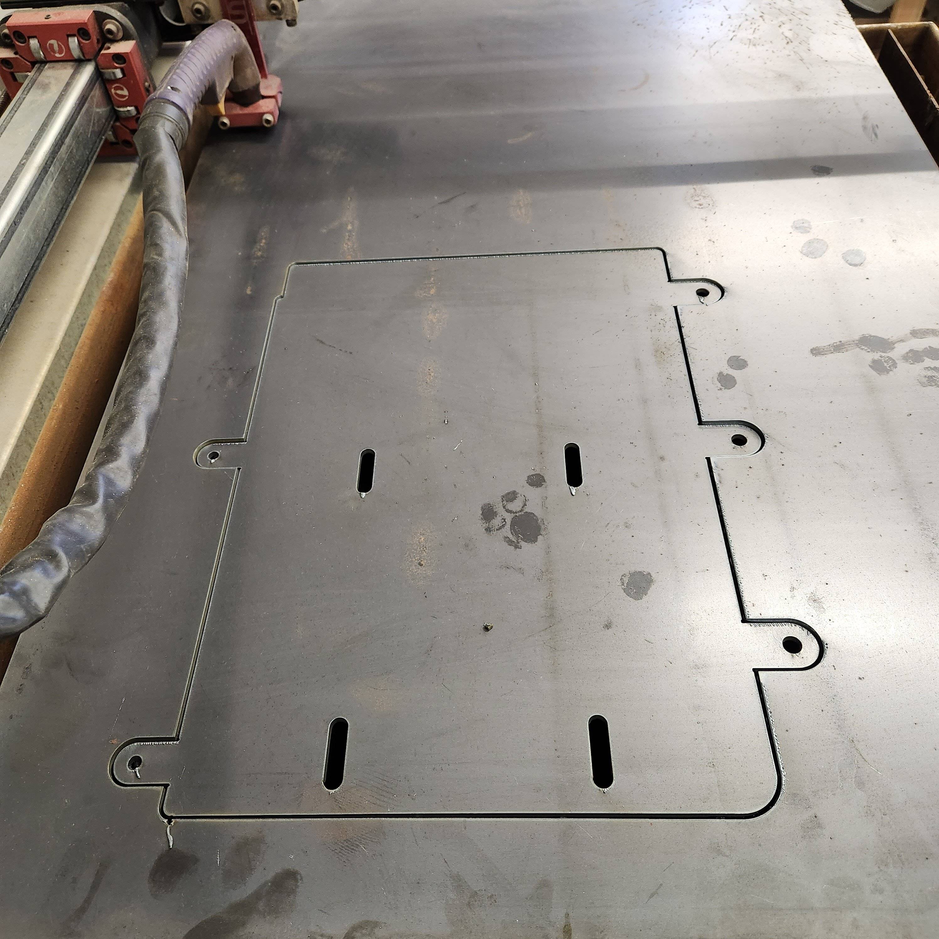

I have a langmuir cnc and put it to work for this custom inner fender liner. The other panels are made of aluminum, but this panel is cut from .120 wall steel to hold a 1.5hp extreme outback air compressor.

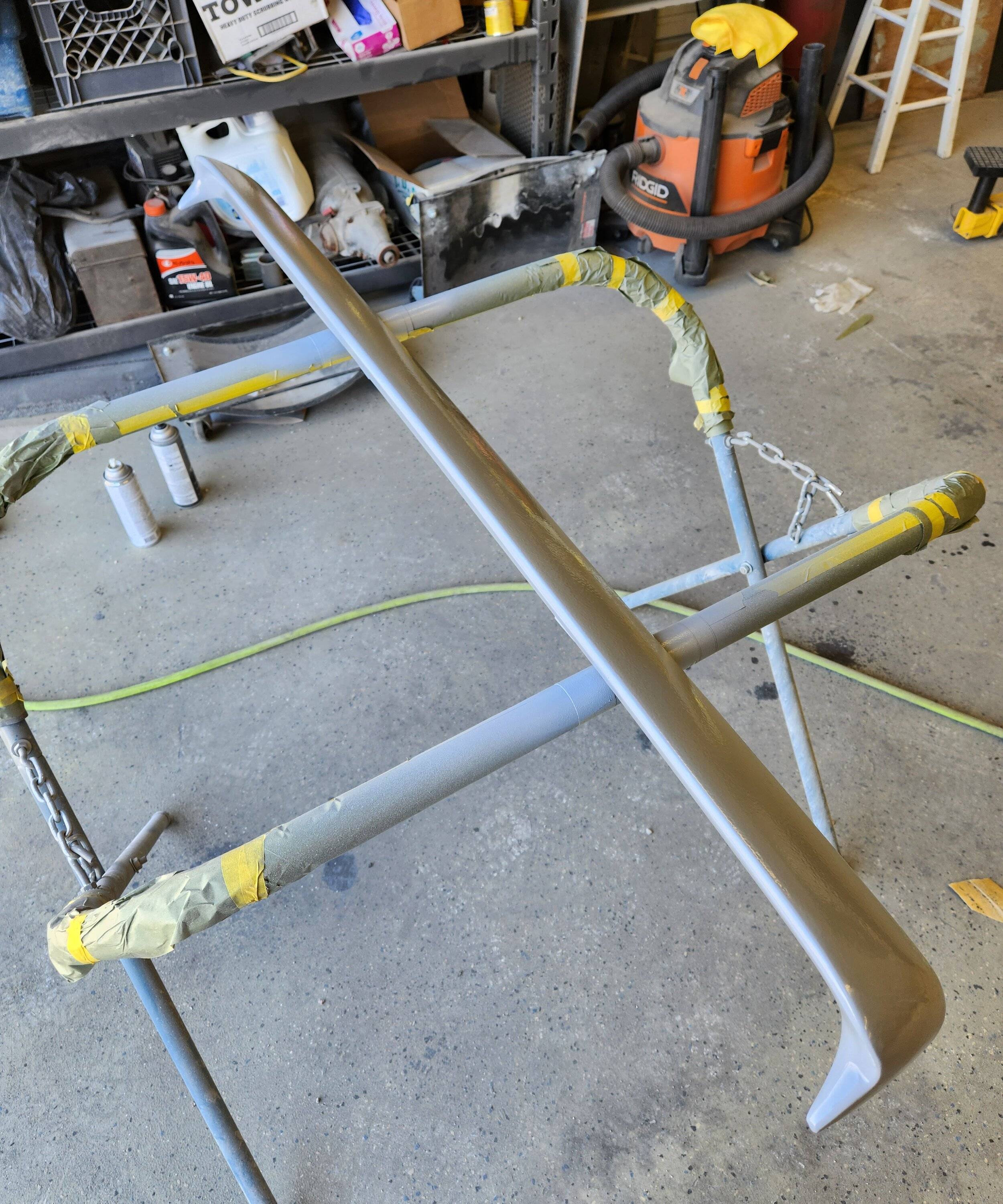

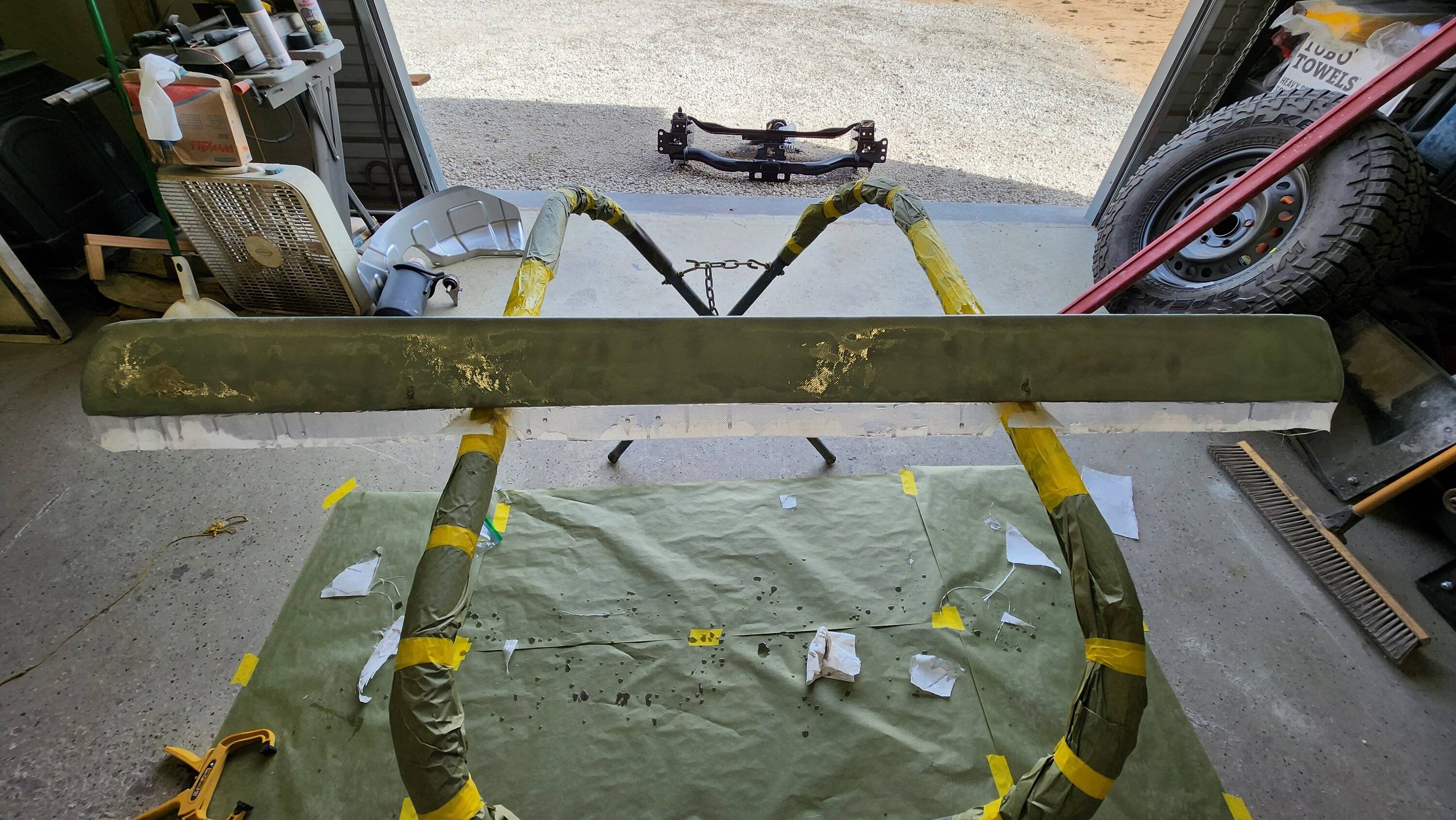

Pictured, the visor is fully shaped out. Because I'm going to use fiberglass, I had to cover the foam with cathair bondo.
Jeep Gladiator Retro Gladiator build, my modern take on the Old Honcho 20230312_142931
Three layers of fiberglass and lots of sanding later. Loved the idea of building this. Did not love the itchy after affects of fiberglass.
Jeep Gladiator Retro Gladiator build, my modern take on the Old Honcho 20230408_173106

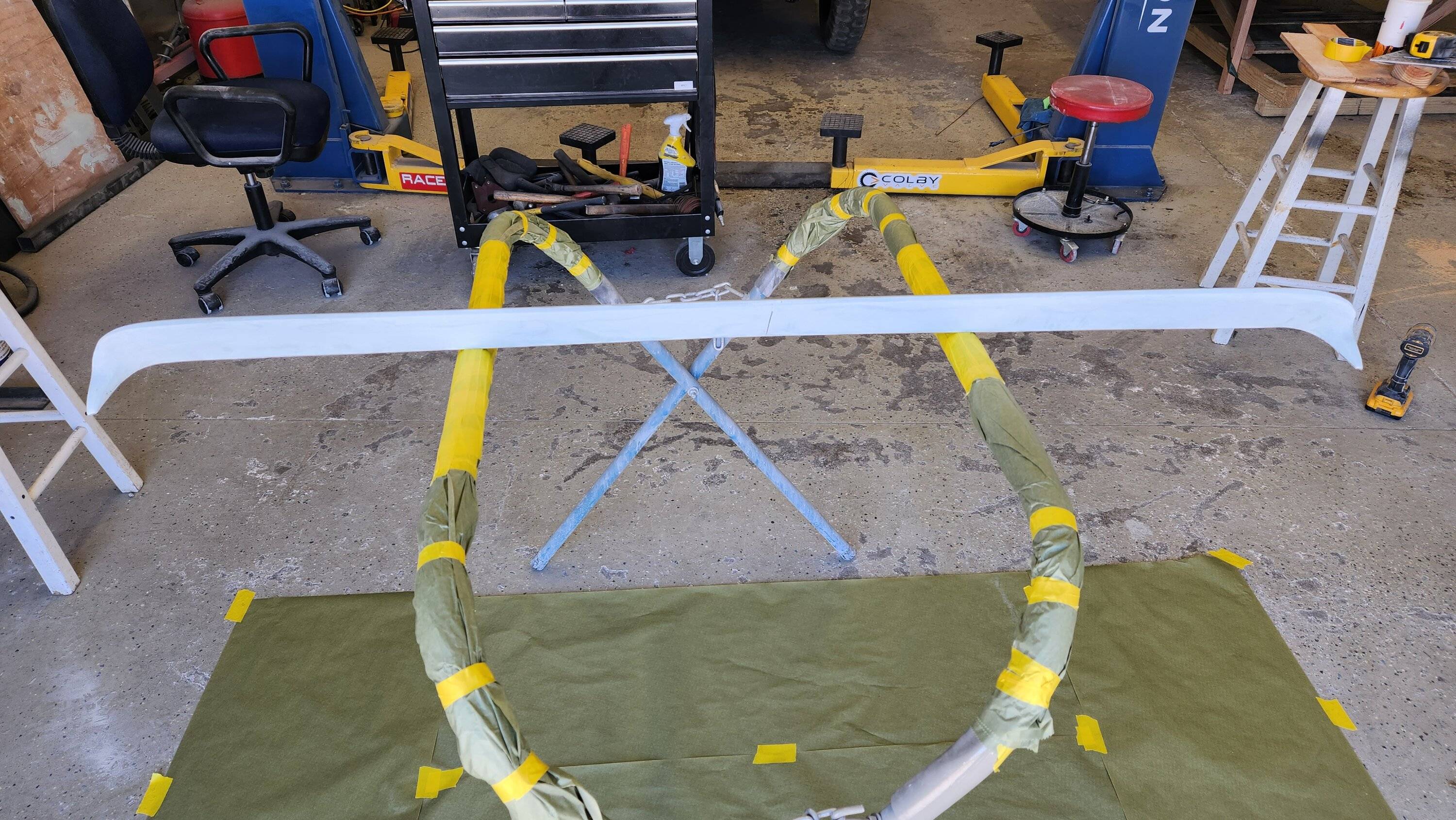

A coat of sealer and 3 coates of poly high build primer. Off to the paint shop with the other parts.

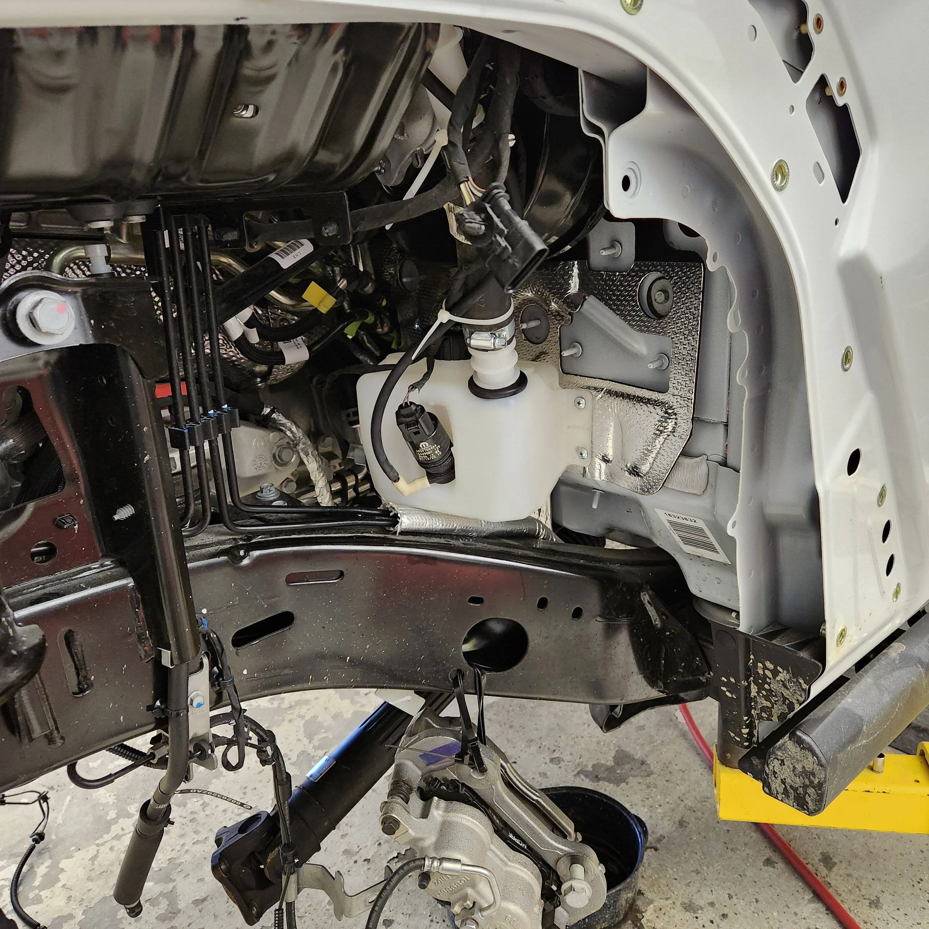

This may not seem like much. The factory washer bottle on the diesel is located here and hangs over the frame. There is no way to fit 40's without removing the bottle. I ordered a bottle from a plastics company and fitted it to the factory filler neck and motor. When the hood is open you can't tell the difference and it still hold a half gallon of fluid. Suspension is coming in the next post.

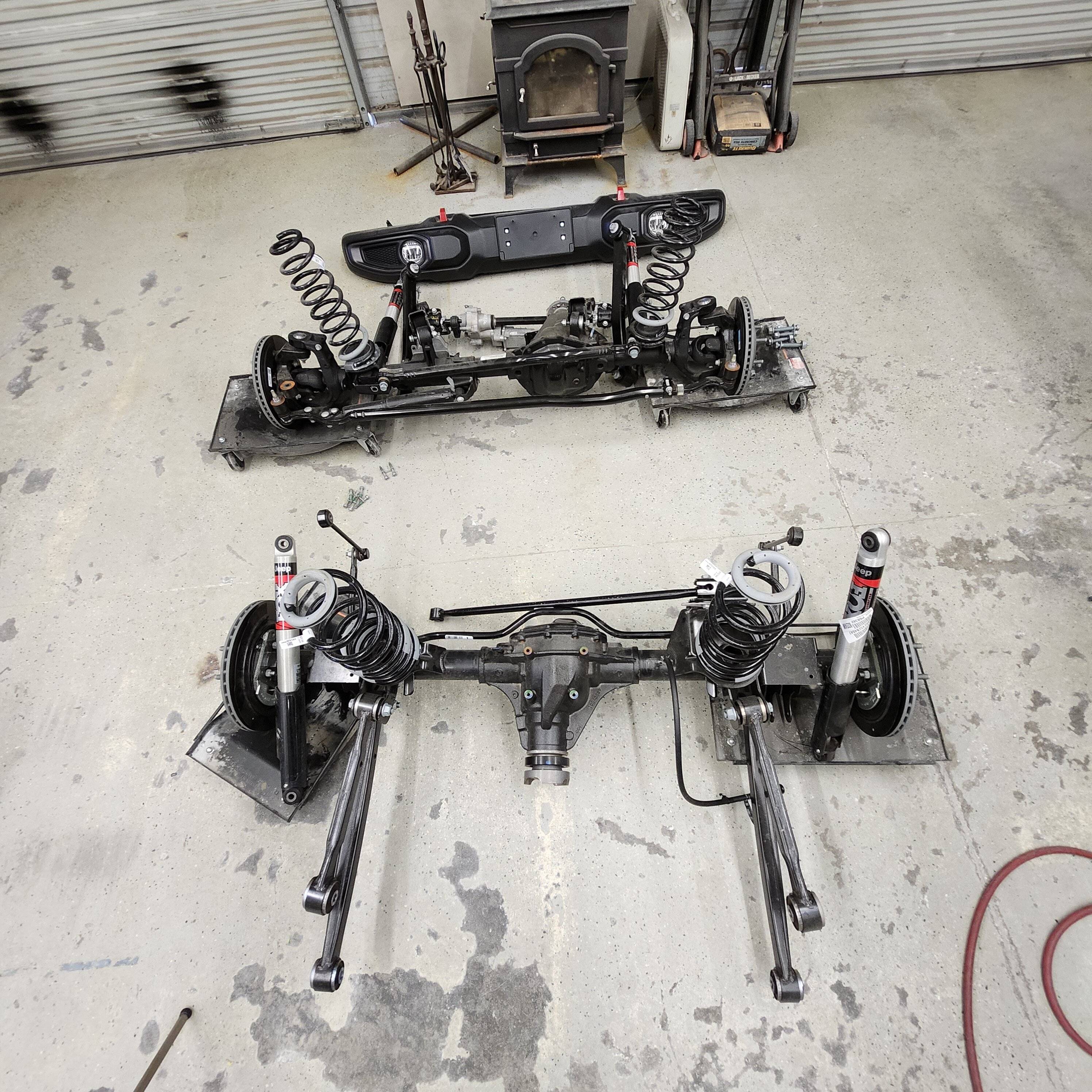

I always planned on upgrading the axles so the time to do the suspension is while all the parts are at paint.
Jeep Gladiator Retro Gladiator build, my modern take on the Old Honcho 20230416_094218
I have to say, all the post about how much rubicon axles are worth are over rated. Took 3 months to sell them and dumped the price several times. These axles had less than 500 miles on them and worth less than 4k.
Jeep Gladiator Retro Gladiator build, my modern take on the Old Honcho 20230416_181933

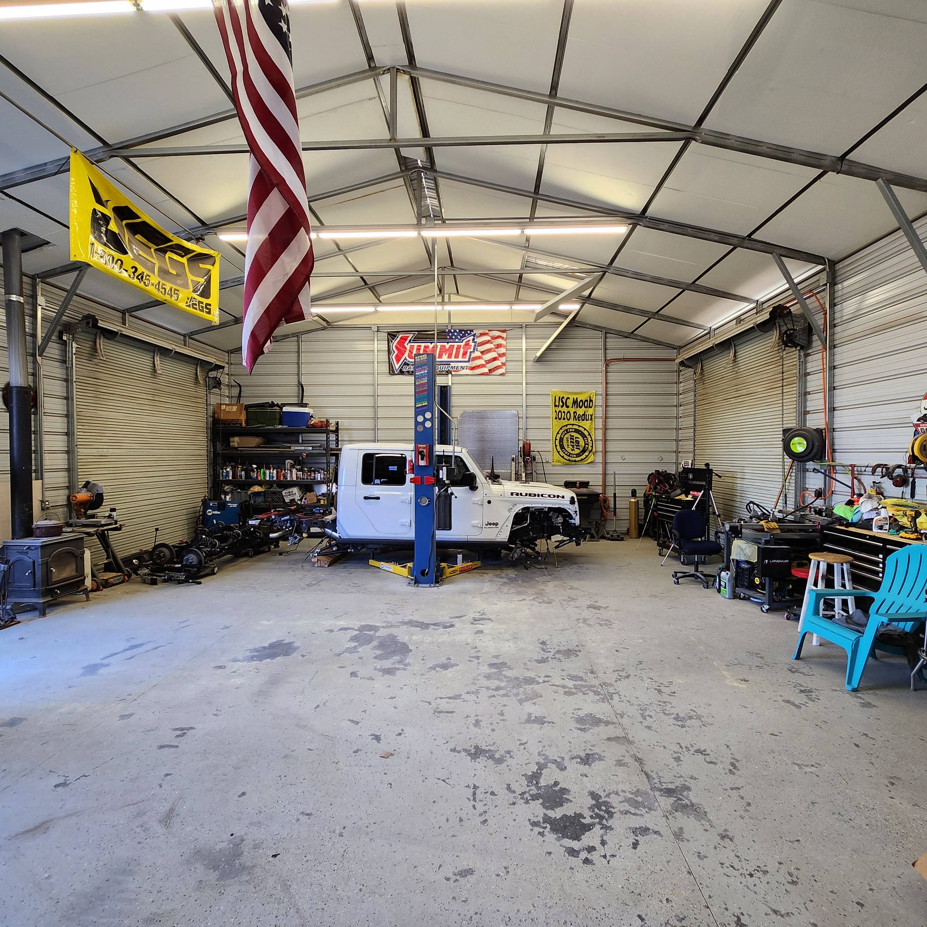

I affectionately refer to this as the safest photo ever. A build this big is painfully slow.
