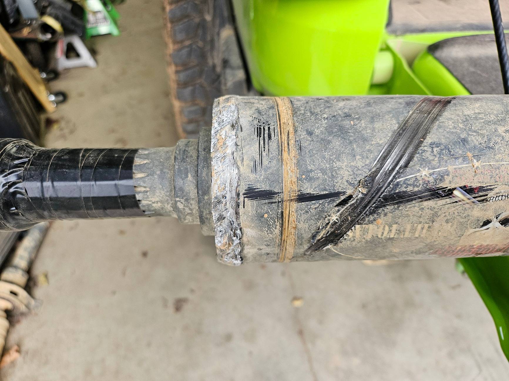

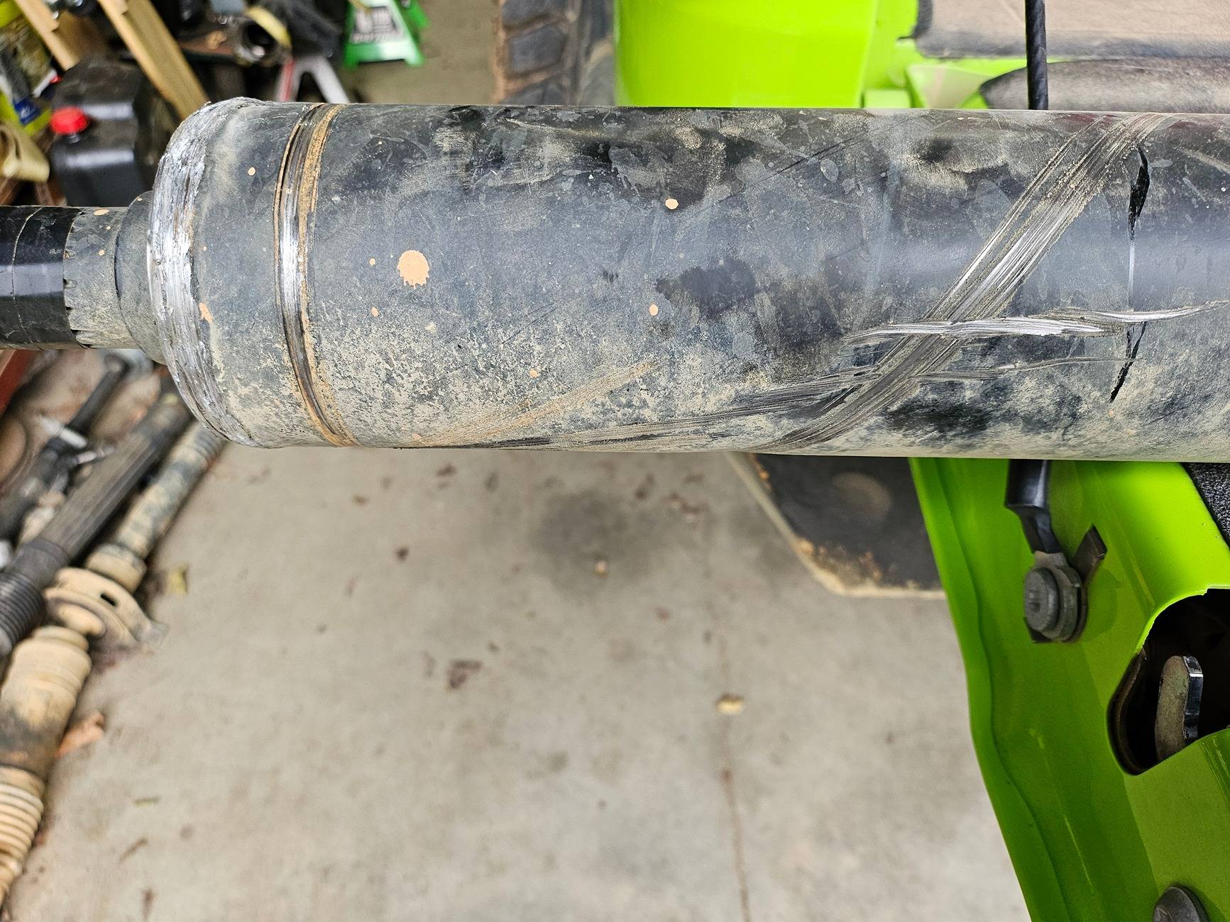

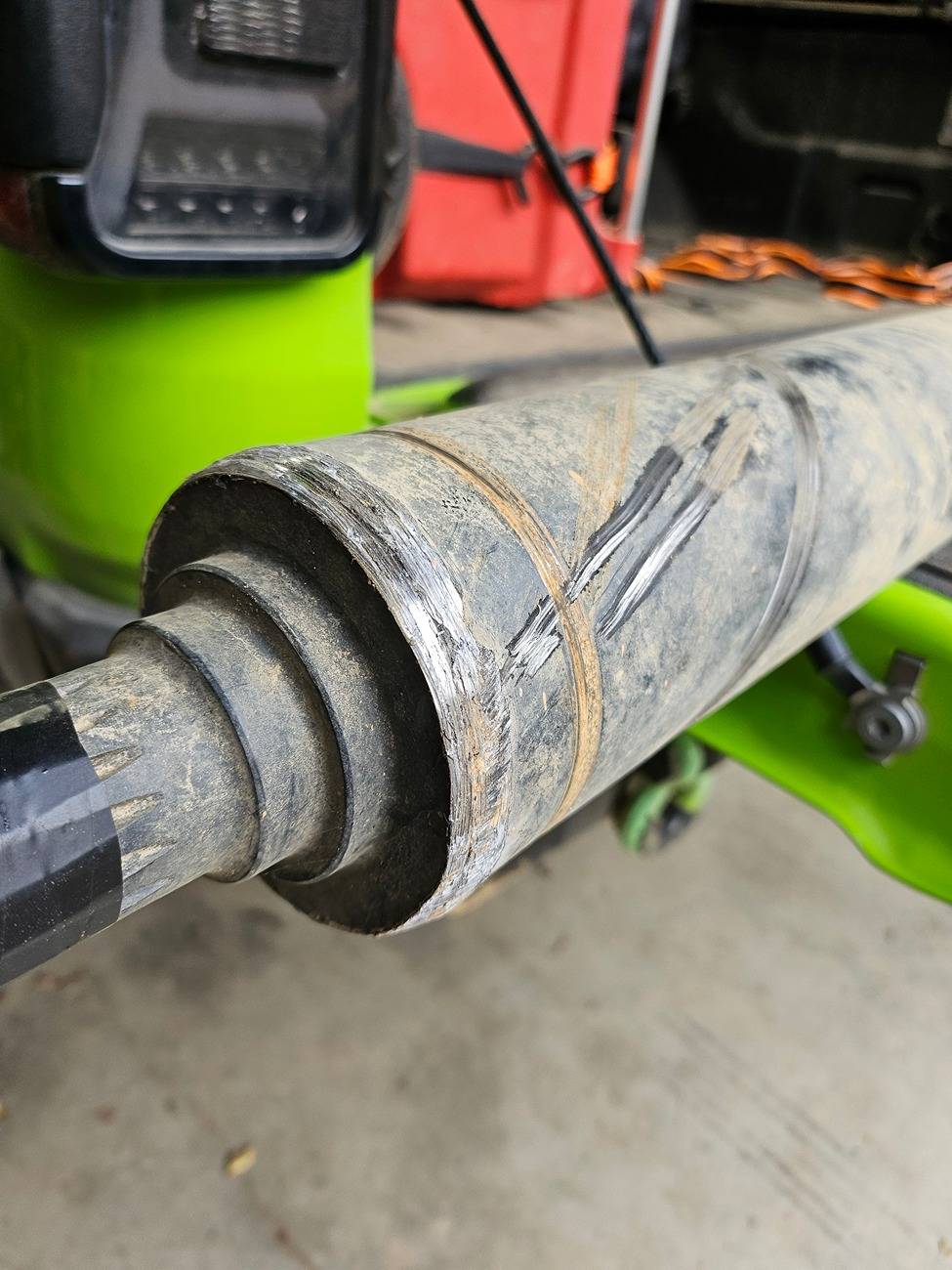

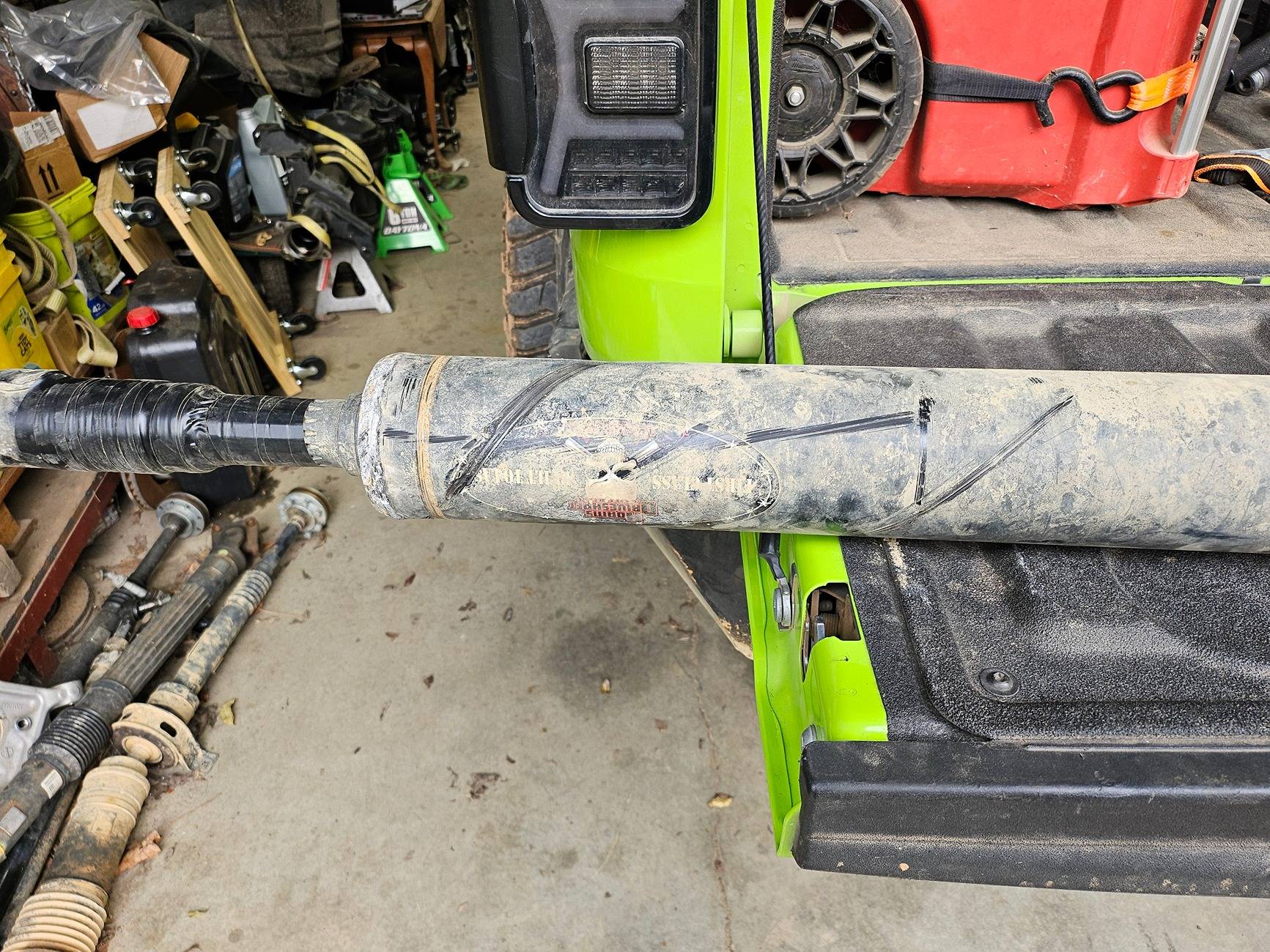

I got into some BIG rocks last weekend over at Uwharrie NC. It tweaked the rear drive shaft and now it vibrates worse than it did before. Adams said they will re-tube it and cover the labor but I will pay for shipping and the tube. Anyone ever ship a drive shaft across country? It's gotta go from TN to Vegas. I don't know if I should try to box it or just slap a label on it and get it insured and call it good. It is dented and the weld is really ground off so its a matter of time until it fails completely. Glad I kept the OEM one in the shop.

Yes all the weights are still intact. The larger weight on the slip yoke has a chunk ground off it. It's a tough shaft for sure but with a spiraled dent it will eventually break. Before the damage, It's not a bad vibration but it's there. It's always had a slight vibration. It improved when I adjusted the pinion angle but never went away. I have the stock shaft back on now and it's smooth as silk.
i had a vibration on mine it was pretty noticeable after 55mph. my pinion seal was leaking and removed driveline. When we reinstalling it i noticed the u-joint caps wanted to slide off when clamping them. took the time to make sure they were seated properly and 98% of the vibration went away. i could see a lot of people not paying full attention to this as it was over looked by me as well. just a small detail i caught.
