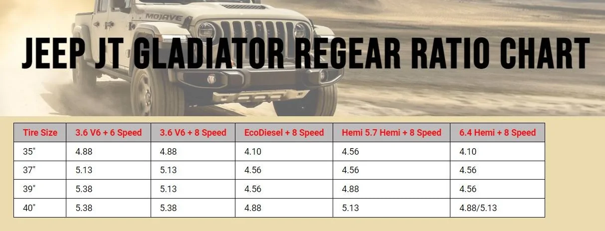

Ok, I’m sorry for being responsible for yet another question about regearing. Trust me, I’ve been immersing myself on the subject to the point of feeling like I know less now than when I started. Even people who I was thinking of as pretty damn knowledgeable had contradictory opinions and advice.
So, my ride is a Texas Trail version. It came with the 3.73 gear ratio. I just upsized the tires to the BFG All Terrain T/A K02’s 315/70R17’s (C2).
I’m waiting on the Veepeak Bluetooth device and cable adaptor and currently I’m really only planning to modify the tire size and the gear ratio IF THE LATTER IS NECESSARY. I’m confident about the tire size needing to be recalibrated, but because of all the contracting opinions about the regearing I’m not sure what to do. I realize I could just play around with the setting until I’m satisfied, but I don’t really want to have to jack with that damn bar down there under the dash that makes access to the cables exponentially more difficult than it had to be.
The only other thing I can add is shifting in this thing is NOT impressive and it’s been that way since new. Never have the display set to where I can see the gear but it seems like it really sucks going from either 3rd to 4th or it might be 5th to 6th. I’m so used to it now I don’t really pay that much attention.
So anyway, I’d be forever thankful just to hear what you’d do. The area I’m in (bit west of Ft. Worth) is about as flat as it gets with the odd rolling hill added for good measure. I rarely have the opportunity to get off-road and it’ll never be climbing rocks. I’m leaning towards 4.10 but I know there’s a lot of people that would say stay with the 3.73. As I was saying, I realize I could just play with it and see how it drives between 3.73 and 4.10, but I’d really rather have to jack with that bar down there once. My hands are just way too big for getting in and out of that area.
‘Thanks a ton for listening. I appreciate it.

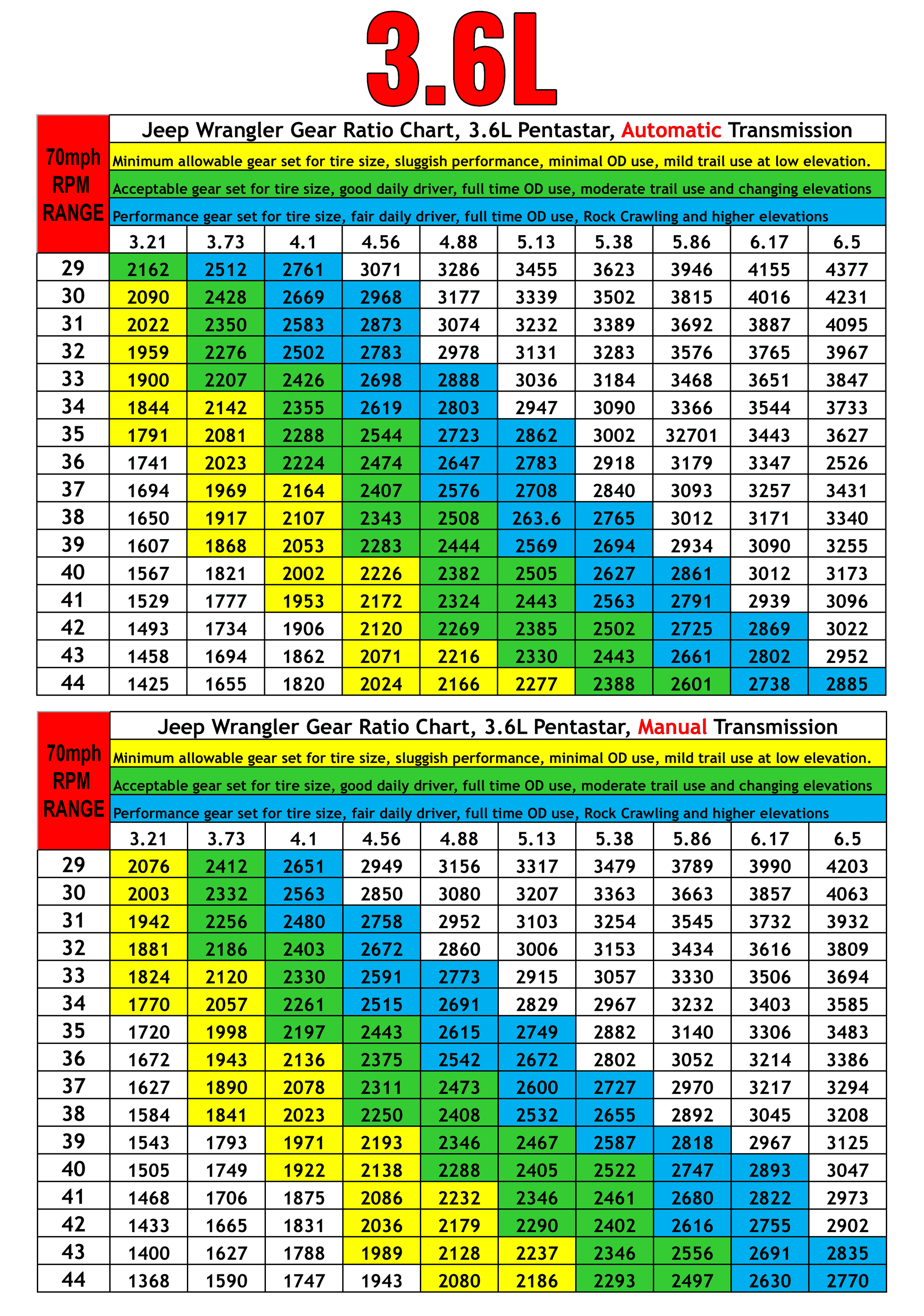

That is the wrong chart. It's for a 6 speed auto. RPM numbers are not correct for the 8 speed.
4.88 with 35" tires (assume 34.5" actual height) in 8th gear at 70 MPH = about 2,300 RPM.
Thank you. But now I am really confused...
I am trying to figure out what gears would be the same for a 37" tire as a 35" tire with 4.56.
Hoping this may help! From my own personal experience, I've had the gearing changed on several rides to get the trans/engine/powerband back in line with my tire size and intended use. You will also need to recalibrate for the gears/tire size (Jscan or Tazer).
With the 3.6 auto 8 speed:
35's/315's - I found 4:56 gears to be perfect for my use (Highly recommended).
With 37's I changed to 4:88 gears (if I had been at high elevations or maybe rock climbing I would have gone with 5:13's for sure).
I'm now driving a JTRD with 37's and 4:56 gearing, which is perfect for my use and is one of the best improvements I've made to date.
You will read lots of comments on the forum "for doing or not doing" a gear change. Personally you will feel a marked improvement in performance/gear shifts, etc., by changing the gears, especially going from 3:73 to lower gearing like 4:56. (4:10's will be fine with 315's BUT if you go to bigger tires in the future then you'll be "under-geared" again)
Now the other issues (1) Cost and Time (Dana gear set approx. $650 front and rear, Bearing install kits approx. $480 front and rear, and then labor - somewhere around $1,200 to $1,500), (2) finding a shop that can do the work correctly, (3) possible added costs for changing out other items (driveshafts, extended brake lines, etc., etc.)
4.88s on 37s is within 50RPM of 4.56s on 35s
4.88 with 37s is about the same final drive ratio as 4.56 with 35s.
