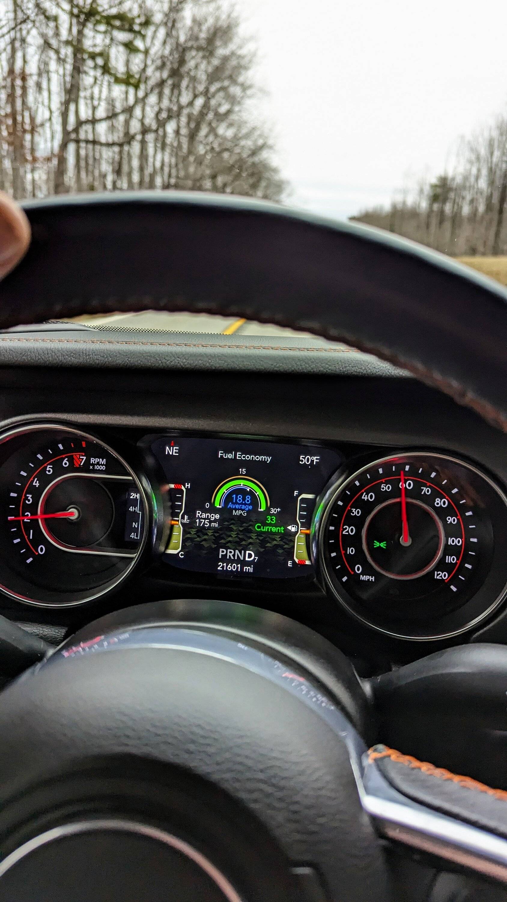

As far as your shifting concerns go, all I can tell you is that my Mojave shifts buttery smooth, and if it were not for displaying the current gear as I drive along, I'd likely not even feel it most of the time, especially in the 6-8 range.
'21 Mojave (4.10 gear) / 2 inch lift / OEM rims / BFG 35's / rural mixed / 18.5 MPG
