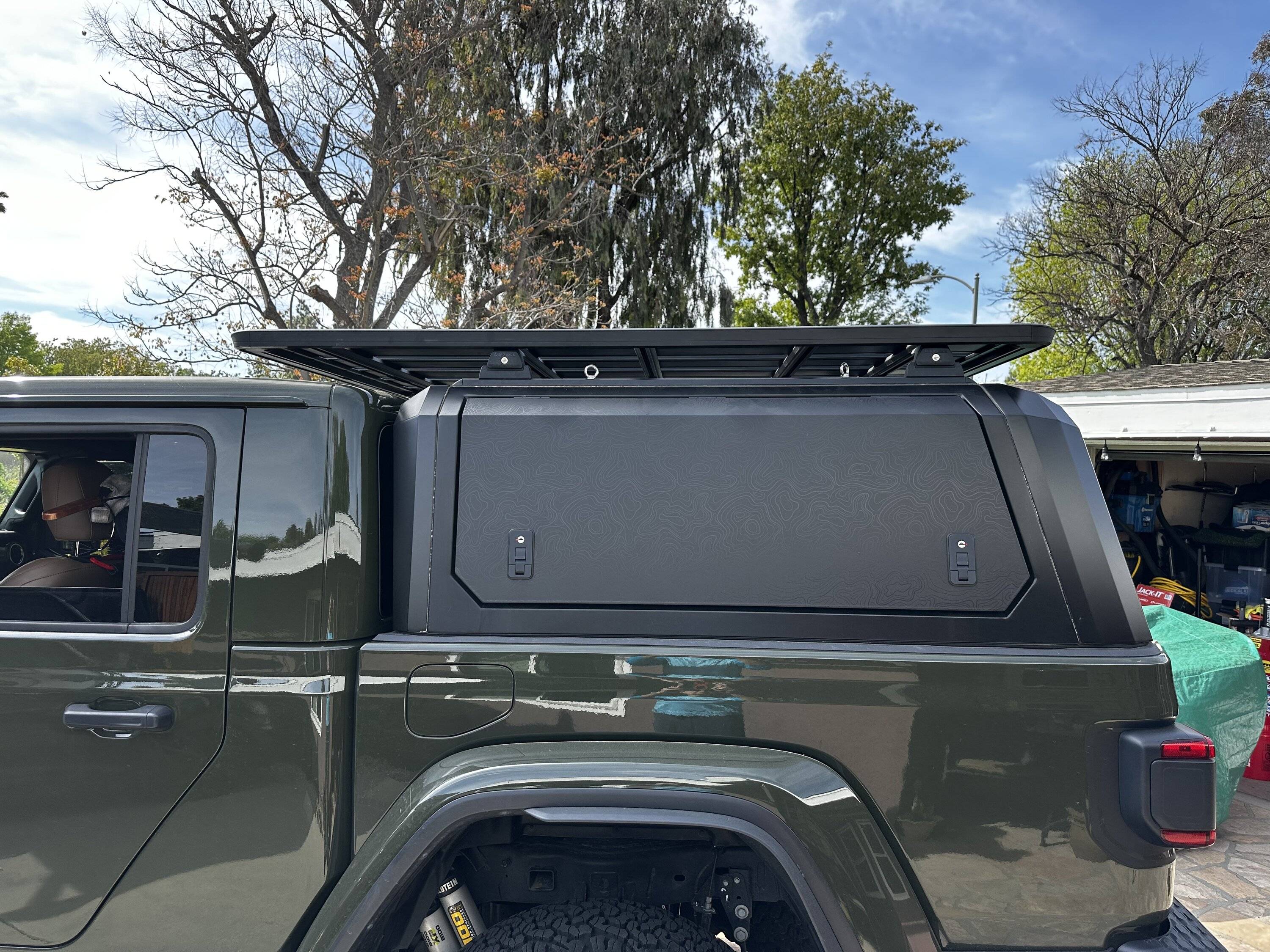

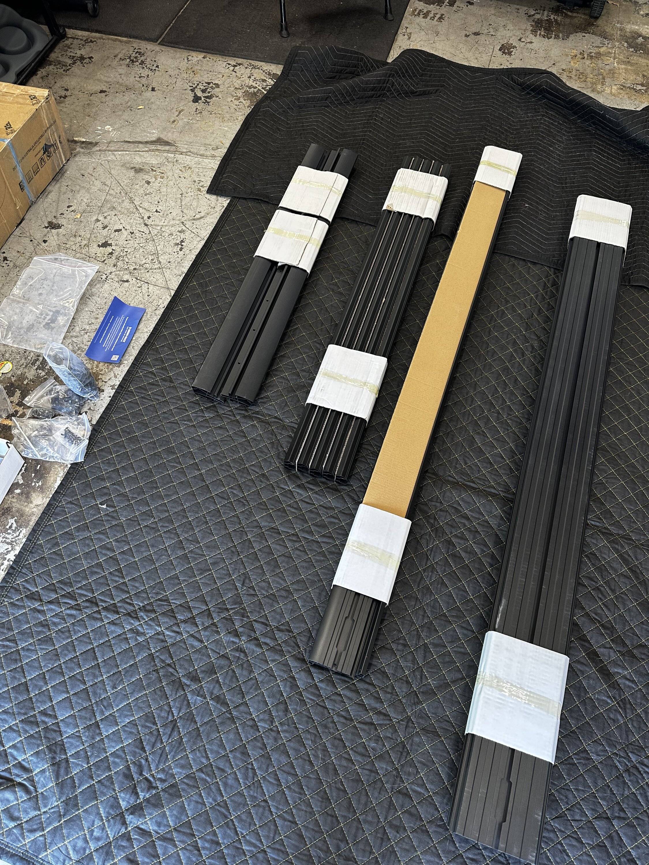

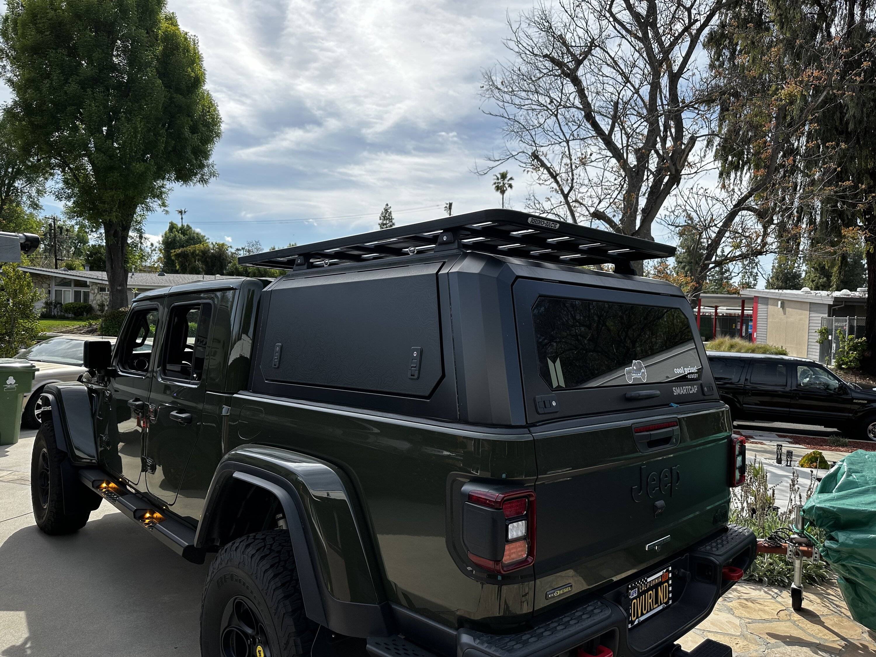

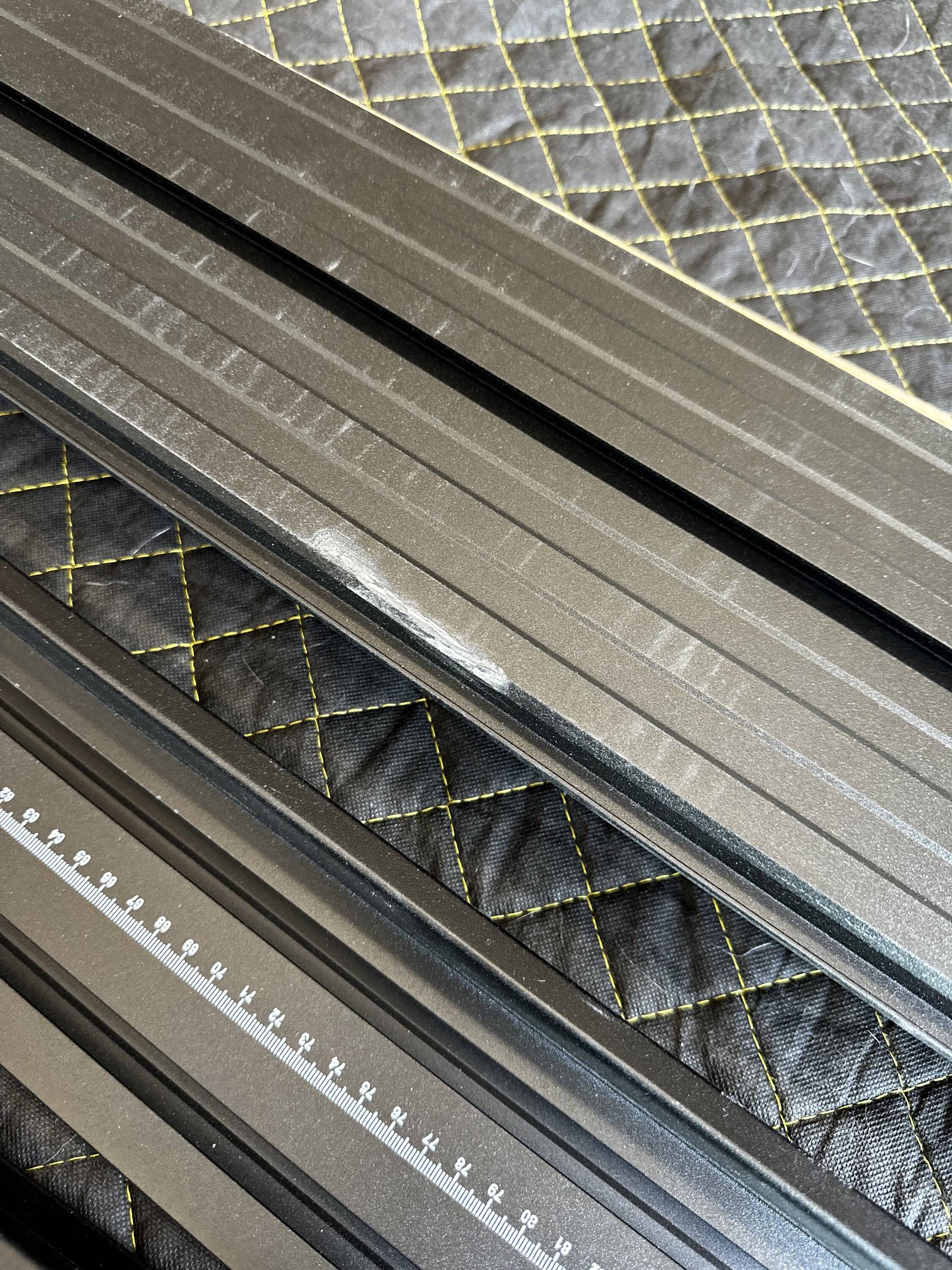

Added a Rhino Rack platform to the RSI smart cap today. Noticed that Front Runner and Rhino Rack show a rack the size of the cap as the fitment but wanted something that went over the cab a little. Was looking on CL for a used one. Last one I looked at was a literal POS and was $500. Ended up getting a scratch and dent used on Amazon for $479, about 1/2 price from new. Had to order feet as well, but got those on the used Amazon listing as well for $167. Both looked new when received and there was only one 2" scratch on the platform - zapped it with a little flat black and good to go.

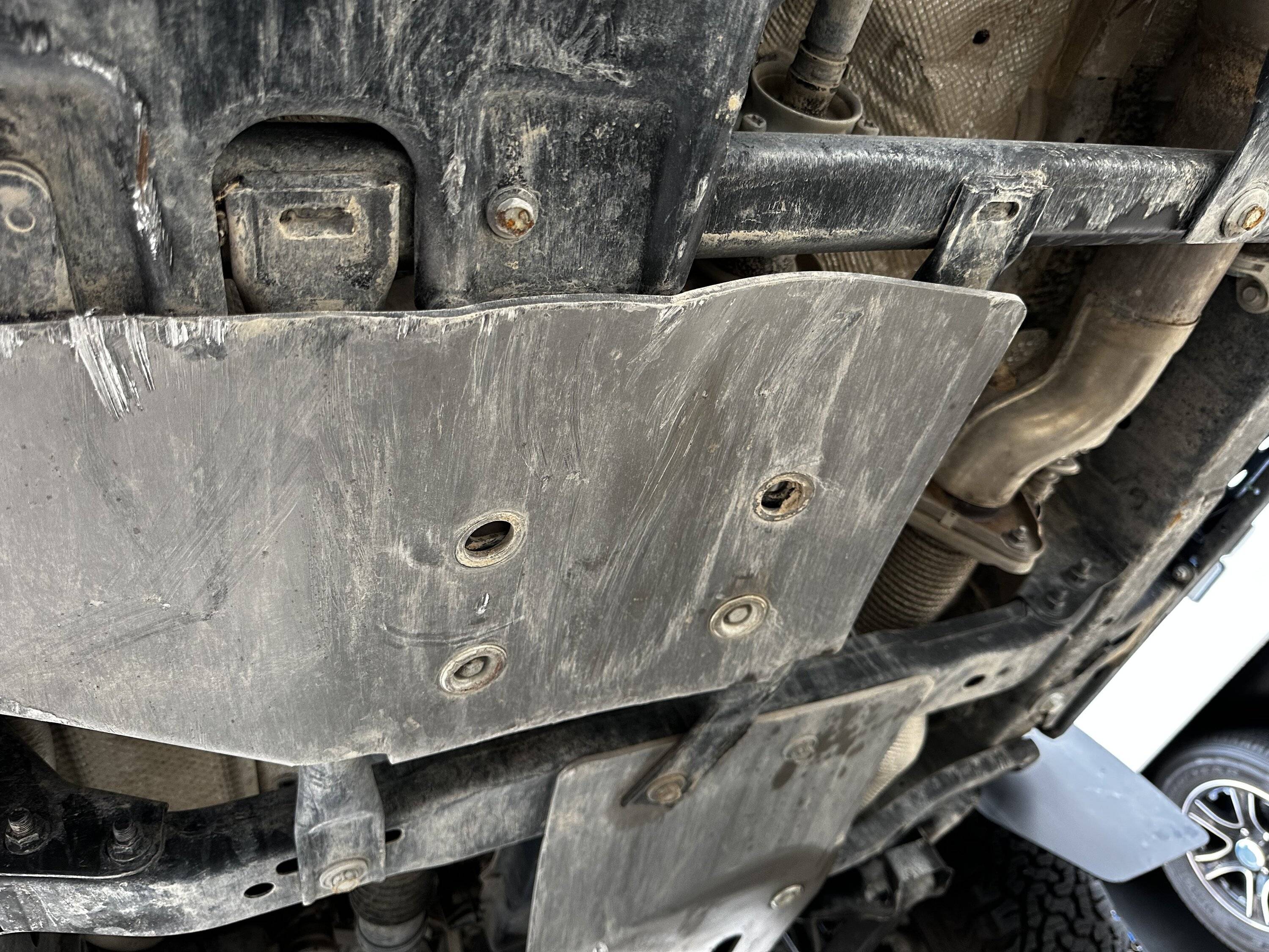

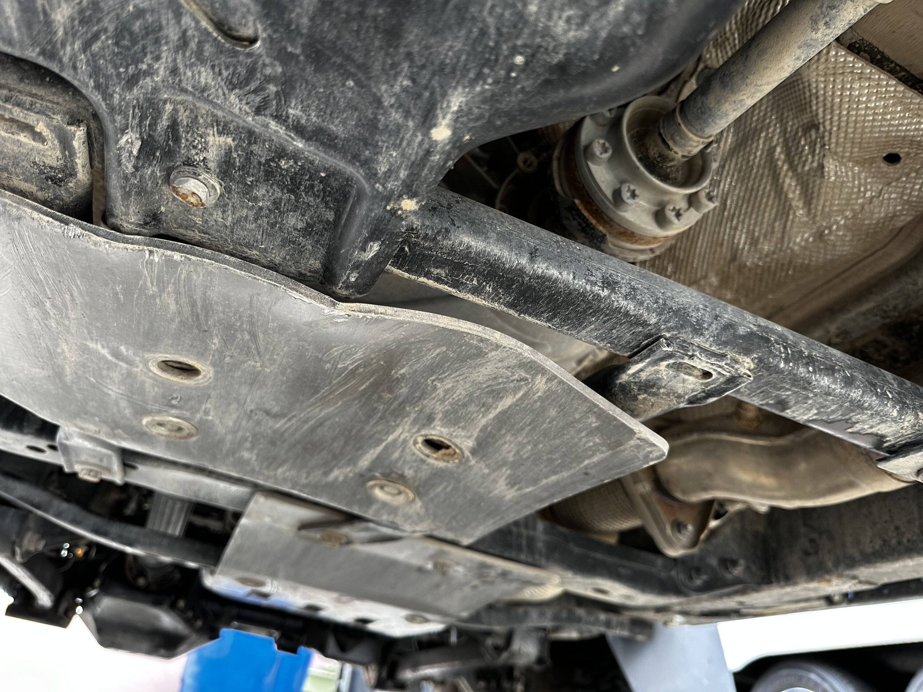

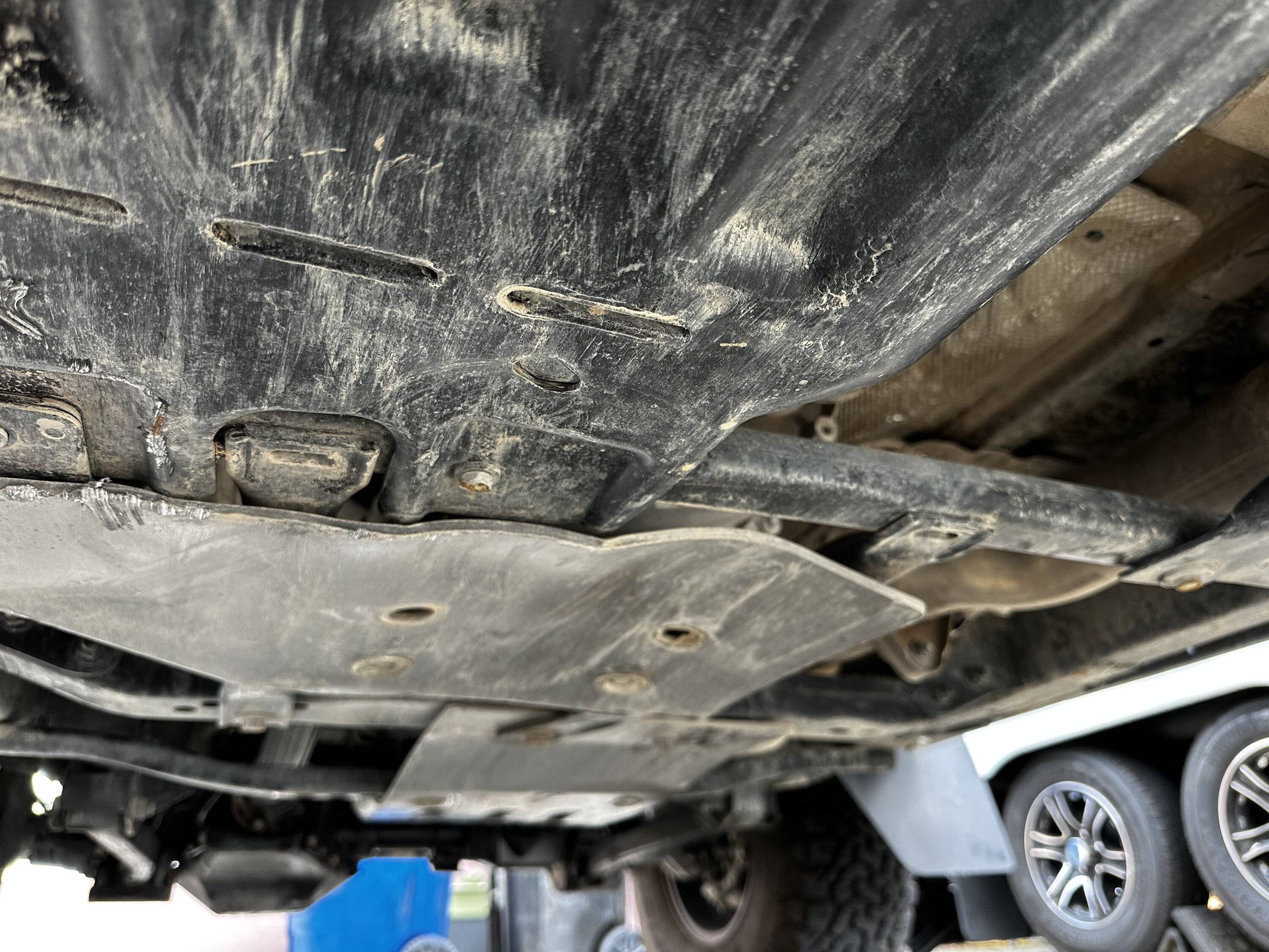

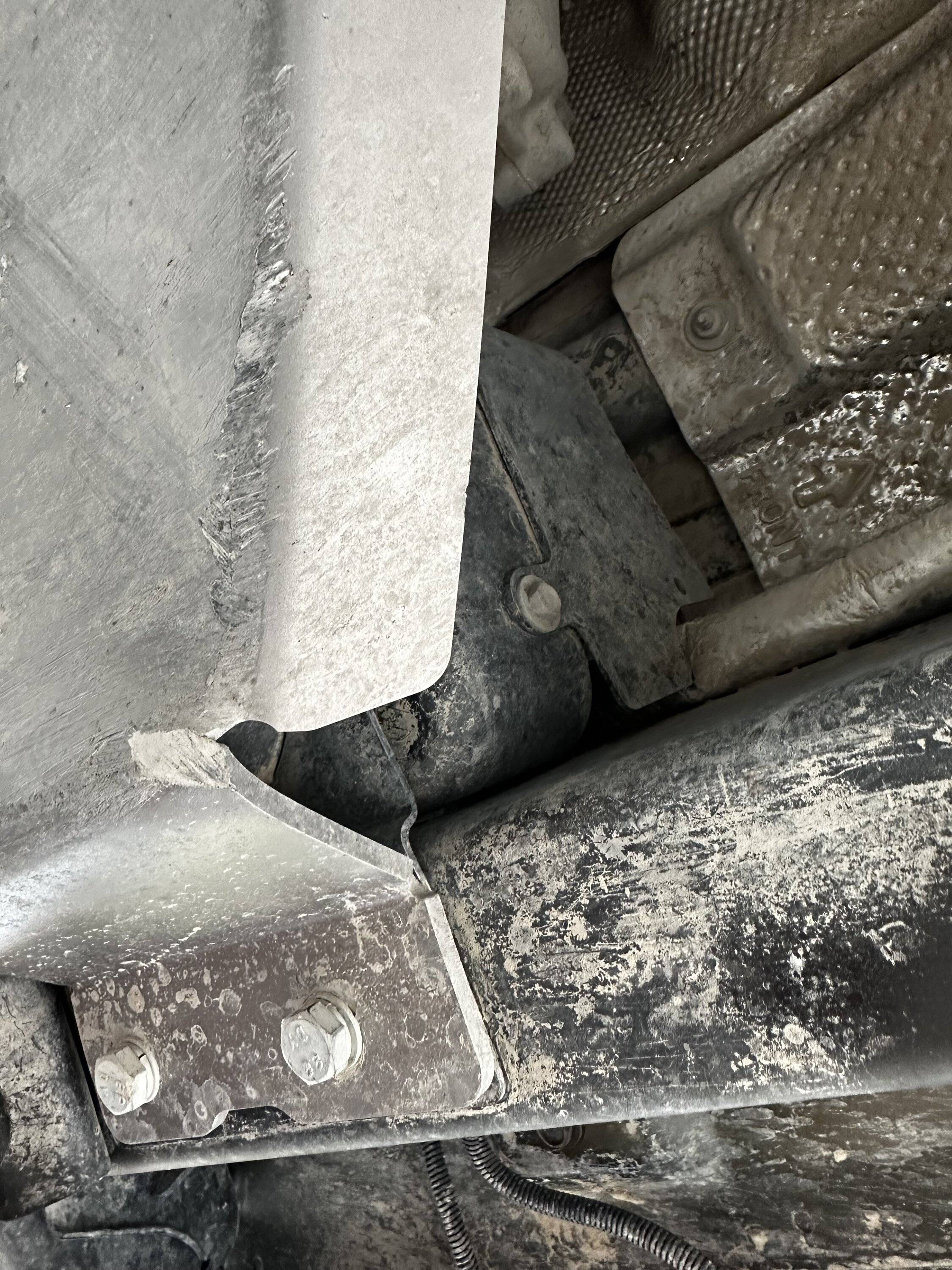

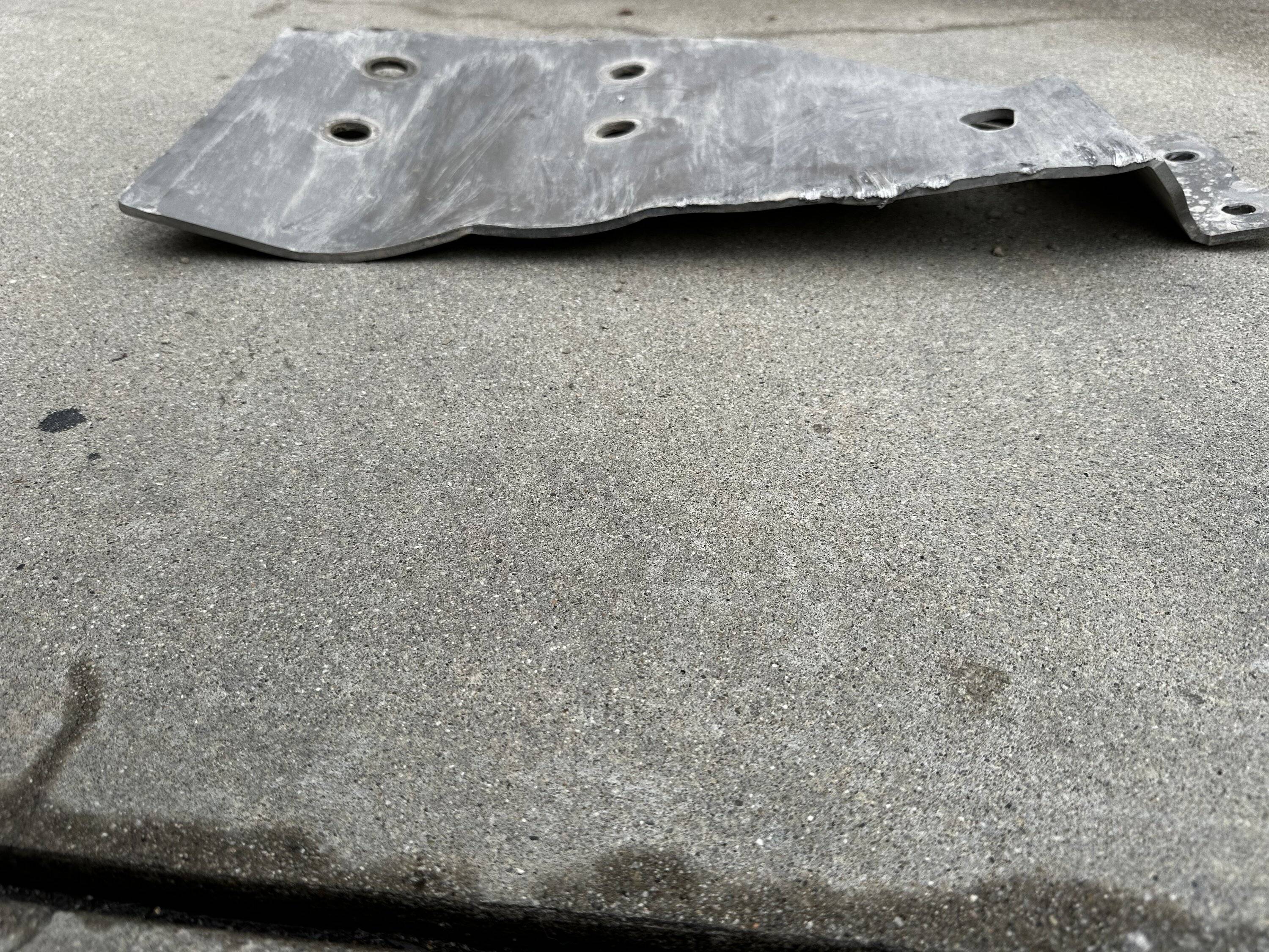

Fuel filter skid

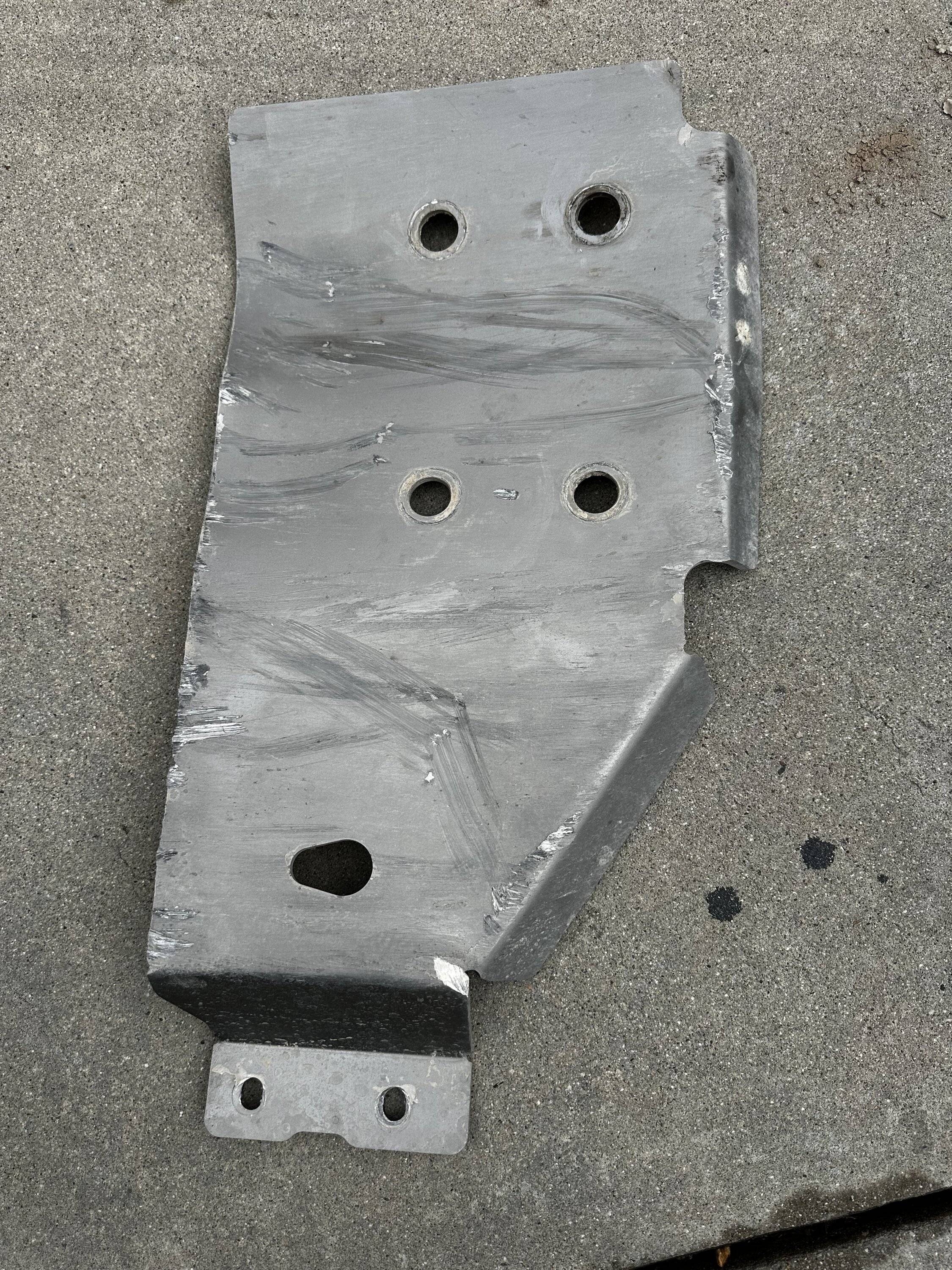

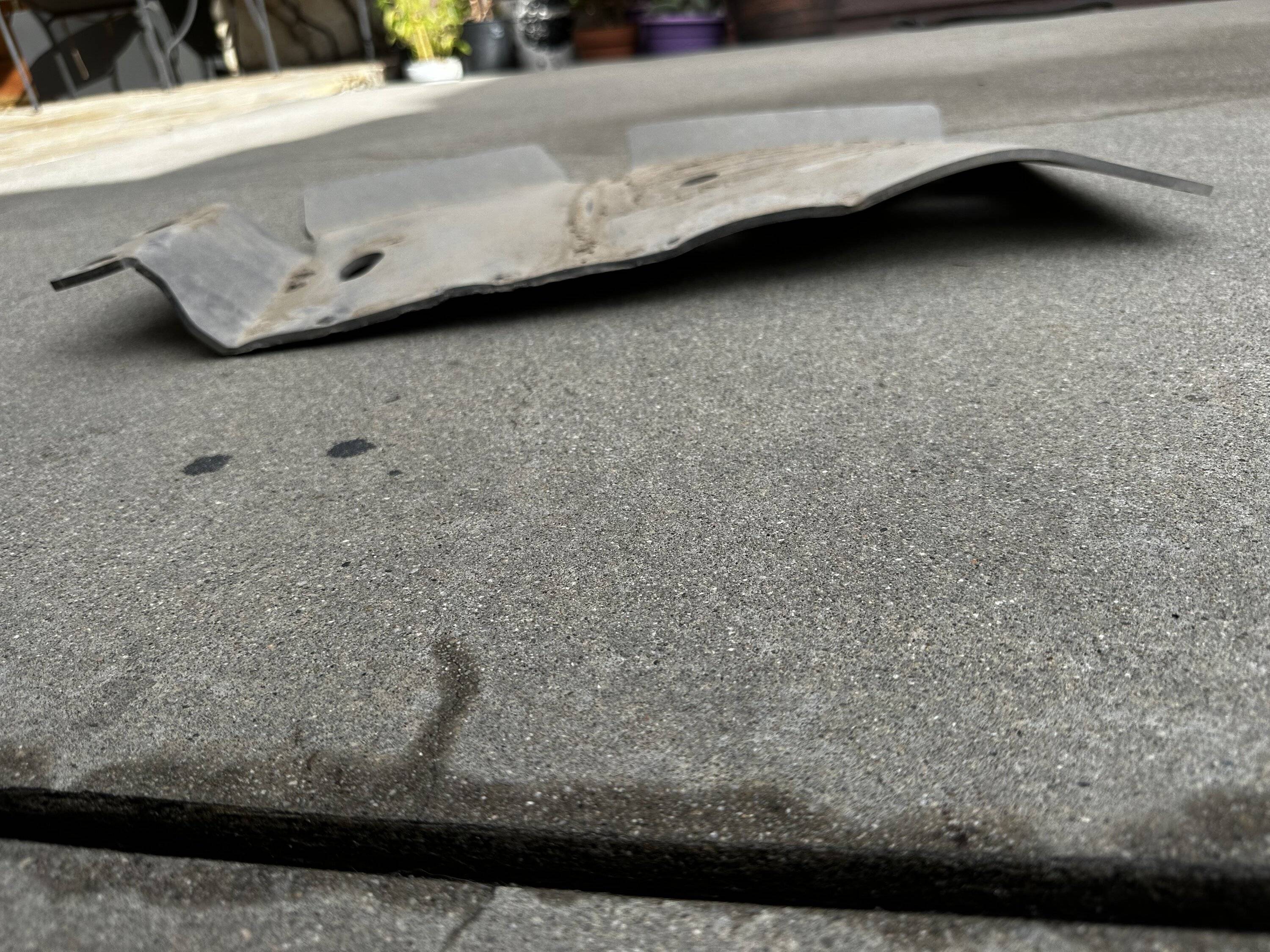

looks like you would be better off with some 1/4" steel plate welded to a 2x2 tube that get bolted to the frame rail.

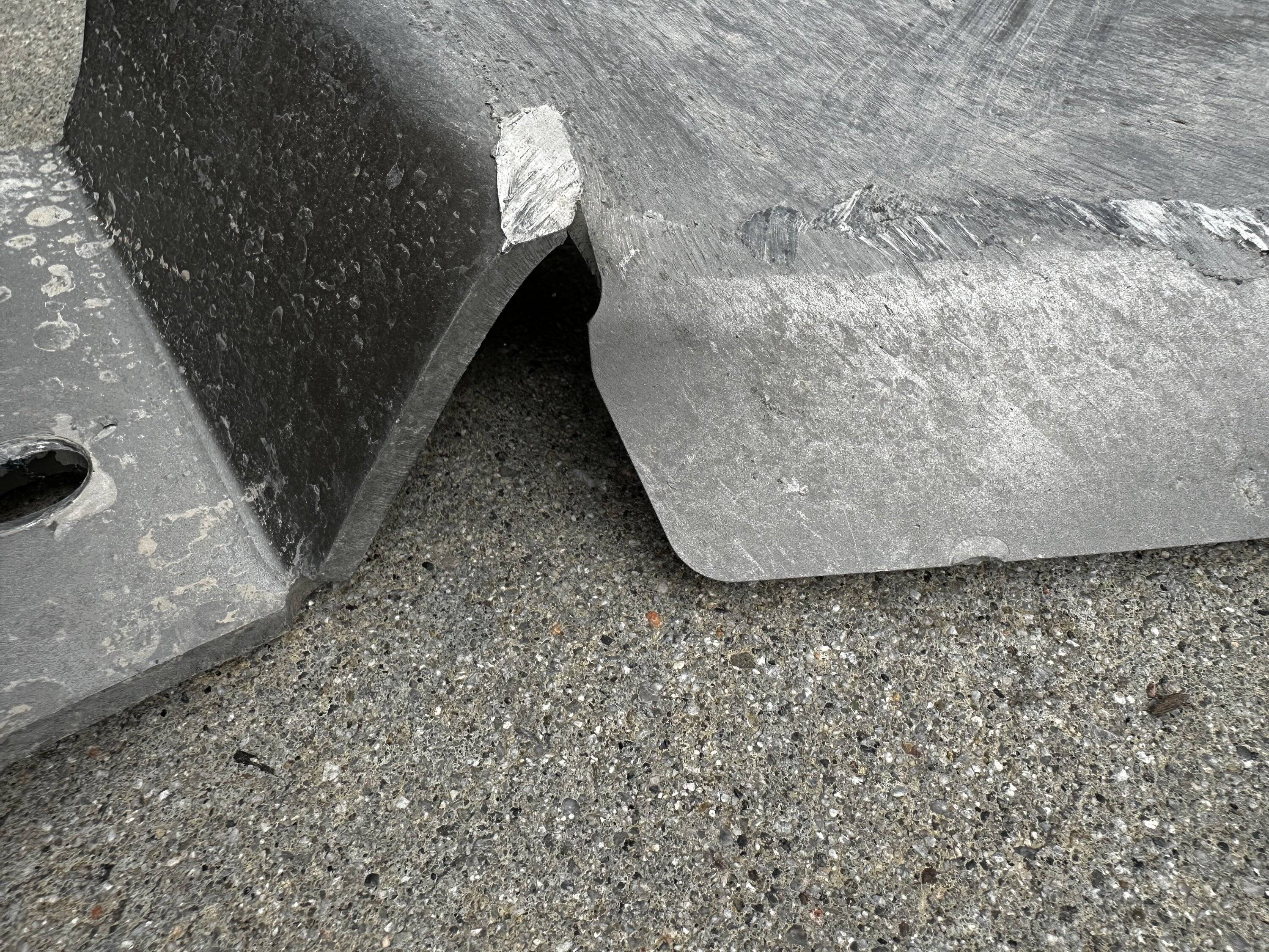

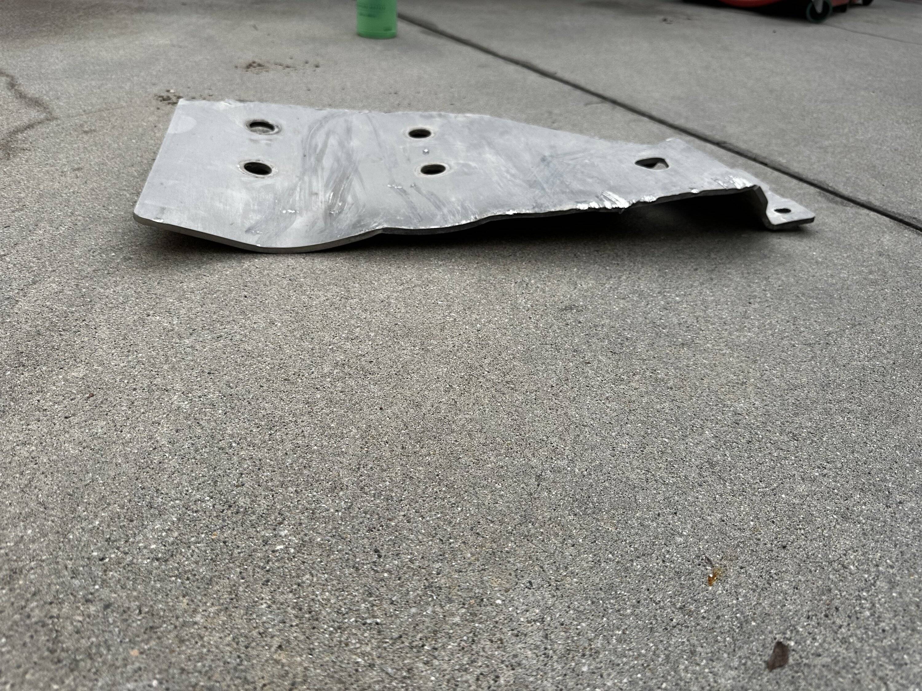

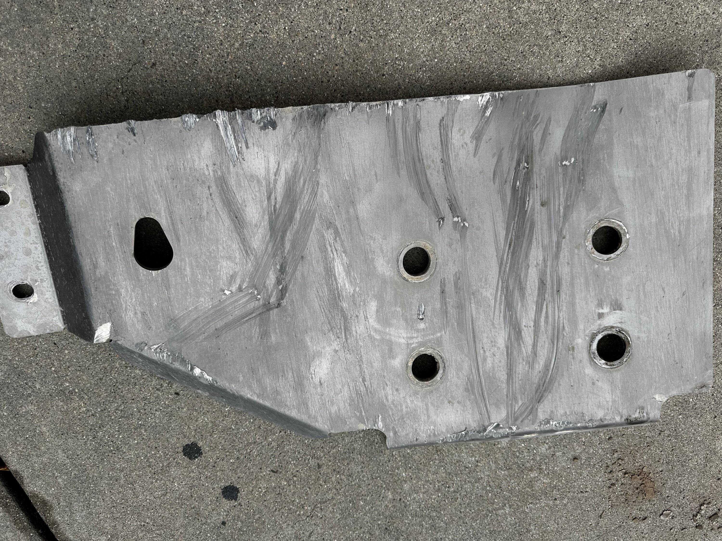

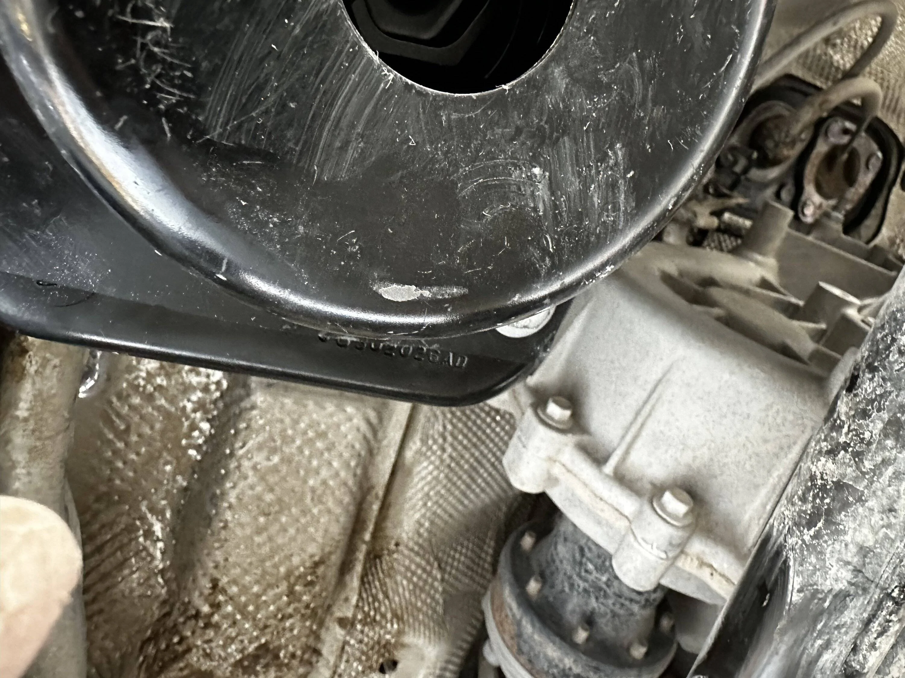

A hammer! The aluminum doesn’t cut it. I posted these up for the guys at Asfir 4x4 to take a look at. Sent them an email that it either needs to be steel or twice as thick aluminum.
It bolts to the transfer case factory skid and the frame next to the filter.
Mytruck is pretty heavy and a couple high centers on some rocks took their toll.
No complaints at all about the Asfir skids - I need a stronger solution for what the truck is subjected to. The oil pan skid has faired really well. Was trying to save a few pounds where I could.

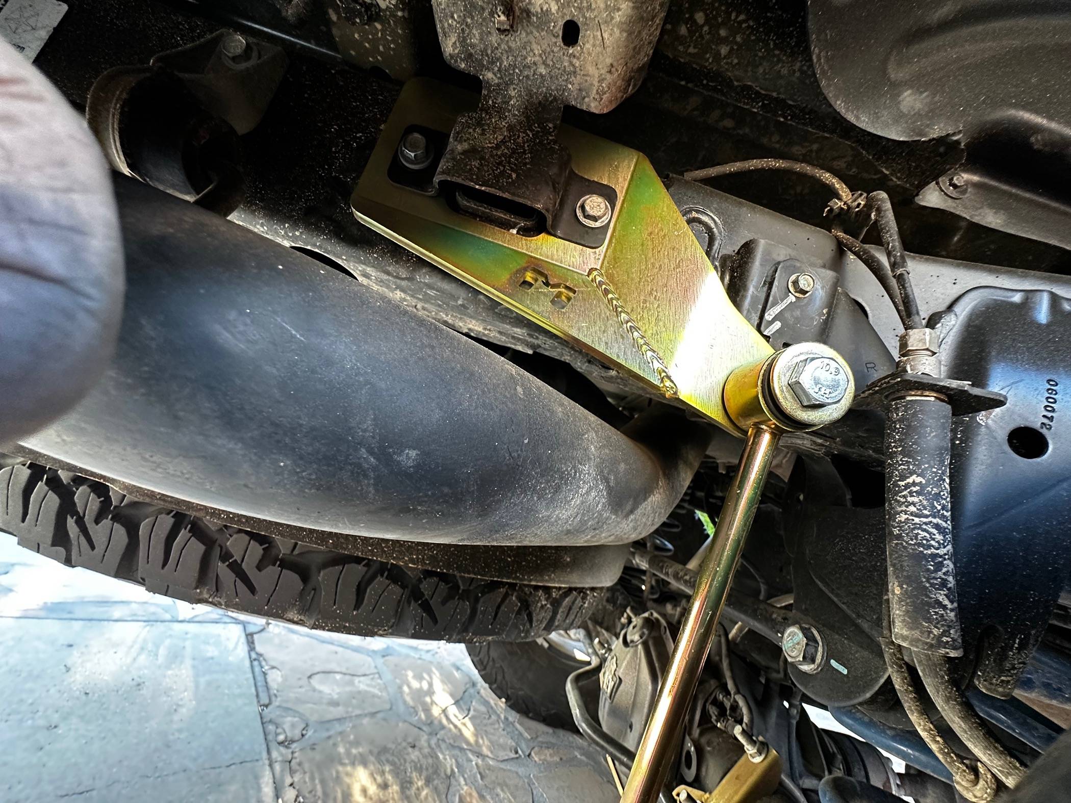

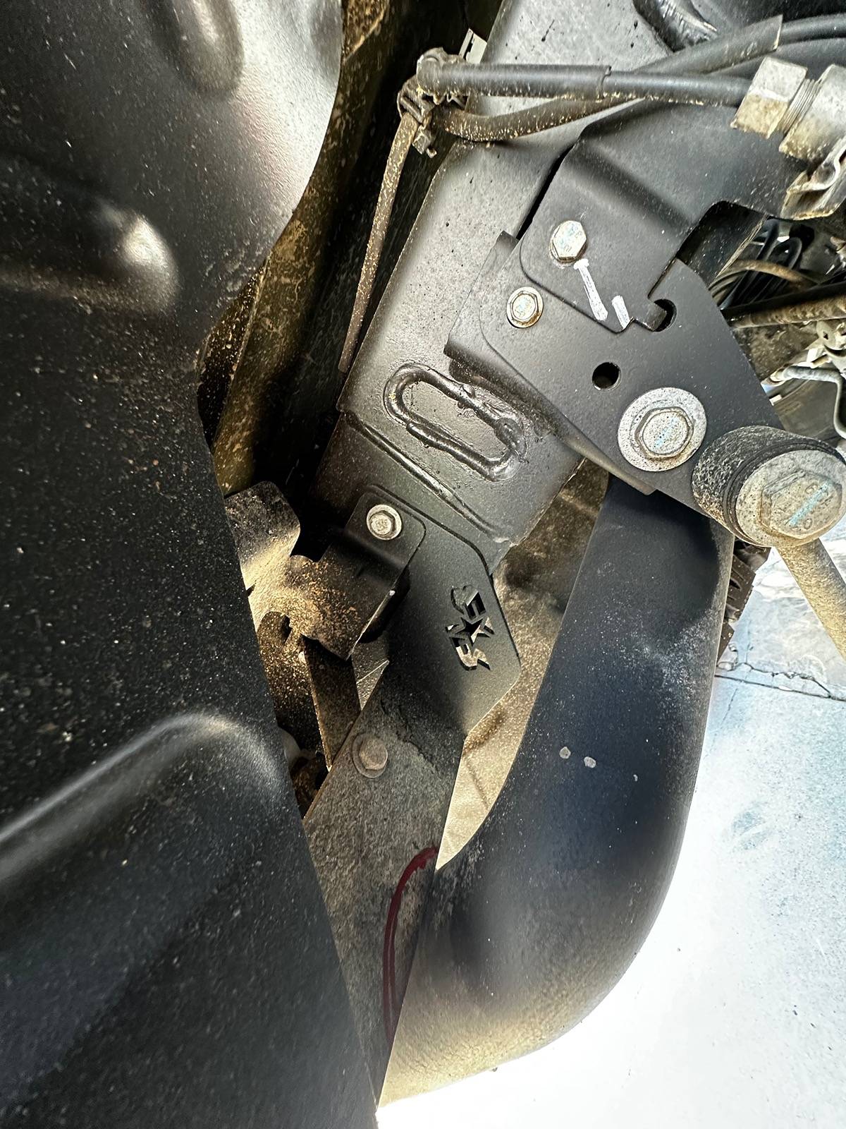

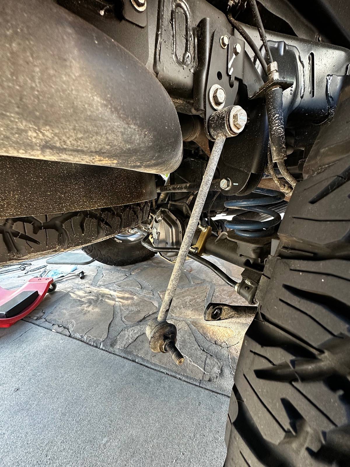

2022 JTRD AEV370

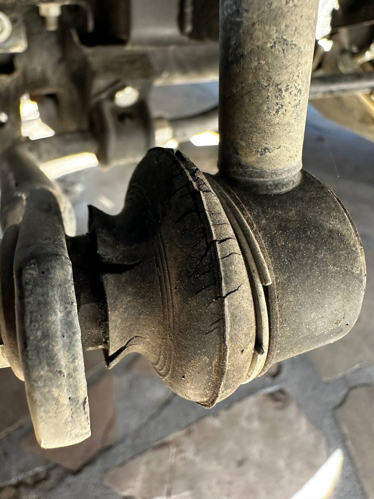

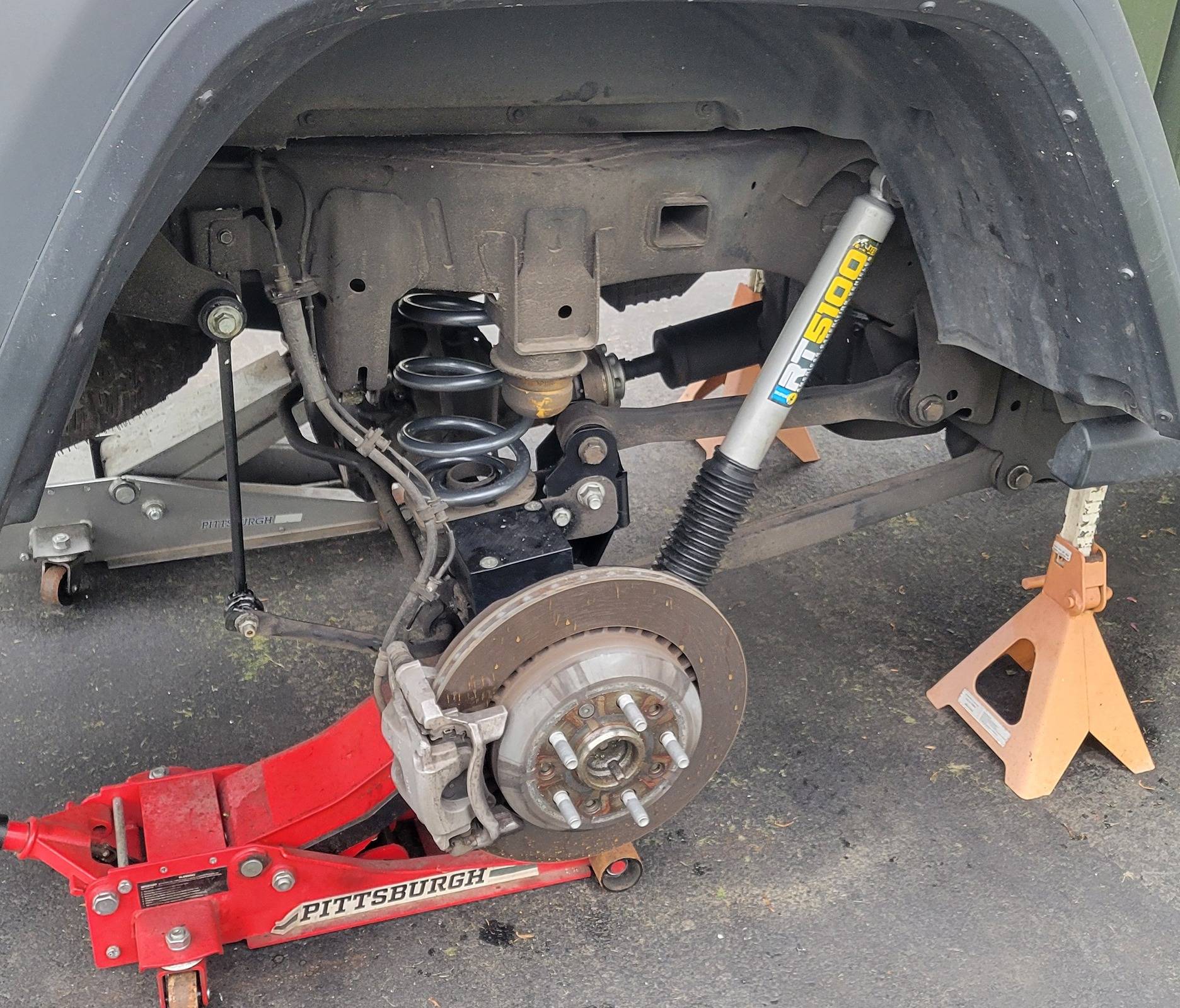

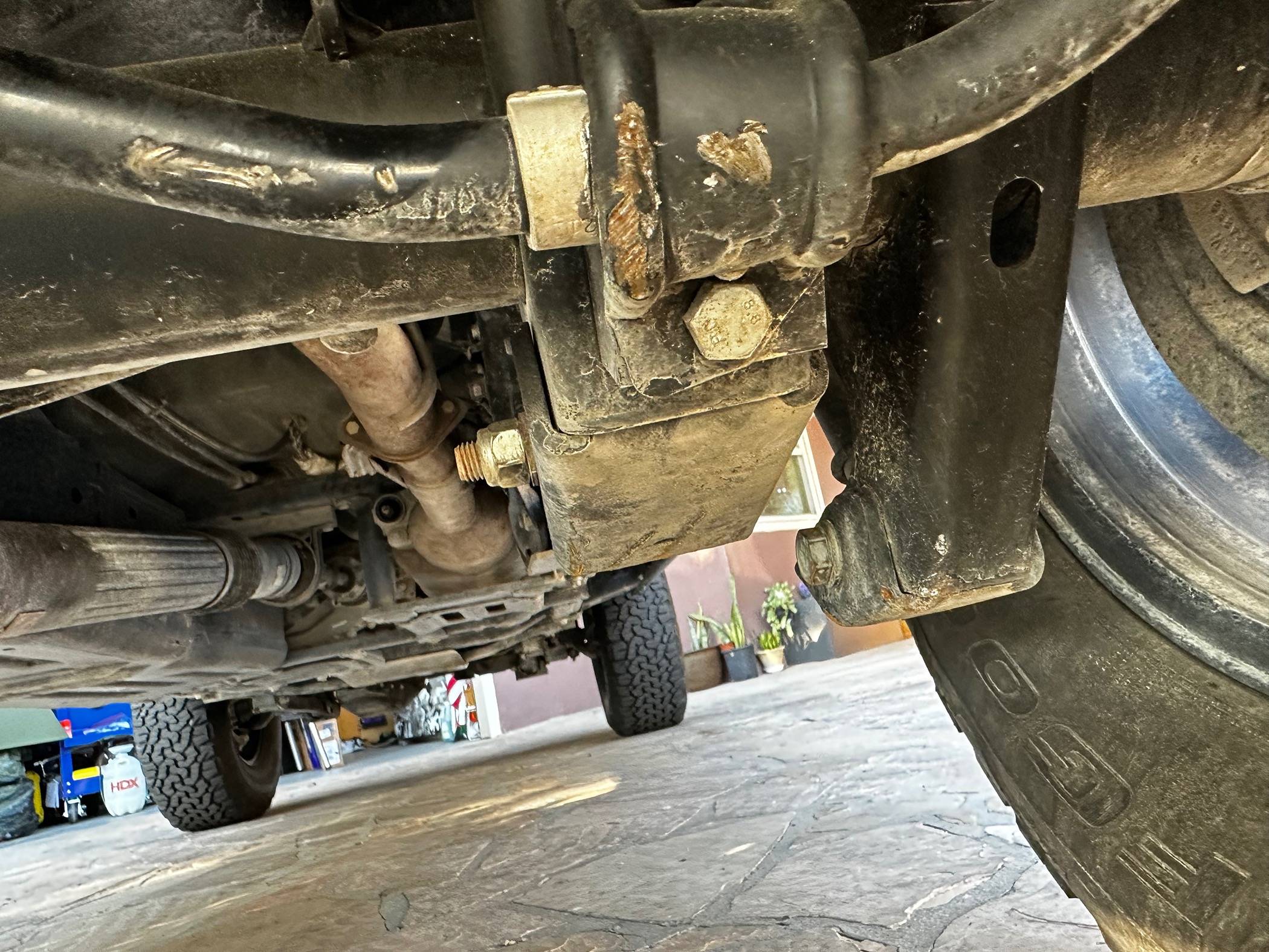

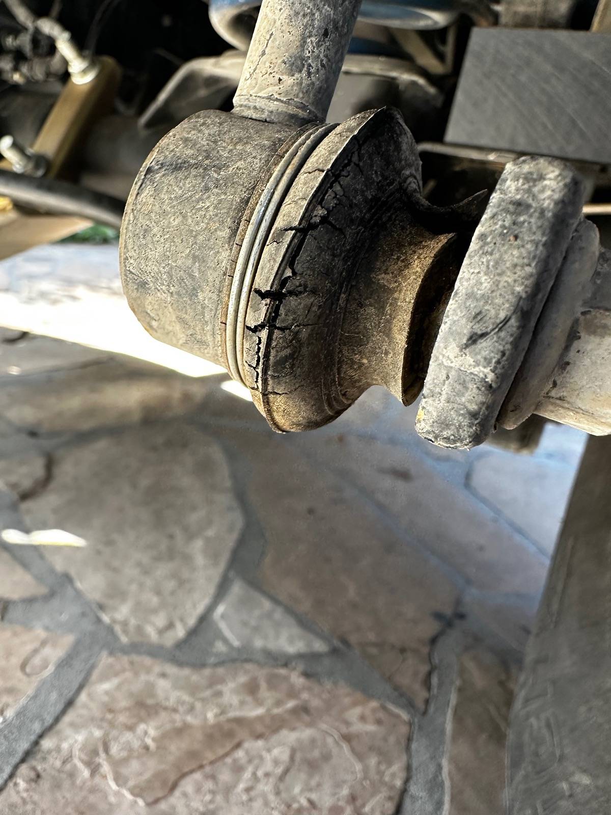

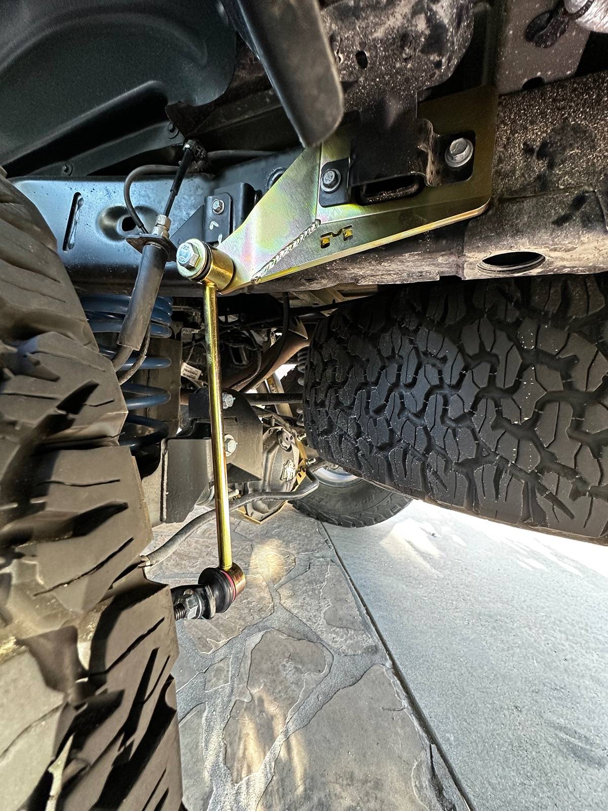

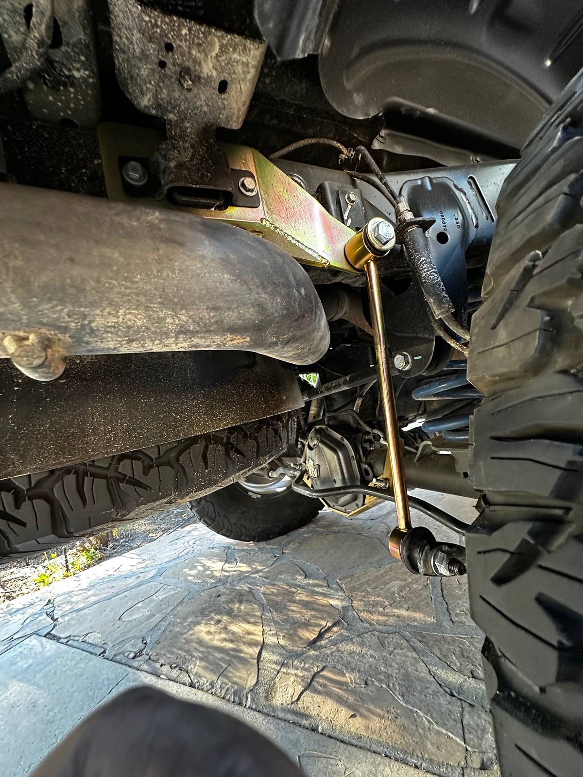

Quick and easy project - added the Metalcloak rear end link reinforcement and end links. AEV has a drop down bracket that isn't beefy, but no issues with it yet. As noted by others on the forum the AEV end link rubber caps are already deteriorating after 2 years.
The Rockblokz bracket doesn't fit with the Metalcloack bracket. Will probably do some cutting and reshaping so that it matches the contour of the reinforcement bracket.
Thinking of adding a Hellwig sway bar at some point as well. Noticed that I mashed up one of the swaybar bushing brackets pretty good on the rocks.
I did the same thing when I installed my AEV lift a couple weeks ago. Already had the MetalCloak reinforcement brackets and took them off initially to installed the AEV ones and end links. Did not like the setup and took off the AEV bracket and end links and went back to the MetalCloak ones and installed a set of end links out of the MOPAR 2" kit.
