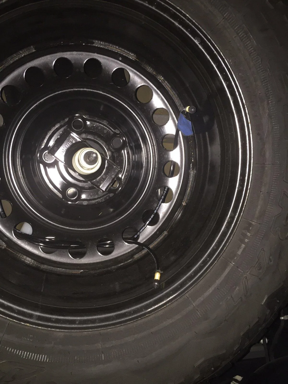

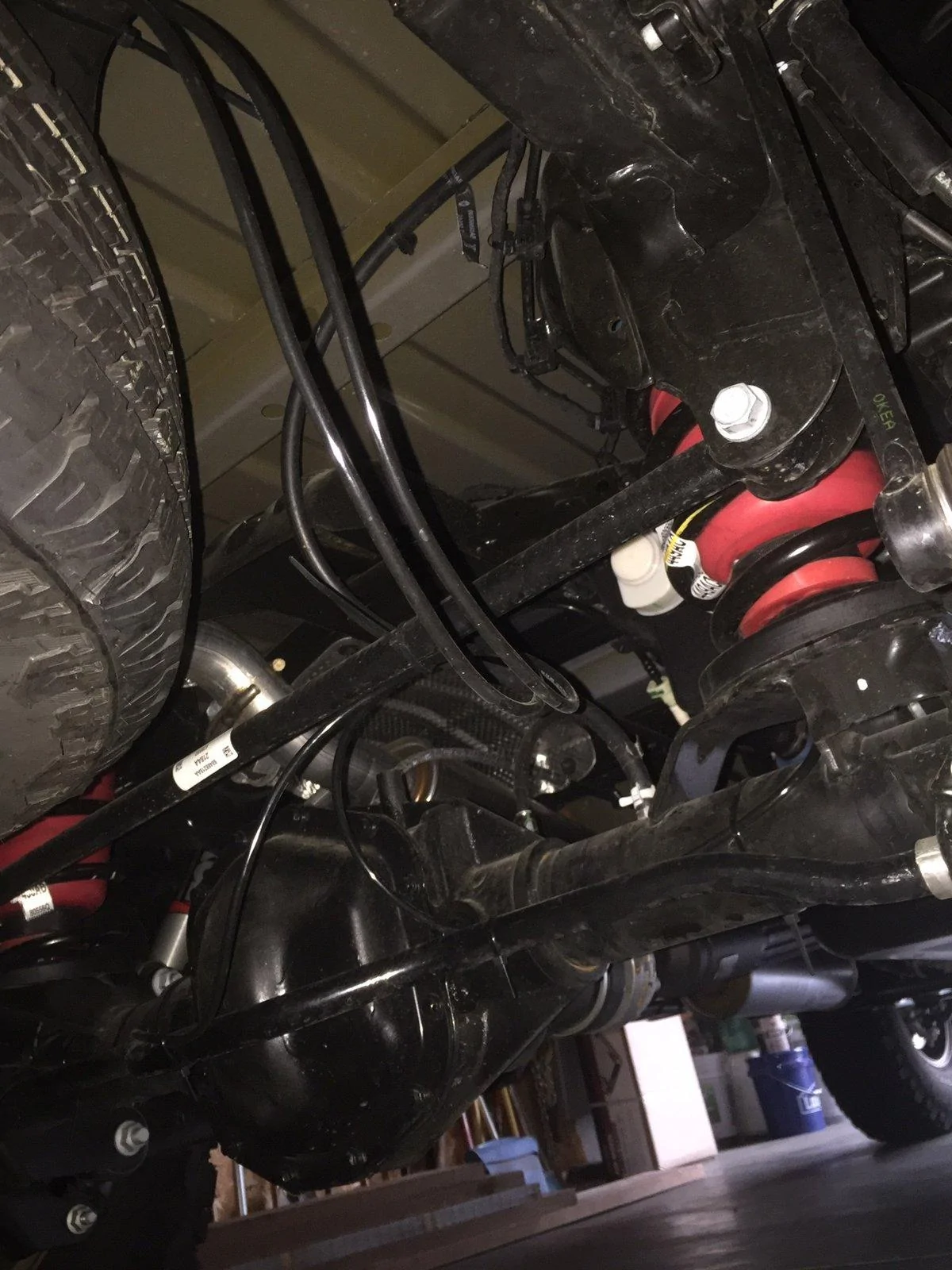

I installed my Air Bags with the brass nozzle pointing down and ran the air lines through the hole in the spring perch. Then, using zip ties, I ran them along the axle tube and up over the spare tire. Just looped them through the spare a bit to keep them out of harms way. Not the most stylish but took a grand total of 2 min and they're easily accessible with a simple hand pump that you might use for inflating a basketball. The blue tape just identifies the passenger's side from the driver's side. As far a the the T fitting...I didn't install it so that I could maintain as much hose for each bag as possible in case I want to re-run them differently in the future.

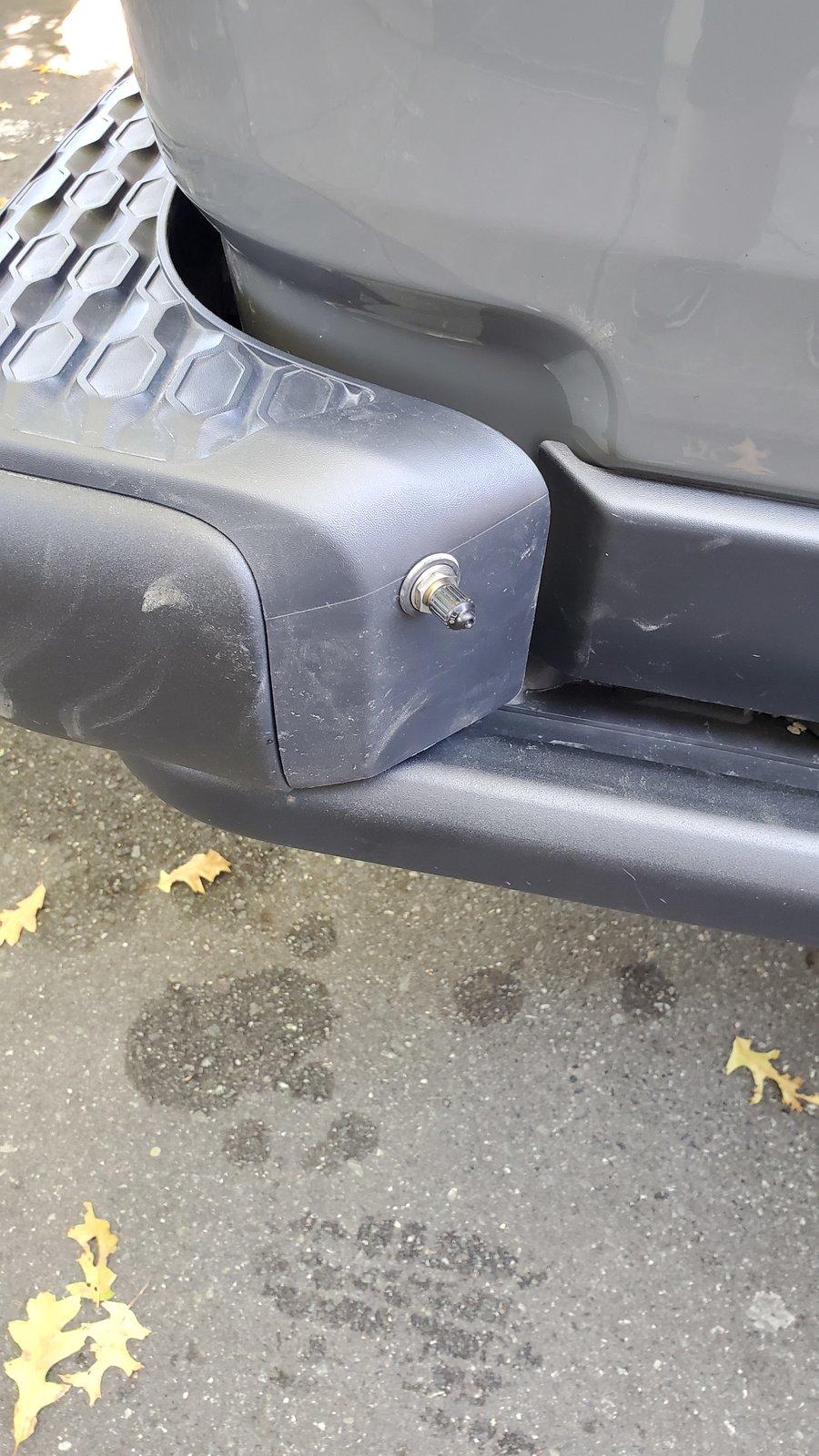

I ended up putting the valves in the corners of the bumpers. Drilled the hole in the plastic. No turning back now!!!
Edit: not leaking anymore!
