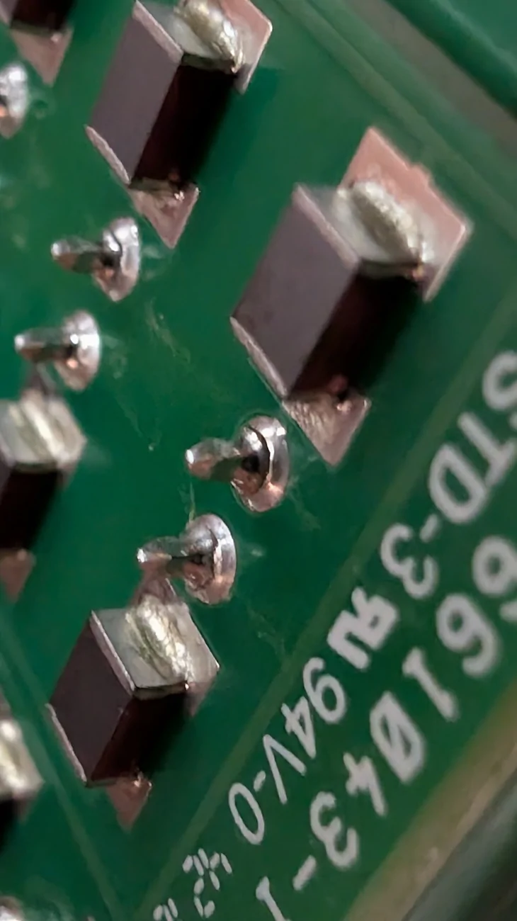

I’m going to replace the Star connector and see if that fixes it. Worth a shot
This is my vote. I had similar symptoms that were remedied by replacing the star connector. You ought to be able to zoom in with your phone camera and find broken solder:
Jeep Gladiator All dash lights at once 1788229117747-id
This reminded me of a very similar thread you might've already come across.
The star connector was indeed the culprit in this case.
