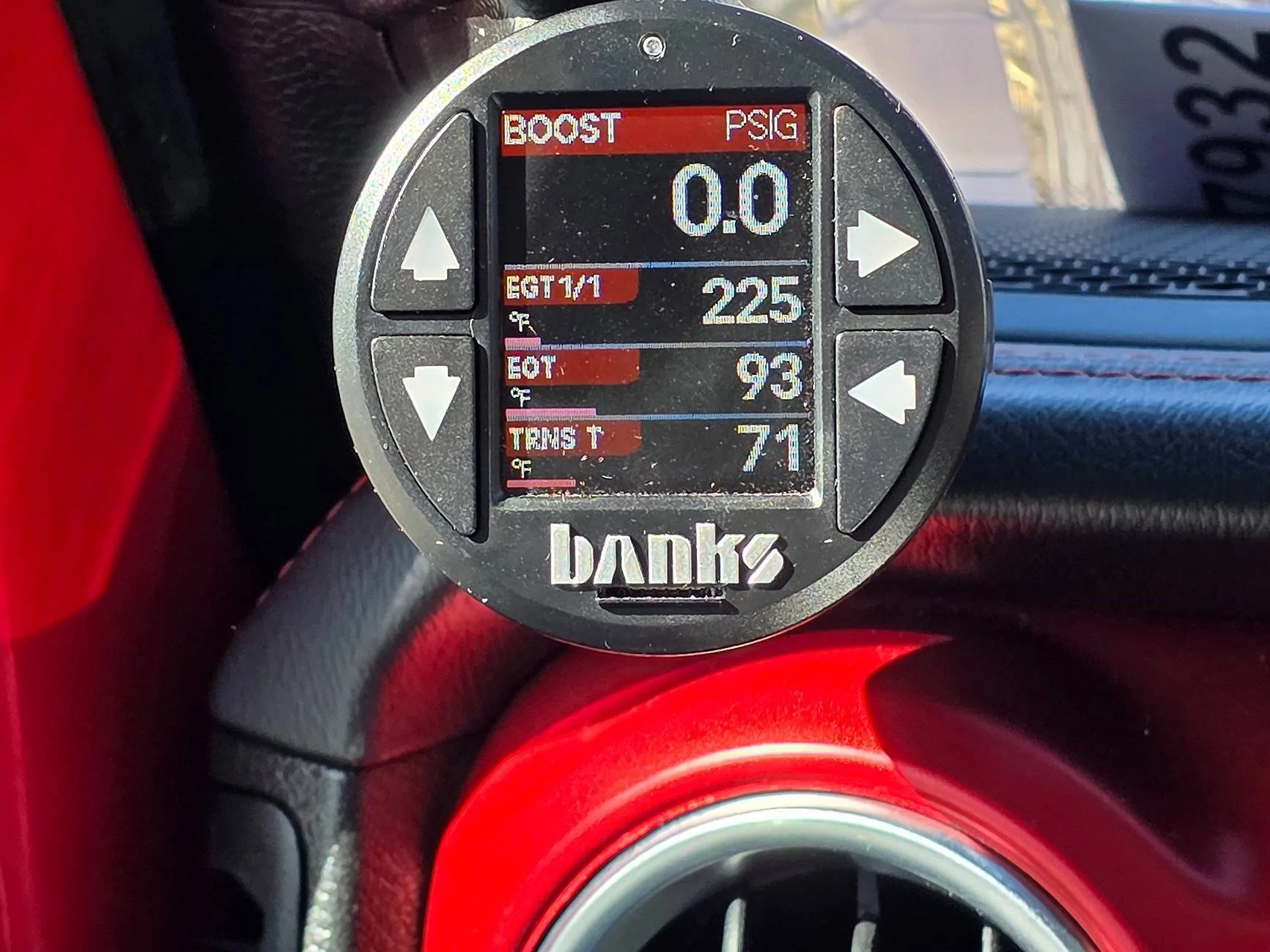

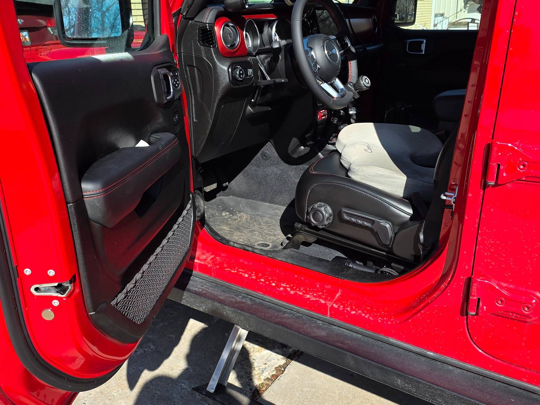

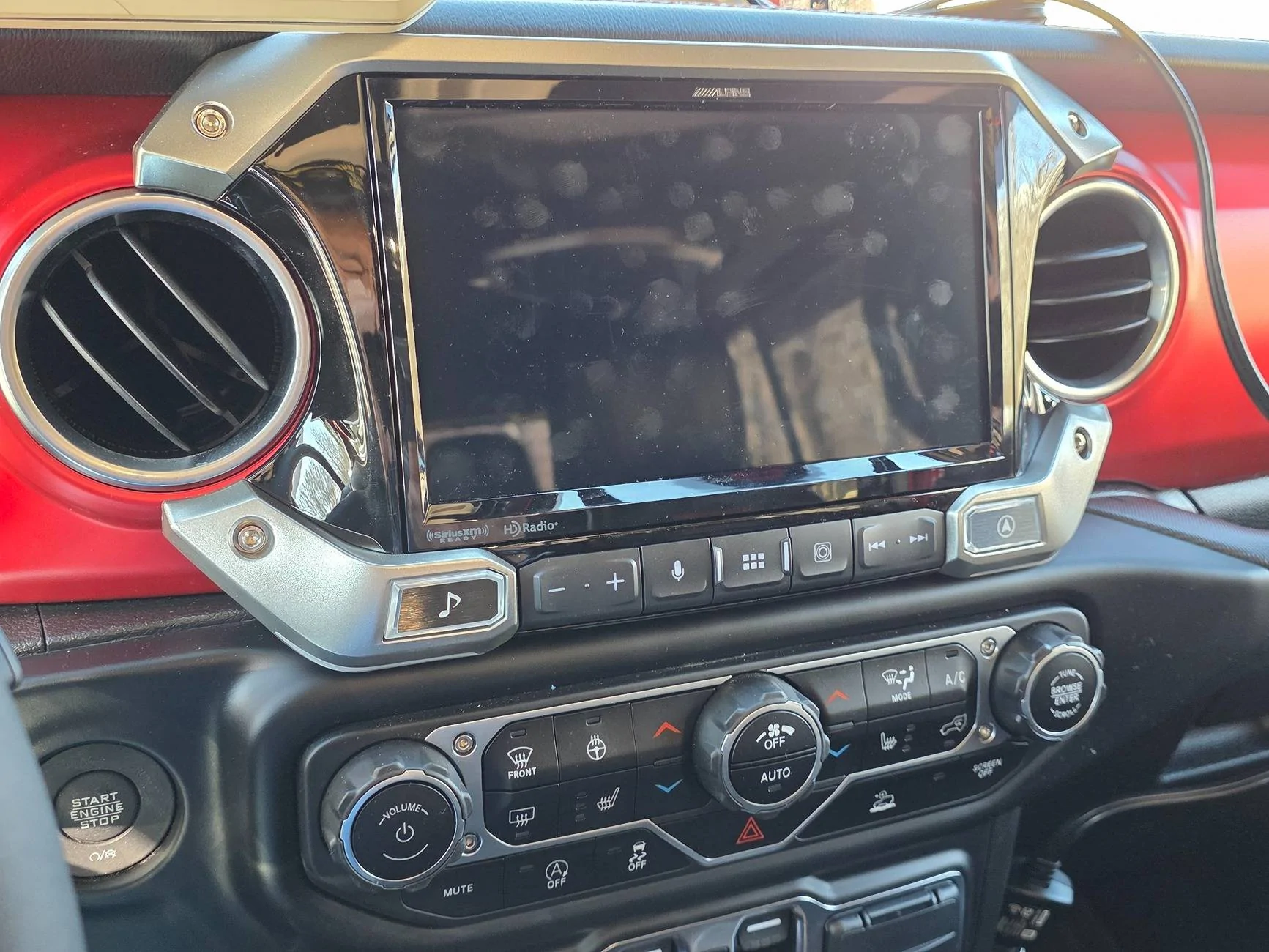

My Gladiator came with the Premium Alpine Audio system, but I just replaced it with an Alpine i509-WRA-JL Multimedia Dash Restyle system. While at it, I had the front and overhead speakers replaced. I kept the Alpine subwoofer. I added a five-channel Alpine amplifier. I can finally hear the system going down the freeway at 75 MPH.
ALSO updated interior with a BANKS iDash and Pedal Monster. Next will be some under bumper fog lights.
