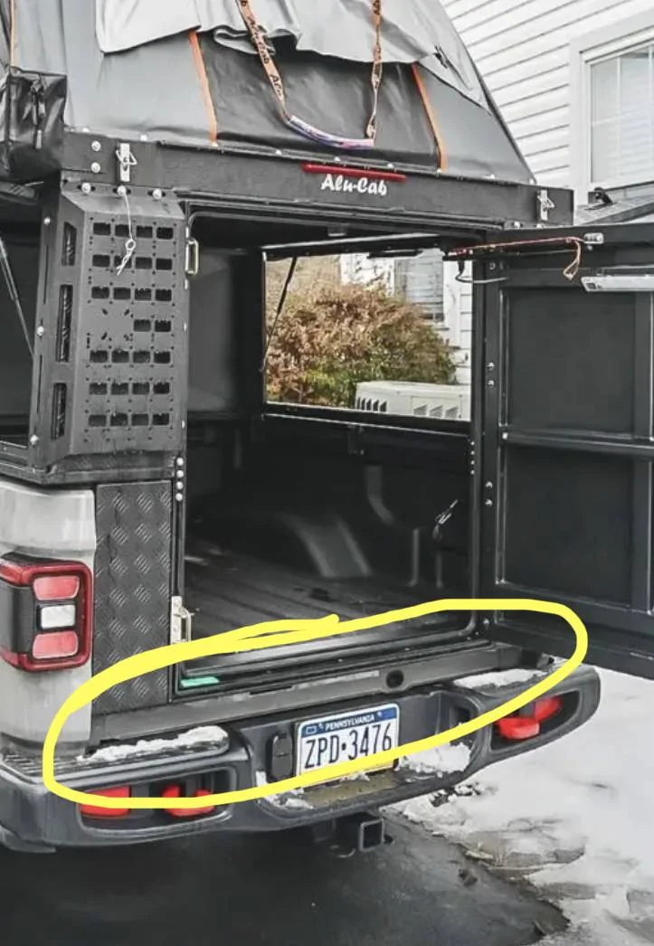

You need to keep access to that hole, the spare tire winch handle goes in there
(did the tailgate harness go through there before the ACCC? I never thought to check)

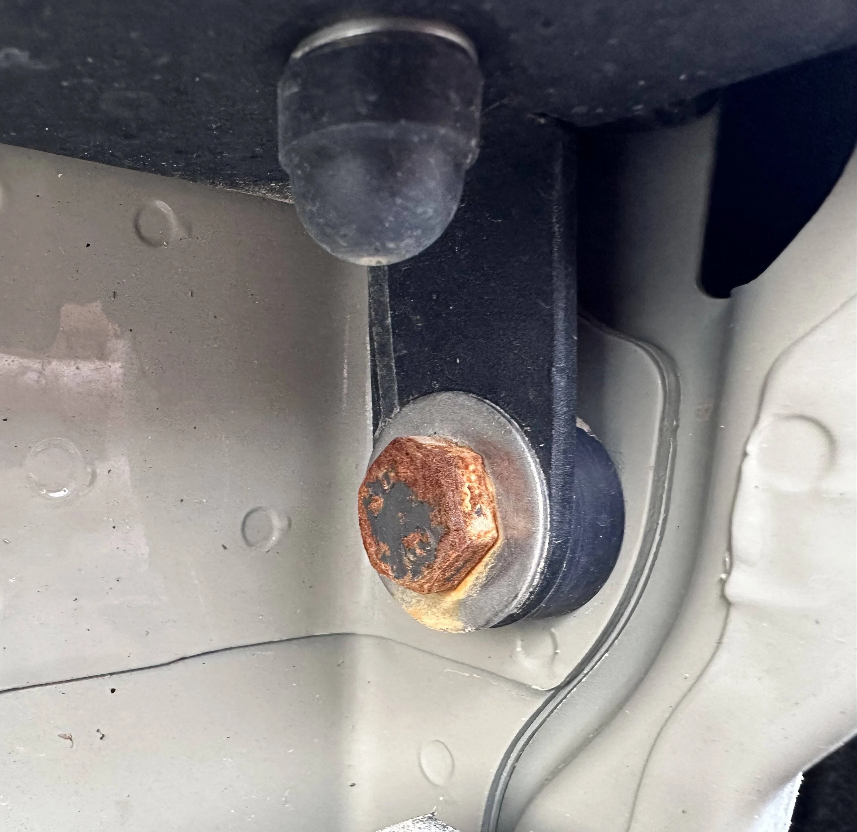

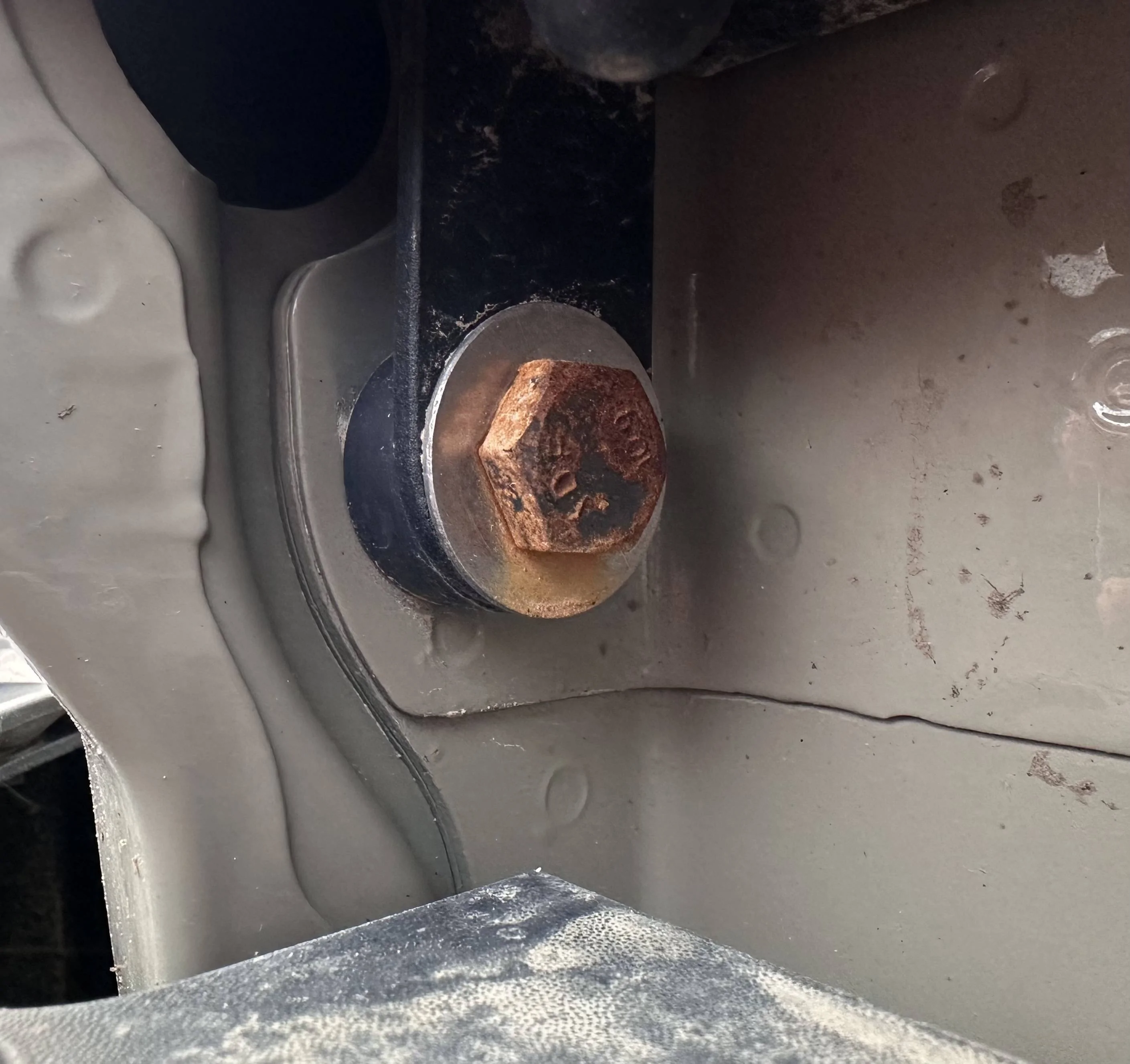

Oh but while we’re talking about that area below the back door, check out my three month old ACCC bolts. This is from just a few CA rainstorms; you salt belt folks better keep an eye on these…
If anyone has specs please share; otherwise I’ll pull one and link the proper stainless or zinc-plated part from somewhere. Black oxide bolts is disappointing
My shop installed SS bolts, so they did not do that in almost two years.

Hm, maybe it's a shop issue, not an Alu-Cab issue. Anyway easily fixed but annoying
They're M10 x 1.5 x 45mm, just ordinary part-threaded hex-head cap screws.
Grade 10.9 zinc: https://www.mcmaster.com/91310A640/
Stainless: https://www.mcmaster.com/92800A469/
I found 10.9 zinc in my local hardware store for a couple bucks, but only in 40mm and 50mm. The 50mm fits just fine. There also weren't lockwashers on my pair of bolts so if you're in there, you probably want to add them.

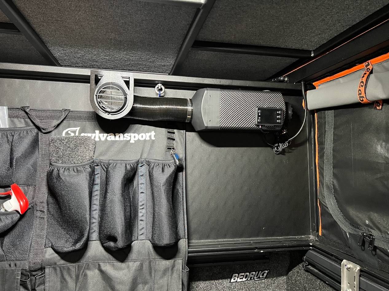

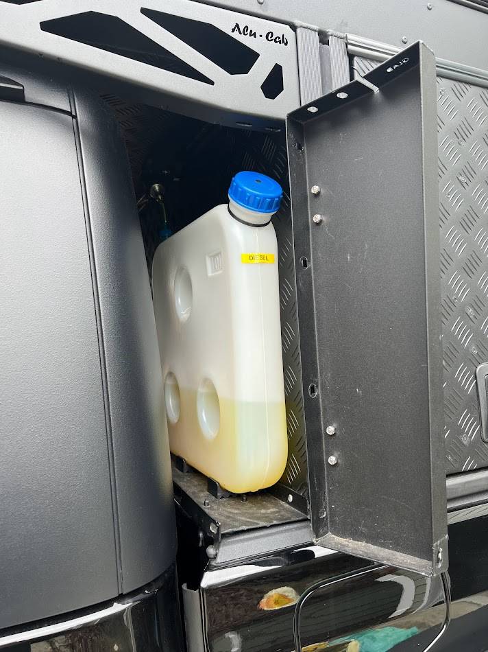

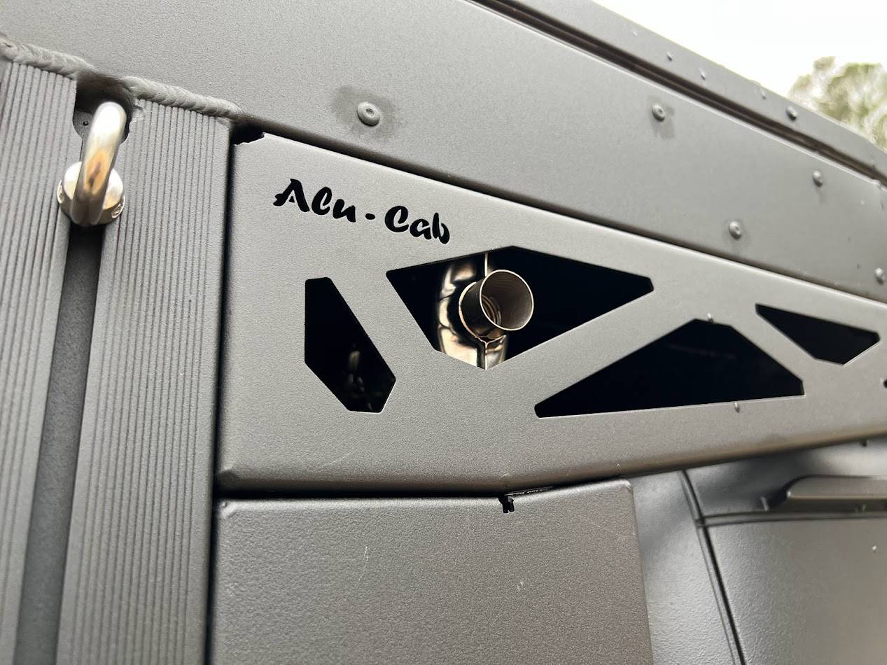

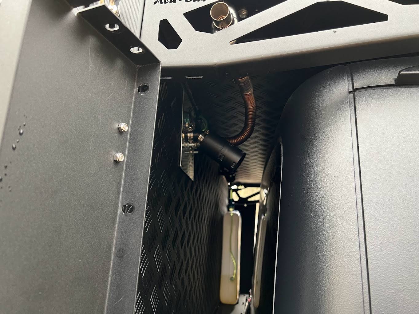

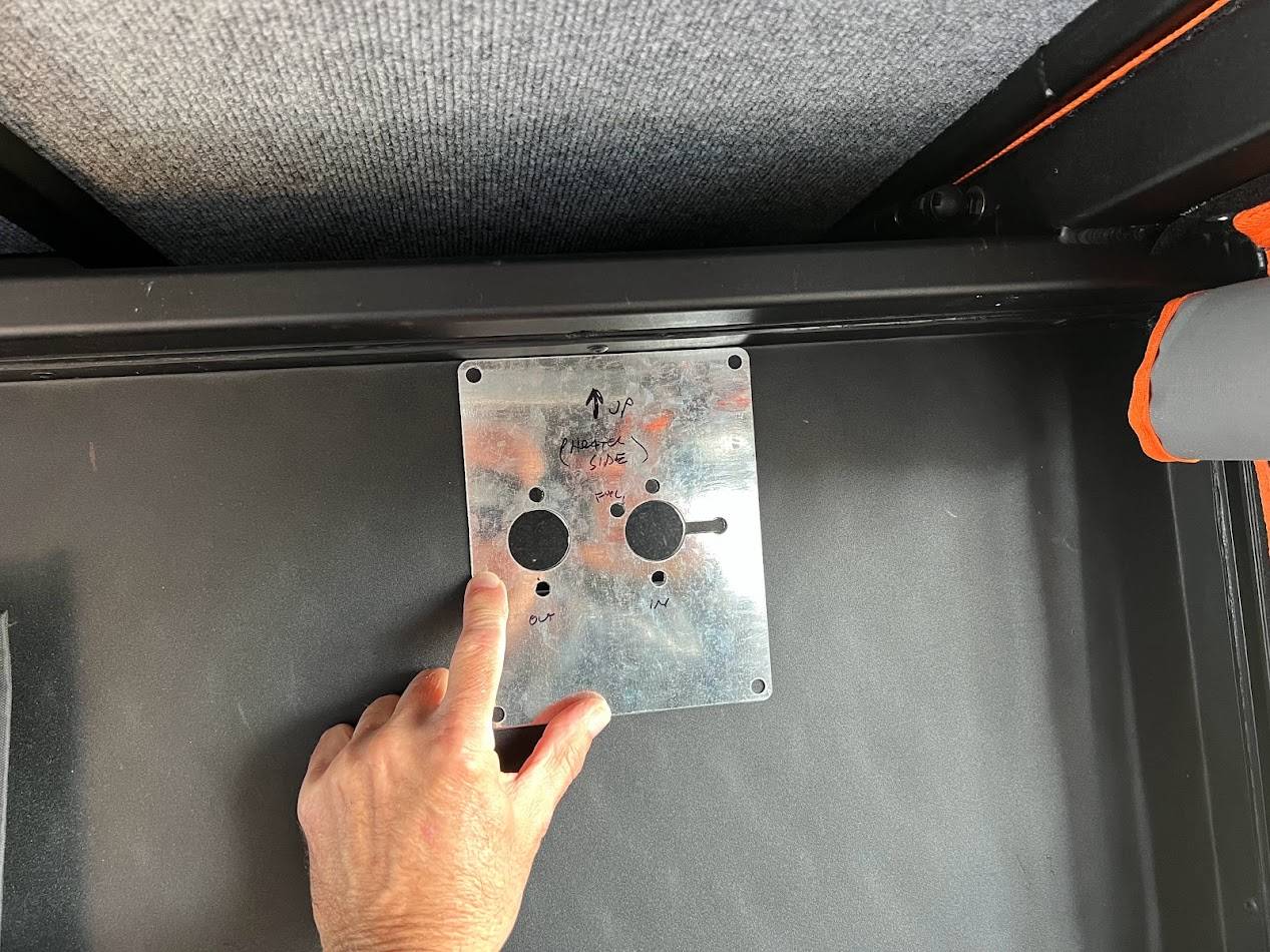

Alu-Cab Diesel Heater Install: Just completed this install and now I have nice hot forced air heat! :) FYI, these heaters cost less than $150. My JT is diesel so any fuel I carry has two uses.
Cheers!
Jeep Gladiator Alu-Cab Canopy Camper Roll Call installed heater
Jeep Gladiator Alu-Cab Canopy Camper Roll Call exhaust
Jeep Gladiator Alu-Cab Canopy Camper Roll Call exhaust door open
Jeep Gladiator Alu-Cab Canopy Camper Roll Call diesel tank
Jeep Gladiator Alu-Cab Canopy Camper Roll Call template
