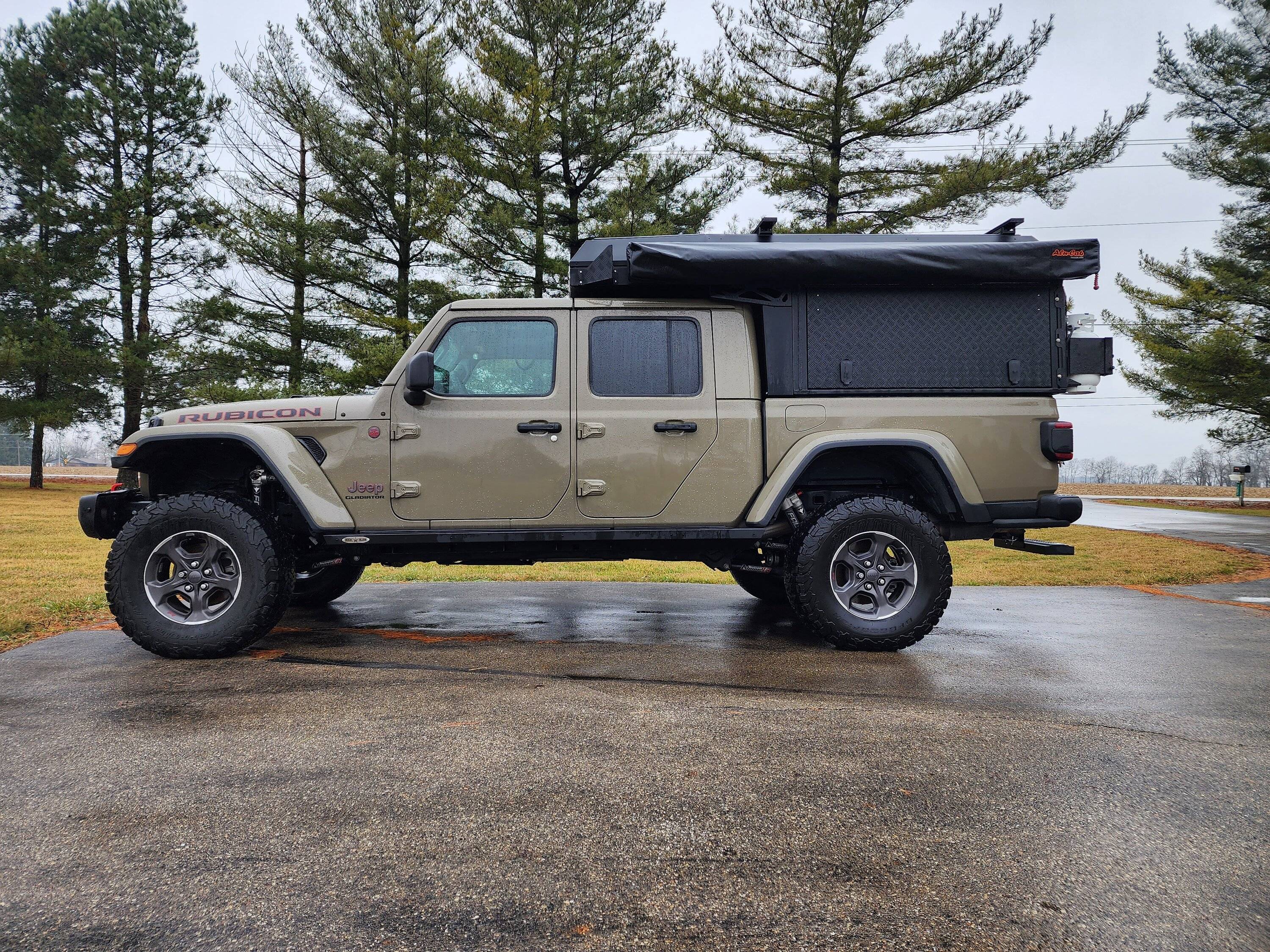

@Donnie2153, any more details on this Clayton HD spring setup?
Well, i installed the dobson hd rear springs with a teraflex 1.5" spacer to the 3.5" lift with 315/70 r17 tires on stock rubicon rims. This gives a slight forward rake when unloaded and a level stance when fully dressed out for overlanding. The gladdy weighs around 6700lbs when fully loaded. I have driven from Texas to virginia and back and I am now in Ohio. Under normal hwy conditions (except for illinois roadway) the Gladiator travels much much better. On backwood roads with wash boards and ruts she drives even smoother than before. No more rear end sag or side to side swaying. I like it! Mileage took a big hit. Before the alu cab i was getting 18mpg. Driving 65 i get 14 mpg, but at 75 it drops to 12.8 to 13.3. Which i am good with for the fun factor.
