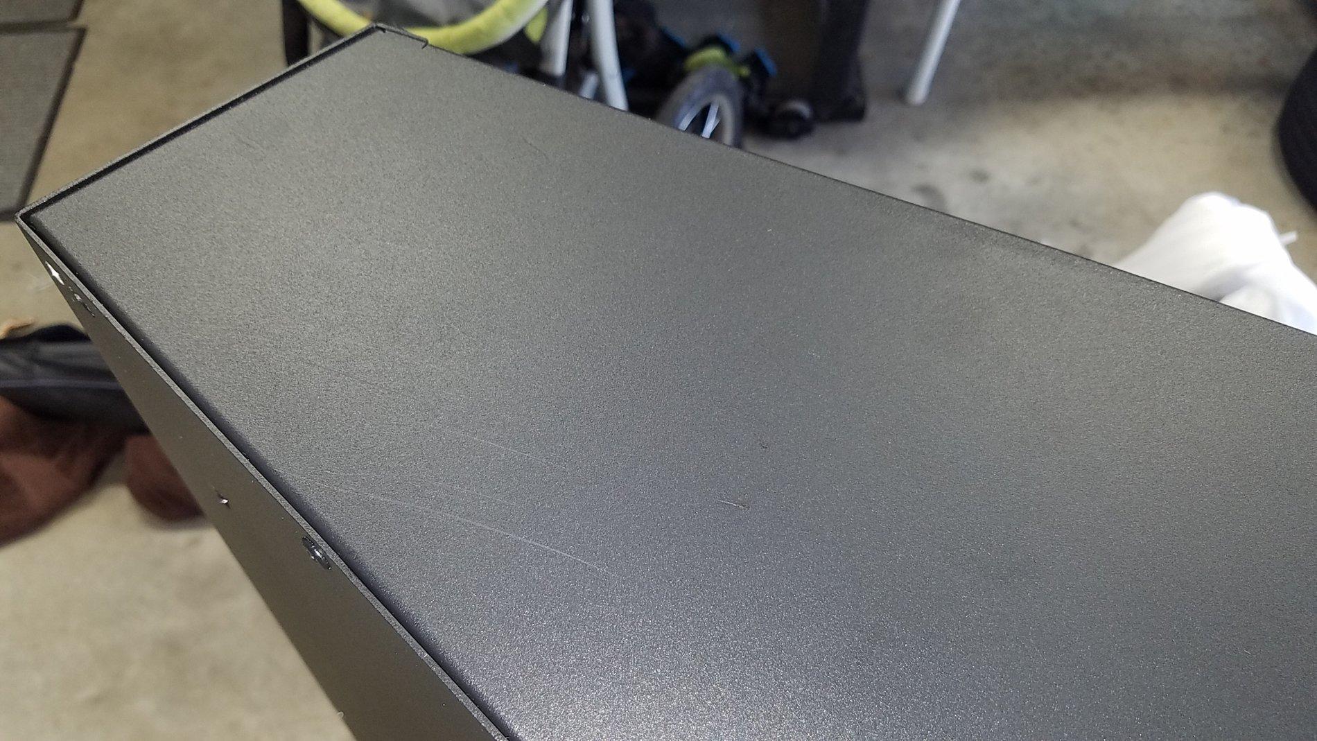

Hey @smlobx , (because i know he has a cabinet) my cabinet came with some deep enough scratches in the side that you could see bare aluminum. It would hit the light just right when both sides of canopy were open, and I was kinda bumbed. I used a sharpie to paint the scratches, and then discovered goo gone didn't take off the excess, BUT Goof Off did. I sprayed it on a papertowel and lightly rubbed the excess away but not so hard that the towel went into the cracks. Now I don't even notice it, and can only see with the right light.
Jeep Gladiator Alu-Cab Gladiator Bed Cap Screenshot_20200517-105023_Gallery
For all Team Alu-Cab
This approach might also help for other scratches on alu-cab's stuff. Inside or outside.
Use at own risk, ESPECIALLY ON THE OUTSIDE. =)

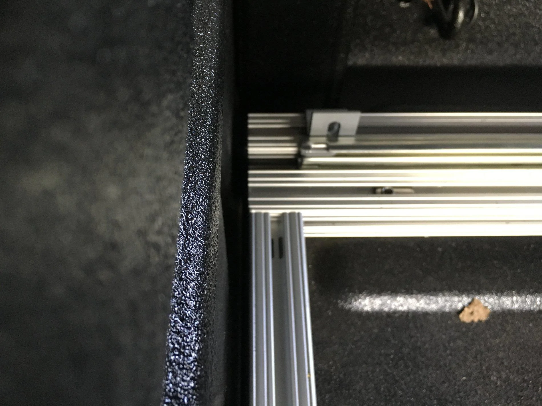

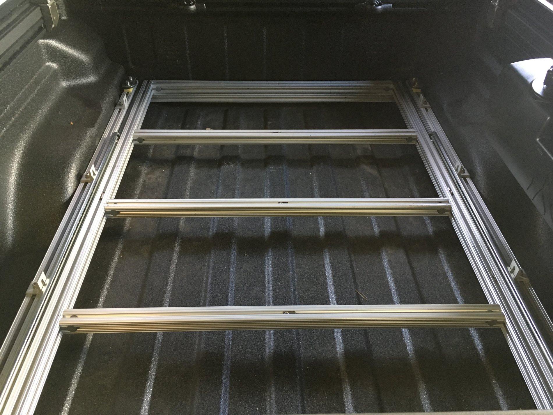

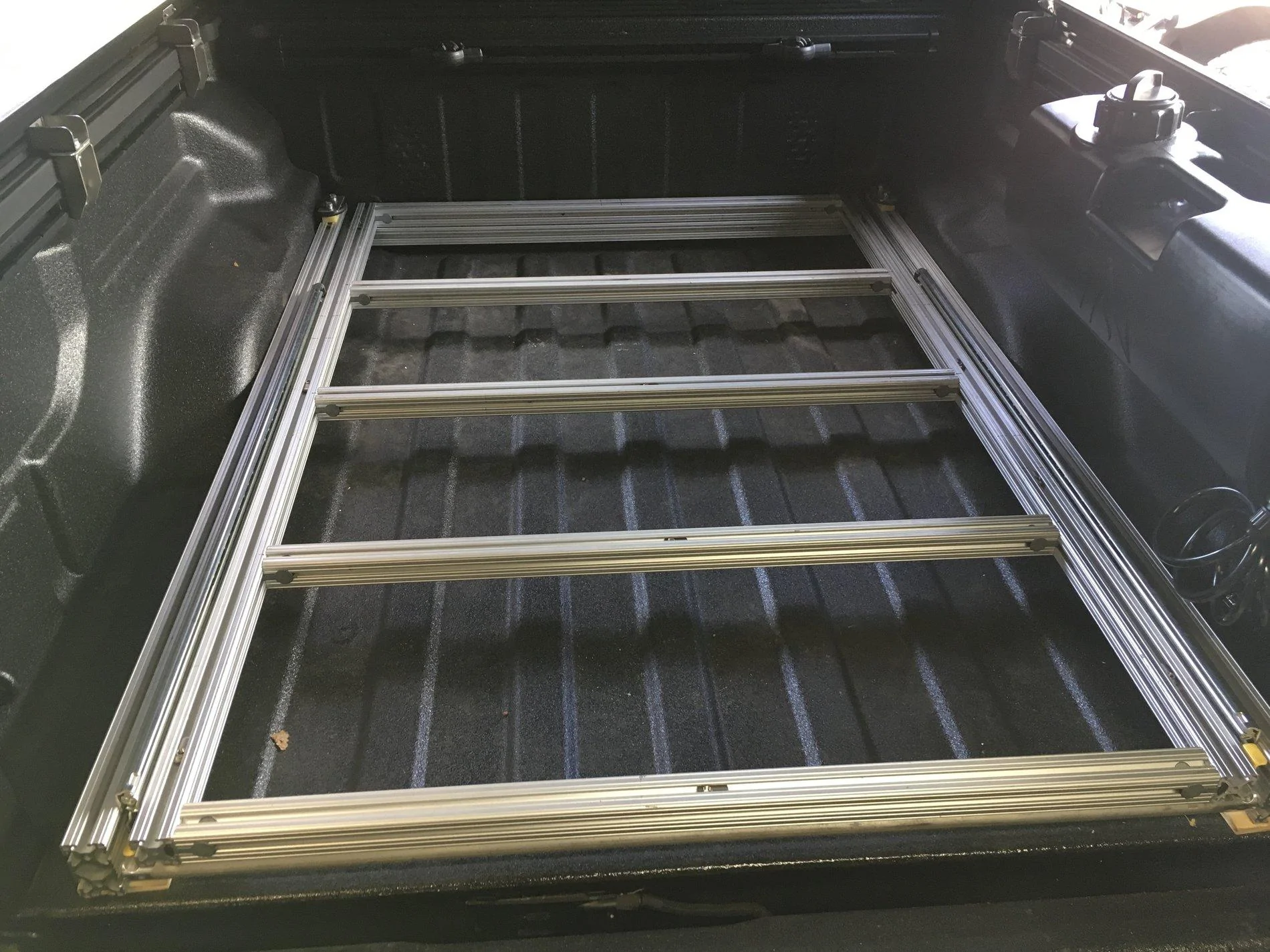

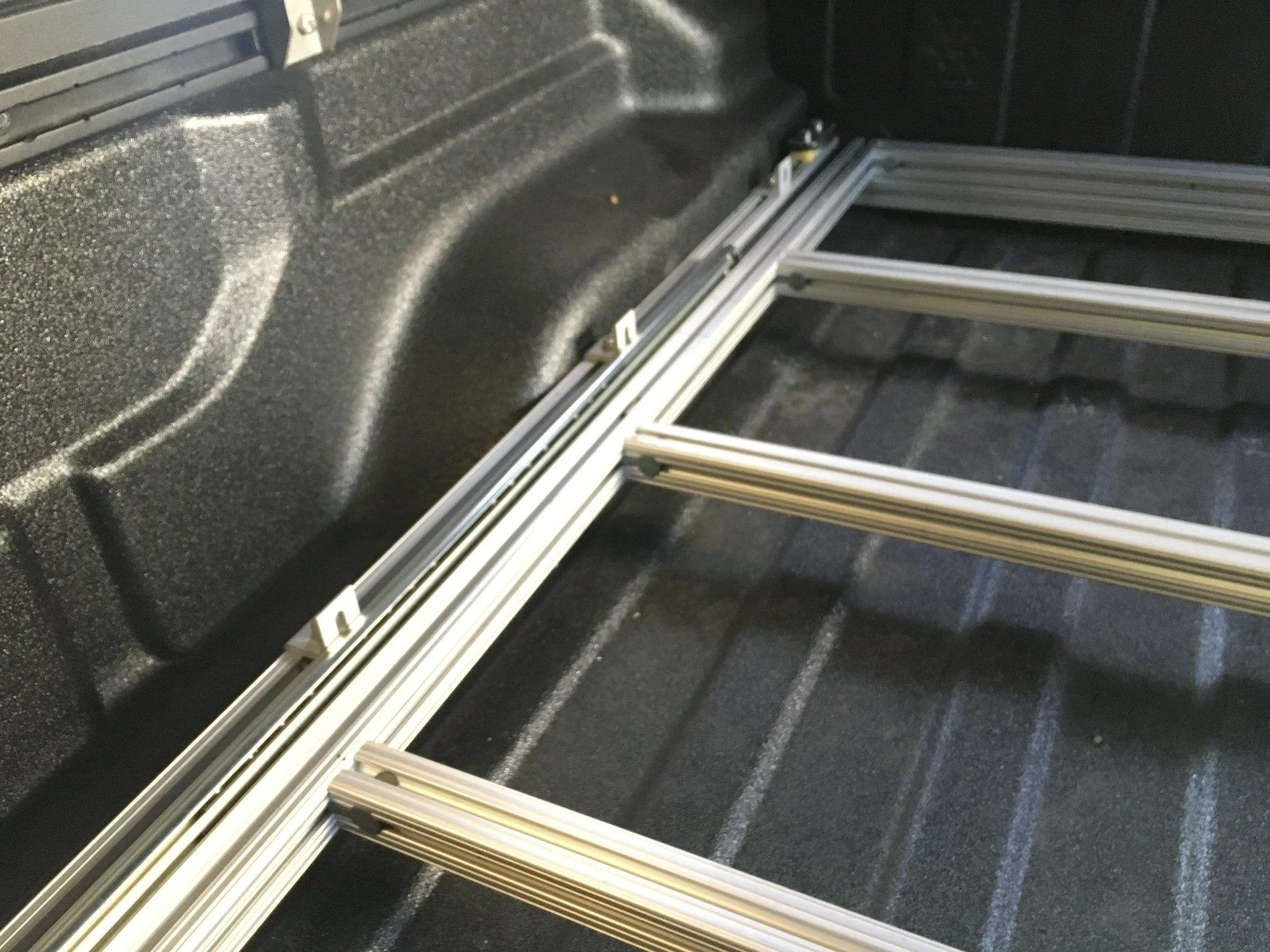

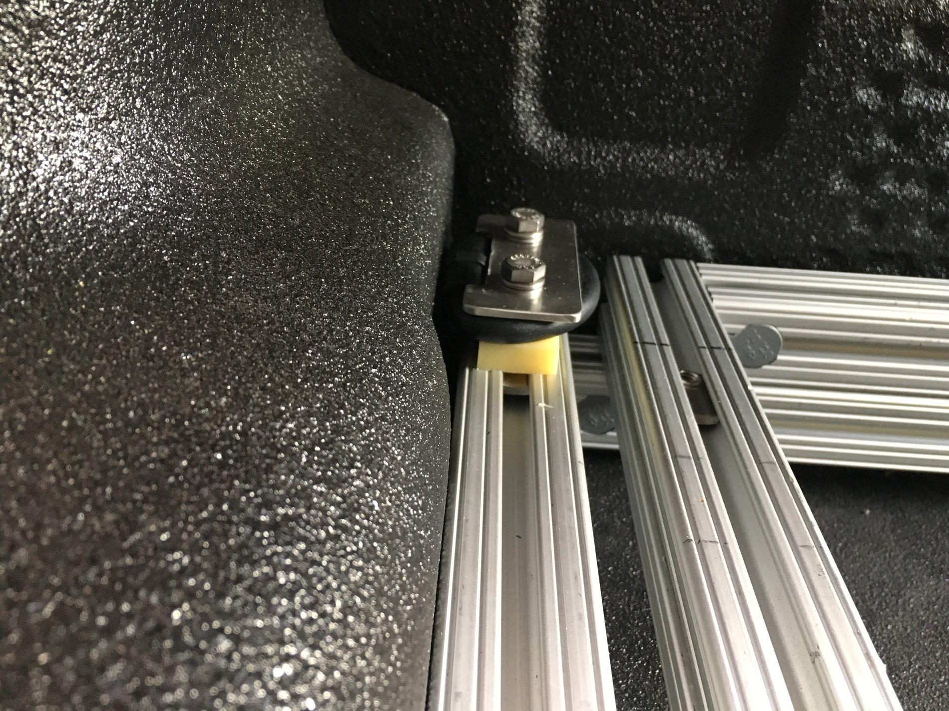

Did the first fit up of the bedslide today. It was a real squeaker with zero slop fit between the wheel wells. By removing the rear plastic spacer of the original bed tie down and socketing it down tight I lost a tie down but gained a stout no drill bed mount. Slide frame just slips under the hinge body of the tiedown. Nylon spacer and a SS plate sandwich the tie down ring to the top of the frame rail. No rear mounts yet.....
did you shim up the left and right rails of the frame with like 1/4" of wood so the drawer would clear the tailgate?
Oh, and how tall is the platform? (thickness of the square tube?)
Bottom of the 3” rail sits at the same height as the top ridge of the bed. Floor of the slide platform is 3 1/8” above the top ridges of the bed. The rear doesn't sit on a ridge but on the lower portion of the bed. There is a 3/8” nylon shim pad under it at that point.

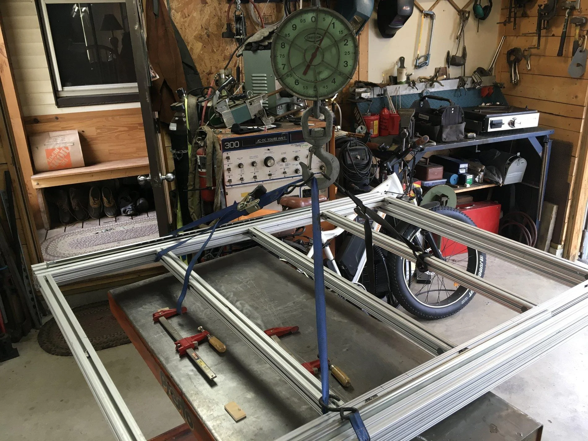

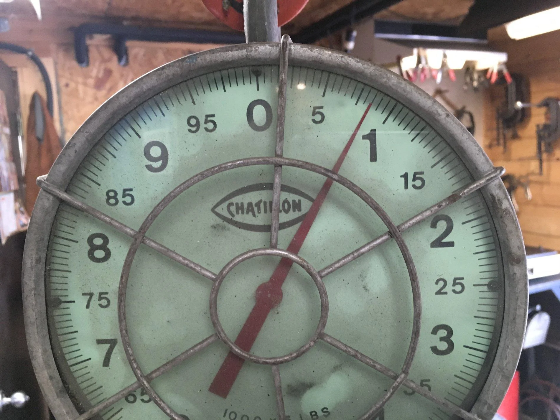

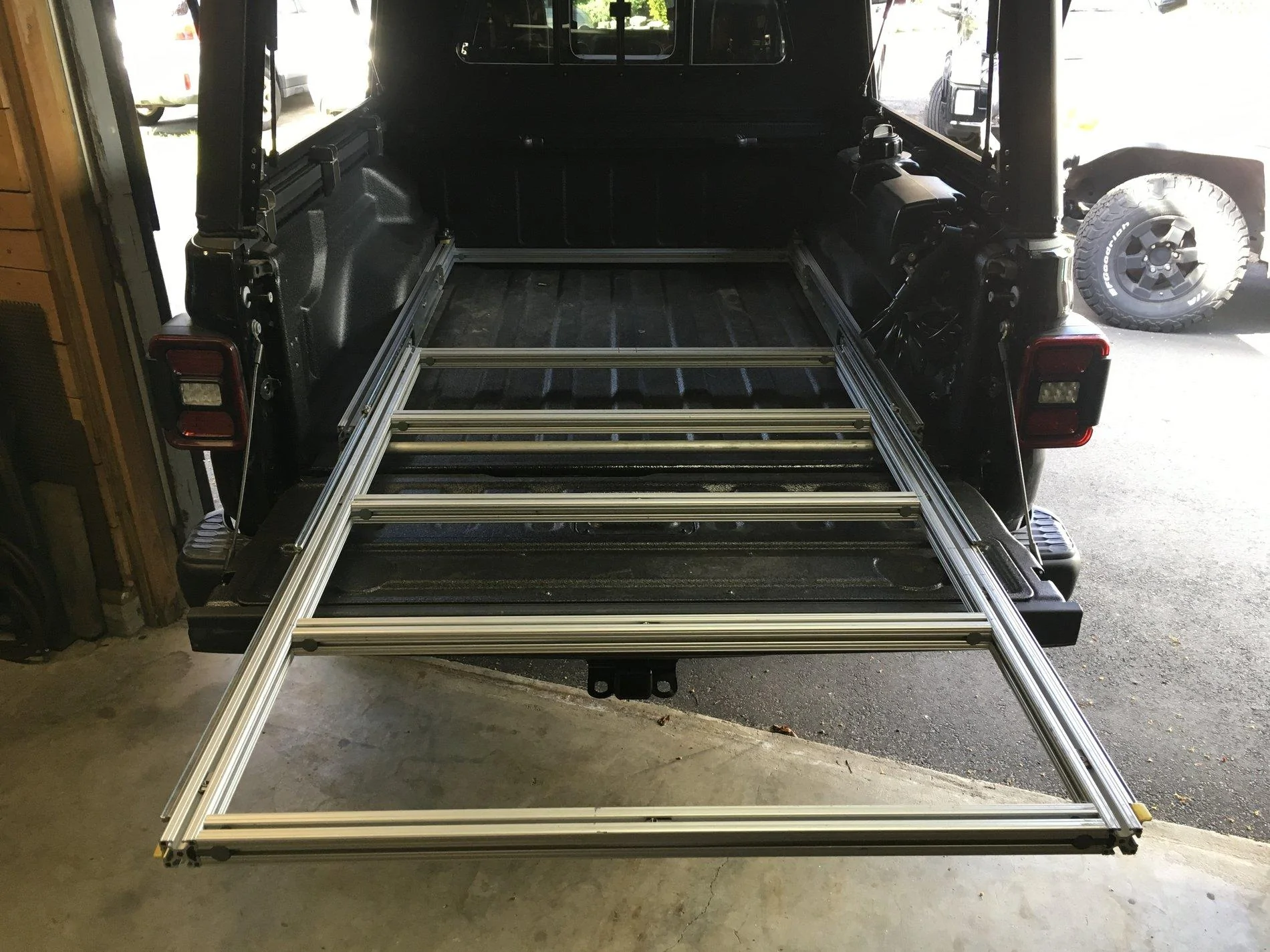

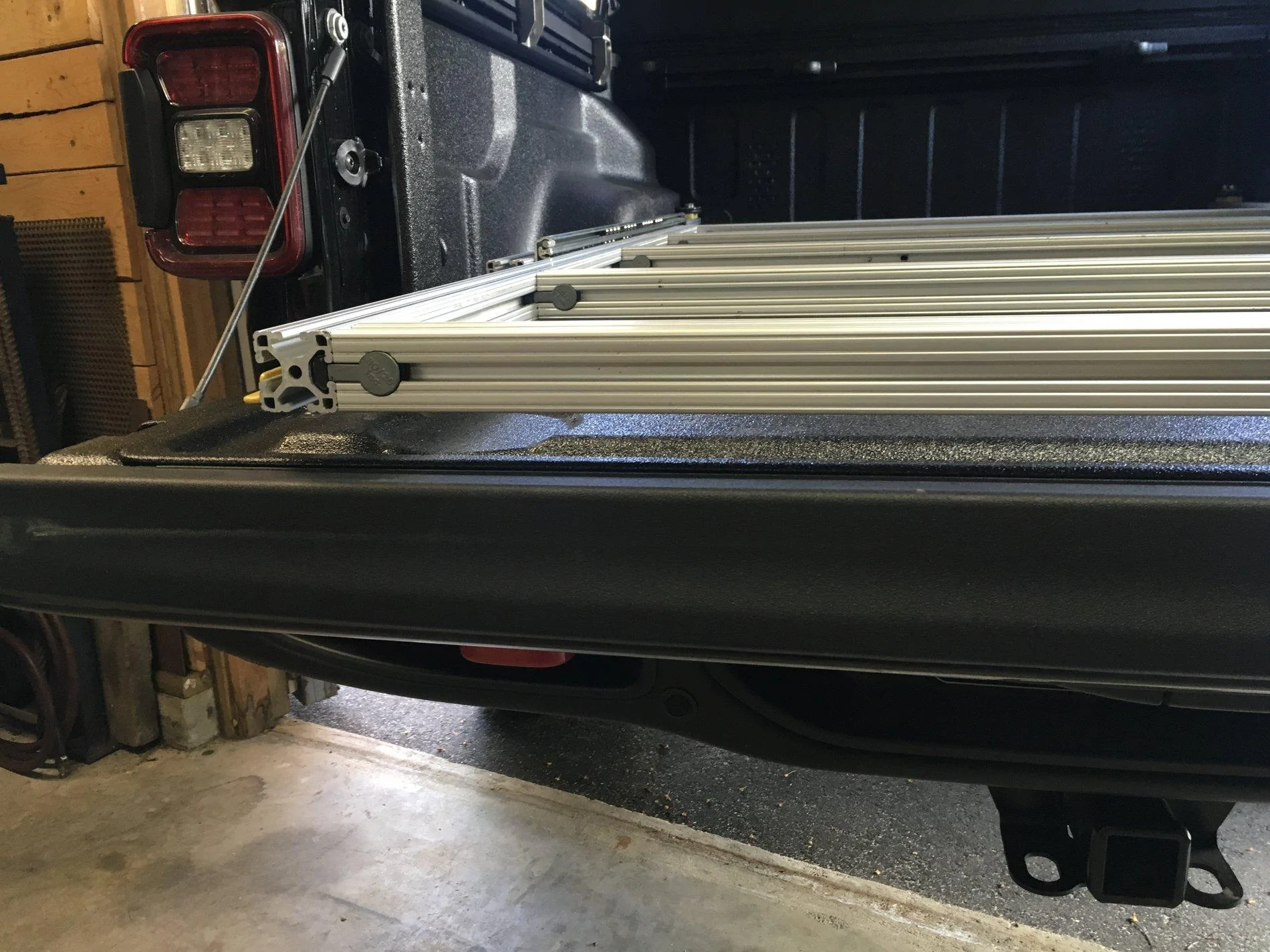

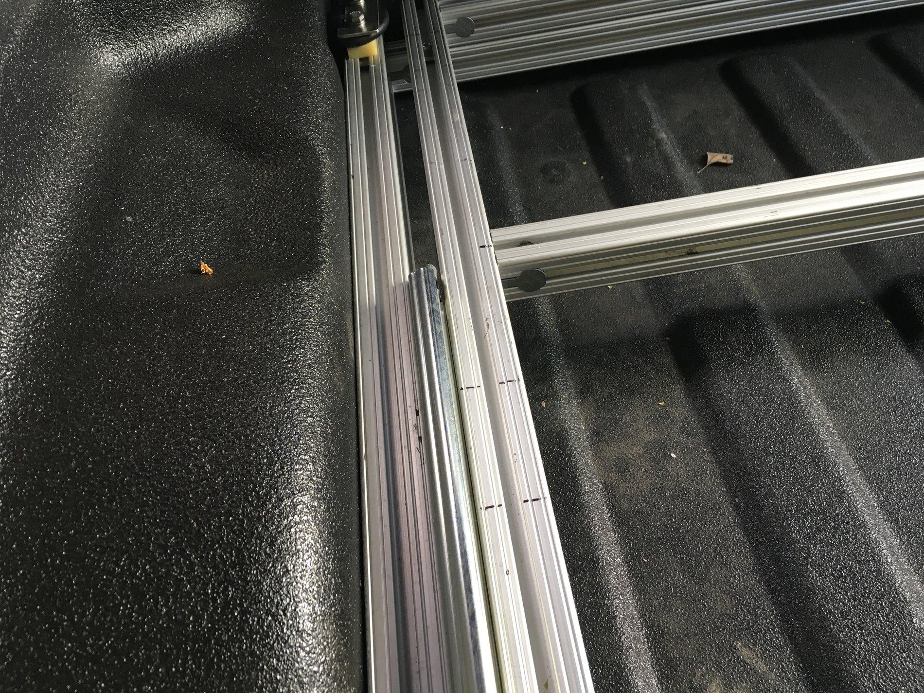

Did weigh the bed slide, minus 1/8” top and top rails. Came in at 85 lbs.
Added for anchor points each side of the fixed frame. About a 1/4” of clearance when tail gate is closed. Front of slide frame is butted up to the front wall of the bed.
When you're bored, can you weigh the alucab canopy?

Wait, I might’ve misread, but is your whole slide tied down in the front of the bed by the tie downs as shown in the picture? Or is it also bolted in the rear somewhere?
Edit- I saw you added “no rear mounts”, so what are you thinking to address it? The build looks great, that’s a small fortune in materials you’ve got there. Good shit
@takeitsleazy there will be rear mounts for sure. A bunch of choices and haven't looked to close yet to make any decisions.
Stay tuned!
