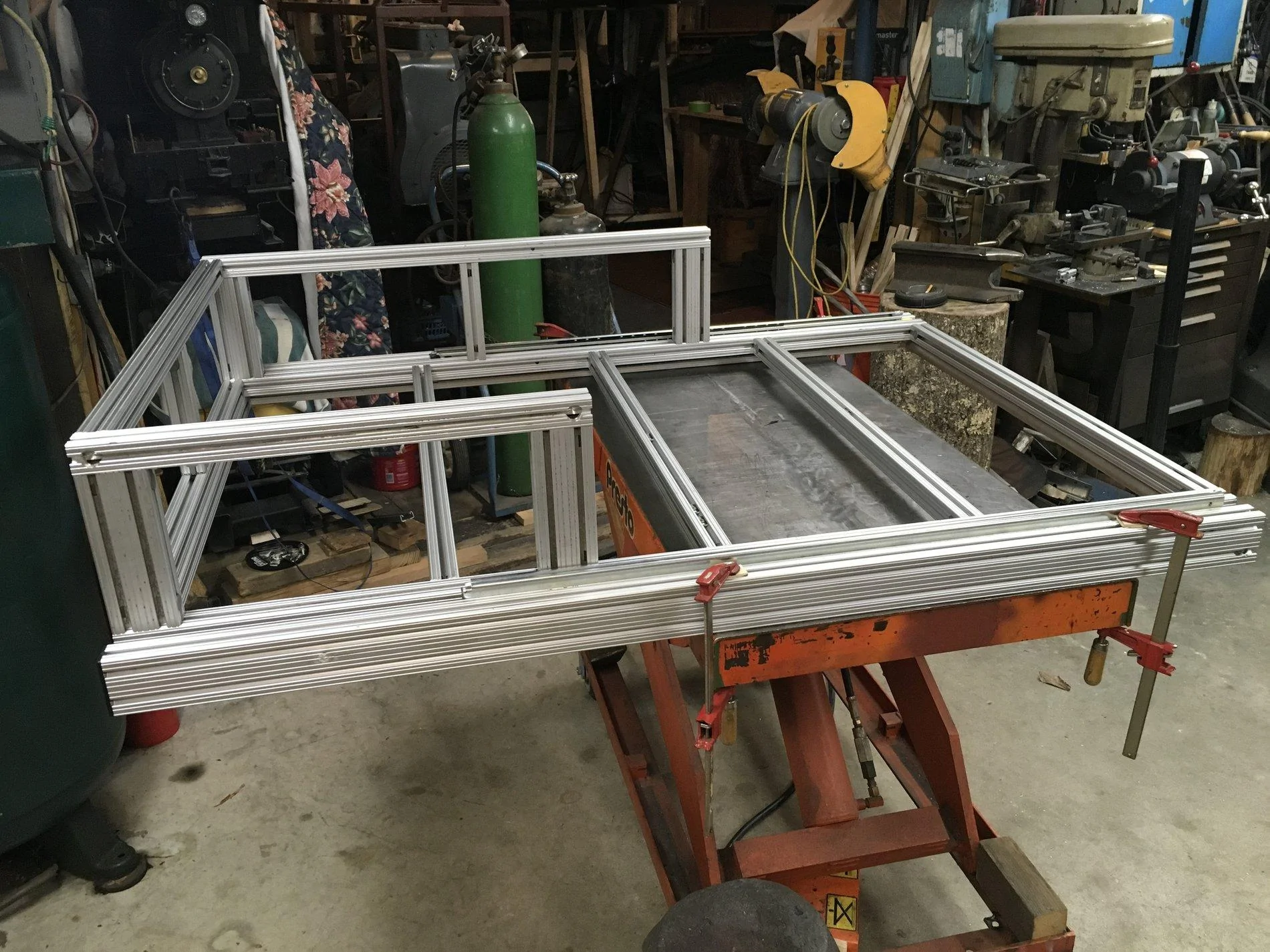

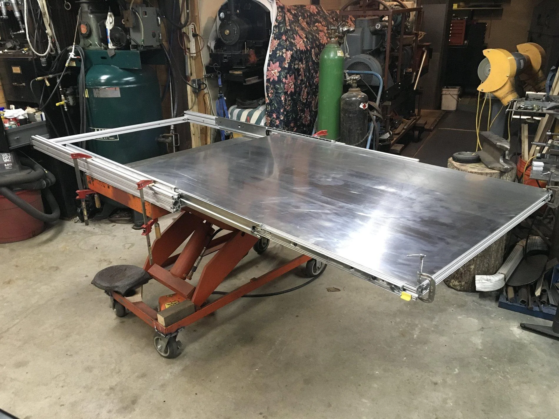

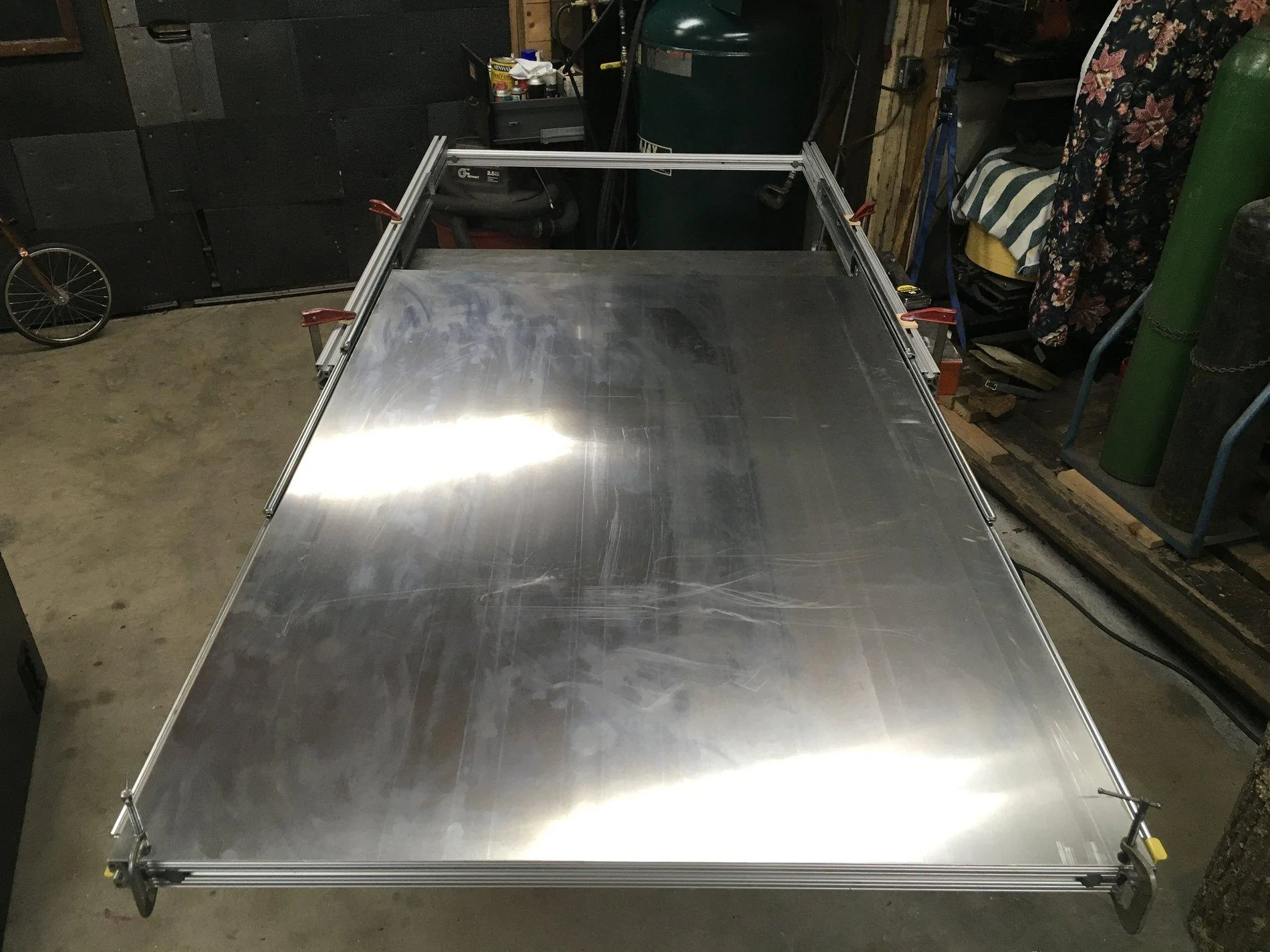

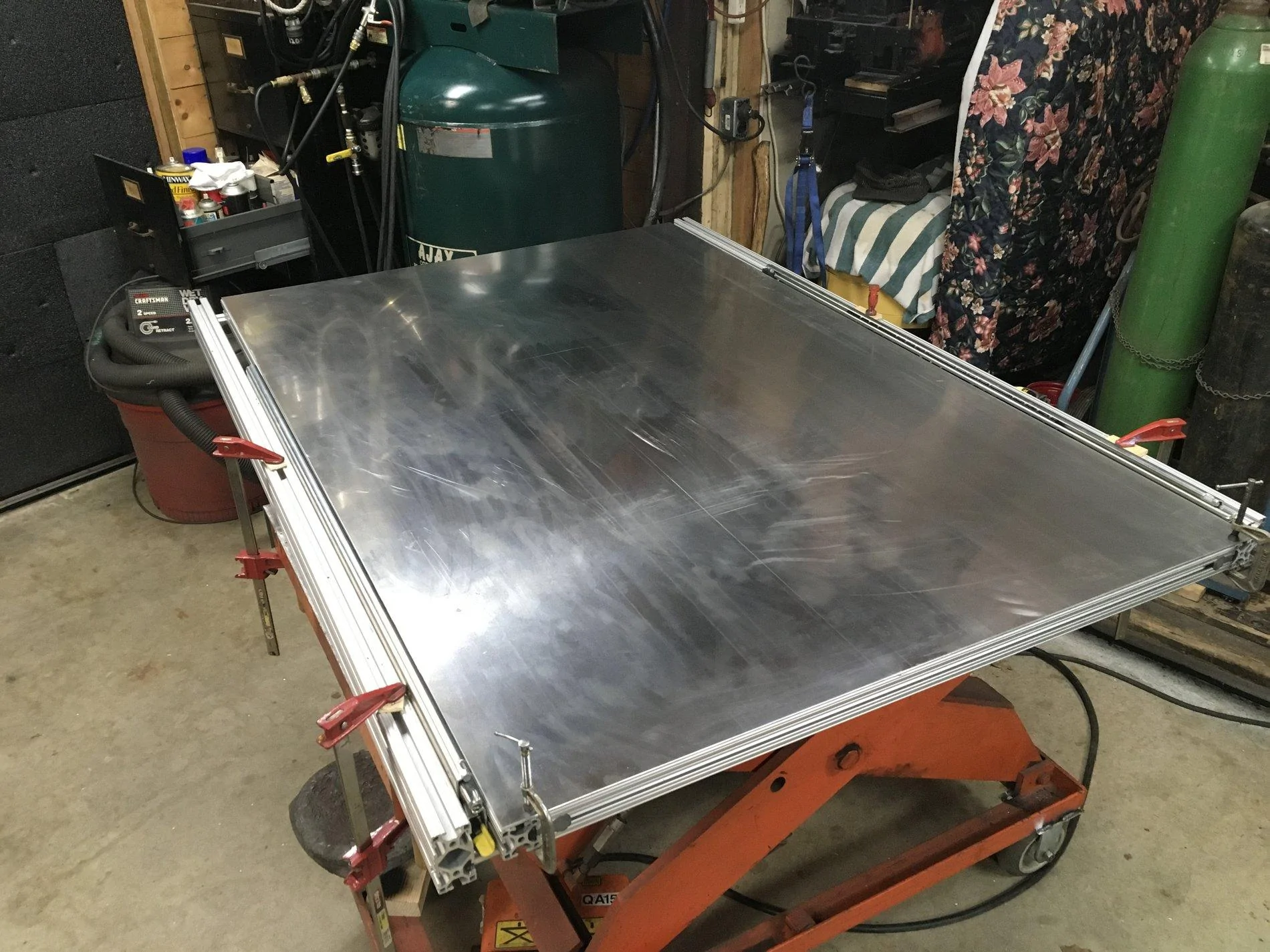

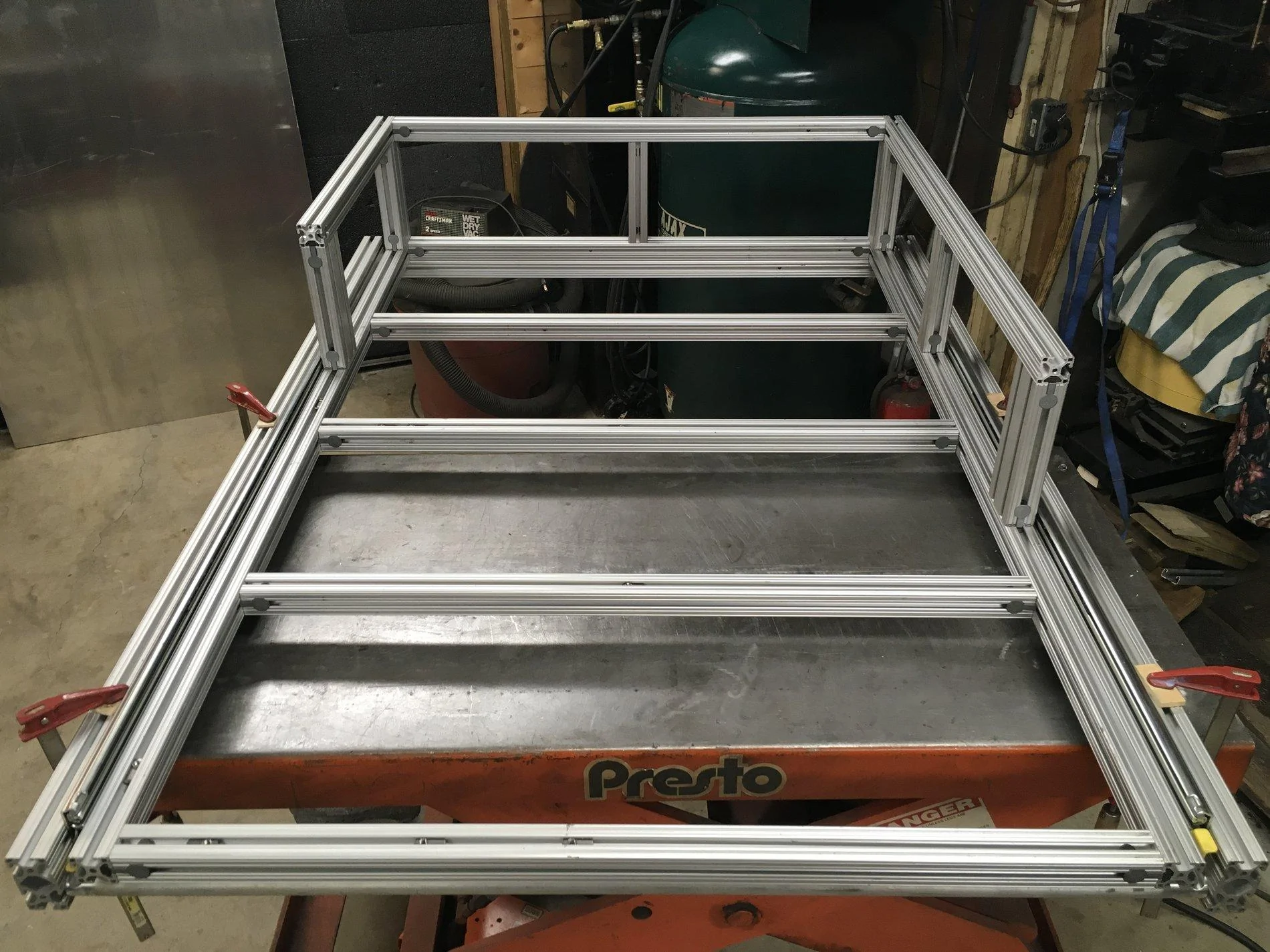

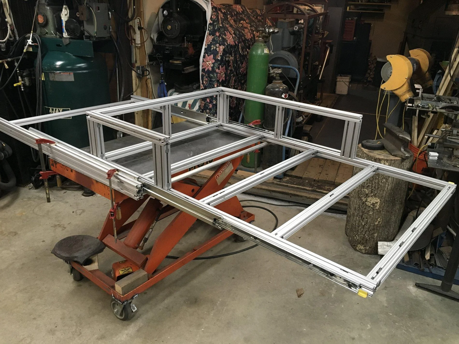

Some more shots of my homemade bedslide.. Local sheetmetal shop supplied the 1/8” aluminum sheet for the deck. Purpose of asymmetrical railing will be apparent in a few days.... I think one more cross bar will be added to these railings to make a separate forward compartment. May add solid aluminum side walls to make it a bin.

Very nice!
How are you going to attach it to the bed? I’m still thinking about that for myself.

Very nice!
@smlobx , The bolts for the front lower bed tie downs come just above the slide rails with enough room to keep the tie downs. Have to make some brackets to do this still. At the tailgate end either thru bolts or nut inserts into the bed. Hopefully get this worked out today.
Very cool! When you're done, can you estimate the cost of the materials?
Unfortunately it would be crazy expensive if you bought all the 80/20 brand new. I was fortunate enough to be in the right place to get a mess of it for free and I bought a bundle of it cheap on CL from a guy that had used it for frame work for solar panels on a house. Having a Bridgeport I could do all the machining myself for square cuts and fastener pockets. What amazed me was the as found stock was nearly to length for the JT! Only had a couple of inches of waste on each length. That sealed the deal on using it for this project.....
Although an optioned out steel Commercial bed slide starts looking like $2k and aluminum even more, new 80/20 and substituting some angle to reduce price might work out price wise. Even the Accuslide tracks are pricey enough that upon discovering I had two righthand slides I “converted” one into a leftie....
This will make you cough up your cereal..... I have about $200 bucks into this!!!
