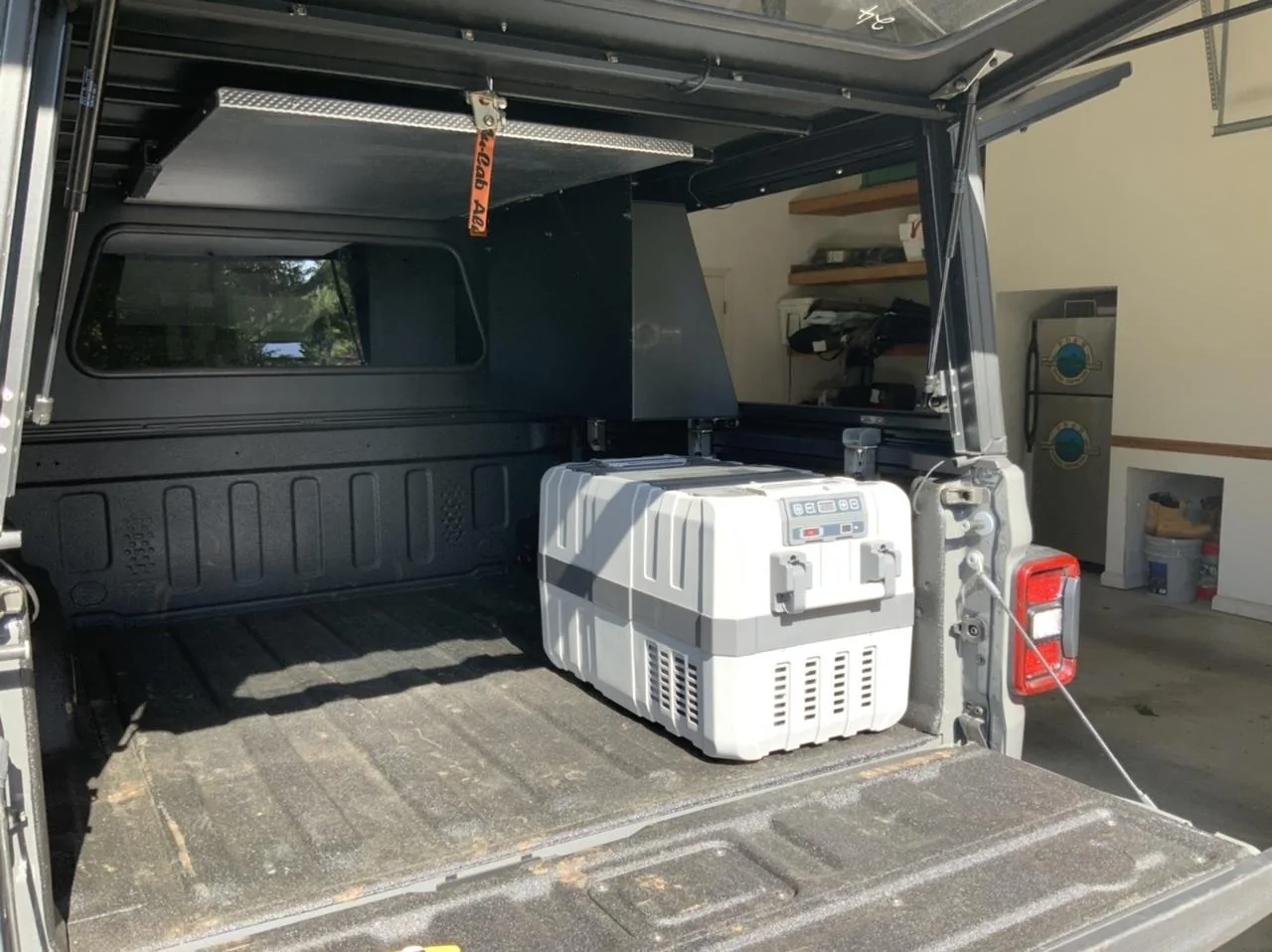

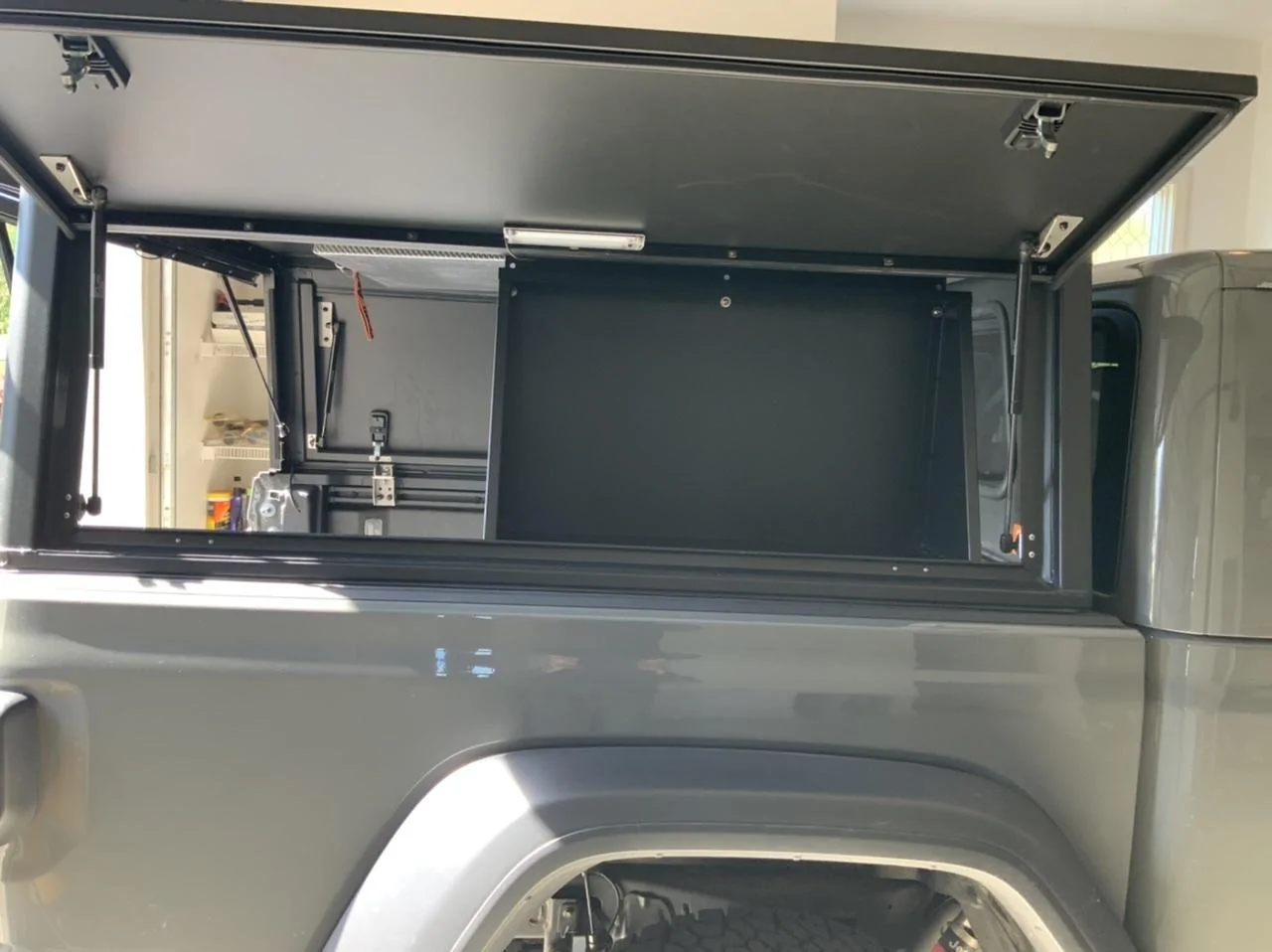

I elected to get the smaller (750 mm) side cubbard and plan to outfit it for our kitchen ware. I will do something like what they sell but it will be tailored to the way my wife cooks. These can be installed on either side and anywhere along the opening. We elected to install it as far forward as possible so that we can access our fridge from the side if everything goes as planned...

i'm so glad they did this instead of making it flat accross and used another gasket on the front. Did this also help to figure out where laterally "centered" was?
Yes to some degree. They also used the top rail of the bed to verify they were the same on both sides.

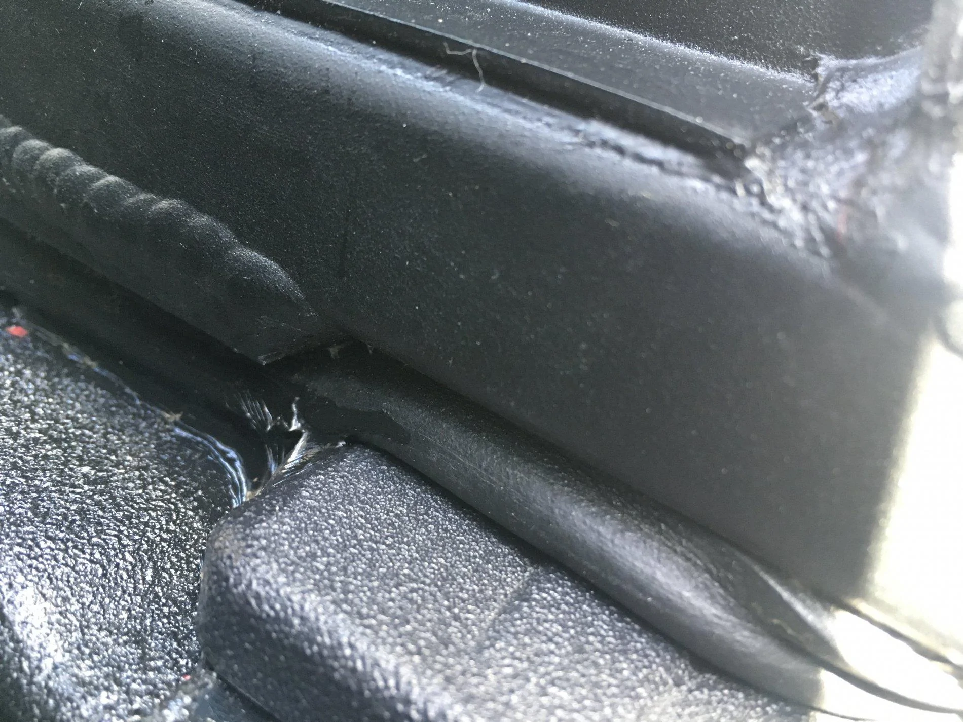

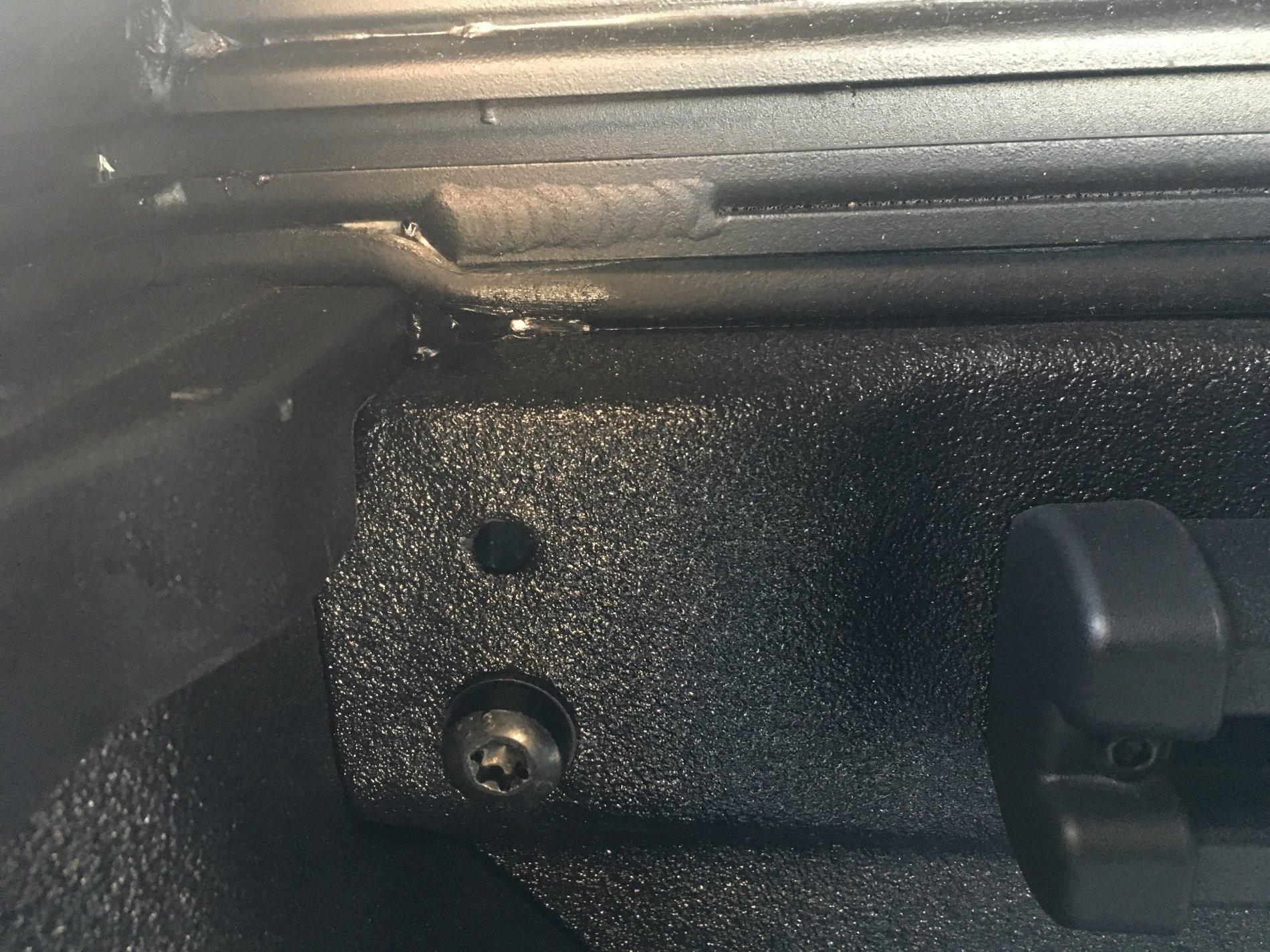

I had to use a little RTV sealer at the front inside corners of the cap. Couldn't compress the rubber seal enough to seal and could see daylight. Lifted the gasket slightly with a putty knife to get better RTV coverage.

Can you please post some pictures of how the cubbard attaches. Also a measurement of of far past the wheel well the cubbard sticks out. Also an over measurement of the side opening. I am trying to decide on 1 - 750, 2 -750 or 1- 1250 cubbard. Thanks

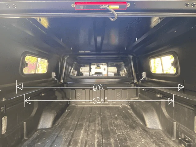

while you're taking all of our questions @smlobx , can you measure the same side to side measurement that another RLD owner took. RLD was 60.5", wonder what alu-cab is.

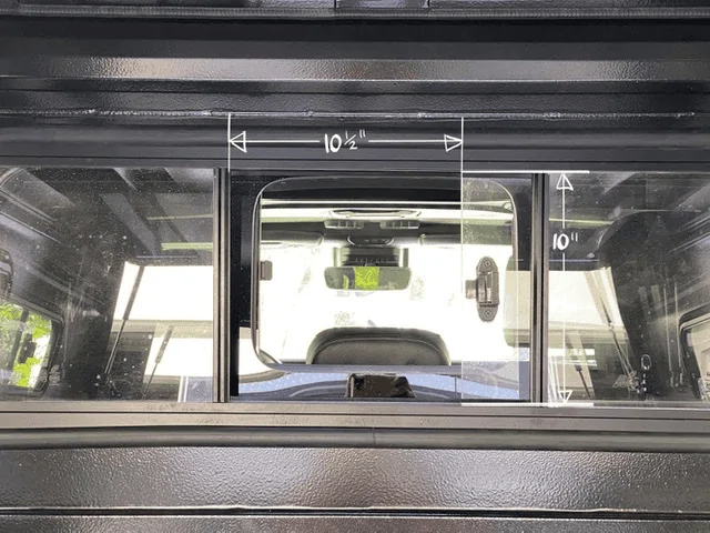

I would be interested in seeing a pic like for the Alu-Cab and the measurements to go with it. If it is too small on the Alu-Cab to be usefull, then I will order it with solid glass.
do you think it would work if I laid down a bead of silicone there, smoothed it out, let it dry, THEN put the cap on?
I just don't want the silicone to stick to the cap's weather stripping for when i take it off.
Check out that fridge cubby-hole! NICE!
Ok the width between my factory rails is 56.25”
The width to the inside of the canopy rails is 57.50”
The width between the base of the swing out doors is 56”
If you look at my pictures above it will make sense.
Given how small the Gladiator window is I didn’t order the sliding glass option for the canopy.
