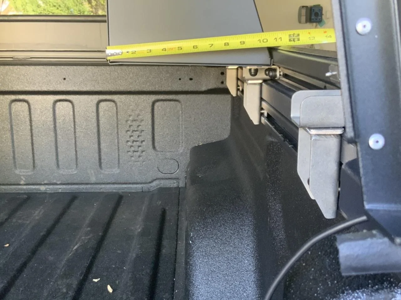

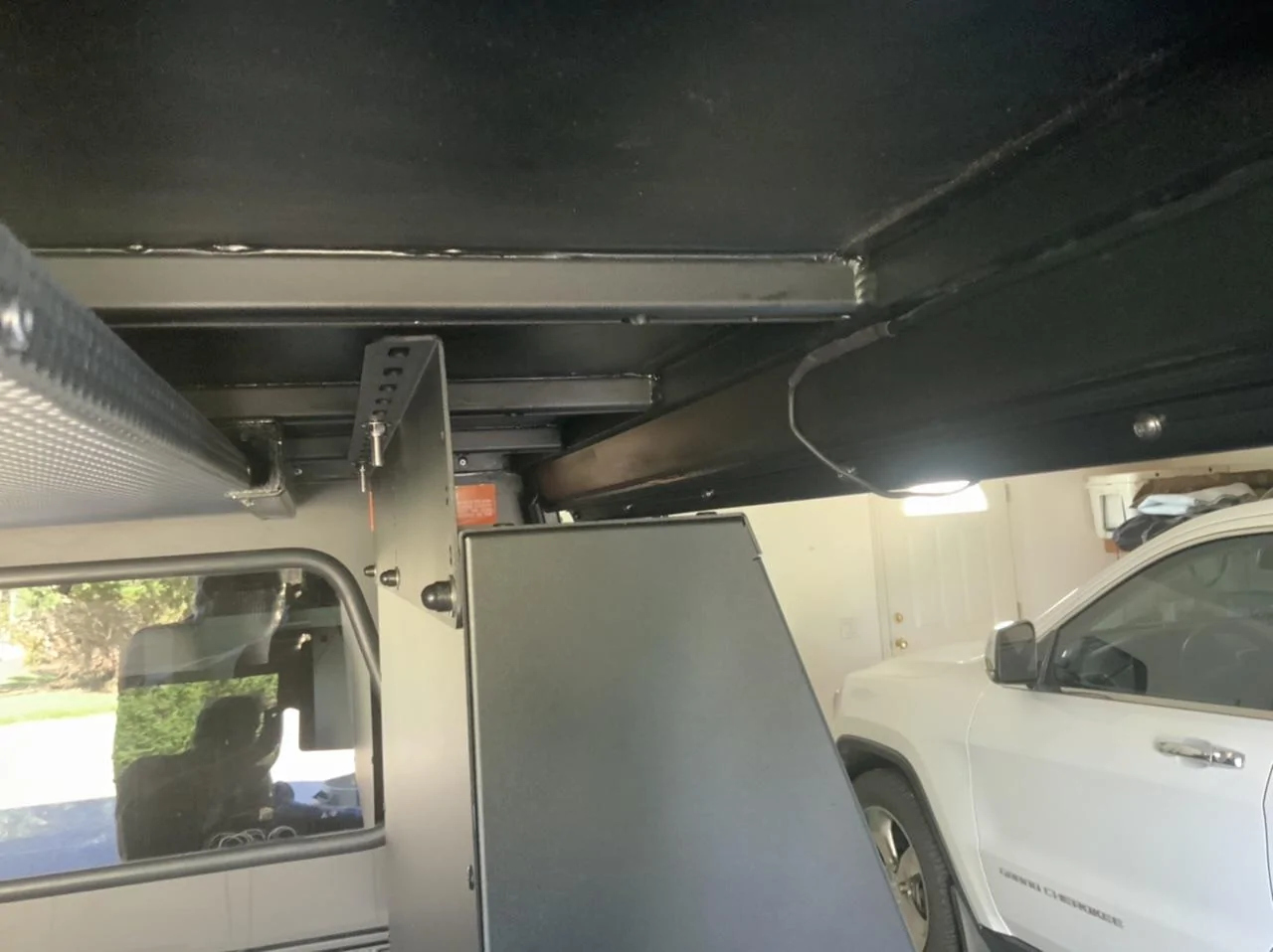

OK here are a few pictures of the brackets that hold the cubbard. The base of the cubbard is about 4.5” inboard of the wheel well.
The overall width is 29.5” which leaves about 21.5” from the cubbard to the strut.
let me know if you have any further questions.

Thats great. Thank you. Can your cubbard go any further toward the front? When looking at the pic of the compartment open, there looks to be a bit of gap to the right of the cubbard
‘It might but you have to leave room for the strut and it is at a slight angle so it needs a bit of room

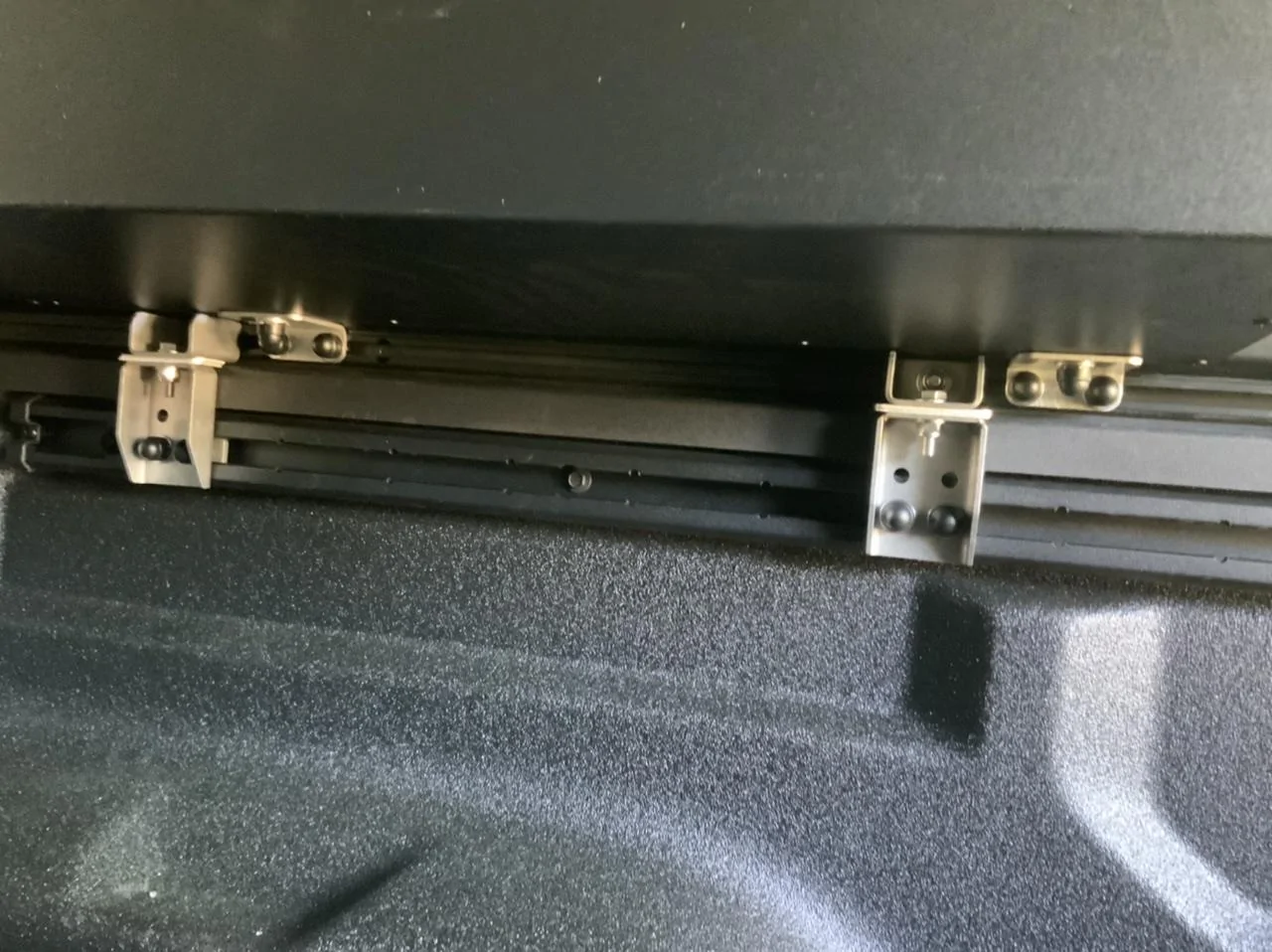

I’m hoping to do a series of posts to hopefully answer most of the questions you guys may have..
Up first is the fit of the canopy to the bed..

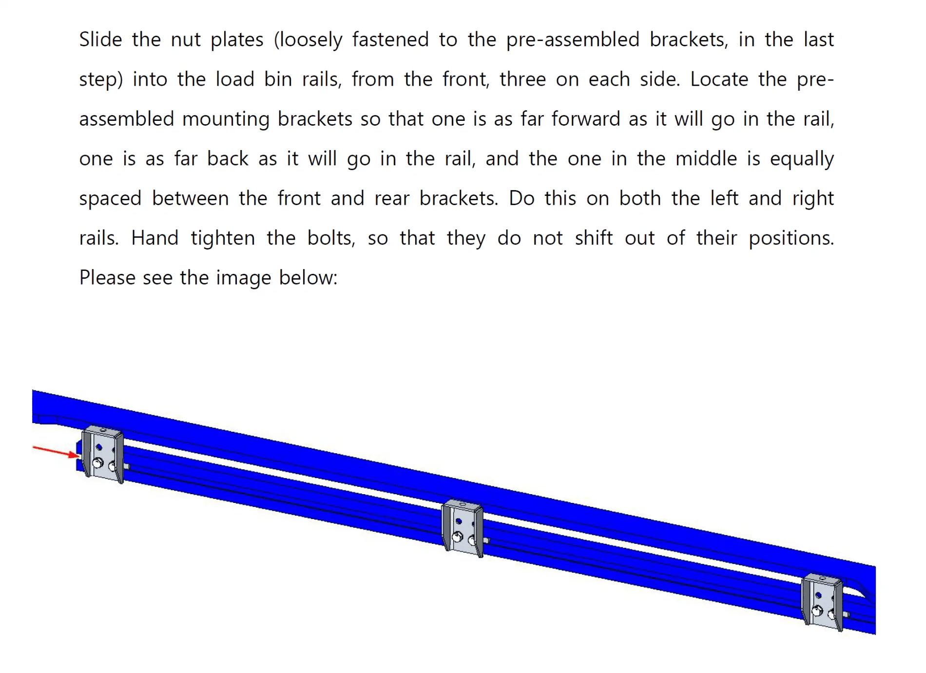

there are 3 stainless steel custom brackets on each side that are attached with SS bolts to the Gladiator bed rail. These brackets are really well built and will securely hold the canopy to the truck regardless of what you do to it.
Also, as you know the front of the bed is slightly below the side rails and this would create a potential leak point. The canopy front is actually slightly lower than the sides and along with the heavy duty gasket completely seals the canopy to the bed. We drove home in heavy rain yesterday and didn’t have one drop inside!
Now some pics!
Technically it looks like they didn't follow the directions, but i think i'm doing it in a similar way.

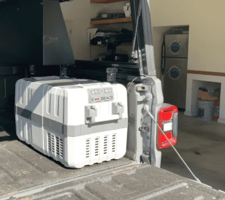

Check out that fridge cubby-hole! NICE!
‘You May be right but I’m not sure 2” will make any real difference.
