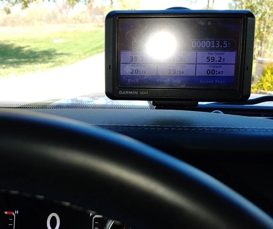

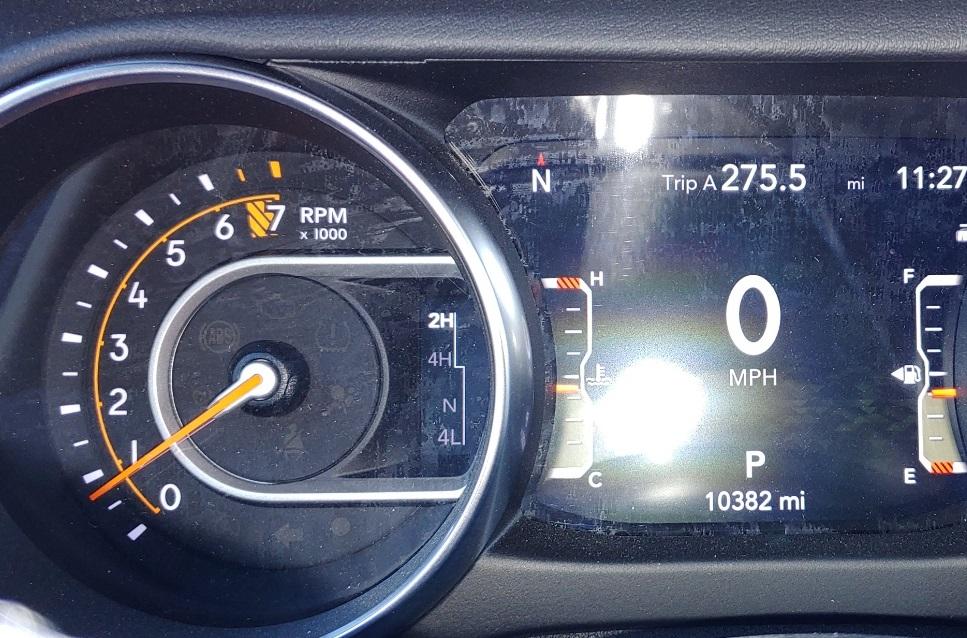

Speaking of jscan - I bought thinking I was going to use it for proximity lock addition AND setting tire sizes to ensure accuracy - especially when running the Rubicon take-offs.
So I did a test today, driving several miles with both.
I set my GPS up as a speedometer, logging distance, time, miles and more.
I set the miles to 0 on the GPS when my JT trip meter A hit a certain point. I drove over 13 miles and in the end, the miles on the truck and the miles on the GPS lines up to the tenth of a mile and the mph indicators followed each other exactly although the analog dial on the right - the physical speedometer always seemed to read a bit above even accounting for parallax. But the digital readouts on the truck and the GPS lined up absolutely perfectly in both speed and distance traveled over 13+ miles.
In short, my JT is spot-on.
So I don't get to plug in that cable and mess with tire sizes after-all.
Was your phone plugged into the Jeep? Ie iPhone plugged in with CarPlay? I ask because I was excited when I picked up my newly lifted Jeep...went from stock to 35s.......I pulled up my speedo app and everything was perfectly I sync...then someone told me to unplug it from vehicle and disconnect it from BT and I was now about 2-3 mph off........
I used a dedicated GPS on the windshield, my phone was sitting on the cup holder beside me, not plugged in.
Everything matched. I set the cruise for a couple of miles twice to keep a really steady speed and it lined up fine. Set speed was 45 one time, 55 the other. Both the digital speedometer display on the dash and the Garmin and phone (android) GPS lined up.
When I started the GPS tracking, the trip A read 262.
262 + 13.5 = 275.5
