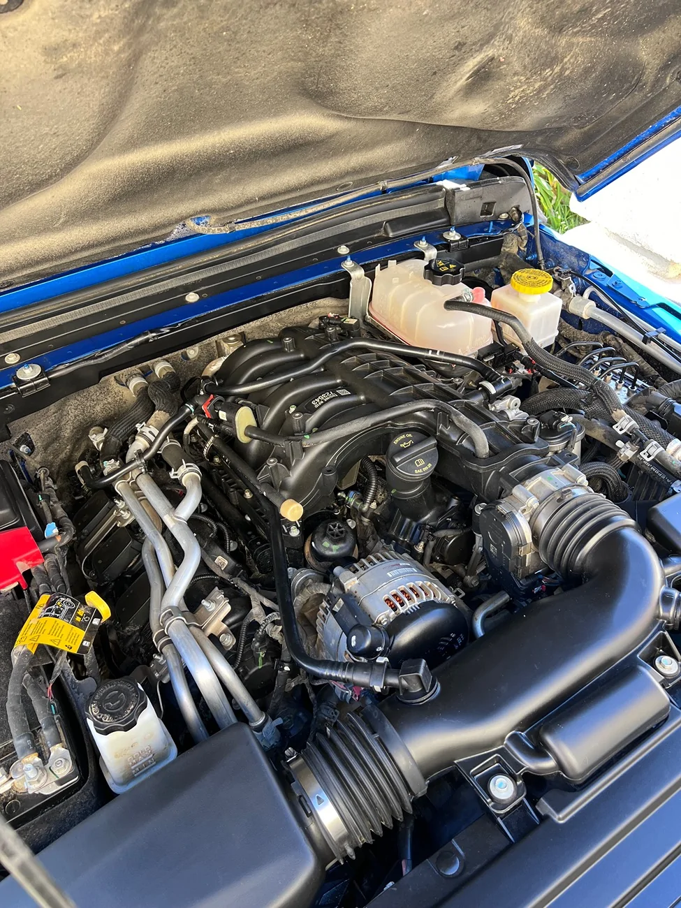

I picked up my Jeep from the dealer today.
too many crazy things going on.
After they switched out the engine and fired it up they heard a hissing sound that turned out to coming from the EGR valve. It turns out the o-ring was split and leaking so they replaced the EGR valve and seal. Looking at the picture in their file it showed damage on the flange and gasket face as if somebody had screwed it up when changing the engine.
More crazy, on the following test drive the belt tensioner pulley froze, burning up and breaking the drive belt and tearing up the tensioner pulley and idler pulley. So they replaced the tensioner, idler pulley and belt.
When I picked it up I drove around for a couple minutes and noticed the check engine light was on. I immediately drove back to the dealer to return the vehicle. When we opened the hood I noticed one of the tubes was missing from the side of the engine. The service manager said it might be part of the EGR system which was upgraded and may not be needed anymore. I’ve been looking at my engine diagrams and parts catalogs to find what this part is. So far I haven’t been able to find it so I’m going to post a pic of it here to see if anybody knows what it is
it the one on the side of the engine with the beige colored end cap on it
Jeep Gladiator Another Cam bites the dust... IMG_2013
Jeep Gladiator Another Cam bites the dust... IMG_1426
Needless to say, I insisted on a rental car until they figure out the mess they made of my jeep and I am now going to be very particular on the work they do with hardly any trust in their work from now on.
If I was them I would be embarrassed as hell.

What is that label on top of the intake?
Hootbro
Apr 13, 2019
58
10,330
20,352
2025 Gladiator Sport
You mean the 723543?
I don’t know. It looks like the part number to me.
Ok, thought it had more data on it than that. Thanks.
