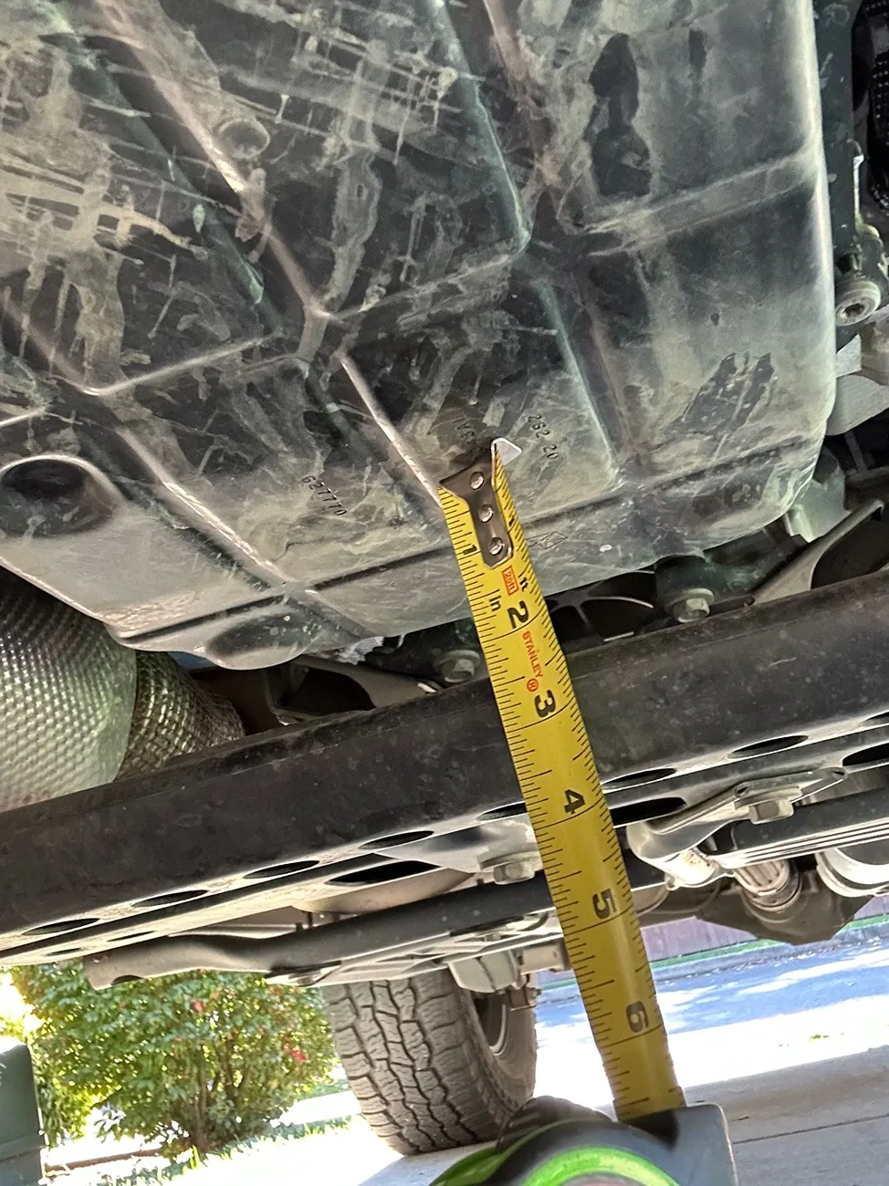

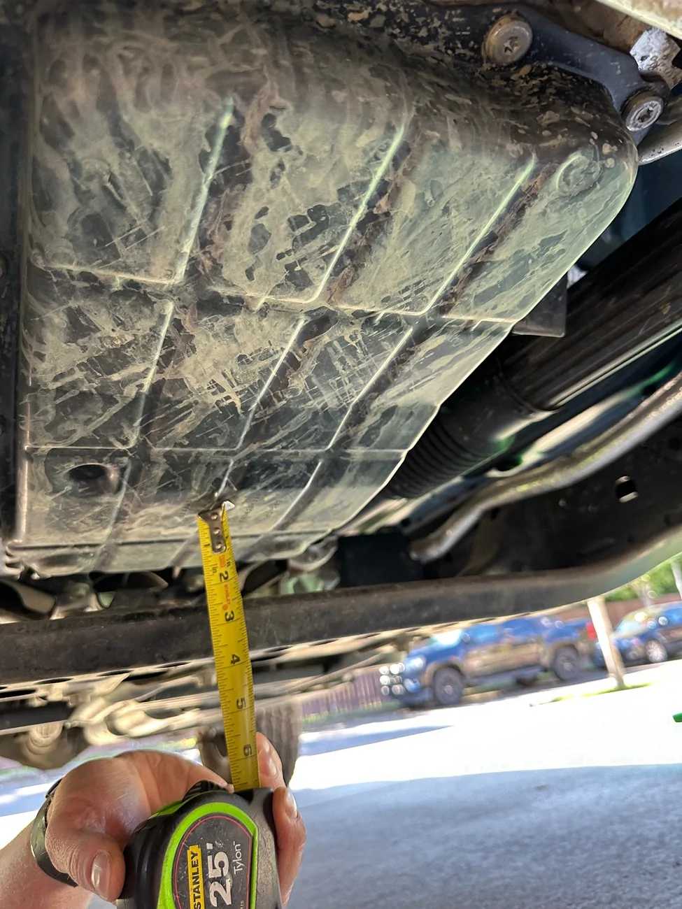

Good to know. I went out and measured the clearance from the stock transmission pan to top of the stock crossmember and it's 2 3/8" at best. I'm assuming most skid plates would be located the same as the top of this stock crossmember.

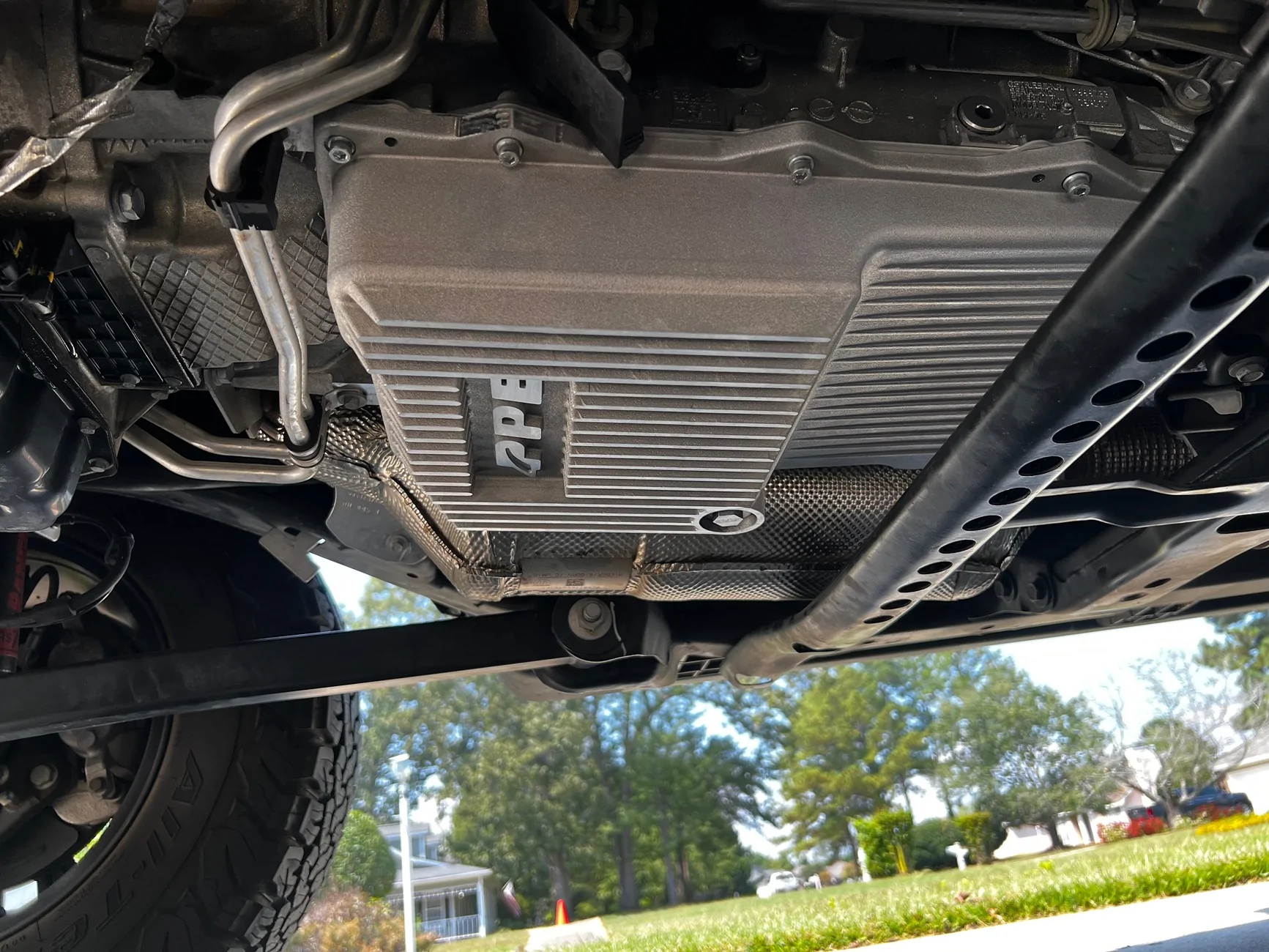

Jeep Gladiator Any DIESEL owners running PPE's transmission pan? IMG_5855

Installed about two weeks ago..I didn’t go with the deep pan so mine just added 1qt extra. So far so good. Keeps temps around d 190 running on interstate
Didn't know they had two options. Thanks. I bet this would clear a skid plate. Looks like it doesn't sit as low as the top of that crossmember.
i got mi e thru extreme terrain and they have deep which is the 2.5 extra, I went with the lesser option..also a few bucks less

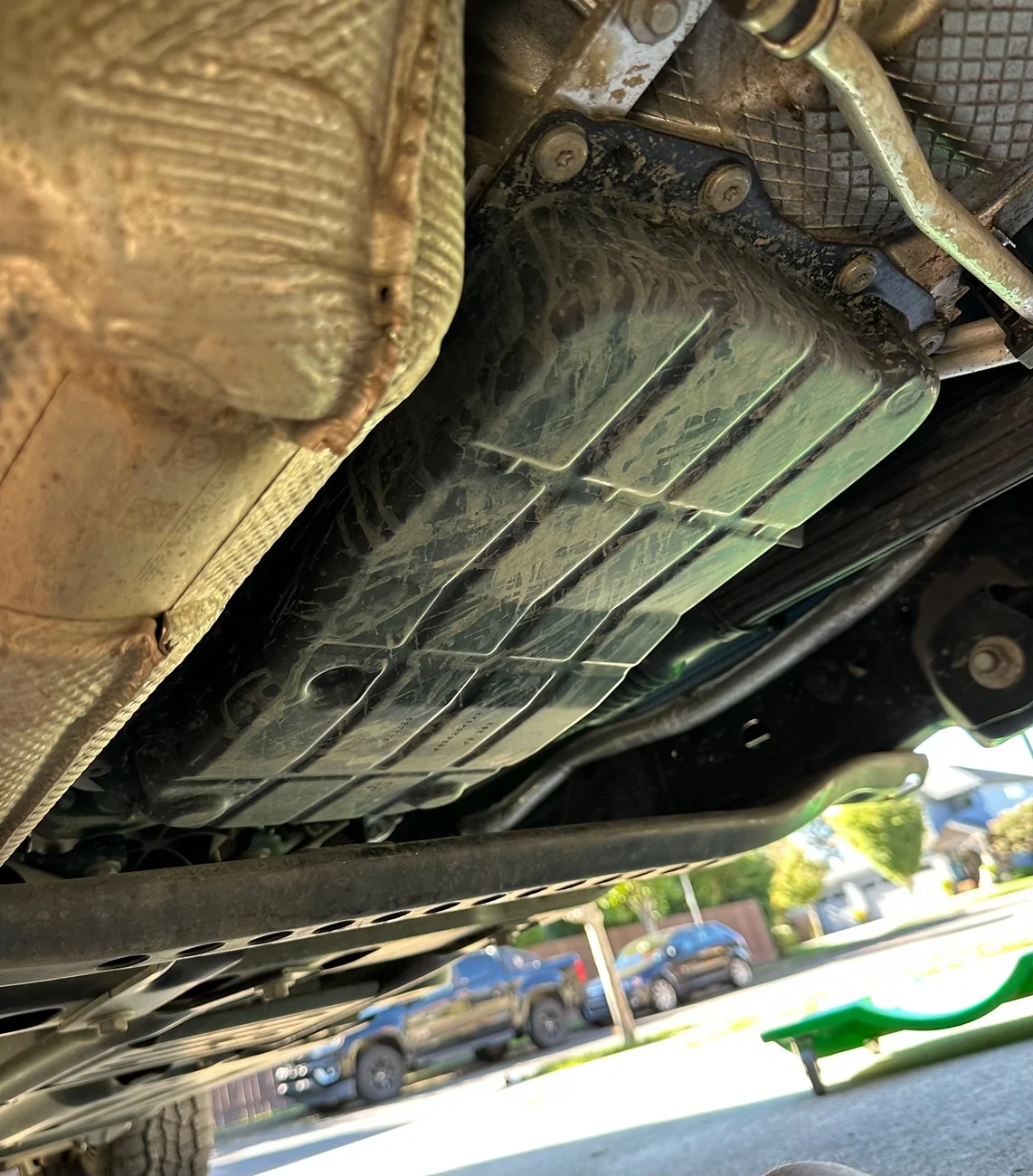

The stock pan has its lowest point at the rear of the pan, but that PPE pan is built differently. Still curious if the forward section branded “PPE” would hang as low as the top of that stock crossmember.
Here is the stock pan. Hard to take pics under there.
