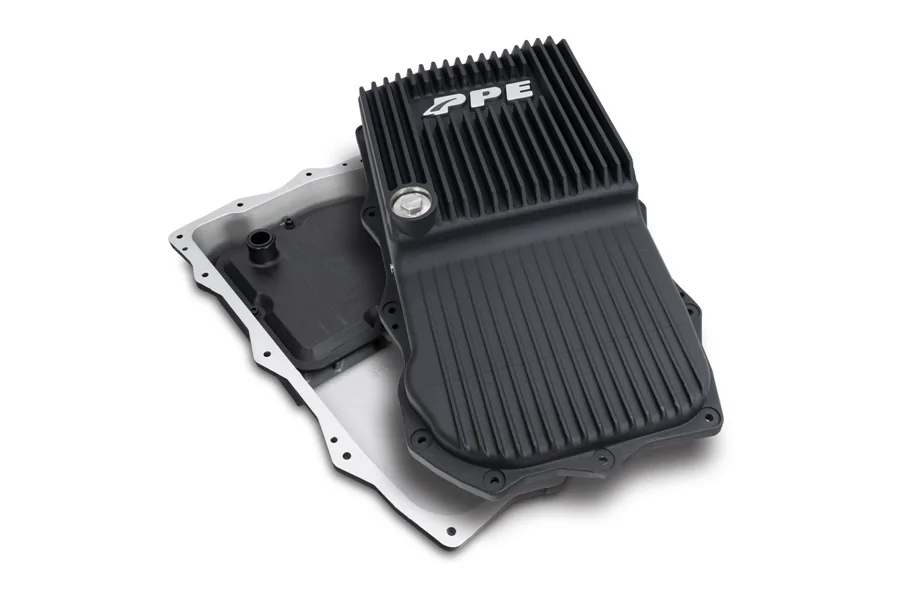

I saw this transmission pan adds 2.5 qt capacity and was wondering if anyone is running it? I'm gonna change out my transmission fluid + filter anyway and will have to lower the pan. It would be a good time to add this aftermarket upgrade. Will it interfere with skid plates? It sits higher than the crossmember, and the DPF looks like the next lowest item besides the crossmember. Northridge 4x4 sells the pan.

I messaged Northridge and was told they have seen some clearance issues with skids. Advised to stay with stock transmission pan. Did not say specifically which skids have clearance issues with the PPE deep pan. Probably best to ask the skid manufacturers, honestly.

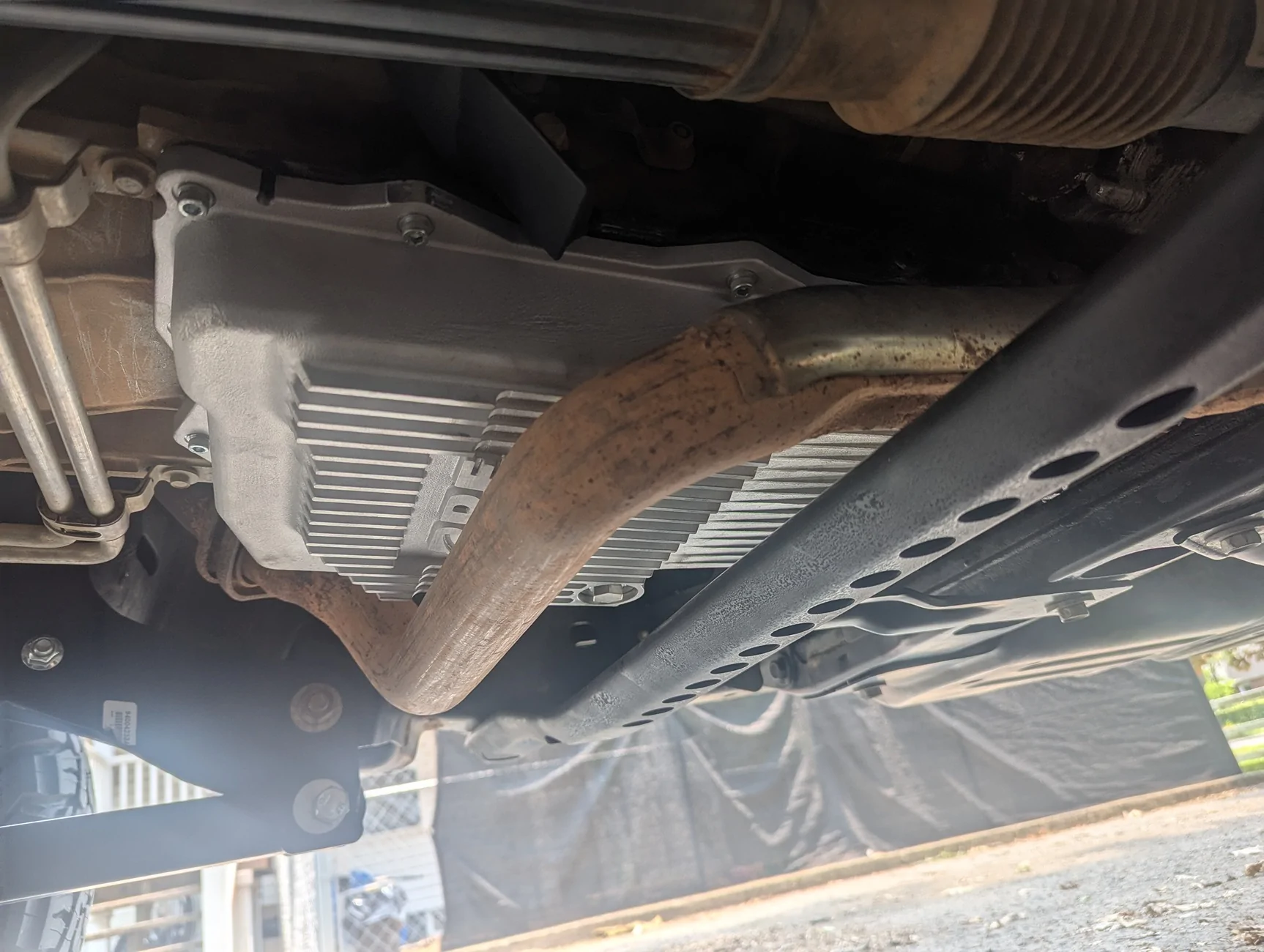

You need the ppe pan made for the gladiator that has clearance for the exhaust pipe. Not sure it adds any capacity.

I still had to drop the crossover exhaust pipe to get the non extra fluid PPE pan on.

I have this on a 3.6L and have had no clearance issues with Motobilt skids. The pan has made temps more stable and it's a lot easier to drain. Also helps that this pain has a replaceable filter.

I have the PPE pan on my JT. I have stock skid plates. No issues with the install and no issue with the OEM skids. Not sure how after market skid plates would interfere with the PPE pan as the exhaust would be between skid plates and PPE pan. I have the 3.6.
