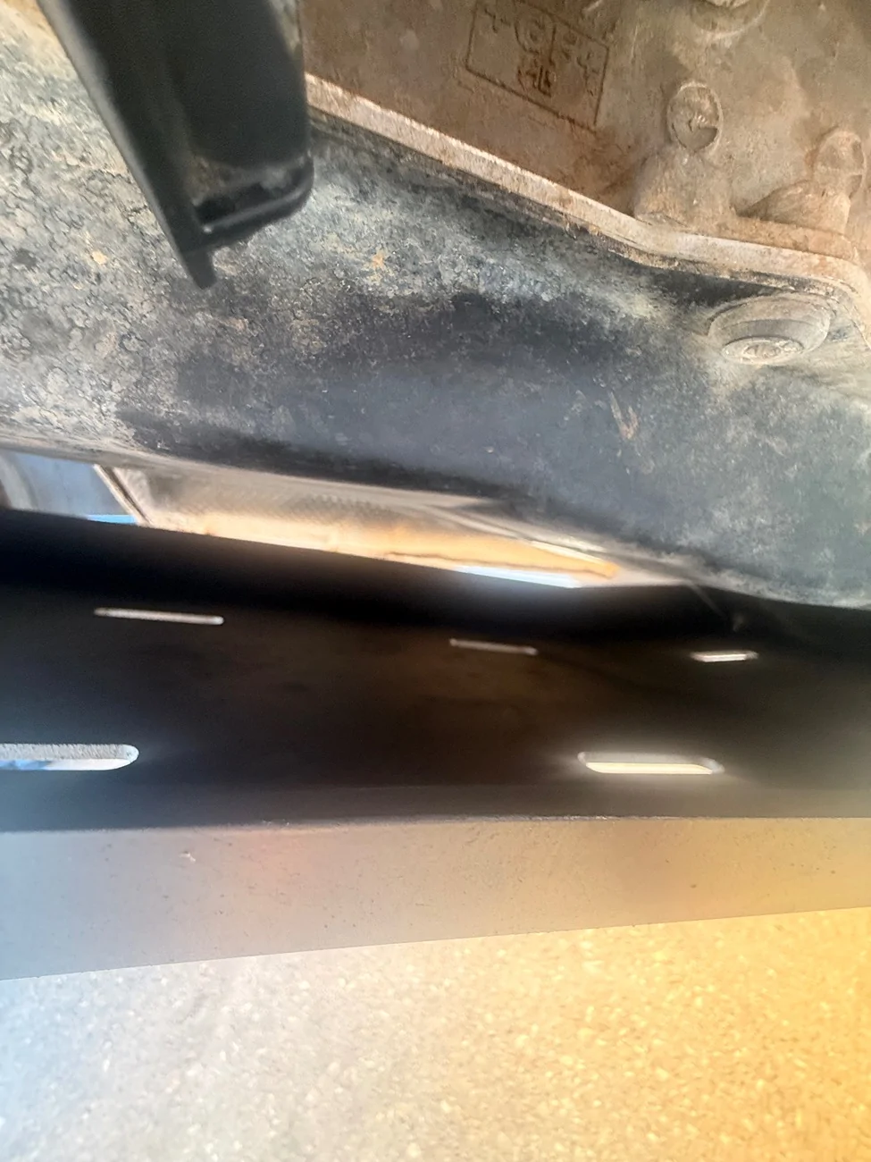

RockJeep98
Bobby
Oct 4, 2022
85
204
Dothan
2022 Jeep Gladiator Rubicon
Technical Support Manager
If you learn anything definitely try to remember to report it here. I called Artec today and tried to get tech on the line, but it just rang and rang. No one picked up. I was gonna ask about the specific combo and see if they knew anything.
Then I called Motobilt, asked about the skid clearance for a PPE transmission pan like this, and he offered to go measure their diesel JT with skids on it. He called me back and said it was tough to get an accurate measurement under there, but there was between 2-3 inches of clearance between the bottom of the stock transmission pan and top of their skid. Then he said probably 2.5 inches, but hard to say exactly. I appreciated the effort and thanked him for it. I will remember Motobilt in the future for it.
Here is the photo I took the other day. Let me know if you need anything else.
Jeep Gladiator Any DIESEL owners running PPE's transmission pan? IMG_3432
