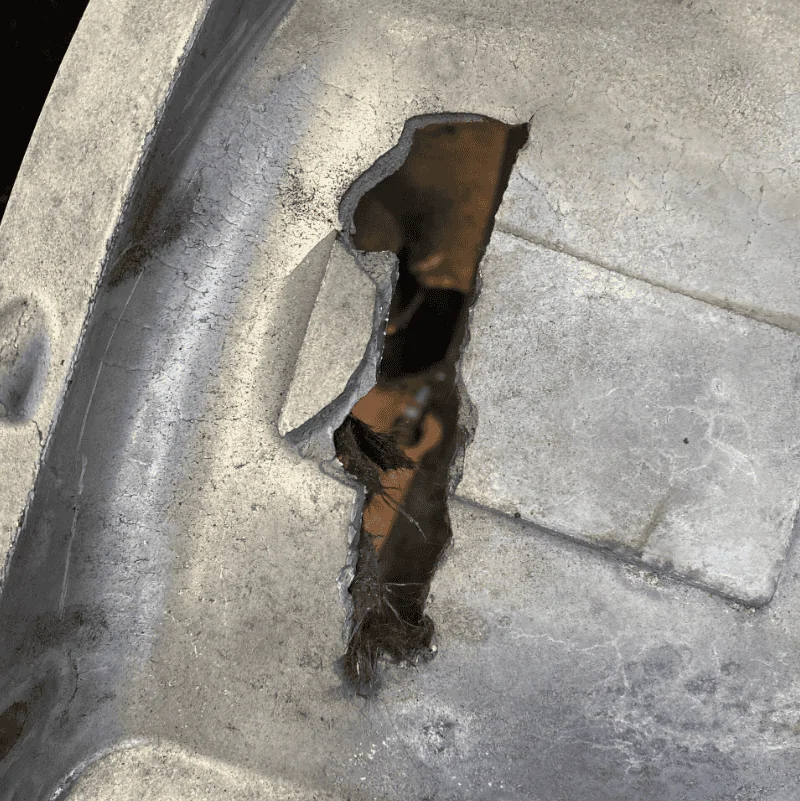

Did he say both recalls or just one?
Didnt read the whole thread.
Wasn’t specific - but given the time frame, the first was either already done or they would certainly have done both while they were at it.
Based on the date, both recalls would have been completed. Here's another post in that thread from someone whose clutch failed after both recalls and others are mentioned in subsequent posts. https://www.jlwranglerforums.com/fo...rns-2018-jlu-to-the-ground.98834/post-2045675
My experience is that my JL's original clutch seemed glitchy and it was replaced under the recall at around 20k miles. The replacement feels like a regular clutch. I posted pics here https://www.jlwranglerforums.com/forum/threads/clutch-recall-new-clutch-pics.52128/post-1138274
40,491
53,988
Based on the date, both recalls would have been completed. Here's another post in that thread from someone whose clutch failed after both recalls and others all mentioned in subsequent posts. https://www.jlwranglerforums.com/fo...rns-2018-jlu-to-the-ground.98834/post-2045675
OK, there's where it's said "both recalls" and there's zero doubt that the bloody thing exploded. Looks like some bell housings I've seen after a flywheel explosion.......
Someone needs to reach out to those plaintiffs with some of this, although it will probably still be dismissed since they were not directly impacted by the problem. They can't prove that even after the recalls, they were impacted in a negative way.
Obviously, a couple of other folks could.
