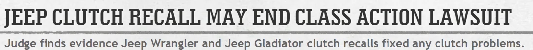

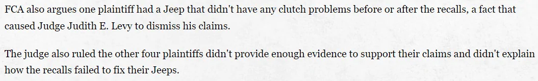

Avoid the manual, it has a tendency to explode around 30k. There have been multiple lawsuits and recalls to no avail. If you have one sell soon while it is worth something. Mine has been at the dealership for 4 months with no repair.
250
40,616
54,299
All related to the clutch, not the transmission itself.
The 2nd recall modified engine torque when the clutch reached a dangerous temperature.
There are no issues related to the transmission itself - just the clutch.
Some have resolved that by putting in 3rd party clutches.
Jeep Gladiator Any reason to avoid Manual Transmission? 1675484091708
Jeep Gladiator Any reason to avoid Manual Transmission? 1675484122310
The judge is giving the plaintiffs another shot at proving there are still problems but if they can't prove the recall didn't fix the issues, he's dismissing their cases.
So it would seem that from everything I've ever found - once the recalls are performed, the clutches don't explode. I find nothing showing that after the recalls are actually performed there are still fire or blown clutch issues.
