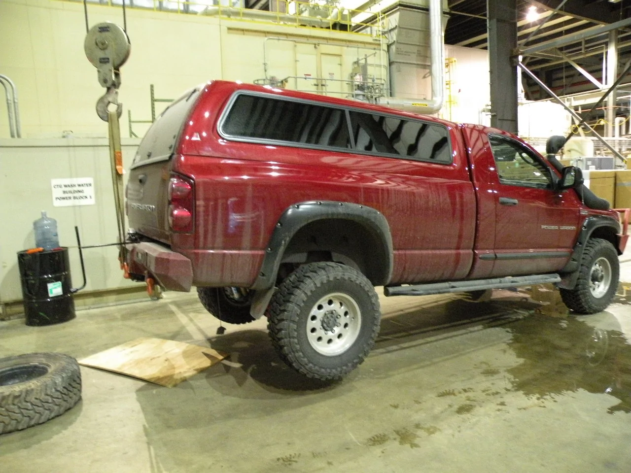

When I installed 3" King shocks on my Power Wagon. I used a 100 ton crane to lift each end of the truck up to install the long travel shocks. Still needed help getting them installed.

That's what I did with a 100 ton crane and it still wasn't enough.

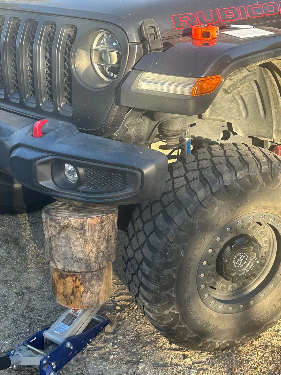

here is how I did it using a 1.5 ton aluminum floor jack from harbor freight jacked up 10 inches bottom of shock at16 inches top at 46inches tires on the ground still had 3 inches to go on the jack clearance from bottom side of fender to top of tire is 14 inches I’m running 37 inch tires
Jeep Gladiator Any tricks for keeping new shocks compressed for install? IMG_5108
Jeep Gladiator Any tricks for keeping new shocks compressed for install? 1772935843262-y7
